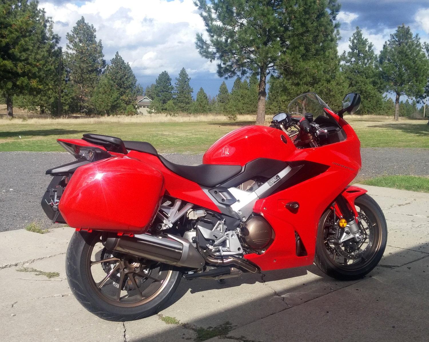

Member Contributer CoyoteChris Posted September 28, 2019 Member Contributer Posted September 28, 2019 I love this bike! Time for the first oil change (piece of cake) and a chain adjust. I got out my breaker bar, torque wrench, rulers, etc and went to work on adjusting the chain. Unencumbered by the thought process, I read the procedure in the owners manual. I then decided to do the business on the center stand instead of the side stand and note the difference. I also checked the slack at four points, just like it was 1964 all over again. It didnt change from side stand to center stand that I could tell. Question. In days of yore, we would put a ruler perpendicular to the chain at midpoint, press the chain down first (about 1/4 inch on this bike) and then press the chain up. I did this on my VFR and set the slack to 1 inch at midpoint. If this what y'all do? Sept is at an end here in the great Pacific NW...still time for a nice warm ride or two....but winter is coming. Quote

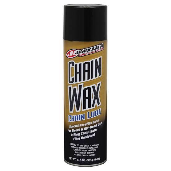

Member Contributer Grum Posted September 28, 2019 Member Contributer Posted September 28, 2019 36 minutes ago, CoyoteChris said: Thanks, Grum. Do you press down on the chain, note the ruler marking, and then pull up? Wow, looks like you are getting great sprocket and chain milage......which lube do you prefer and what chain cleaner? You must be doing something right. 👍 Hi Chris. Never measured the slack. I simply pull down and push up, no rocket science in knowing what 25 to 35mm looks like especially with us ex Aircraft Engineers! Years ago I bumped into a very experienced motorcycle mechanic and he recommended Maxima Chain Wax and I've been using it ever since, really like the stuff. I generally don't travel more that a couple of hundred K's without giving the chain a good squirt. Currently running a nice Gold EK525ZVX3124 (cut back to 110 links) and is performing excellently. Generally just wipe over the chain side plates with a Kerosene soaked rag to get it looking good and clean. Ahh Yes the other added gem of the center stand, more pieces of cake! So easy to lube and clean a chain. Cheers. 1 Quote
Member Contributer VFROZ Posted September 28, 2019 Member Contributer Posted September 28, 2019 Ha, that's the same wax I've been using for years. and same for me, 60,000km on my last chain with only 2 adjustments in it's life. Only swapped it out as I went for a 520 chain kit with 2 extra teeth on the rear. 25,000km on it now with only one adjustment at 1000km. Quality chains do make a difference. I've never used a ruler either, I know what 25 to 35mm looks like. 1 1 Quote

Member Contributer CoyoteChris Posted October 8, 2019 Author Member Contributer Posted October 8, 2019 On 9/27/2019 at 7:48 PM, Grum said: Hi Chris. Never measured the slack. I simply pull down and push up, no rocket science in knowing what 25 to 35mm looks like especially with us ex Aircraft Engineers! Years ago I bumped into a very experienced motorcycle mechanic and he recommended Maxima Chain Wax and I've been using it ever since, really like the stuff. I generally don't travel more that a couple of hundred K's without giving the chain a good squirt. Currently running a nice Gold EK525ZVX3124 (cut back to 110 links) and is performing excellently. Generally just wipe over the chain side plates with a Kerosene soaked rag to get it looking good and clean. Ahh Yes the other added gem of the center stand, more pieces of cake! So easy to lube and clean a chain. Cheers. All right! I will try some. My friend Frosty and I are both pilots and we dont have the sense God gave an eggplant so we measured ours. It turns out to be the low limit when the chain wont touch the upper rubber guard.... Quote

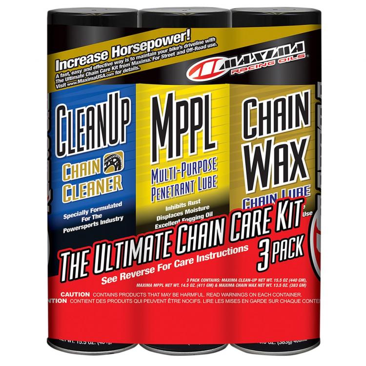

Member Contributer CoyoteChris Posted October 8, 2019 Author Member Contributer Posted October 8, 2019 On 9/27/2019 at 7:48 PM, Grum said: Hi Chris. Never measured the slack. I simply pull down and push up, no rocket science in knowing what 25 to 35mm looks like especially with us ex Aircraft Engineers! Years ago I bumped into a very experienced motorcycle mechanic and he recommended Maxima Chain Wax and I've been using it ever since, really like the stuff. I generally don't travel more that a couple of hundred K's without giving the chain a good squirt. Currently running a nice Gold EK525ZVX3124 (cut back to 110 links) and is performing excellently. Generally just wipe over the chain side plates with a Kerosene soaked rag to get it looking good and clean. Ahh Yes the other added gem of the center stand, more pieces of cake! So easy to lube and clean a chain. Cheers. Not worth the money for the cleaner and penetrator? Quote
Member Contributer Grum Posted October 8, 2019 Member Contributer Posted October 8, 2019 25 minutes ago, CoyoteChris said: Not worth the money for the cleaner and penetrator? Hi Chris. Haven't seen the triple pack before,so can't comment. I just get by with Kero on a rag to get the chain clean and just use the Chain Wax after a ride while the chain is still warm. YMMV. Cheers. 1 Quote
