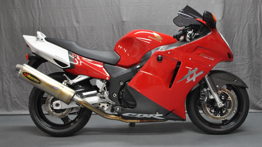

Member Contributer Chromedome Posted May 8, 2019 Author Member Contributer Posted May 8, 2019 You bet. Then to add confusion, yesterday I rode my Blackbird for the first time in a long while. Wow, wind hitting me at my shoulders, helmet nice and quiet but also that engine is the smoothest thing out there. I have to admit after looking at the fairly funny front end of the VFR I ended up really loving how the Blackbird looks. And after all these years I've done like 50 mods to it - I think I need to keep this thing, finish my V&M Anniversary livery (see below) and I'll probably end up selling the VFR - late this year I'm sure. UGH. But, I guess it's all good. I plan to buy and sell many more bikes in the future. I mean, I've got electronic cruise on this thing, DMr fork cartridges, Ohlins shock, custom paint and undertail, am installing a full Akrapovic system soon and it's red, white and black just like I seem to love. Too many bikes, not enough room in the garage, 😞 1 1 Quote
