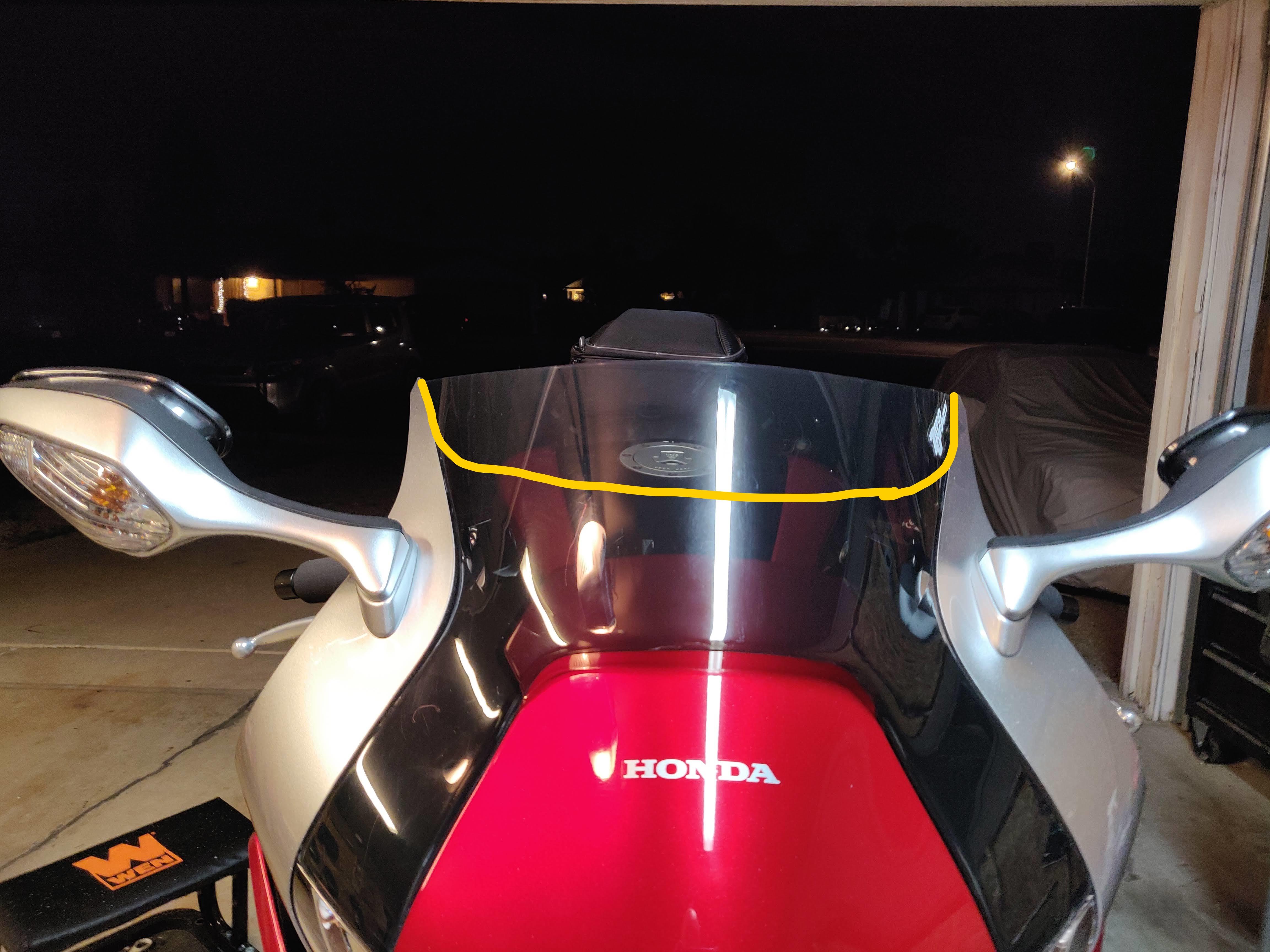

Member Contributer Chromedome Posted April 1, 2019 Author Member Contributer Posted April 1, 2019 So, not happy with the National Cycle screen. I had talked about finding someone to cut (and edge polish) my ZG screen but decided I should try myself. Ending up scribing the shield using a set of digital calipers then cutting it with a Dremel and cutting wheel. It's not perfectly straight but will do for me. I then used a headlight polishing kit to polish the edge and some of the other scratches. I took off about 1.75". Let's hope it helps! Quote
Member Contributer Chromedome Posted April 7, 2019 Author Member Contributer Posted April 7, 2019 Better, but still turbulent air hitting the bottom of my helmet. I now have a great method of cutting, smoothing the edge and polishing it. I'll share for posterity. Simply, I use a Dremel and small cutting wheel. I use the gap created between the chuck and cutting wheel to help set the line and guide me. I then clean up the cut with a palm sander starting with 100 grit then 500. I then finish polishing (and clean up any scratches from slips) with the process as described in this Mothers headlight polishing kit (which, by the way, works really well for yellowed headlights). Mothers 07251 NuLens Headlight Renewal Kit https://www.amazon.com/dp/B00GZLMEPM/ref=cm_sw_r_cp_apa_i_ZxzQCb4963BPZI'll keep trimming this visor down as low as it needs to go. Even if it ends up just a little 4 inch screen. I think it looks awkward in pictures but looks perfectly normal and natural in person.Sent from my ONEPLUS A6003 using Tapatalk Quote

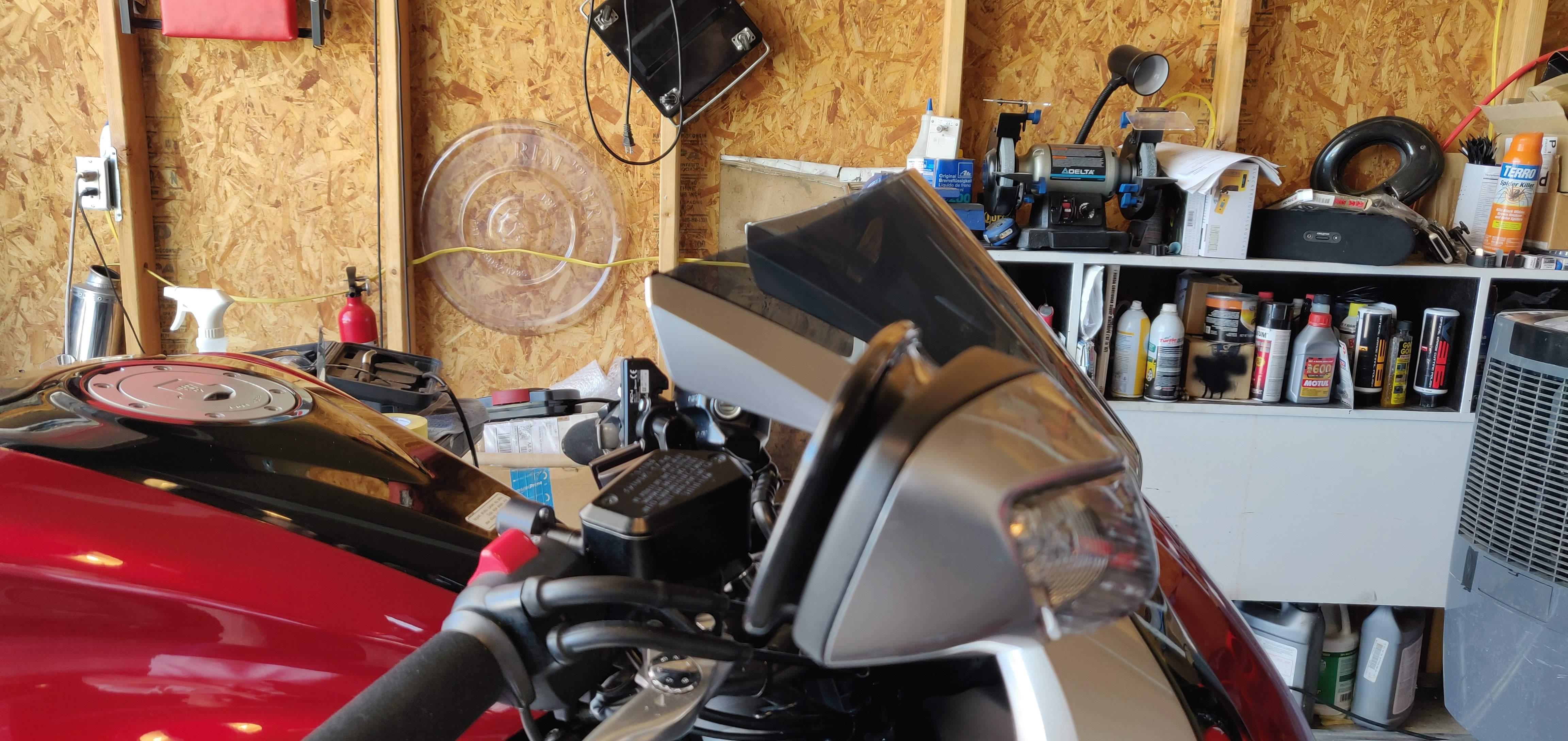

Member Contributer Chromedome Posted April 9, 2019 Author Member Contributer Posted April 9, 2019 Alright, so HERE's the experiment. And I suspect the big fascia in the front is going to give me a bit of wind protection so this may end up being my solution. However, unless it grows on me (and maybe I'd go so far as to trim the windscreen ... posts(?) down to around the mirror), I wonder if I'll just be selling this bike when my Ninja's fixed. I'd be sure to source another front cowl first. This weekend I'll be trimming the ZG screen even lower, and especially down around the ... posts. Am definitely curious to see any effect of the holes in the front now. Quote
