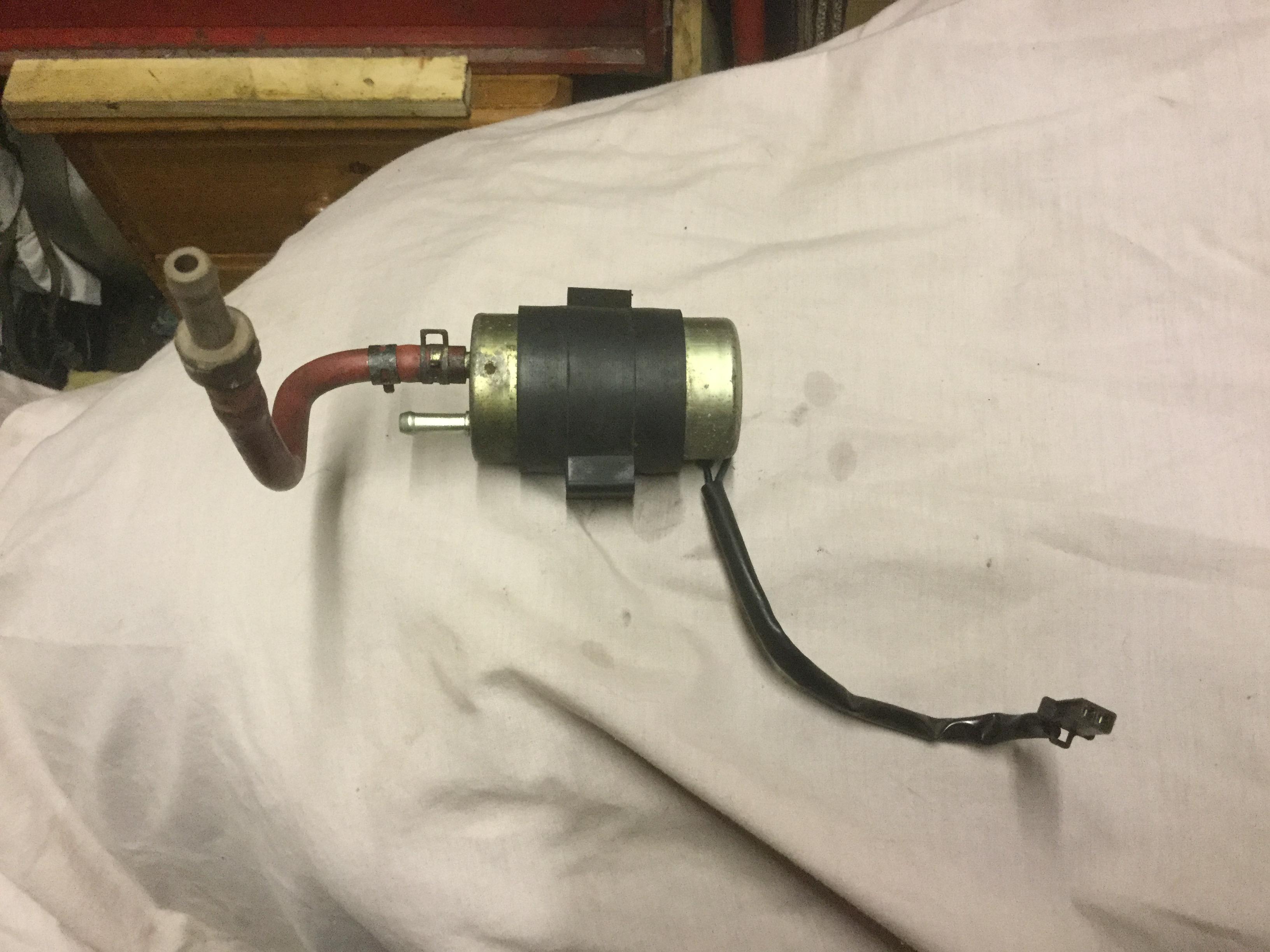

Hello, tried to start the bike over easter, fuel pump was not working, so by passed it . Started ok , a bit tappety but not too bad, But when I select 1st gear and release the clutch the bike stalls !!! . It doesnt appear to have a sidestand switch !. Could the cutch be seized ! Any advice or suggestions welcome , cheers Eamonn
