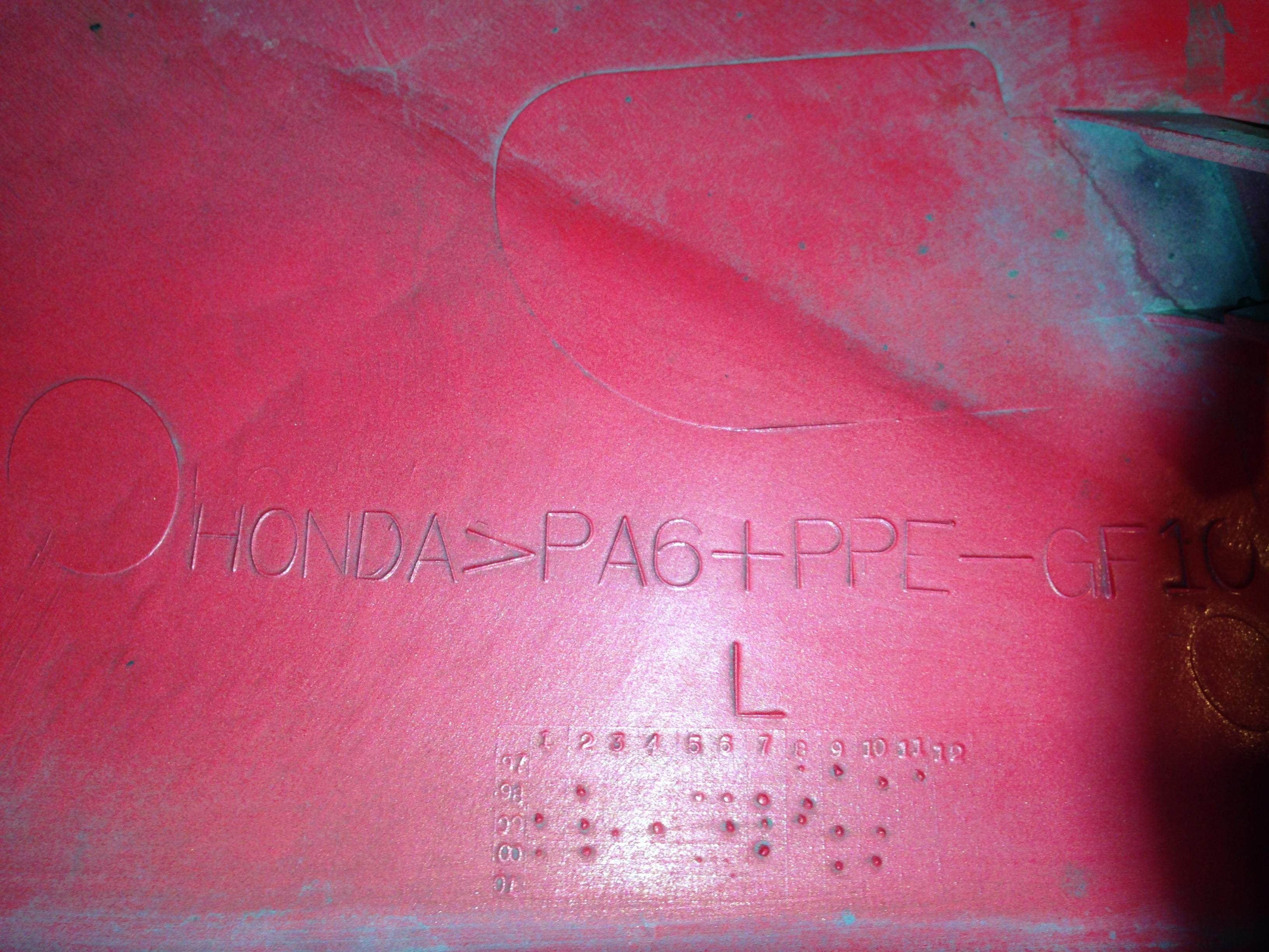

Member Contributer Hingley Posted December 28, 2018 Member Contributer Posted December 28, 2018 Do you know the code of Honda motorcycle plastics and what car bumper plastics code is? Quote
Member Contributer Duc2V4 Posted December 28, 2018 Member Contributer Posted December 28, 2018 (edited) 41 minutes ago, Hingley said: Do you know the code of Honda motorcycle plastics and what car bumper plastics code is? I have a picture of the code from one of the side panels of my 5 Gen, let me see if I can dig up the picture off of my computer and post it up. Edited December 28, 2018 by Duc2V4 Added photo 1 Quote
Member Contributer RossR Posted December 28, 2018 Author Member Contributer Posted December 28, 2018 1 hour ago, Hingley said: Do you know the code of Honda motorcycle plastics and what car bumper plastics code is? It might be different for each model. You have to look at the the back as Duc2V4 has posted. In his image you see the code PA6 +PPE which is mix of two different plastics. Usually it's just one type. Once you find the code Google it and you will find out the type of plastic. Some fairings are ABS which apparently is easier to work with. PPE is polypropylene which is notoriously difficult to glue or paint. My Givi E-41 cases are PPE. Quote
