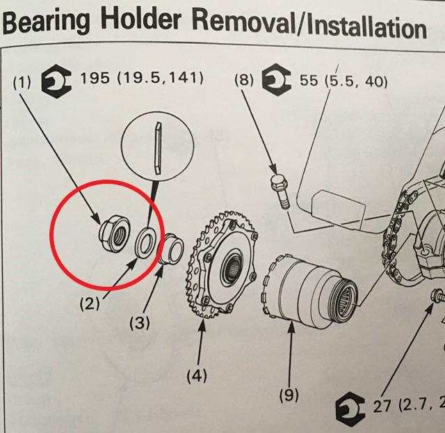

On 5/15/2020 at 3:08 PM, Gebruiker said:
Nothing looked dodgy to me but the little hubcap thing wouldn't click in place. So I tried jiggling the nut. And it turned. By hand. It was loose. The nut. I could hand tighten the whole nut. By which I mean, I could hand tighten the whole damn wheel.
Here’s the service manual. Nut number 1.
Thank you for bringing this to the attention of the forum!
You are correct, a properly staked nut will have a big dent in it.  Glad yours didn't cause a catastrophic failure.
I went out and checked mine and while the rear axle nut is not loose, no attempt has been made to stake the nut in place even though it is definitely designed to be.  I am wondering if it came from Honda this way?!
Thanks again.
Neither of us know the history of our bikes. Once I discovered the problem, I did notice what could have been a small staking dent maybe. But dent or not, it wasn't doing its job. Since it has never become a known unknown around here at VFRd in the 30 years since the bikes were built, it seems unlikely to be a major issue. Unless of course, all non-stakers are now dead and therefore failing to report in...
But now that you have doubled the sample size of unstaked axles, it might be a good thing for more gen3 owners to check into.
