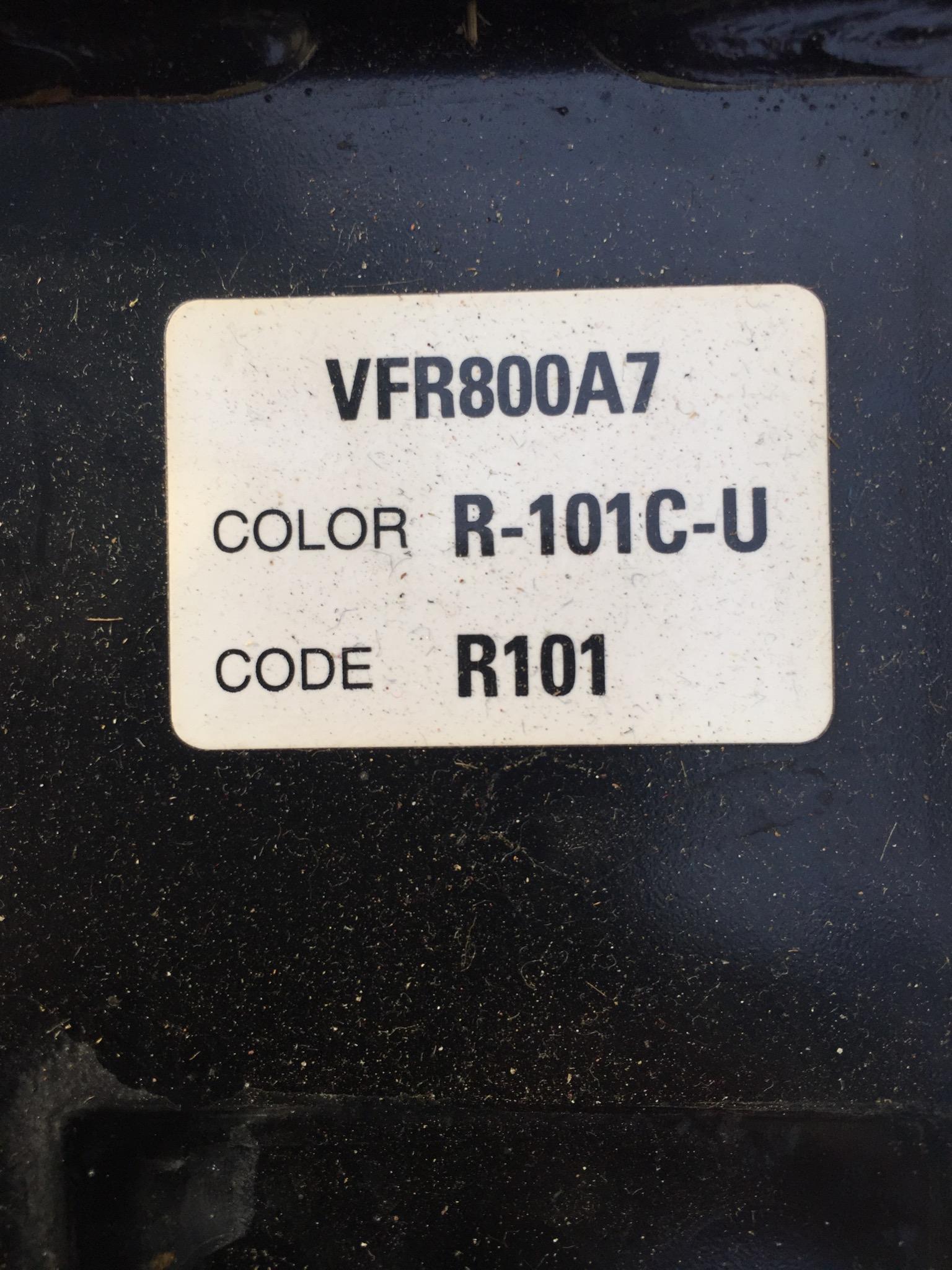

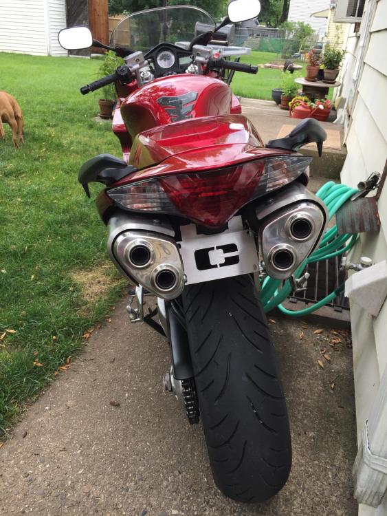

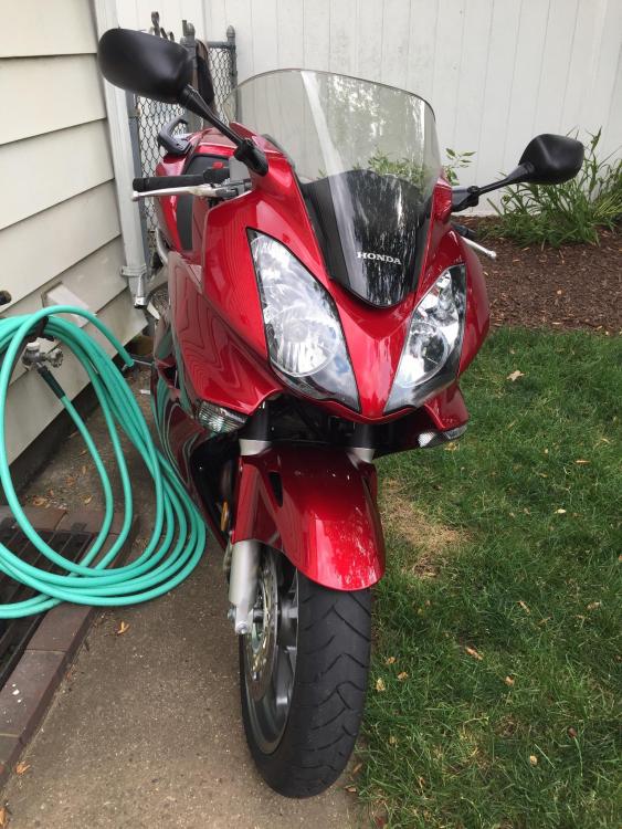

Member Contributer VARIABLE9 Posted June 11, 2018 Member Contributer Posted June 11, 2018 Or, My New 2007 VFR800A! Of course I wanted a 25th R/W/B but this red (what color is it called?) was so clean with low miles I didn’t want to pass it up. All the 25th’s were thousands of miles away, however my new ride was less than a hundred miles to go pick up. Purchased from Omni Powersports in Palm, PA, nice people and easy to transact with. The title showed first titled in 2009, first owner logged about 400mi, then 2011 second owner 3000mi, then 2016 the last owner just about 1100mi. Now mine with 4500mi, all stock except a fender eliminator (Competition Werkes?) and new tires (Battlax BT023R). In just a few days I’ve put a few hundred miles on and basically left wondering Why didn’t I get one of these before!? I may be new to VFR’s, but not new to motorcycling and not new to sport riding, roadracing, mx, woods riding, et cetera. My last MC was (still have it, hey now it’s for sale!) a 2006 Suzuki SV650 cafe/street fighter/backroad twisty tool that I loved building and tweaking on but somehow lost interest in because it couldn’t do the long miles and left me sore from the clip ons and seating position. So here’s to a new start and a new forum, and maybe some touring, and definitely some tweaking. On to the pictures! A new Shoei RF1200 has replaced my old Suomy Spec1R in the pictures, and some new relaxed riding gear is on order to replace my two piece AStars leathers. I won’t bore you with the suspension set up (that was first), but I already have some things on order and plan to update here as I go. RAM mount, power supply, cruise control, are first things first. 2 Quote
Member Contributer Dutchy Posted June 11, 2018 Member Contributer Posted June 11, 2018 Wishing you many happy miles with the redhead!! Quote
Member Contributer Grum Posted June 14, 2018 Member Contributer Posted June 14, 2018 That's a nice looking ride. Think the color is Candy Red. Enjoy. Cheers. Quote
Member Contributer Dutchy Posted June 14, 2018 Member Contributer Posted June 14, 2018 Candy will beg you to ride her often. Be prepared..... 1 Quote
Member Contributer Cogswell Posted June 15, 2018 Member Contributer Posted June 15, 2018 Hmmm - an '07 in Candy Red with ABS and 4,500 miles . . . I don't want to know what you paid for it - I'll start crying! Quote
Member Contributer VARIABLE9 Posted June 15, 2018 Author Member Contributer Posted June 15, 2018 On 6/11/2018 at 12:52 PM, Dutchy said: Wishing you many happy miles with the redhead!! On 6/14/2018 at 2:01 AM, Grum said: That's a nice looking ride. Think the color is Candy Red. Enjoy. Cheers. On 6/14/2018 at 2:07 AM, Dutchy said: Candy will beg you to ride her often. Be prepared..... Thanks all! A quick Bing of R101 says Candy Glory Red. It’s a beautiful color. Just some for scuffs on the seat cowl from the PO’s. Riding thus far has been ‘glorious’ indeed... Quote
Member Contributer VARIABLE9 Posted June 17, 2018 Author Member Contributer Posted June 17, 2018 On 6/14/2018 at 9:41 PM, Cogswell said: Hmmm - an '07 in Candy Red with ABS and 4,500 miles . . . I don't want to know what you paid for it - I'll start crying! This much: 1 Quote

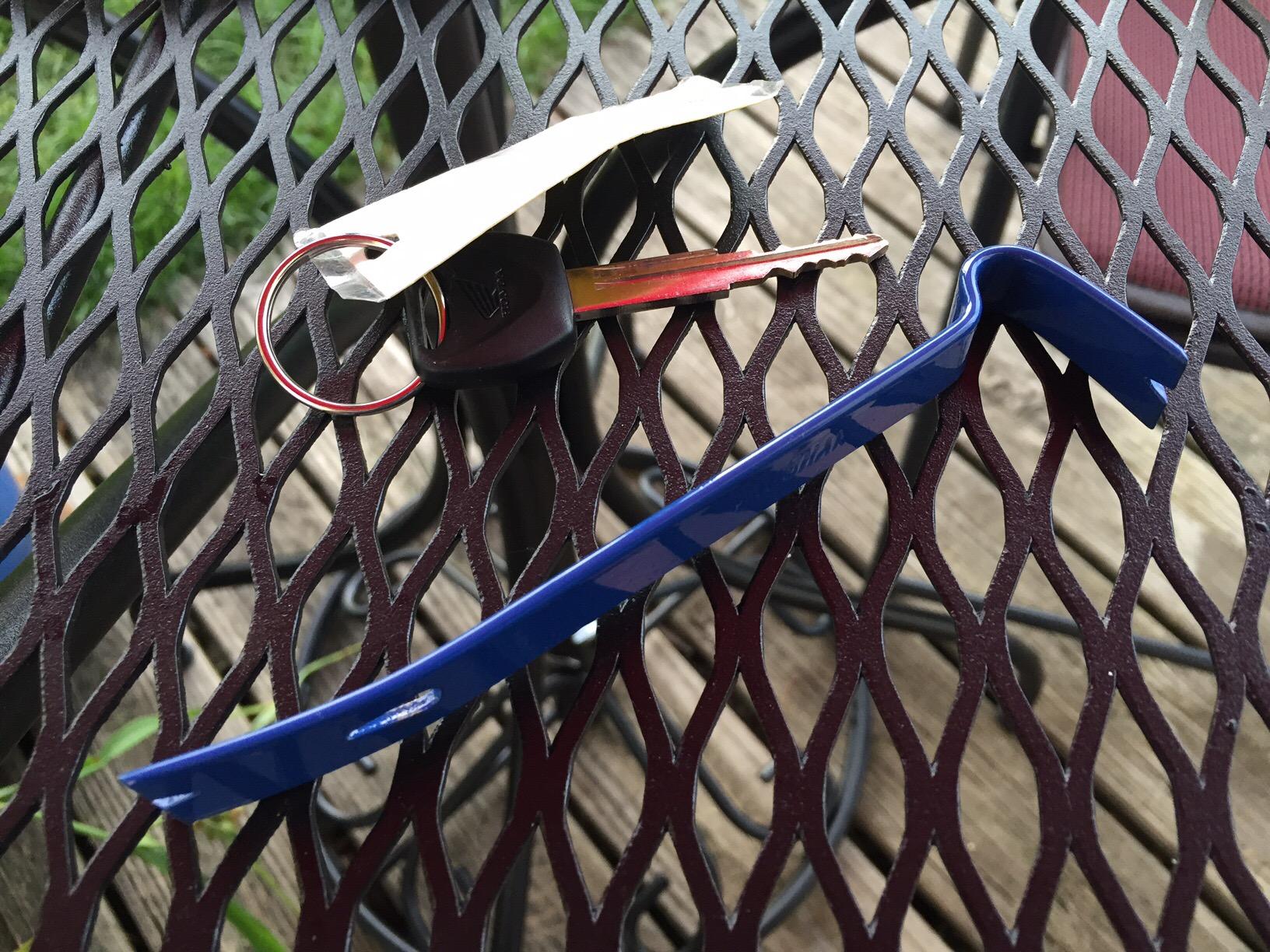

Member Contributer VARIABLE9 Posted June 17, 2018 Author Member Contributer Posted June 17, 2018 Here’s a quick tip for those wondering What tool to use to adjust front preload aka I need a huge screwdriver to turn these aka I don’t want to mar these adjusters up like an idiot.. 3 Quote
Member Contributer Grum Posted June 18, 2018 Member Contributer Posted June 18, 2018 Large screwdriver works fine. Just add a layer of masking tape over the tip. 1 Quote
Member Contributer Cogswell Posted June 18, 2018 Member Contributer Posted June 18, 2018 So does a Kennedy 1/2 dollar (apologies in advance to those outside the US). It's a perfect fit - great if you might want to change settings out on the road. Quote
Member Contributer VARIABLE9 Posted June 18, 2018 Author Member Contributer Posted June 18, 2018 17 hours ago, Grum said: Large screwdriver works fine. Just add a layer of masking tape over the tip. 15 hours ago, Cogswell said: So does a Kennedy 1/2 dollar (apologies in advance to those outside the US). It's a perfect fit - great if you might want to change settings out on the road. But then you wouldn't have a neato little prybar to add to your tool collection! And Cogs it's not just those outside the USA that wouldn't know a Kennedy half dollar. I doubt many millennials have ever seen one. Quote

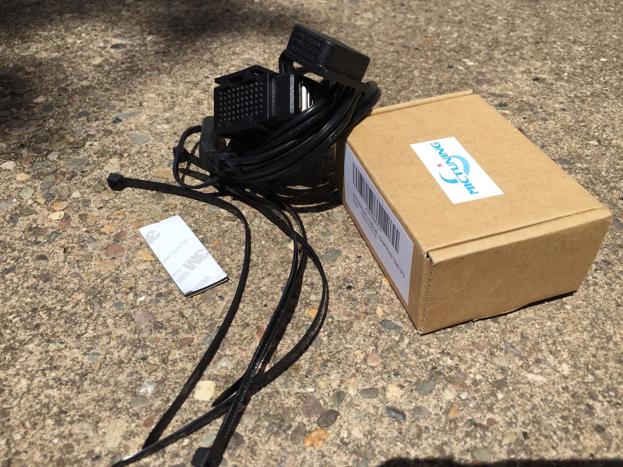

Member Contributer VARIABLE9 Posted June 27, 2018 Author Member Contributer Posted June 27, 2018 Installed a MICTUNING DUAL USB purchased from AMZN. It connects via SAE which will do for now, will be reconnected via fused 3CS Sealed which is pending delivery from Eastern Beaver. Need this to power a GPS and charge mobile for an upcoming trip + future use. Quote

headshrink Posted June 28, 2018 Posted June 28, 2018 16 hours ago, VARIABLE9 said: Installed a MICTUNING DUAL USB purchased from AMZN. It connects via SAE which will do for now, will be reconnected via fused 3CS Sealed which is pending delivery from Eastern Beaver. Need this to power a GPS and charge mobile for an upcoming trip + future use. I bought one of these a few years ago and it's still in a drawer, because I couldn't find a good way to mount it (also physically bigger than I expected). I never thought about doing it this way... sometimes simple is best! Quote
Member Contributer VARIABLE9 Posted June 28, 2018 Author Member Contributer Posted June 28, 2018 2 hours ago, headshrink said: I bought one of these a few years ago and it's still in a drawer, because I couldn't find a good way to mount it (also physically bigger than I expected). I never thought about doing it this way... sometimes simple is best! Yeah for under $10 I liked that I could easily mount without drilling or cutting. It clears the cluster and had plenty of cable so no problems full lock right. Give it a shot. Quote

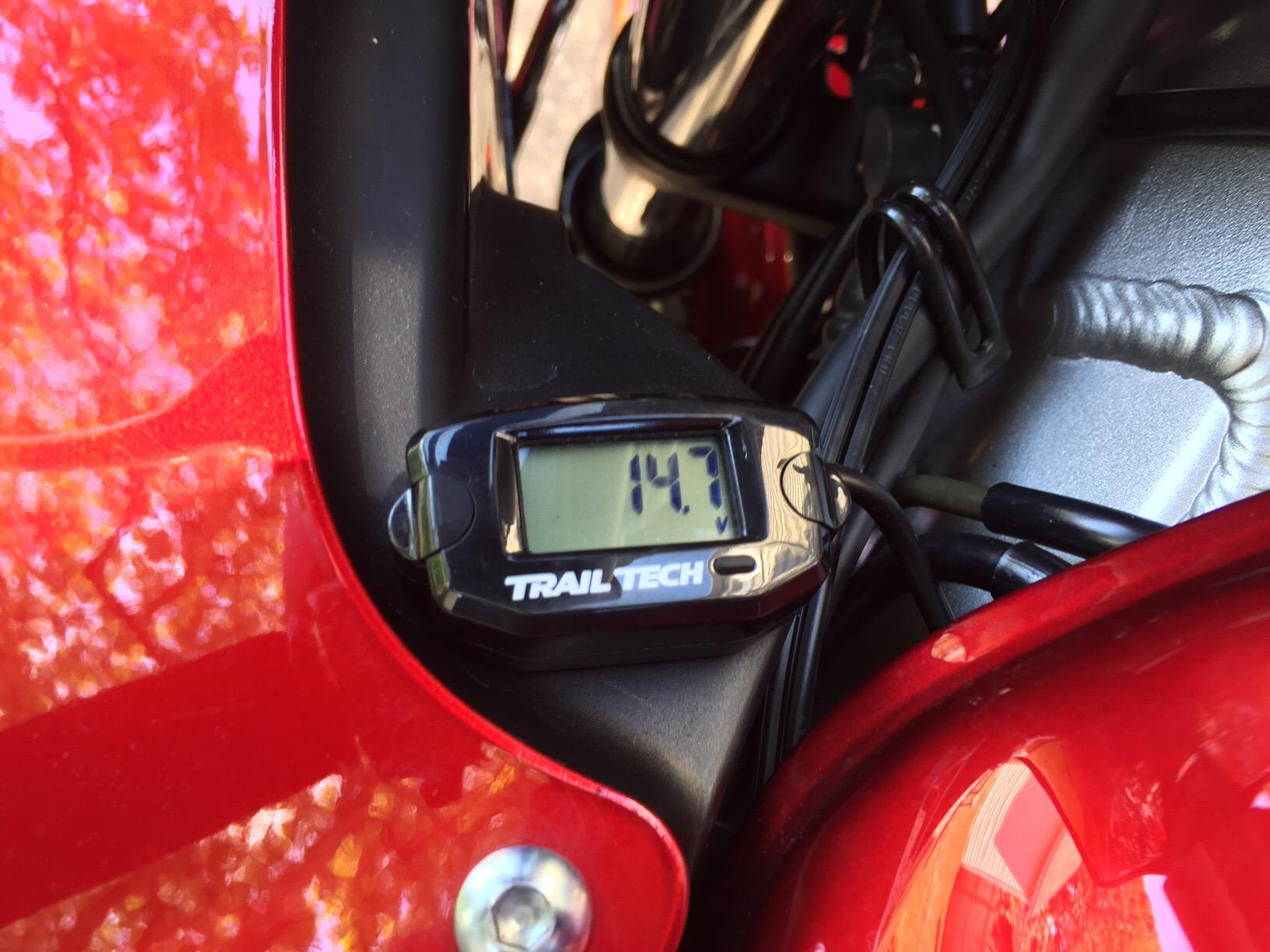

Member Contributer VARIABLE9 Posted June 28, 2018 Author Member Contributer Posted June 28, 2018 Wired up a TrailTech TTO-V voltmeter. Hitting 13.1 or so at idle, 14.7 to 14.8 under load. $45 via AMZN. This too is temporarily wired in through a SAE pending my 3CS from EasternBeaver. For now I can disconnect it to avoid parasitic draw when not using the VFR, when I finalize the wiring it will be on switched power. Quote
Urbanengineer Posted June 29, 2018 Posted June 29, 2018 I recently installed a voltmeter too but have no idea how to read it really. 13 at idle, 13.8-14.6 at running speed. What numbers are we looking for to Be bad? Quote
Member Contributer VARIABLE9 Posted June 29, 2018 Author Member Contributer Posted June 29, 2018 15 minutes ago, Urbanengineer said: I recently installed a voltmeter too but have no idea how to read it really. 13 at idle, 13.8-14.6 at running speed. What numbers are we looking for to Be bad? Others more qualified than I should answer this, but my understanding is good to monitor for the extremes like voltage spikes above 15v and dips down in the 12v’s. Those conditions may preclude a problem. The numbers in the range you listed are indicative of a more normal operating condition. The TTO I installed has a setting for the backlight to flash if the voltage drops or spikes out of a range that the user sets, but of course I haven’t done this yet. 2 Quote

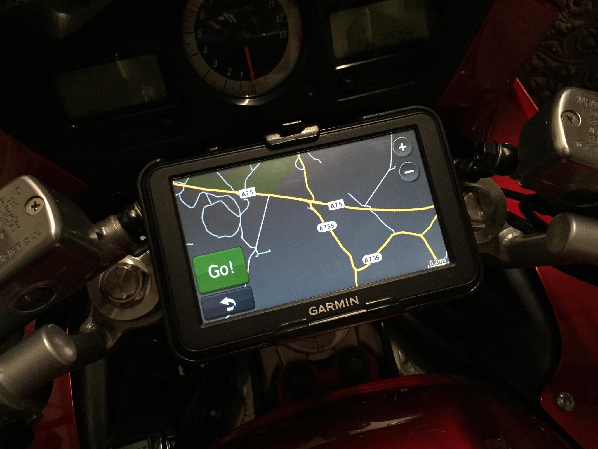

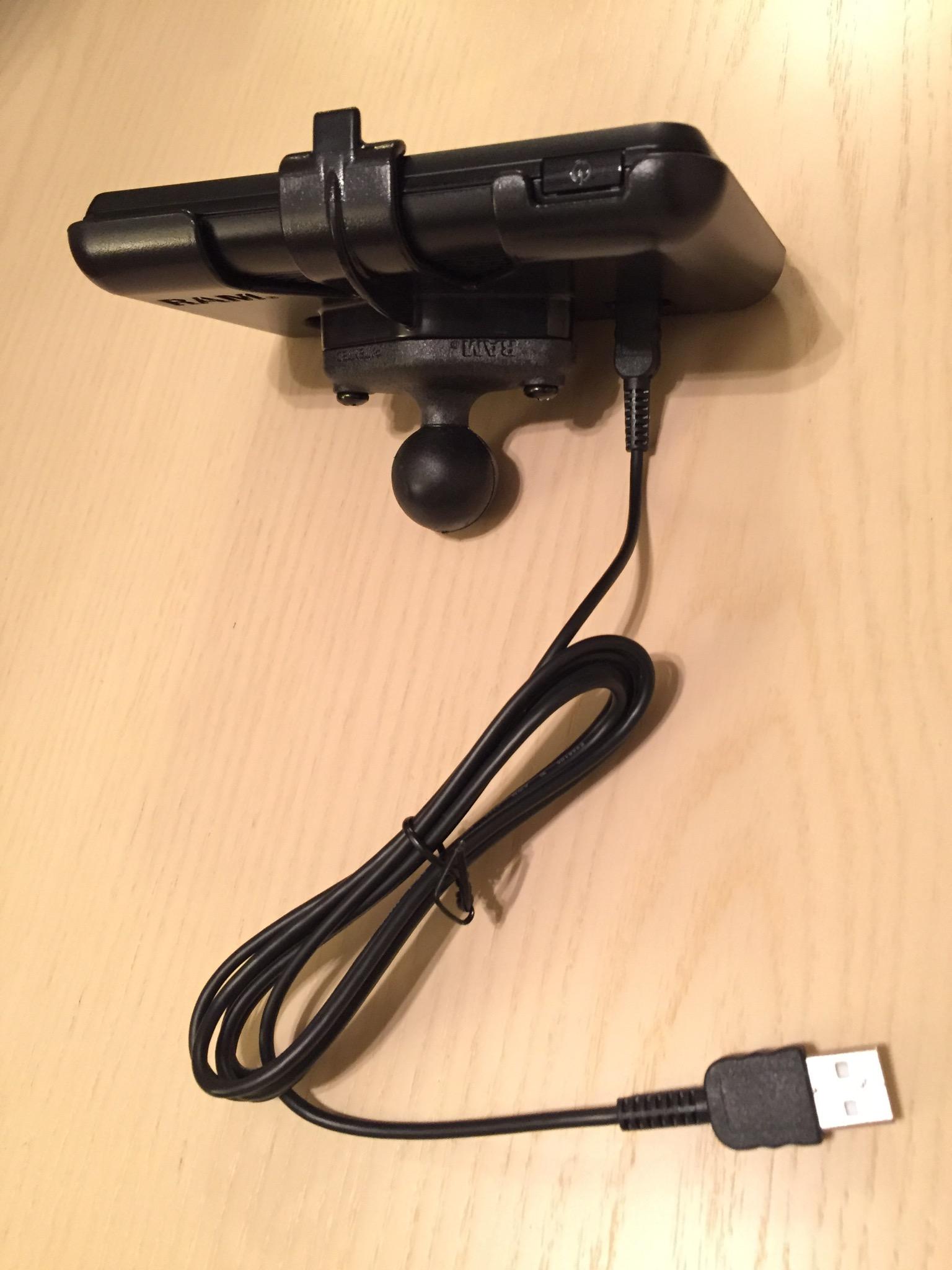

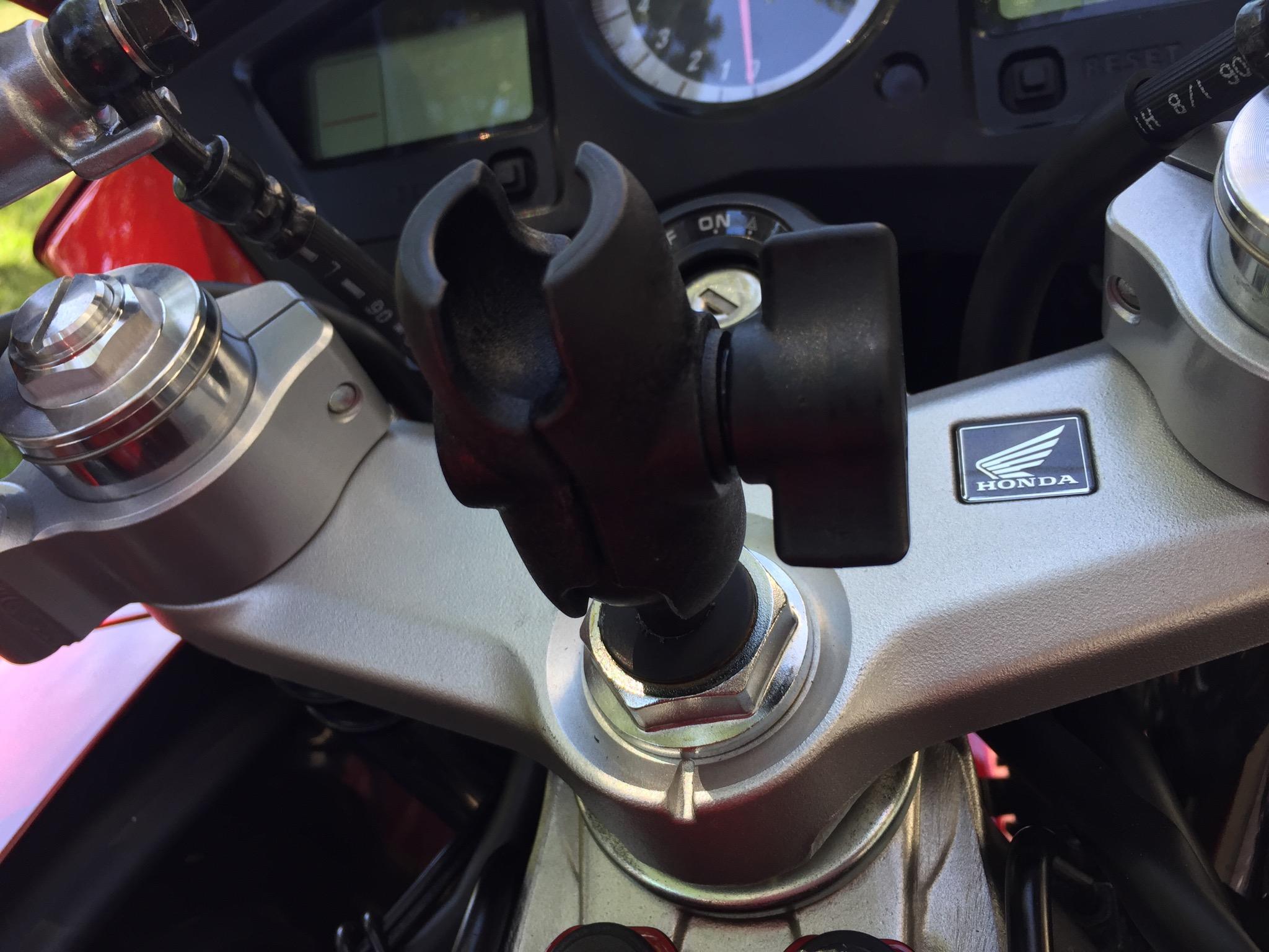

Member Contributer VARIABLE9 Posted July 8, 2018 Author Member Contributer Posted July 8, 2018 Installed Telferizer, RAM Mount, Garmin Nuvi. Didn’t care for the chrome/silver on the Telferizer so painted those parts (shaft and washer) of the mount flat black. May use a longer RAM double socket arm in the future, for now this length seems ok. Just about level with top of my current tank bag. Quote
