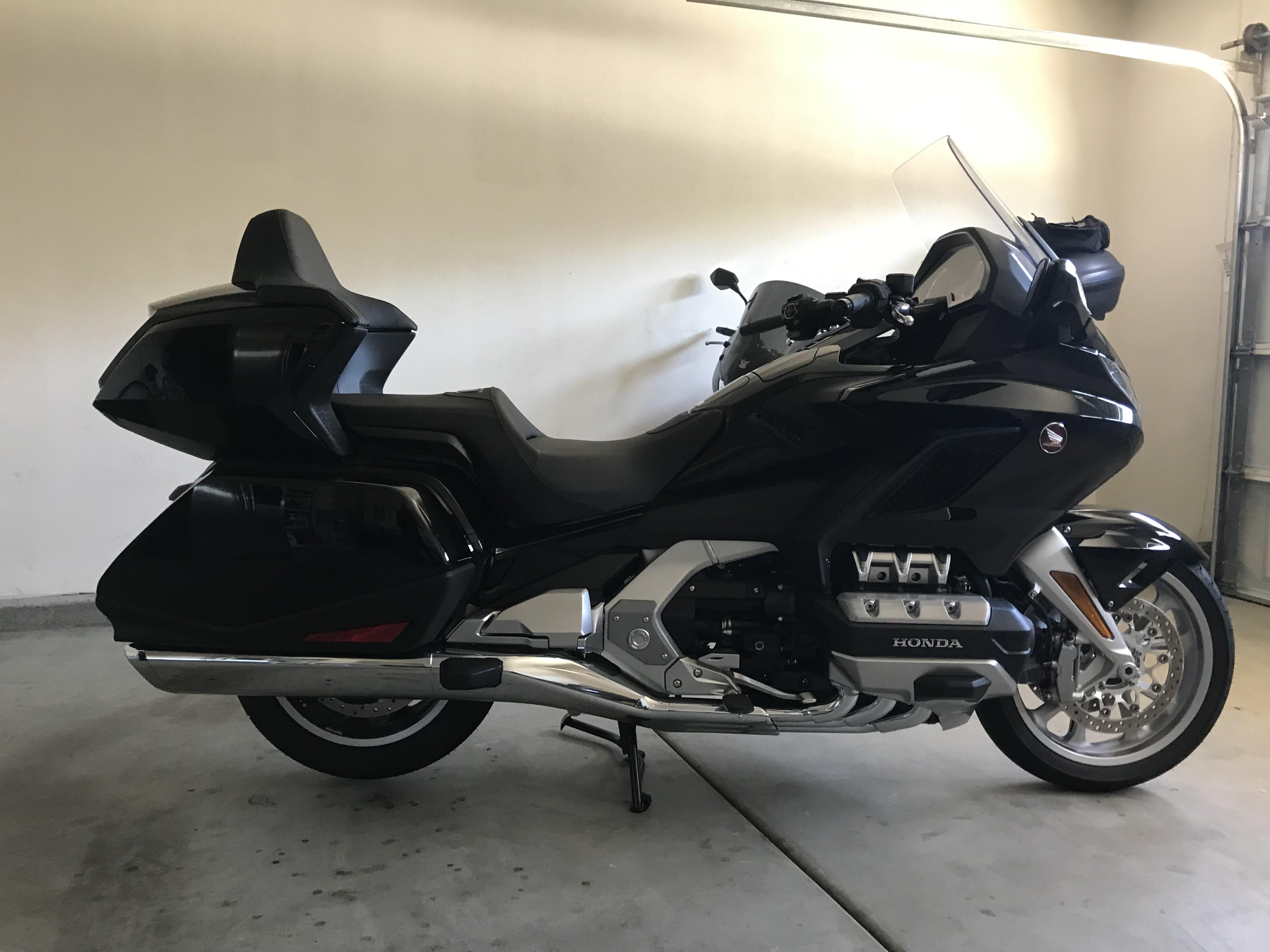

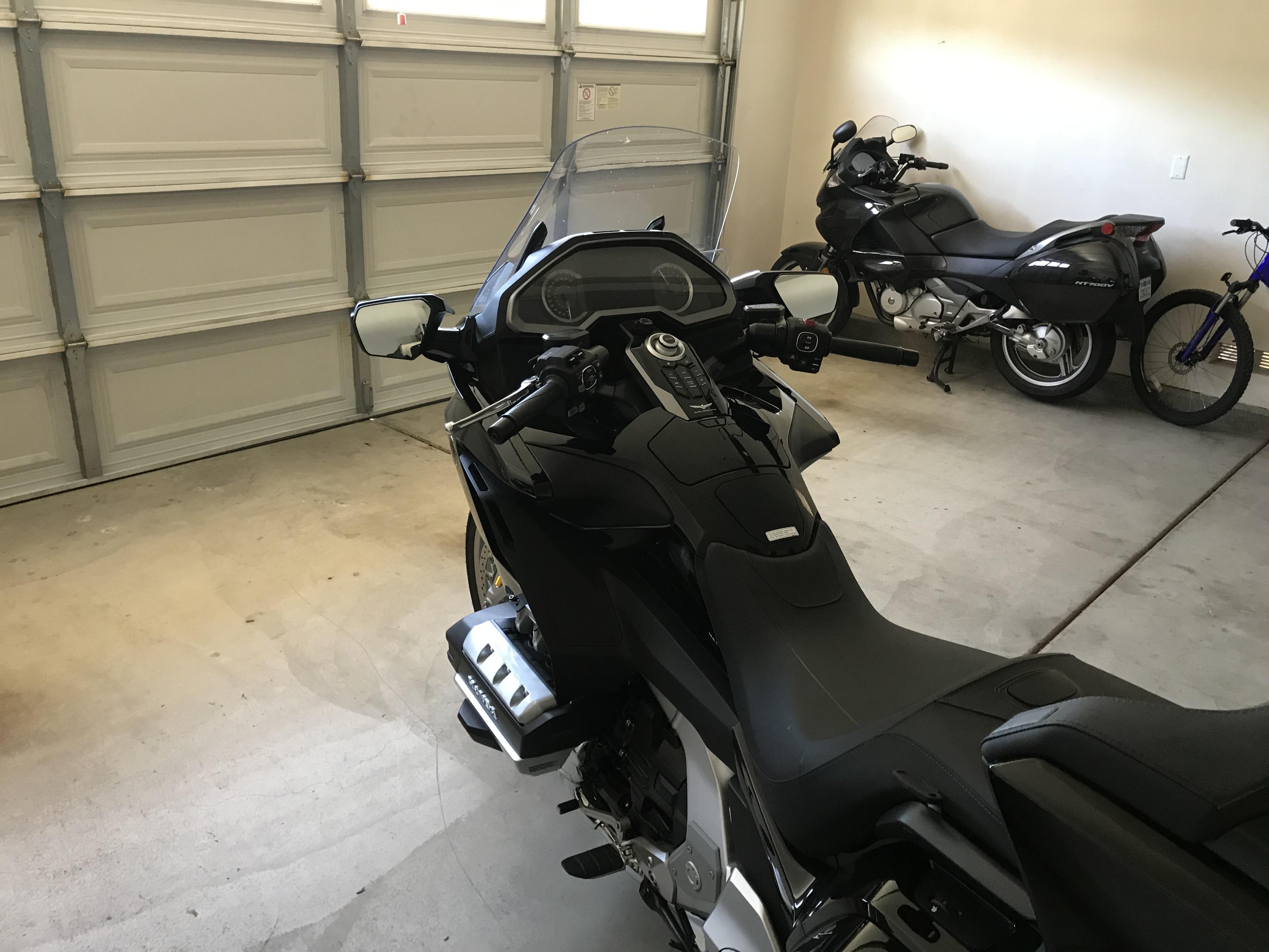

LEGEND Posted April 5, 2019 Posted April 5, 2019 Since the last attempt of bleeding my brakes and syncing starter valves ended with me and my buddy drinking heavily and hoping for the best so this time around I went to my local Honda Powersports dealer. Long story short I don’t think my vfr ran this well when it was new! All of the low end light switch throttle snatch is gone and the bike naturally idles much smoother. The braking is much improved with a nice firm lever and pedal and the clutch is so much smoother to engage. The surprise was was not the service bill but the owner of the shop who rolled out a new 2019 goldwing when I jokingly asked about borrowing one to get home. No joke he went over the features quickly and I was off on a “go have fun” ride. Large and in charge, the thing was rediculously comfortable and pretty damn fast, the torque was immense and the new front end simply works. Well balanced and easy to ride, within a few miles I was comfortable with the size and enjoyed playing music and with that big six. I tried to be a bit respectful to the new bike with 65 miles on it but I sampled enough to make me a believer. The strong brakes and reverse make managing the big bike easy and the bike felt like the flagship model it is. Very nice, so glad I got to scratch that itch. I took it home so my wife could take a look and she approved of the bikes comfort and it was a great test ride and all but I don’t tour nearly enough to justify anything so expensive. Fantastic machine that one day I could see owning when I’m retired and have time to take off to look for America. As excited as I was about riding the wing I’m more excited that my bike is back to its sweet v4 self. I took a pic of the WING sitting in my garage..... 1 1 Quote

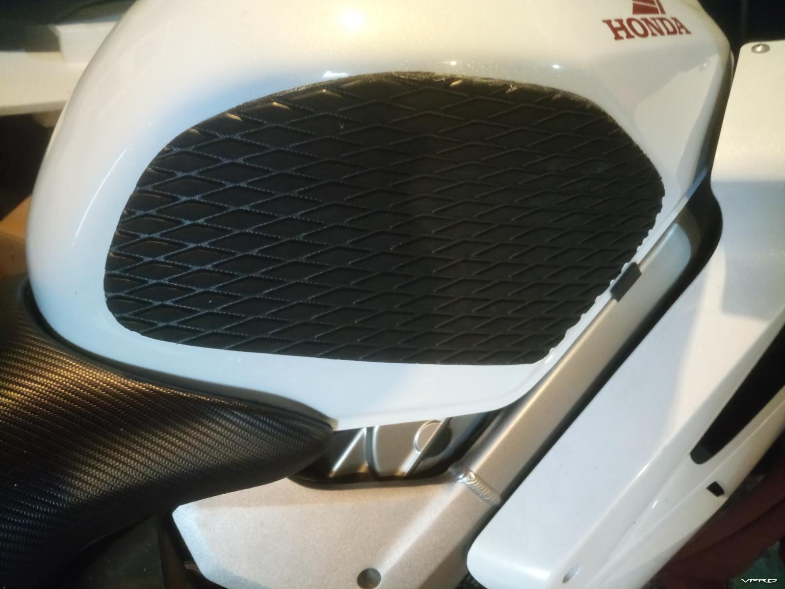

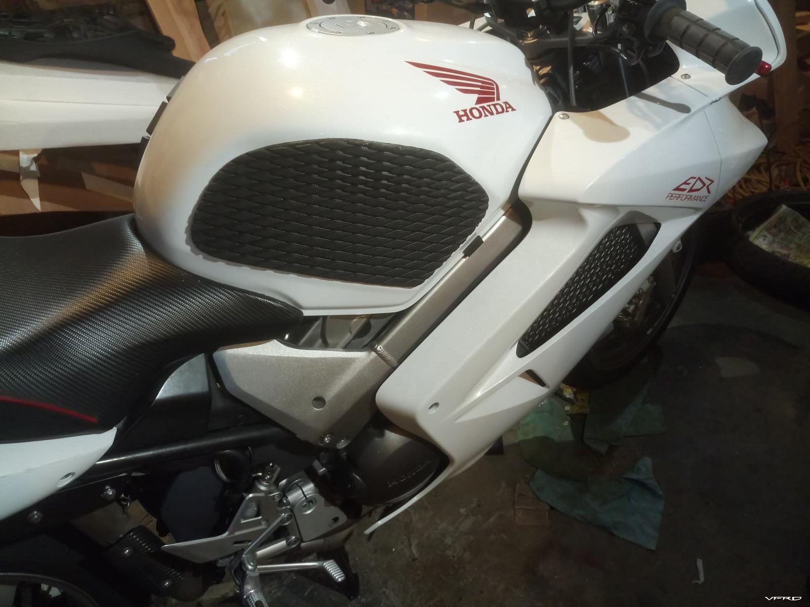

Member Contributer Marvelicious Posted May 26, 2019 Member Contributer Posted May 26, 2019 100% custom. I didn't like any of the pre-cut options: I wanted something that followed the body lines, and I really prefer to make my own stuff whenever I can. I worked a little in a body shop back in the day and I picked up a lot of little tricks for this kind of stuff. The foam is actually Hydro Turf (mostly marketed to jet-skiers). I sketched out a template on posterboard, cut two mirror image pieces and smoothed up the edges with sandpaper. To attach them, I used 3M headliner adhesive - designed to make foam stick to metal. If works excellent if you follow the directions... clean everything beforehand with alcohol, do it on a hot day, or use a little forced air heater to preheat the metal like I did... I bought a bunch of cheap magnets from Harbor Freight, pre-placed the pads how I wanted them with the magnets and then went around the perimeter with masking tape and masked off all around. Sprayed the tank and the back of the pads with the 3M, and then used the masking tape perimeter to line them up just how I had them. The down side to the headliner adhesive is that it's a contact cement, so you get one shot at getting it right or you're basically just going to have to clean it all up and start from scratch. I used the magnets to hold them tight and give the adhesive time to cure. After that, cleanup was mostly just a matter of peeling the masking tape. I'm really happy with how they look and how they work. 1 Quote

duccmann Posted May 28, 2019 Posted May 28, 2019 100% custom. I didn't like any of the pre-cut options: I wanted something that followed the body lines, and I really prefer to make my own stuff whenever I can. I worked a little in a body shop back in the day and I picked up a lot of little tricks for this kind of stuff. The foam is actually Hydro Turf (mostly marketed to jet-skiers). I sketched out a template on posterboard, cut two mirror image pieces and smoothed up the edges with sandpaper. To attach them, I used 3M headliner adhesive - designed to make foam stick to metal. If works excellent if you follow the directions... clean everything beforehand with alcohol, do it on a hot day, or use a little forced air heater to preheat the metal like I did... I bought a bunch of cheap magnets from Harbor Freight, pre-placed the pads how I wanted them with the magnets and then went around the perimeter with masking tape and masked off all around. Sprayed the tank and the back of the pads with the 3M, and then used the masking tape perimeter to line them up just how I had them. The down side to the headliner adhesive is that it's a contact cement, so you get one shot at getting it right or you're basically just going to have to clean it all up and start from scratch. I used the magnets to hold them tight and give the adhesive time to cure. After that, cleanup was mostly just a matter of peeling the masking tape. I'm really happy with how they look and how they work. Man great job, wish you lived in LA I’d love some help making some.Sent from my iPhone using Tapatalk Quote
