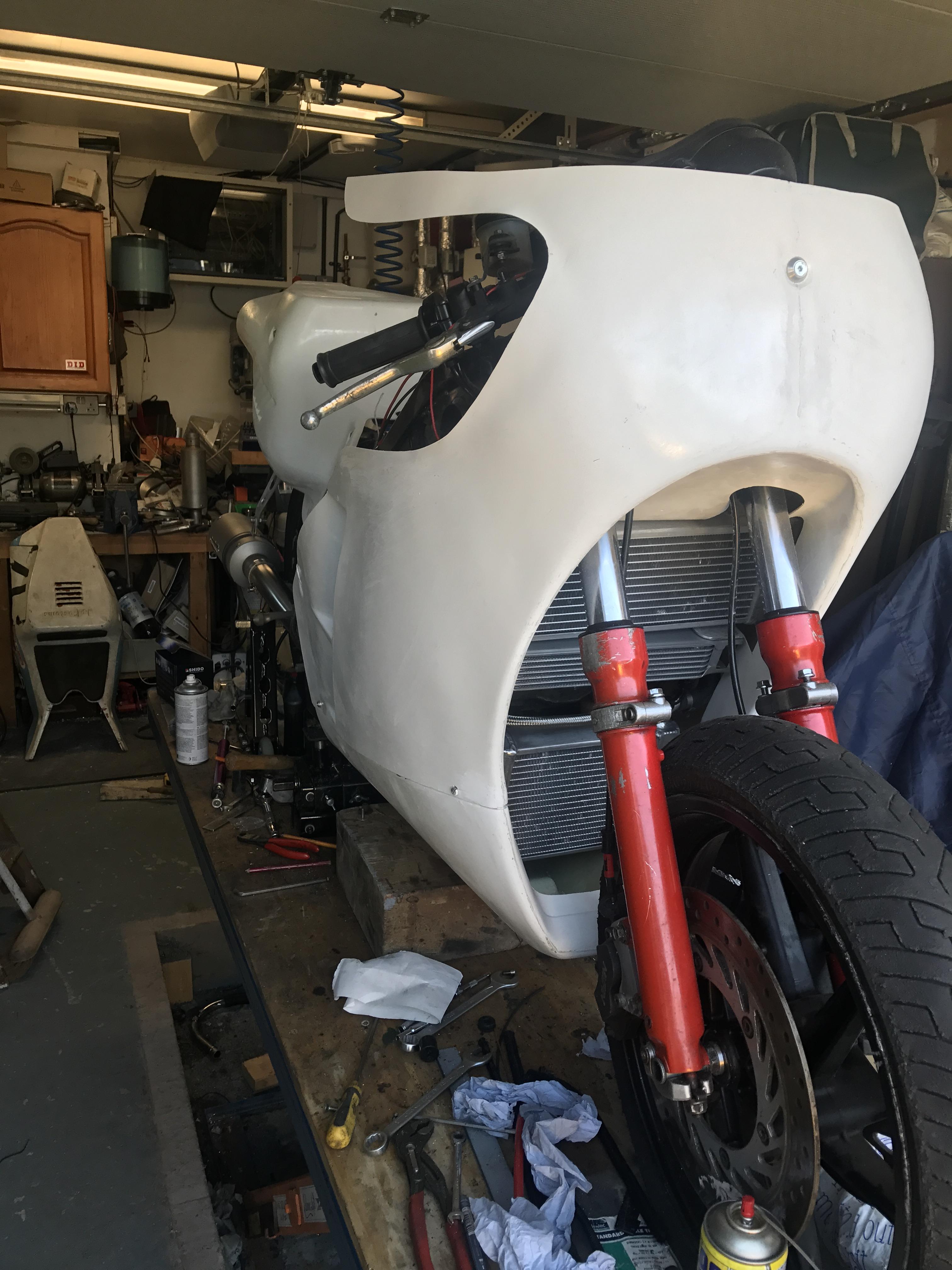

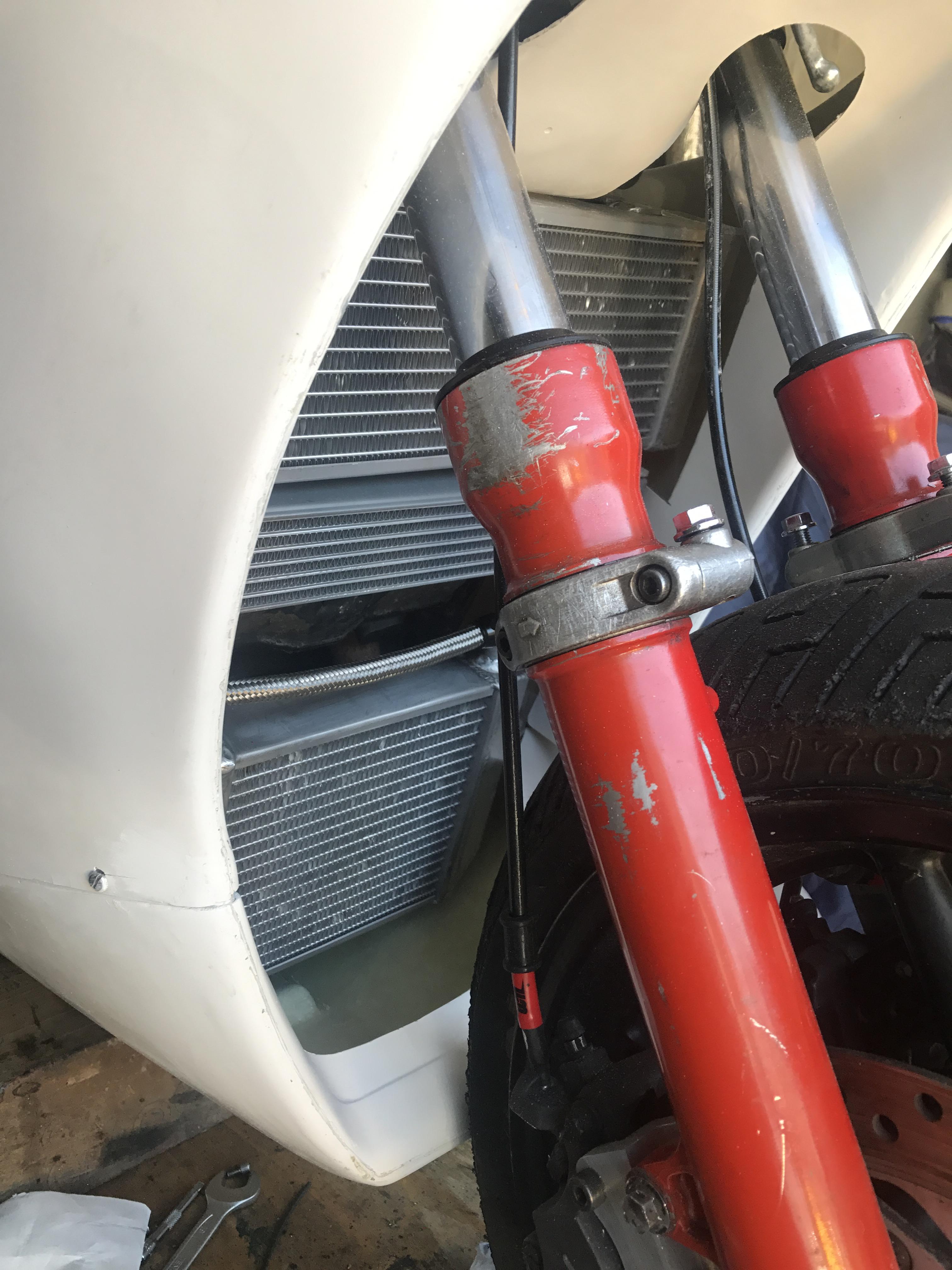

trooper1999 Posted September 29, 2018 Author Posted September 29, 2018 Sorry guys been a while but I've just collected a few new bits, starting to fit but here's a couple of picks of the first fitting 1 Quote

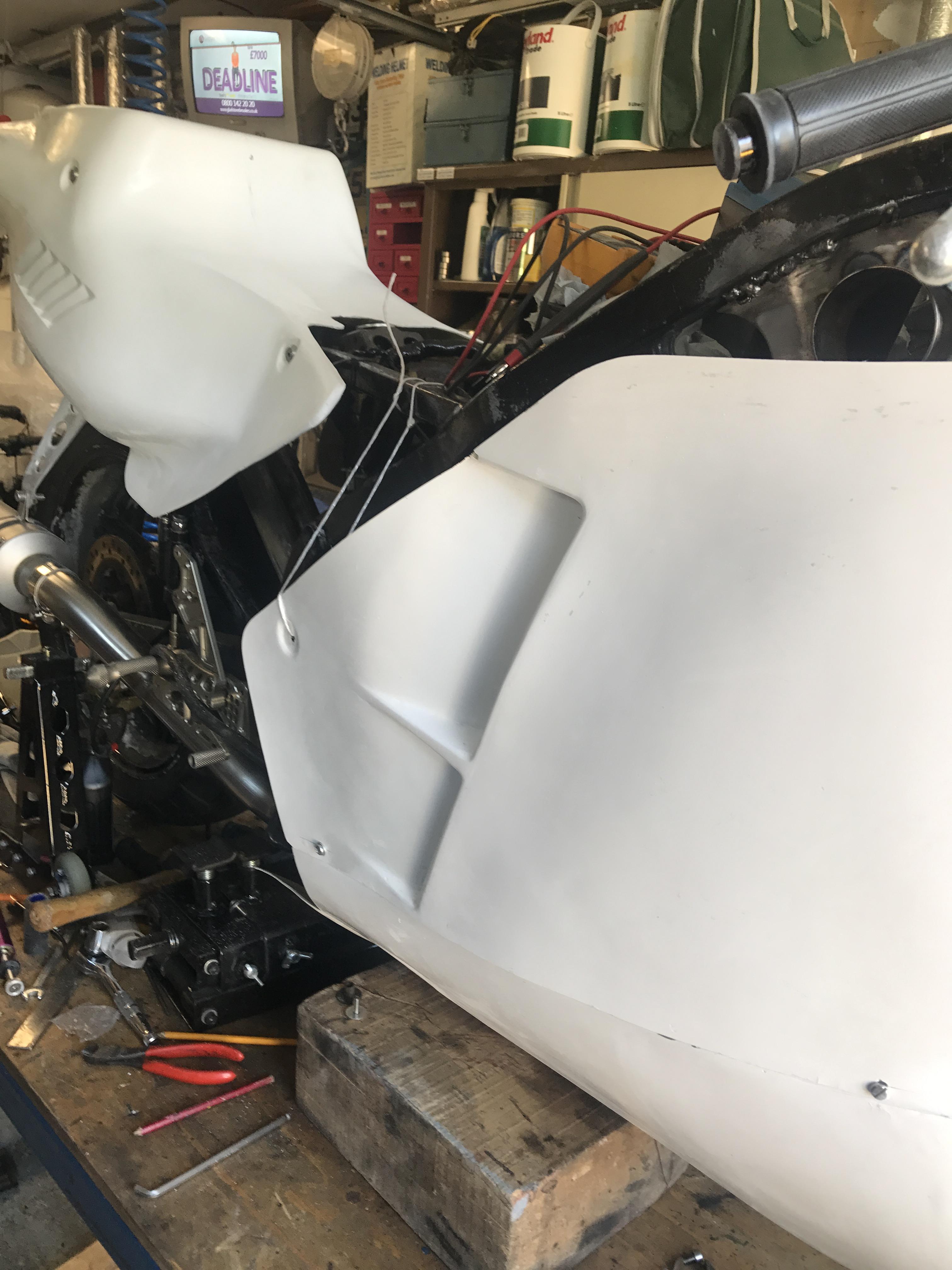

trooper1999 Posted September 29, 2018 Author Posted September 29, 2018 The body work is a copy of the original RS850 parts, I managed to get a set from a guy who has 2 RS's and have had a set of moulds made so I'm now the owner of a correct set of body work, all I have to do is get them to fit better. I have done the seat and opened out the hole for the rear silencer so that's done, been trying to get the fairing to fit this morning, but it's been on and off, cut a little, refit, and then start it all again, it must have been on and off about 10 times today, trying to get it in the correct position before I make the mounting brackets, oh the joys of making a bike. Quote

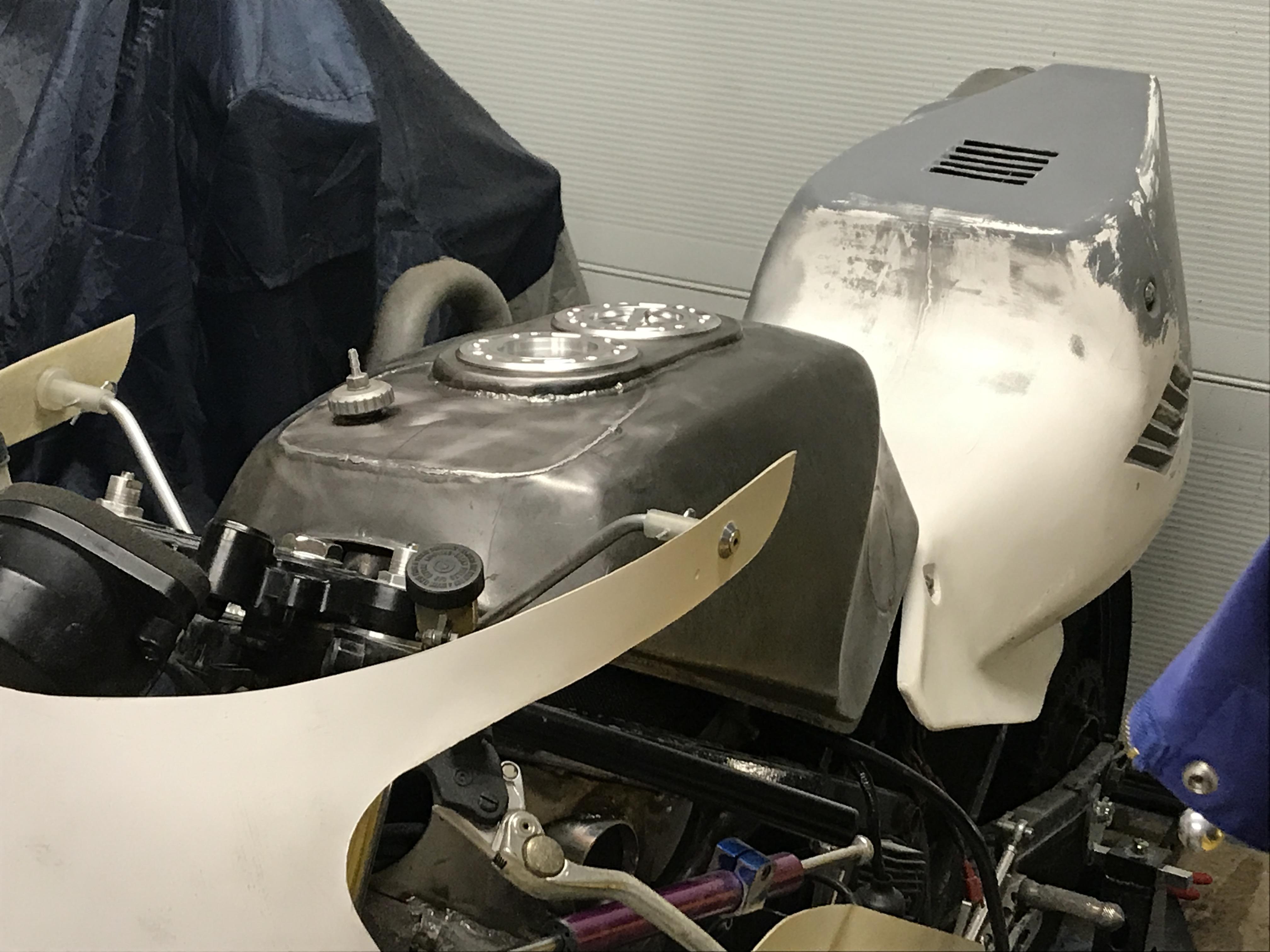

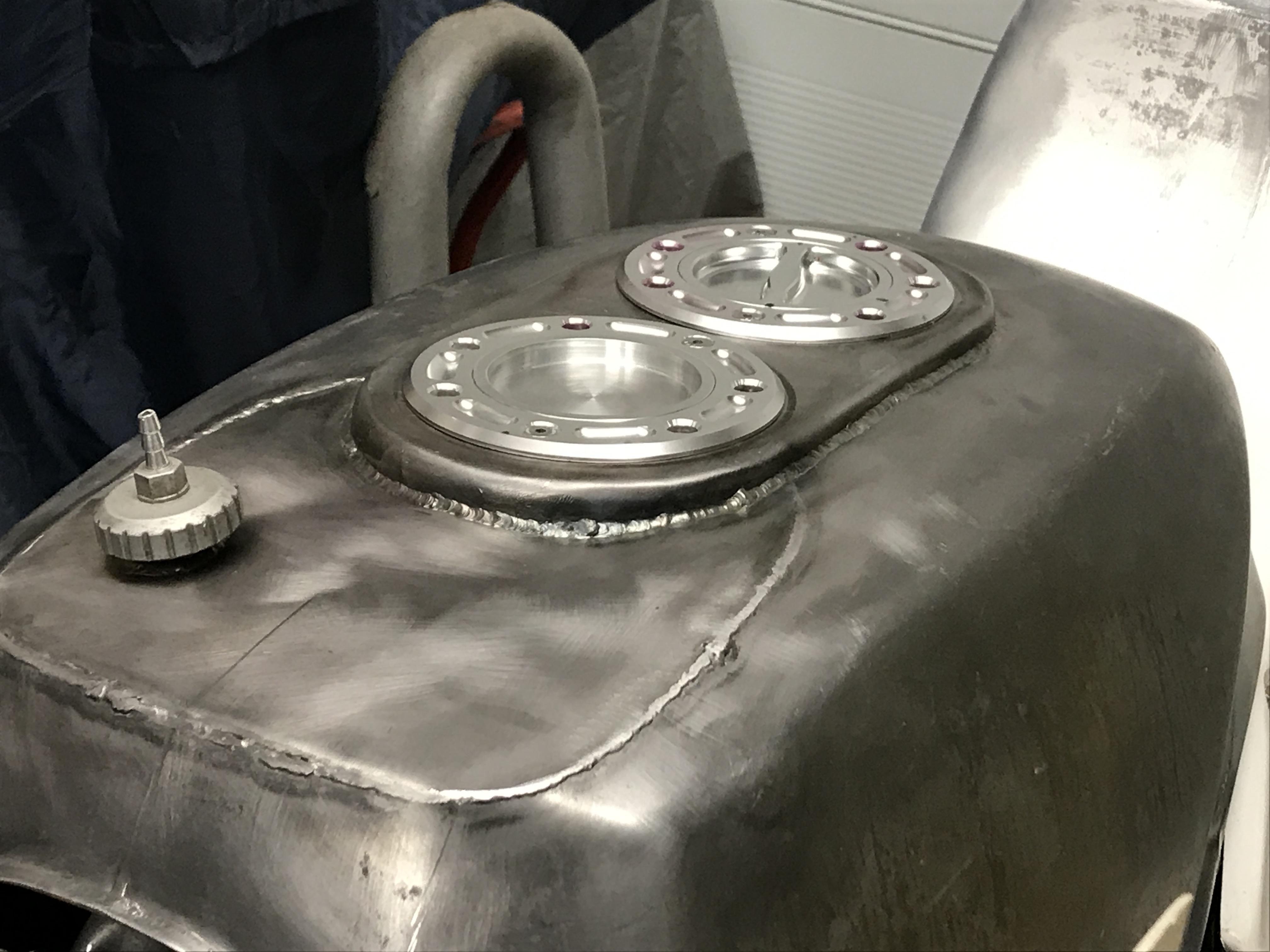

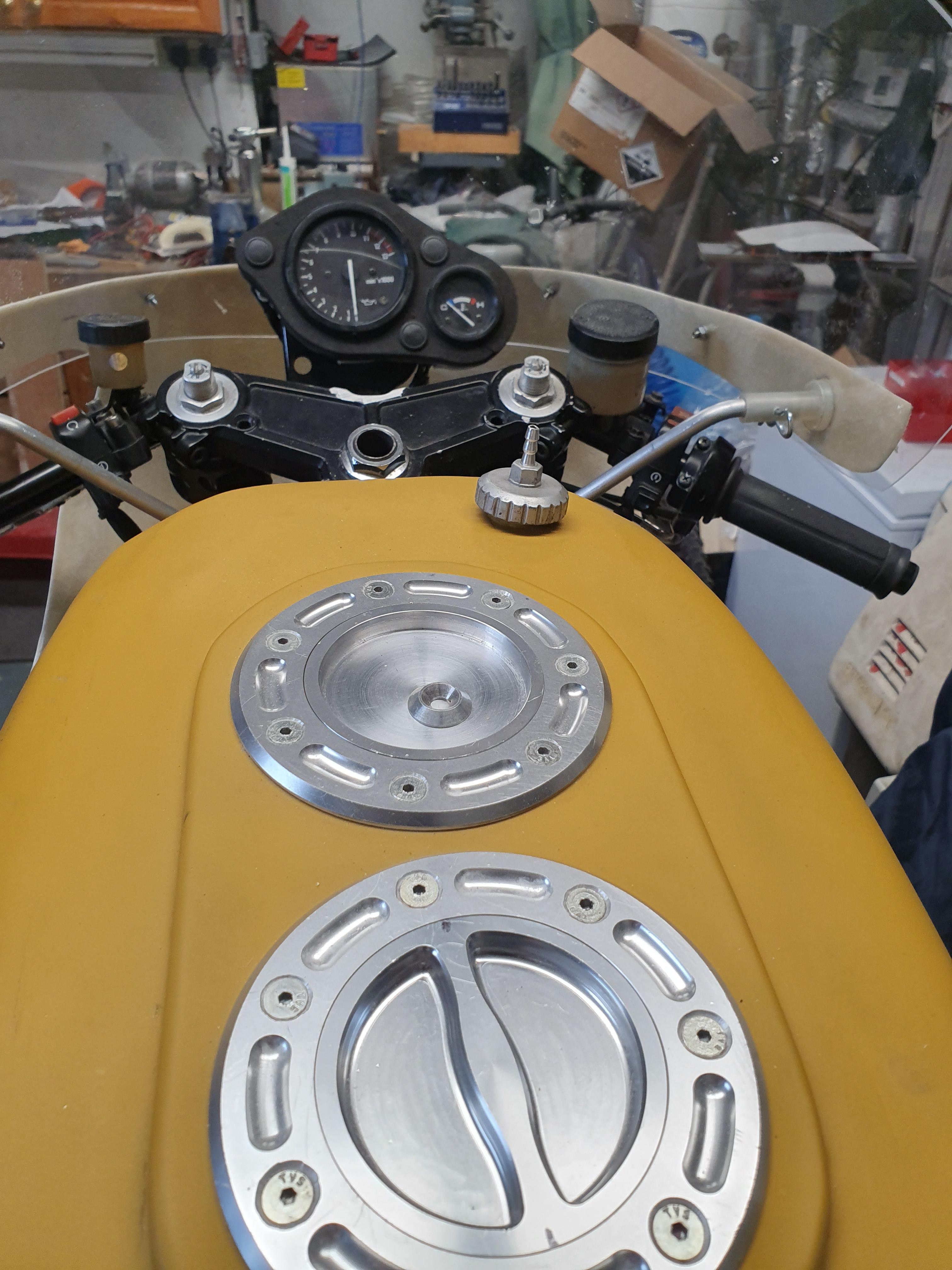

trooper1999 Posted January 28, 2019 Author Posted January 28, 2019 Hi All, Today's been a good day, had a phone call to pop a couple of towns away to collect a interesting part from a metalworking GOD, just got home and co uldn't wait to trail fit it, He has cut and welded the VF750 tank removing the mass of pipework that is the standard fuel tap and filled the hole, he then cut off the original filler cap and made a twin filler setup, I got two alloy filler caps (from a Kawasaki I think) for the endurance look, he also fitted a VFR400R tank breather,.What do you all think? Quote

trooper1999 Posted January 28, 2019 Author Posted January 28, 2019 So you think I've got the right sort of look then? A few other bit I've been on with:- Battery box made and mounted on left hand side of engine, remounted starter solenoid along side battery box. A pair of ruff fairing side mounting brackets along with finished top fairing bracket. Fitted VTR1000 fork stantions and internals to VF1000r bottom legs. Vents cut out into seat unit and started to prime and fill any little imperfections. Cut up the standard VFR airbox to use the mesh part at the base. I'll try and get some more photo's over the next few weeks Next job to get the fuel pump mounted and wiring alterations finished. IS it 2019 already? Quote

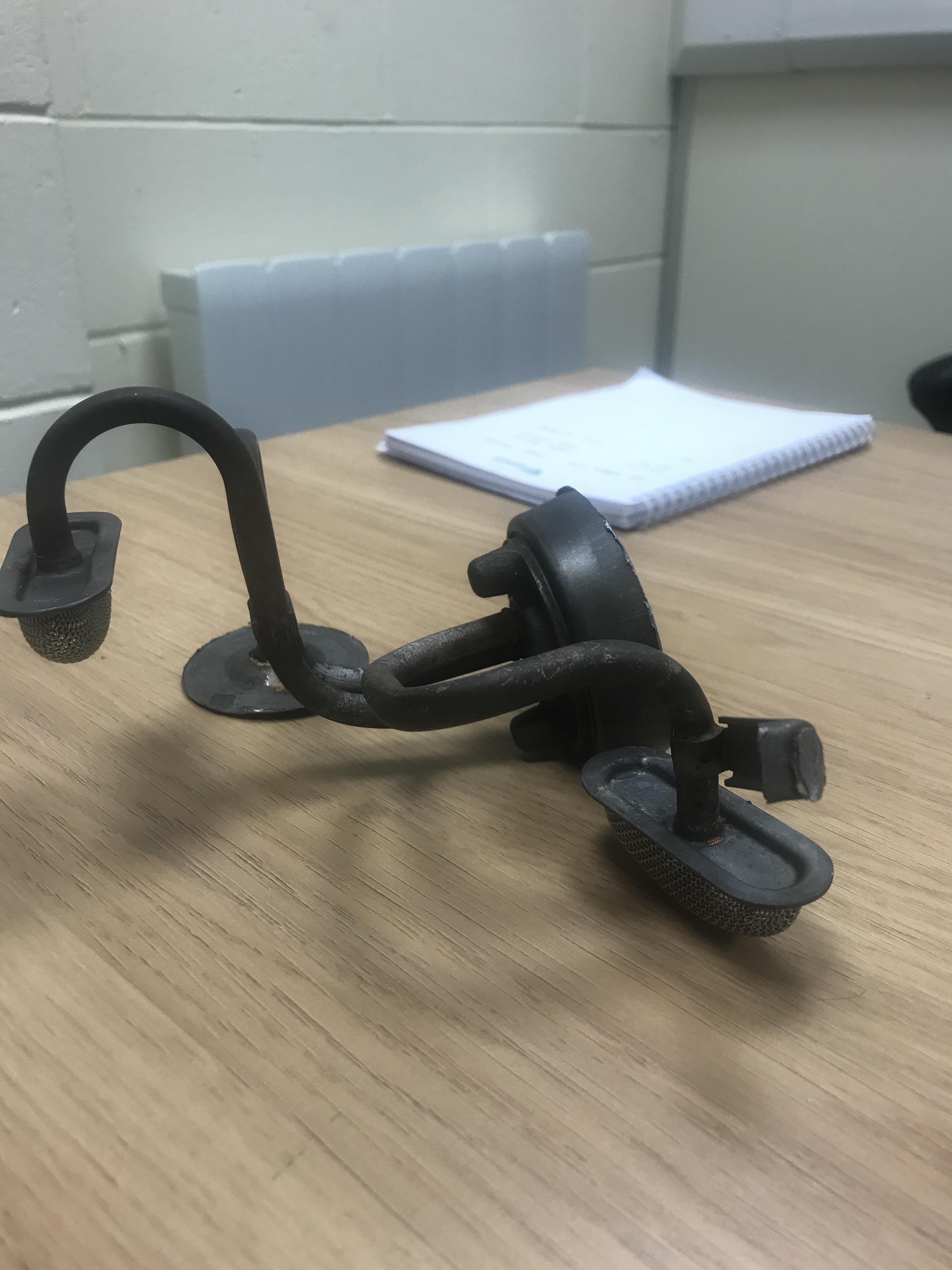

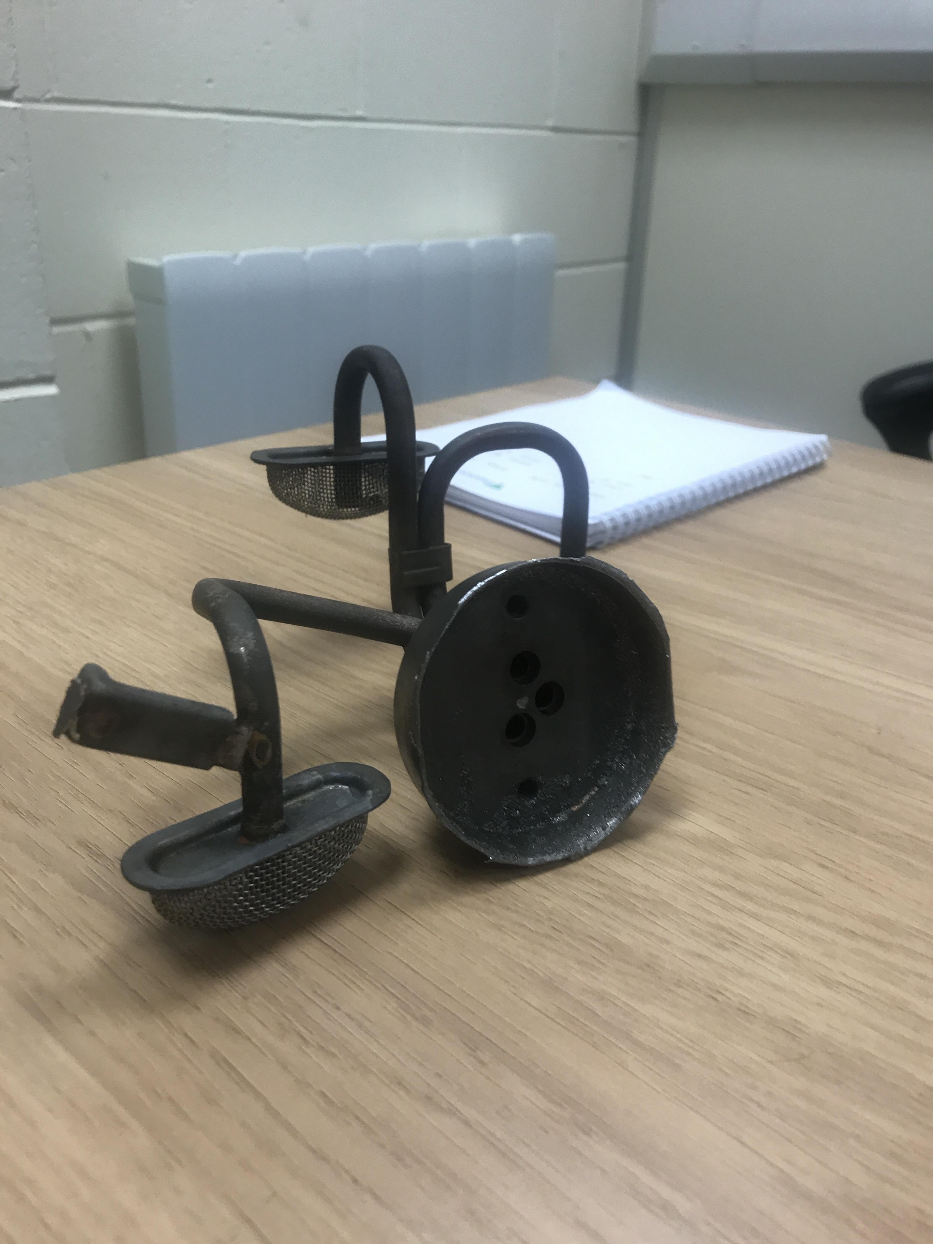

trooper1999 Posted February 1, 2019 Author Posted February 1, 2019 Not managing to get much done this week but have a look at what a proper fuel tap looks like, this array of pipe work has been removed from the VF750 fuel tank Quote

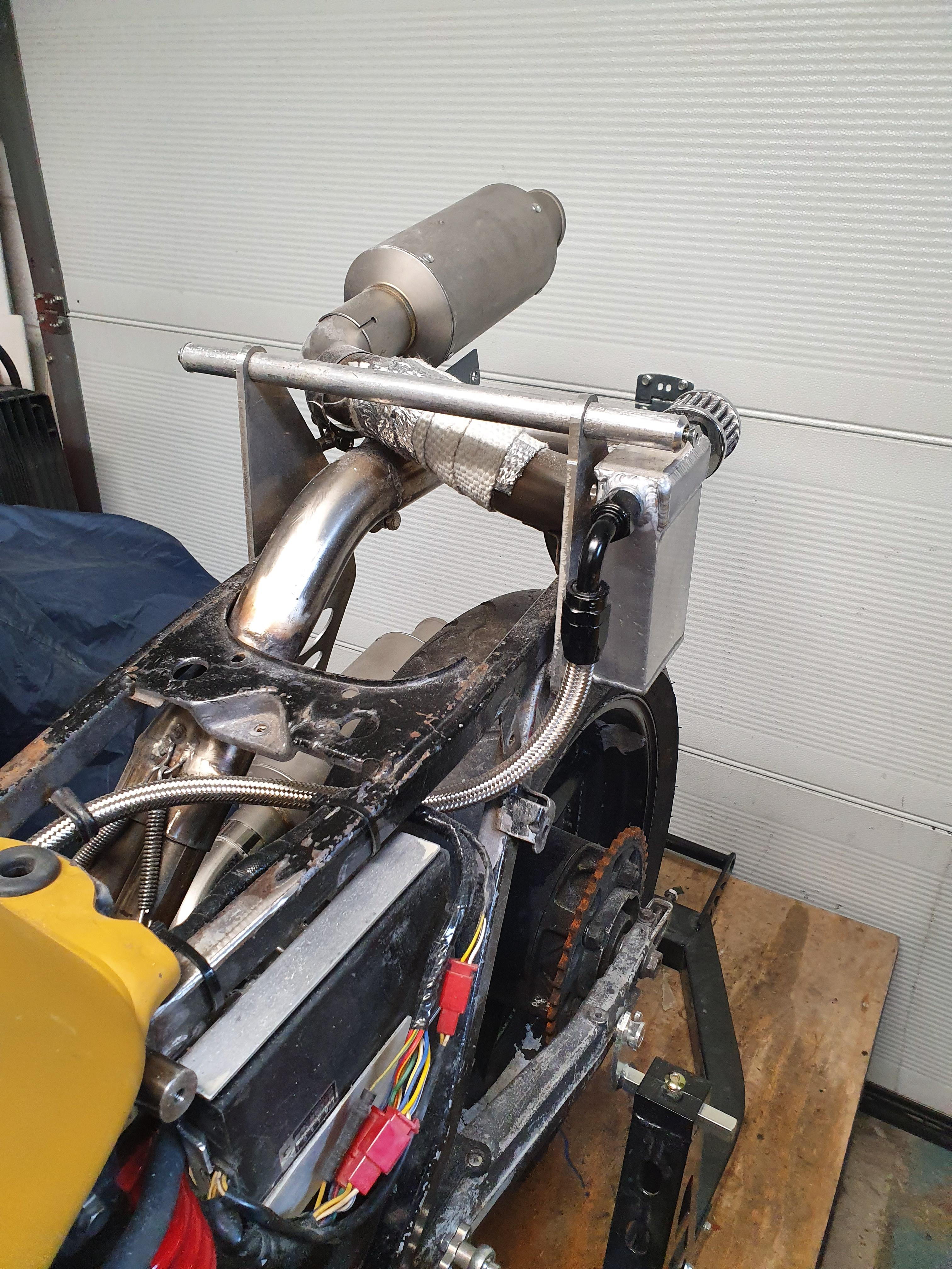

trooper1999 Posted May 2, 2019 Author Posted May 2, 2019 Just a little update, I've been busy with all the little things alterting a bike needs, ie the oil breather catch tank, alter the steering lock to reduce the amount of travel, trying to sort the screen, making the rear engine mount etc etc all little bit that take loads of time. I've sorted the guy who is going to paint it for me it should be with him in about a month so that's a big step, as soon as I get it back from him I'll get it apart for powder coating and then start its final build. At the moment work and family are getting in the way but that's life. 1 Quote

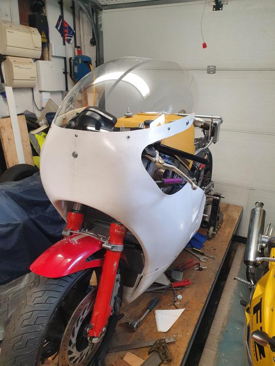

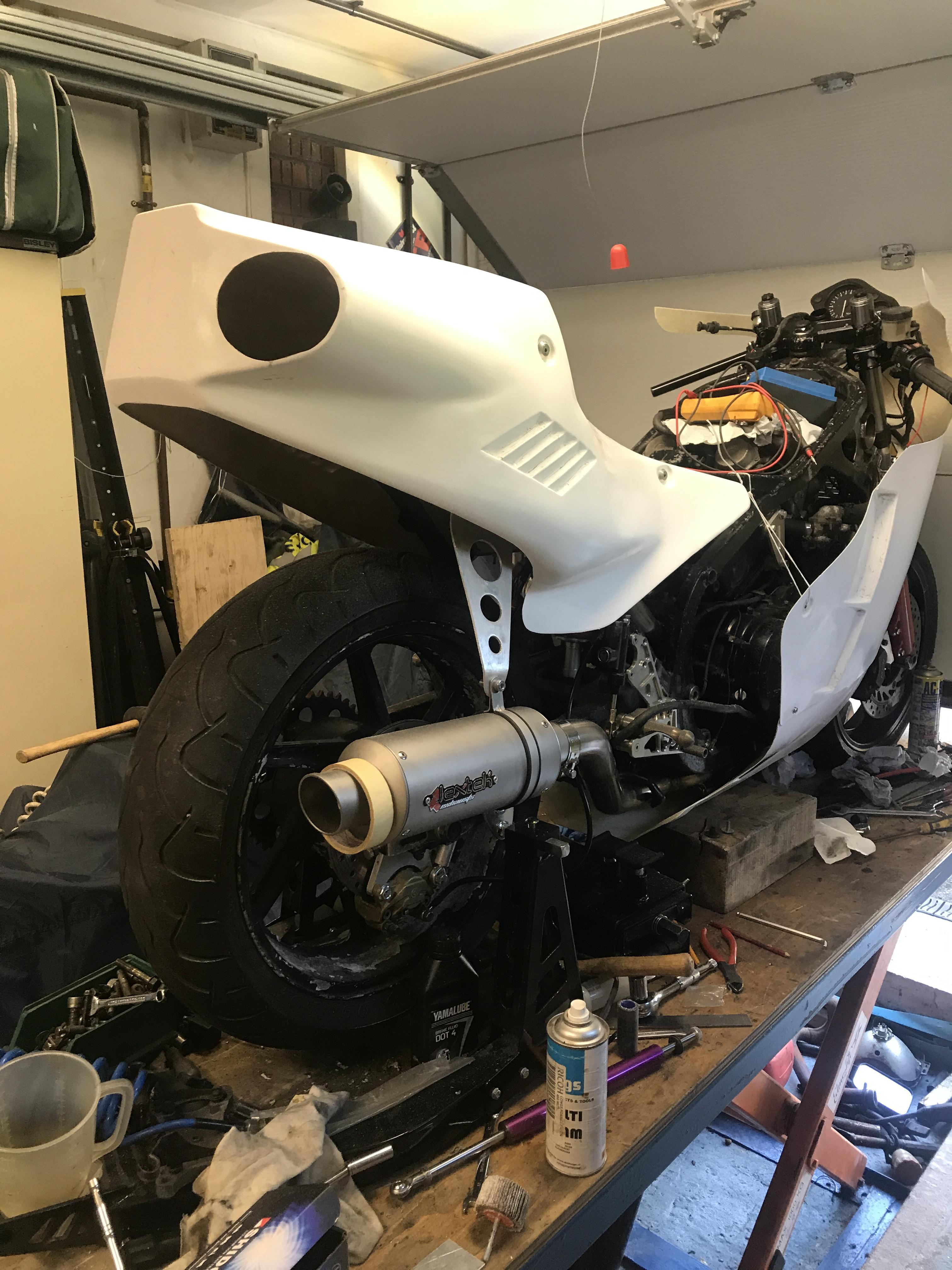

trooper1999 Posted June 2, 2019 Author Posted June 2, 2019 What could be better, just fitted the screen while listening to the TT practice on Manx radio. Thought you should have a few photos. Screen fitted but will need a little trim A photo with the seat off, you can see the rear exhaust and the new catch tank. The last one is a riders eye view 3 Quote

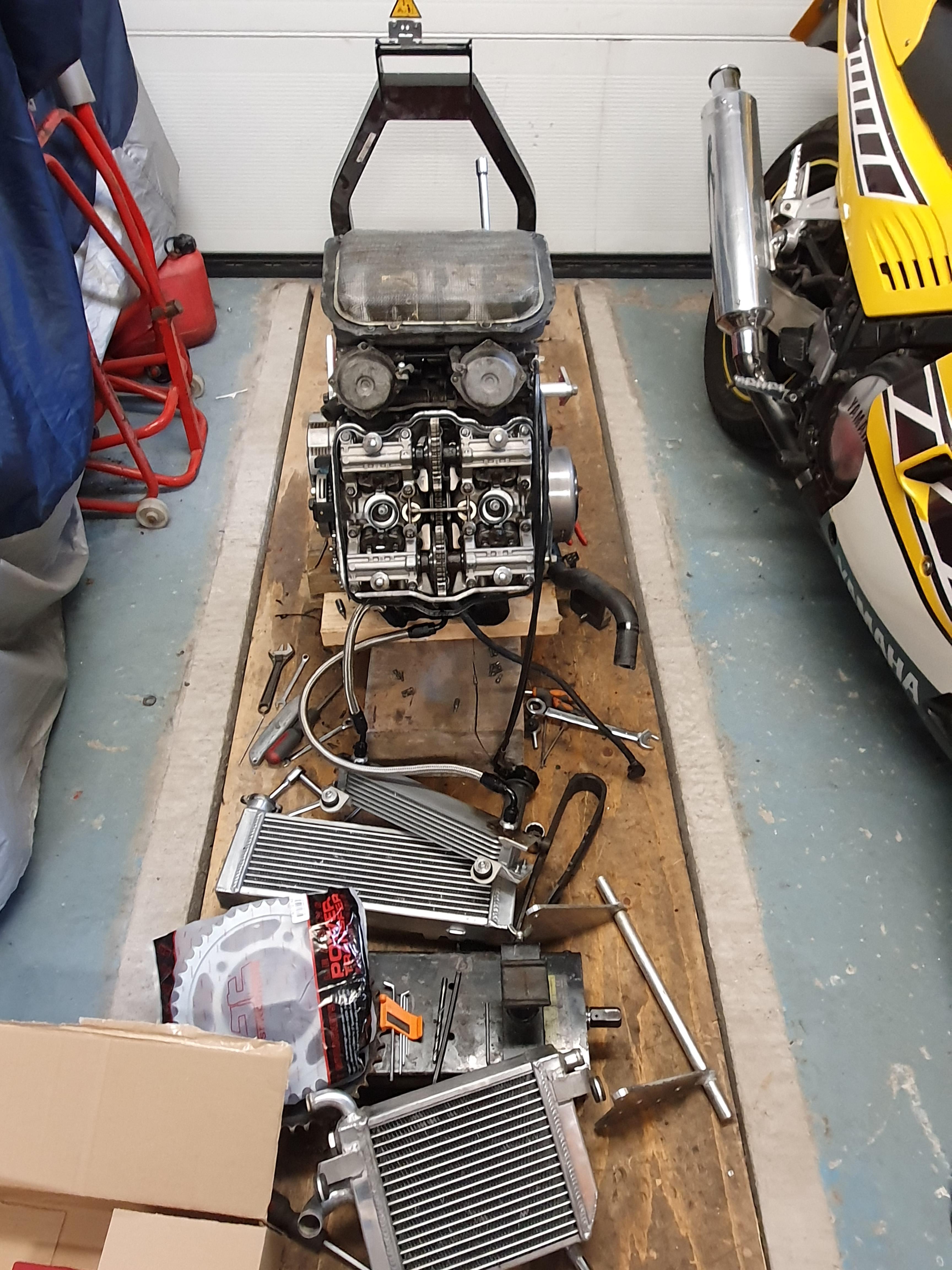

trooper1999 Posted July 11, 2019 Author Posted July 11, 2019 Not much left of my project now, the frame, wheels etc are at the powder coasters, various other bits are being aqua blasted, should be collecting them all on Saturday and then start the final build. Quote
