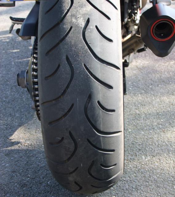

fatshoutybloke Posted March 23, 2016 Posted March 23, 2016 (edited) Here's mine at 3615 miles (T30 EVOs), not half-way to the wear marks yet. Edited March 23, 2016 by fatshoutybloke Quote
