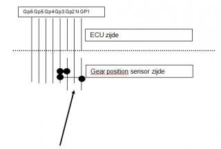

Dutchgixxer Posted October 12, 2010 Posted October 12, 2010 (edited) I have derestricted the 1st and 2nd gear power limitations. I have made a simple scematic : You will get falsh readings on the dash when 1st or 2nd gear are engaged. I am busy decoding the serial link between ECU and dash. To be continued Edited October 12, 2010 by Dutchgixxer Quote

Dutchgixxer Posted October 12, 2010 Author Posted October 12, 2010 (edited) I have derestricted the 1st and 2nd gear power limitations. I have made a simple scematic : You will get falsh readings on the dash when 1st or 2nd gear are engaged. I am busy decoding the serial link between ECU and dash. To be continued While this looks feasible in some respects, I would caution that unless you know what the I/O interface properties are, you may be violating circuit constraints which would then risk a blown sensor or worse. I offer the following scenarios: 1. Each output of the GPS is an open drain that is asserted Low (or simply grounded) for a given gear selection. Then tying 3 output wires together into one input as you have shown is a wired OR gate and will logically work. 2. Each output of the GPS is an open drain that is asserted High (or simply opened) for a given gear selection. Then tying 3 output wires together into one input as you have shown is a wired AND gate and will NOT work as all 3 outputs must be asserted High simultaneously which will never happen. 3. Each output of the GPS is a CMOS type output that is asserted High (i.e. actively driven high) for a given gear selection. Then tying 3 output wires together into one input as you have shown is a definite circuit rules violation as the output that is attempted to be driven high will be actively countered by the other two outputs which are actively driven Low, thus causing a near direct short to the supply voltage and maybe a fried GPS. Perhaps you've already found that it does work as shown, in which case scenario #1 is most likely true. If it doesn't work, then beware of scenario #3 which could end up costing you some $$$ to fix. Good luck in your efforts, I wish I could do the same but the DCT control needs to know the actual gear selection otherwise it would be constantly trying to downshift below third and never finding it. Thanks for your reply. I found from the honda scematic that if a gear is selected the ECU input is pulled to ground. ( your option 1 ) The screenshot with the color in it is a screenshot from the OEM honda scematic. This mod is not working for a DCT. I have added 2 scans of the OEM scematic. schema L.pdf schema R.pdf Edited October 12, 2010 by Dutchgixxer Quote

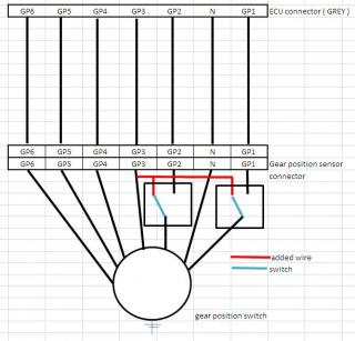

Guest phobe Posted October 14, 2010 Posted October 14, 2010 (edited) I have chanced the scematic a bit. I have made de de restriction switchable. Some testing learned that when using sports tires ( i do ) in cold weather or in the wet its very easy to spin the rear wheel. Phobe had alterted the wiring near the ecu. I have made the mod near the GPSensors connector. Its just a choise Now you have individual switches for 1st and second gear... Good idea I might do the same. It's probably advisable not to flip the switches when the bike is in first or second. Otherwise you could throw a fault code. edit: a DPDT switch would also work. Edited October 14, 2010 by phobe Quote
Dutchgixxer Posted October 14, 2010 Author Posted October 14, 2010 I have chanced the scematic a bit. I have made de de restriction switchable. Some testing learned that when using sports tires ( i do ) in cold weather or in the wet its very easy to spin the rear wheel. Phobe had alterted the wiring near the ecu. I have made the mod near the GPSensors connector. Its just a choise Now you have individual switches for 1st and second gear... Good idea I might do the same. It's probably advisable not to flip the switches when the bike is in first or second. Otherwise you could throw a fault code. edit: a DPDT switch would also work. Please explain what a DPDT switch is. Thanks Quote

wera803 Posted October 14, 2010 Posted October 14, 2010 I have chanced the scematic a bit. I have made de de restriction switchable. Some testing learned that when using sports tires ( i do ) in cold weather or in the wet its very easy to spin the rear wheel. Phobe had alterted the wiring near the ecu. I have made the mod near the GPSensors connector. Its just a choise Now you have individual switches for 1st and second gear... Good idea I might do the same. It's probably advisable not to flip the switches when the bike is in first or second. Otherwise you could throw a fault code. edit: a DPDT switch would also work. Please explain what a DPDT switch is. Thanks Double pole, double throw - Equivalent to two SPDT switches controlled by a single mechanism: A is connected to B and D to E, or A is connected to C and D to F. Quote
Guest phobe Posted October 14, 2010 Posted October 14, 2010 Now you have individual switches for 1st and second gear... Good idea I might do the same. It's probably advisable not to flip the switches when the bike is in first or second. Otherwise you could throw a fault code. edit: a DPDT switch would also work. Please explain what a DPDT switch is. Thanks Double-Pole-Double-Throw On-On switch. Like this one: http://www.thesource.ca/estore/Product.aspx?language=en-CA&catalog=Online&category=Switches+Switches&product=2750636 It is an "on-on" switch with 6 terminals. I think I might repair my harness wiring then install one of these under the seat tied into the wiring near the GPS for switchable power modes. Quote
Dutchgixxer Posted October 14, 2010 Author Posted October 14, 2010 Now you have individual switches for 1st and second gear... Good idea I might do the same. It's probably advisable not to flip the switches when the bike is in first or second. Otherwise you could throw a fault code. edit: a DPDT switch would also work. Please explain what a DPDT switch is. Thanks Double-Pole-Double-Throw On-On switch. Like this one: http://www.thesource.ca/estore/Product.aspx?language=en-CA&catalog=Online&category=Switches+Switches&product=2750636 It is an "on-on" switch with 6 terminals. I think I might repair my harness wiring then install one of these under the seat tied into the wiring near the GPS for switchable power modes. Thanks for the explanation. I prefer 2 single On-On switches. Quote

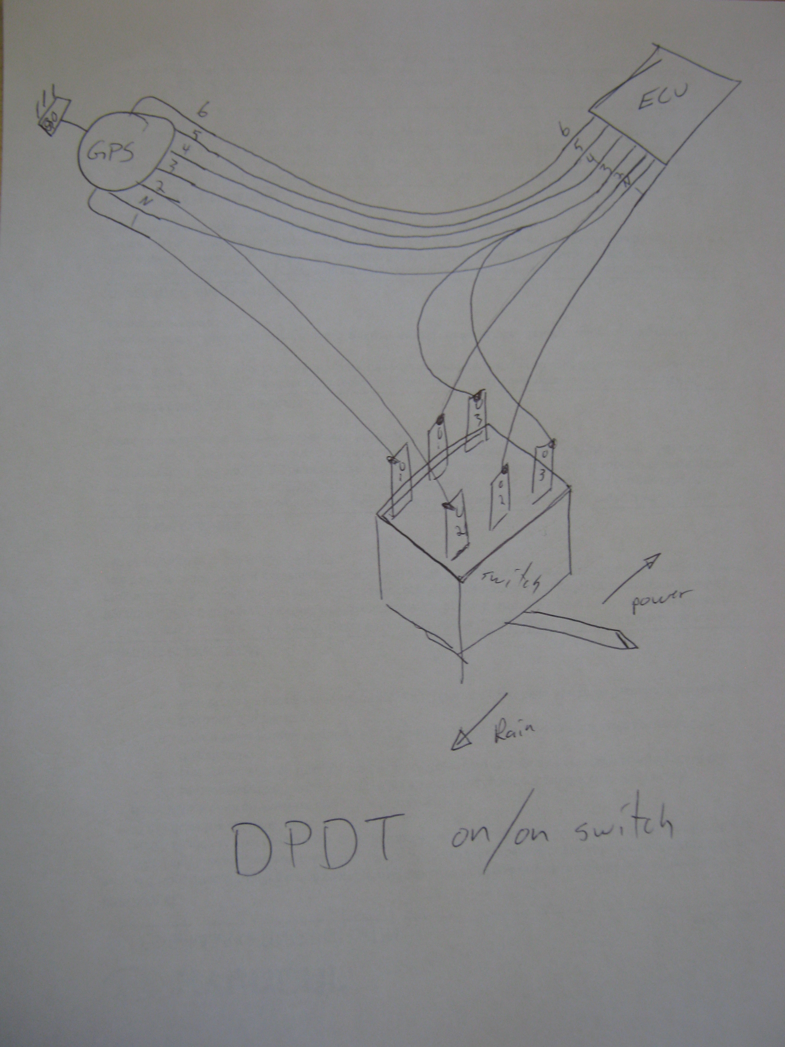

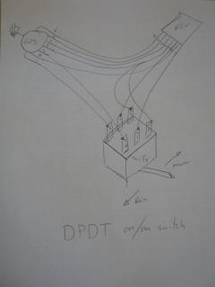

Guest phobe Posted October 14, 2010 Posted October 14, 2010 I went to Radio Shack and bought the switch I linked to in post 19. Here is a crude illustration of how I plan to wire it. I'll mount the switch under the seat... That will ensure that the bike has to be shut off to throw the switch. Quote
Member Contributer MattB Posted October 15, 2010 Member Contributer Posted October 15, 2010 I went to Radio Shack and bought the switch I linked to in post 19. Here is a crude illustration of how I plan to wire it. I'll mount the switch under the seat... That will ensure that the bike has to be shut off to throw the switch. Please, please just ride it as you've done now and relay a ride report... patience is tough for me :comp13: Quote
Dutchgixxer Posted October 15, 2010 Author Posted October 15, 2010 (edited) I went to Radio Shack and bought the switch I linked to in post 19. Here is a crude illustration of how I plan to wire it. I'll mount the switch under the seat... That will ensure that the bike has to be shut off to throw the switch. I think your wiring diagram is false. In the derestriced mode 1st and 2 nd are always connected to the ECU. The ECU sees 2 gears engaged. The GPS for 1st and 2nd wires have to move to both the middle ( P contact ) poles. Edited October 15, 2010 by Dutchgixxer Quote
