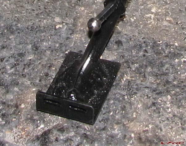

Member Contributer CitizenOfDreams Posted October 3, 2008 Member Contributer Posted October 3, 2008 Here is my "low cost" modification - a piece of metal angle welded to the side stand. Allows me to park anywhere from hot asphalt to wet sand without looking for a beer can. Quote

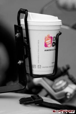

Member Contributer y2kvfr Posted October 7, 2008 Member Contributer Posted October 7, 2008 (edited) Item #1 up for bid: Visor Wiper. Cheapie 1/8" cutting board, some hot glue and velcro wire ties. Latest change: add velcro to clutch MC and cut the velcro band down, instead of strapping to the back of my left hand. Wiper blade Item #2 up for bid: Cup holder. 1/8" aluminum bar stock (from a 19" network/telco rack filler plate). Cut to bolt down to the gas cap ring faux mounting bolts. This gas cap ring has two mounting bolts on a tab so I can switch between a homebrew camera mount or my cup holder. As seen at WDGAH: -t Edited October 7, 2008 by y2kvfr Quote

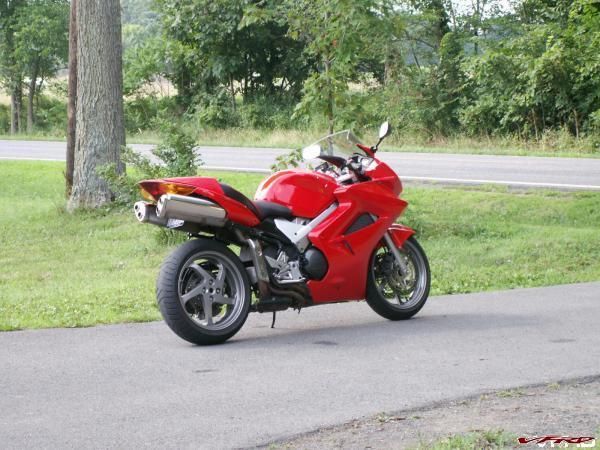

Member Contributer 2FAST4U Posted October 7, 2008 Member Contributer Posted October 7, 2008 I've been meaning to do this mod for a long time because I've always thought chrome is for cruisers. Anyhow, I wanted to keep my stock cans because I don't like loud motorcycles. However, I never liked them being chrome (or stainless steel, whatever it is.) A can I always thought looked cool is the Two Bros. VALE can. Consequently, I decided to duplicate the look. After removing the heat shields and tips, I sanded them down to the bare metal. I left the shields alone and then painted the tips black using my trusty rattle can of high temperature paint (you can get a can of PJ1 engine and case paint from most dealerships for $10). Sanding the heat shields sort of gives them the brushed aluminum look you see on the shields of the RWB VFR. However, from a distance (or at quick glance), they can sort of pass for Ti. All these pics were taken with my cell phone (hence the poor picture quality.) Since I already had the rattle can, all this mod cost me was about a day's work and the cost of the sand paper. As usual, I welcome all comments, positive or negative. Before: sigs1.jpg Before: sigs2.jpg After: cans1.jpg After: cans2.jpg The Two Bros. VALE can: TwoBrosVALE.jpg Quote

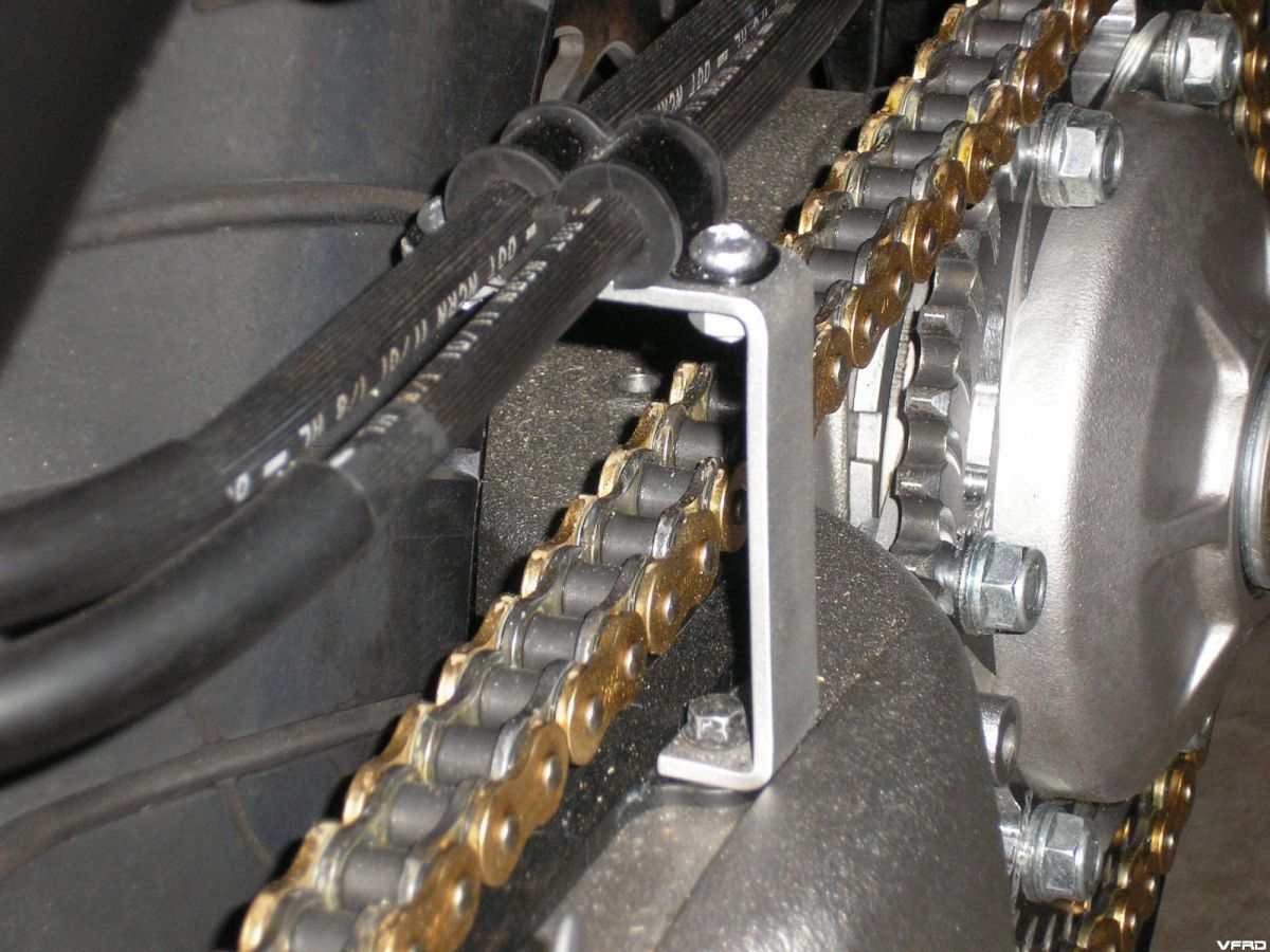

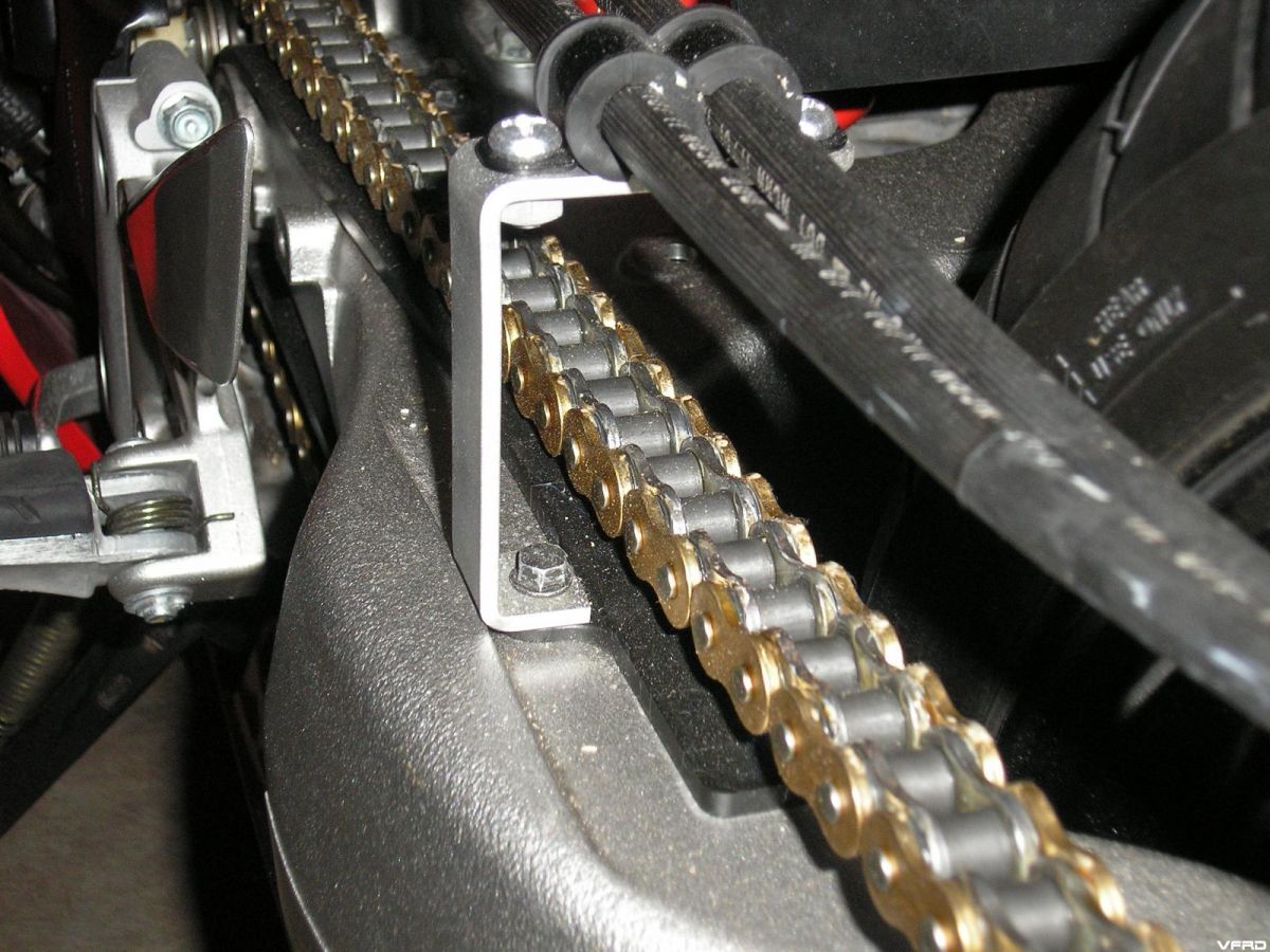

Member Contributer wooly72 Posted October 19, 2008 Member Contributer Posted October 19, 2008 I liked the look of the bike without the chainguard while I was changing out my chain and sprockets last Spring. So I left it off and just used a piece of aluminum, bent it at right angles, drilled a few holes in it, and hooked it up to the brake lines to keep them from hitting the chain. Cost me a whole $4 making this bracket. Picture 069.jpg Picture 068.jpg Picture 067.jpg Picture 145.jpg I plan to get the ss braided brake lines and running them through the swingarm for next season though. Quote
