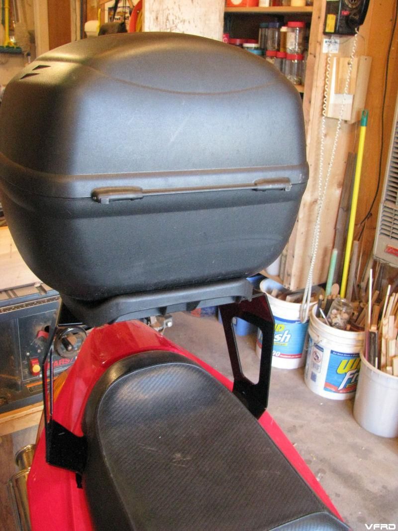

Member Contributer Vfrider1 Posted February 3, 2008 Member Contributer Posted February 3, 2008 First off let me thank Ken from the depths of my soul...OK that may be a little over the top...But I have installed the solo rack that Ken fabricated for us on the 06. I must say I am VERY pleased with the results! Ken has been nothing but helpful with my constant PM's to him. I finally did some minor mods to the rack so it would accomodate the OEM mounting plate without the use of the intermediate plate. I had tried to procure this item from the local dealer, but the only way to get it would have been to order the entire rear rack at around $200 bucks. No thanks, I broke out my bestest back yard mechanic tools and went to work. All in all I only had to drill two new holes in Ken's rack and two new holes in the OEM mount plate. I now have a very secure top case mounted up with four nuts and bolts. Thanks Ken! :thumbsup: Now let me see if I can get some pictures posted... Thanks for the picture posting thread as well Ken.... Quote

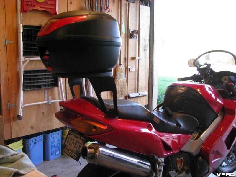

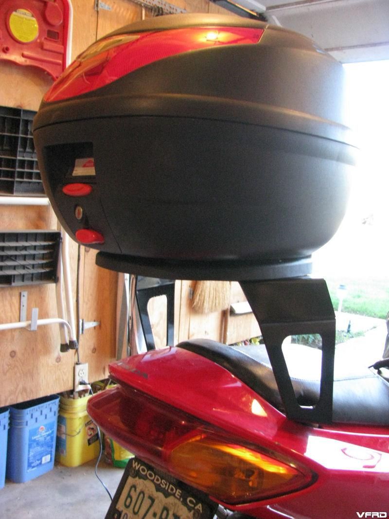

Forum CEO HispanicSlammer Posted May 21, 2008 Forum CEO Posted May 21, 2008 Ken here are some shots of the 5th gen solo rack installed on my 1998 vfr, using my commuter mini givi hardbag - it came with a universal plate which required me to drill 1/4' holes in the solo rack with some bolts and the givi hardware its really versitile. I think a pad on the back of the mini bag can provide you pillion with back support I think it will work with a passenger! KKens 5th Gen luggage rack Mini Givi hardbag with universal mount plate pillion view seat can be easily removed with rack and bag installed Other Side I understand you have 20 of these units on hand that you made for vfrd members who showed interest and yet did not follow through. I am here to tell ya the unit is sturdy easy to install and so simple I dont know why I didnt think of it! Much cheaper than a wing rack or other type of rack at half the wieght - I was surprised at how sturdy it was when I installed it. It took forever to drill the holes for the universal givi plate and I had to sharpen the drill bit to get the last one done with my drill doctor! Good stuff Ken! If you where one of the members who initially showed interest and balked later, its good gear, Ken really made a top notch rack!! You can get one of these mini givi hardbags for $150 on ebay and have a lockable waterproof commuter hard bag for around $300 bucks and not need to adjust your suspension for a heavy load. Quote

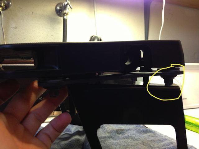

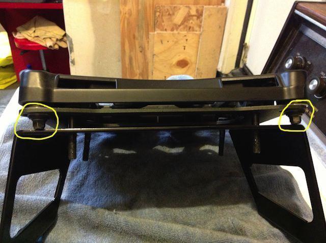

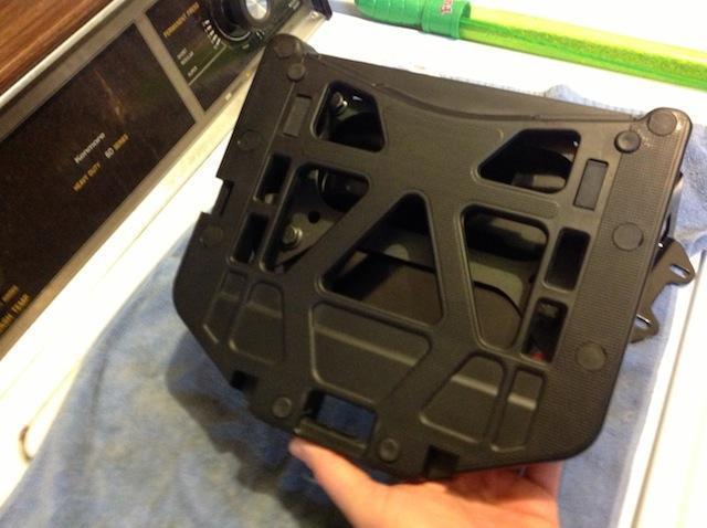

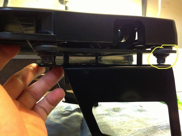

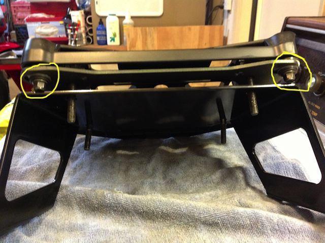

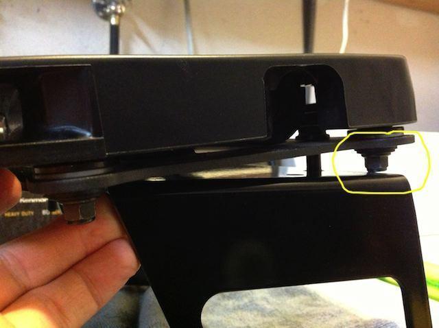

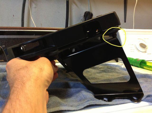

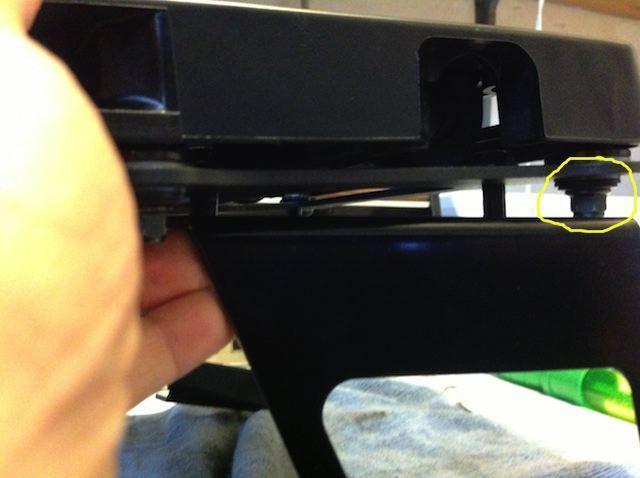

WGREGT Posted April 28, 2013 Posted April 28, 2013 Hey guys- I recently got one of these solo racks from Ken. Also bought the OEM rack. Trying to figure out how to use/mount Ken's solo rack. Ken told me how to mount the rack to the bike. I need some advice on mounting the Honda OEM "pad" to the rack. From Ken on mounting the rack to the bike. This sounds easy. "Grab handles on bike then remove the grab handle bolts set rack on handles - use the spacers under the rack if you don't want the rack touching the grab handles an install the bolts I sent. It's a bit awkward but it's not tough." What I have questions about is how to connect the Honda plastic "pad" that was on the OEM rack (I separated the pad from the tubular portion of the OEM rack) to Ken's rack. Right now I just took off the 4 bolts and nuts that run THRU the OEM tubular portion, and I see that they line up nicely with Ken's rack, but it seems the bolts are too long and only have thread on half the bolt, so it doesn't really get tight. Did you reuse the Honda bolts, or do I need to go buy new ones? Also, the Honda plastic pad is tapered on one end a bit. Right now I have that end pointing to the back of the bike when mounted....is this correct? Quote
WGREGT Posted April 28, 2013 Posted April 28, 2013 Here are a few fotos to show what I'm talking about. See how the two bolts & nuts from the Honda pad keep the pad from lying flat on the solo rack? The ones I'm talking about are the two closest to the front of the bike if this were mounted. Quote
