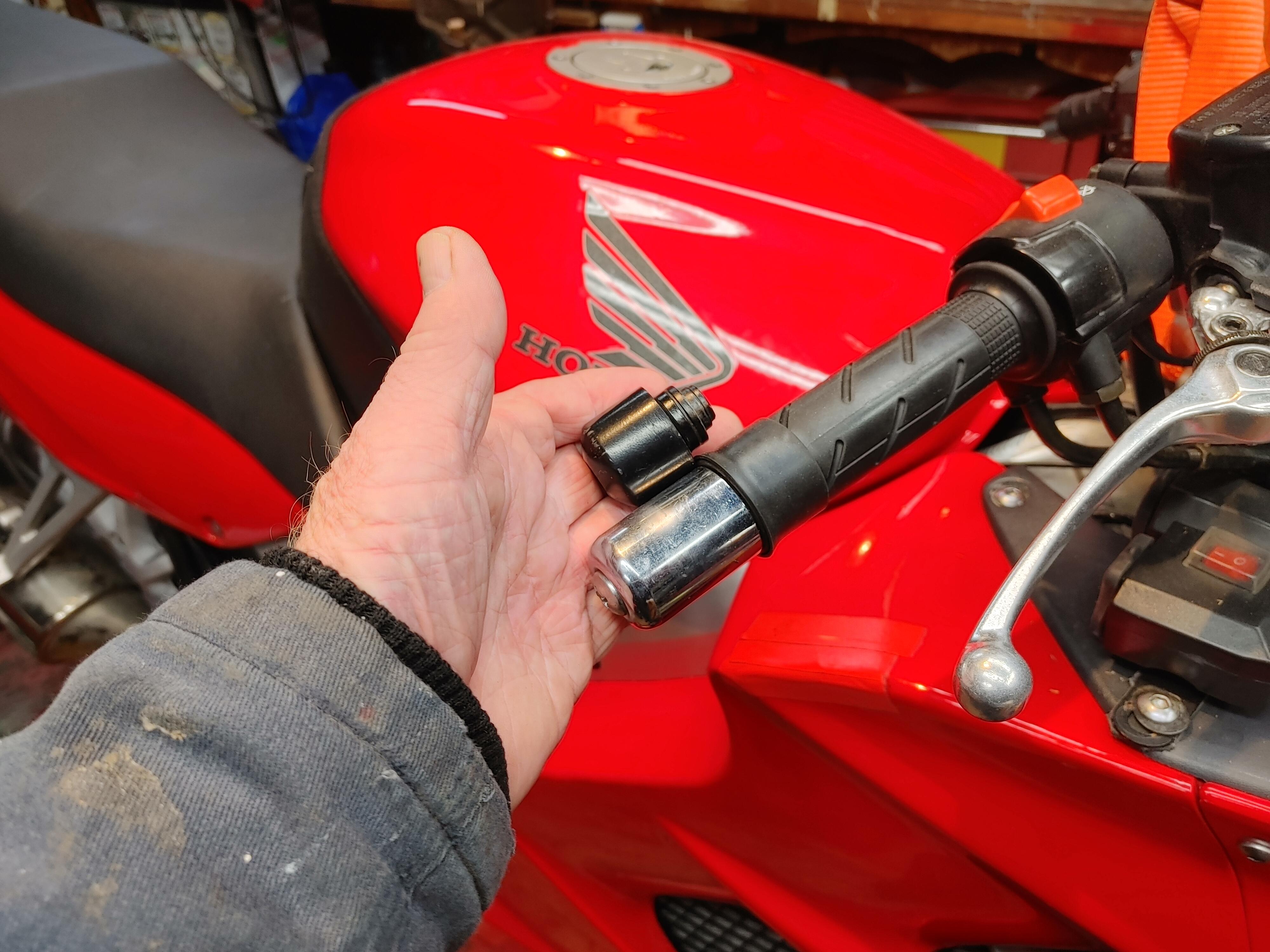

Its odd but the bar ends on the VFR are exactly the same as on my VF1000R's

Forgot a pic of the bar ends. Had to get creative to make them work.

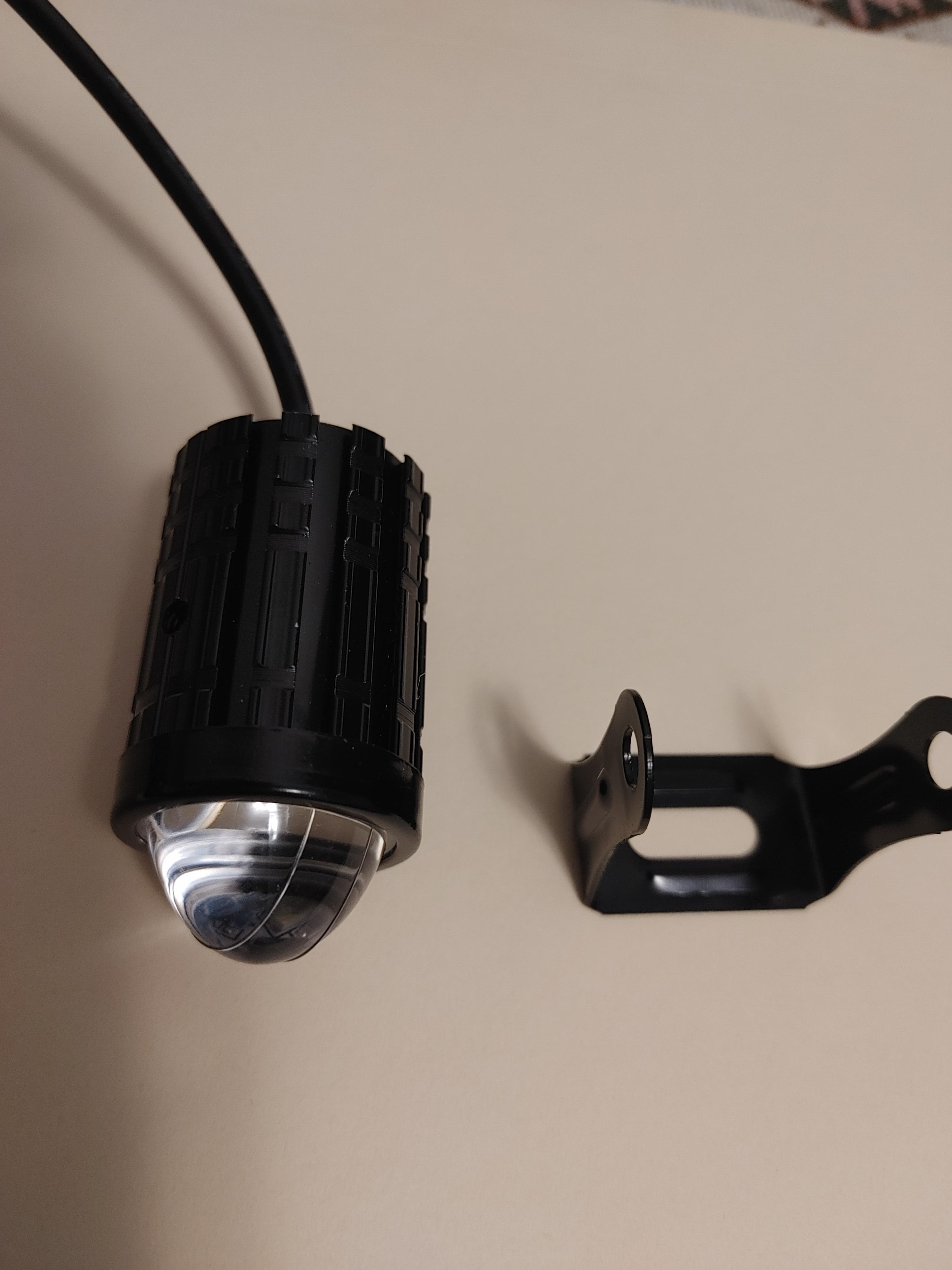

The lights are just cheap chinese riding/fog lights. The lights themselves are surprisingly good and well made with a machined aluminum body. I bought them because they were small enough to tuck in under the front fairing, and not hit the fender when the front compressed. They are about 30mm dia, and 55mm length. The switch gear that come with them as junk though.

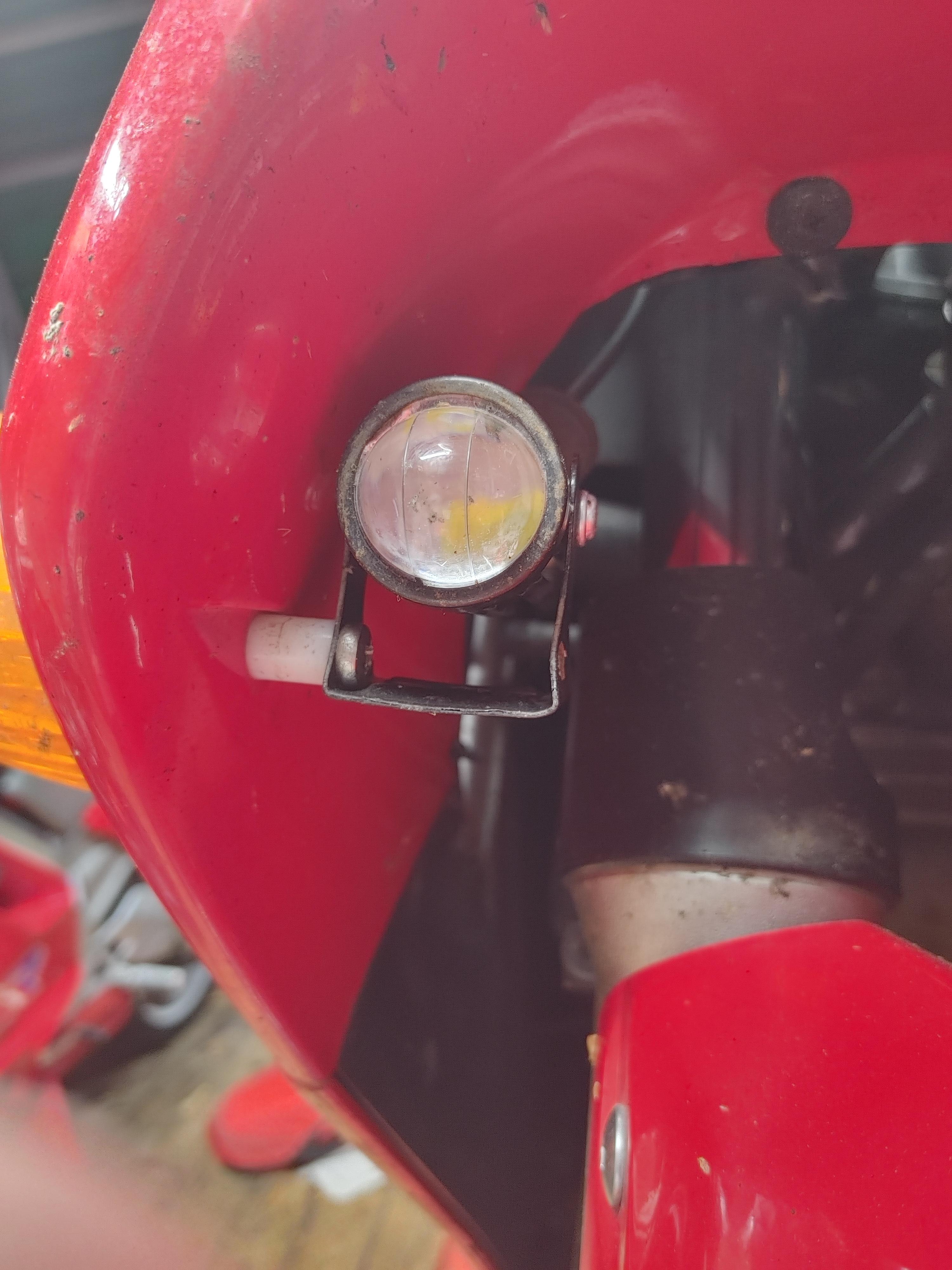

On your fifth, look at the turn signal, then look inside the fairing. There is a flat spot on the fairing with a screw head showing, this holds the turn signal in place, its a 5mm screw. Remove that screw, buy 12mm longer screw and a 12mm ferrule for mounting. The lights I used came with mounting brackets, I flipped them upside down, mounted the lights to the bracket, then held them up to the screw hole as I needed to drill a hole in the bracket to mount. Actually you have to drill holes either side of the bracket so a screw driver can pass through the bracket to tighten the fastening. Hopefully the pictures will help.

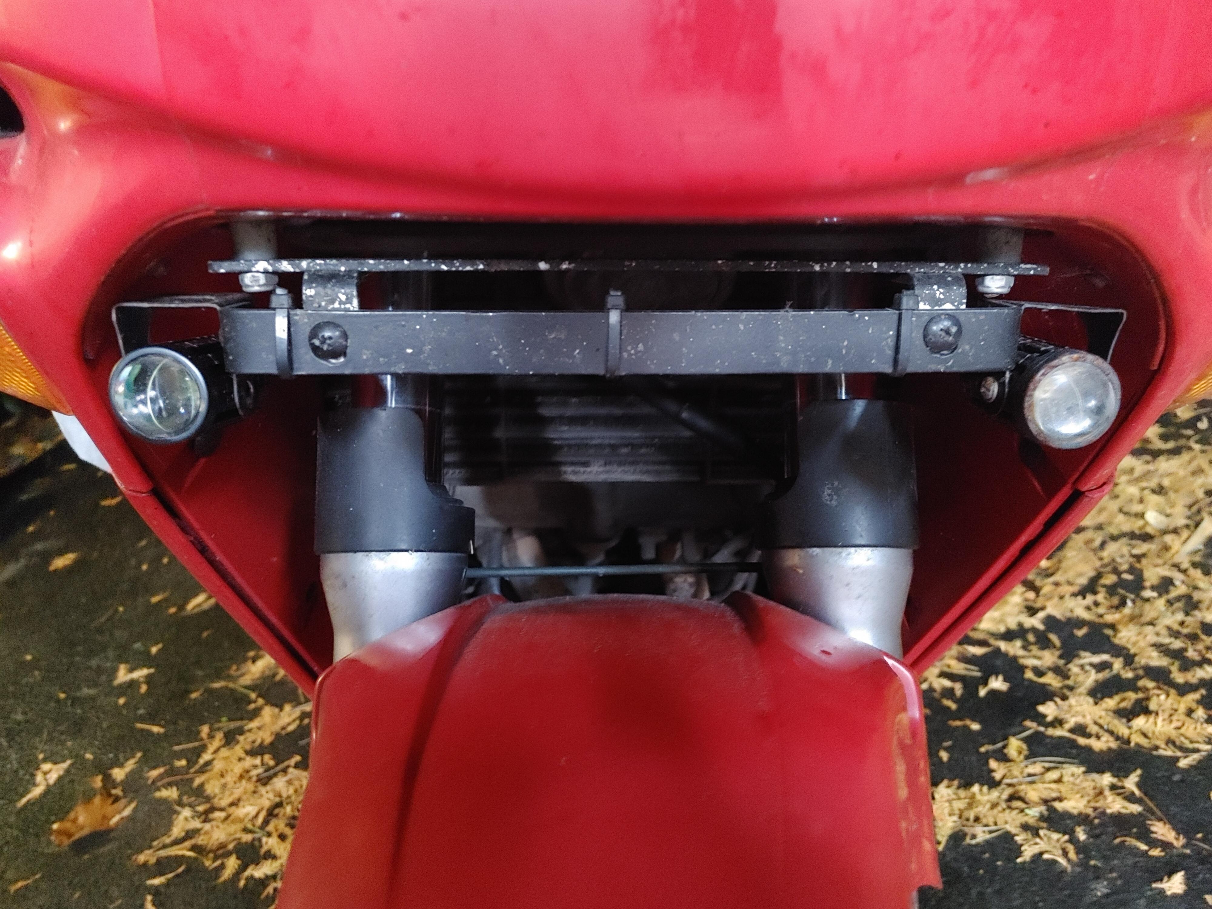

I've added a pic of my 4th gen set up as you have one. Its a bit more complicated. But I have over 70K on it going through 4 sets of different lights.

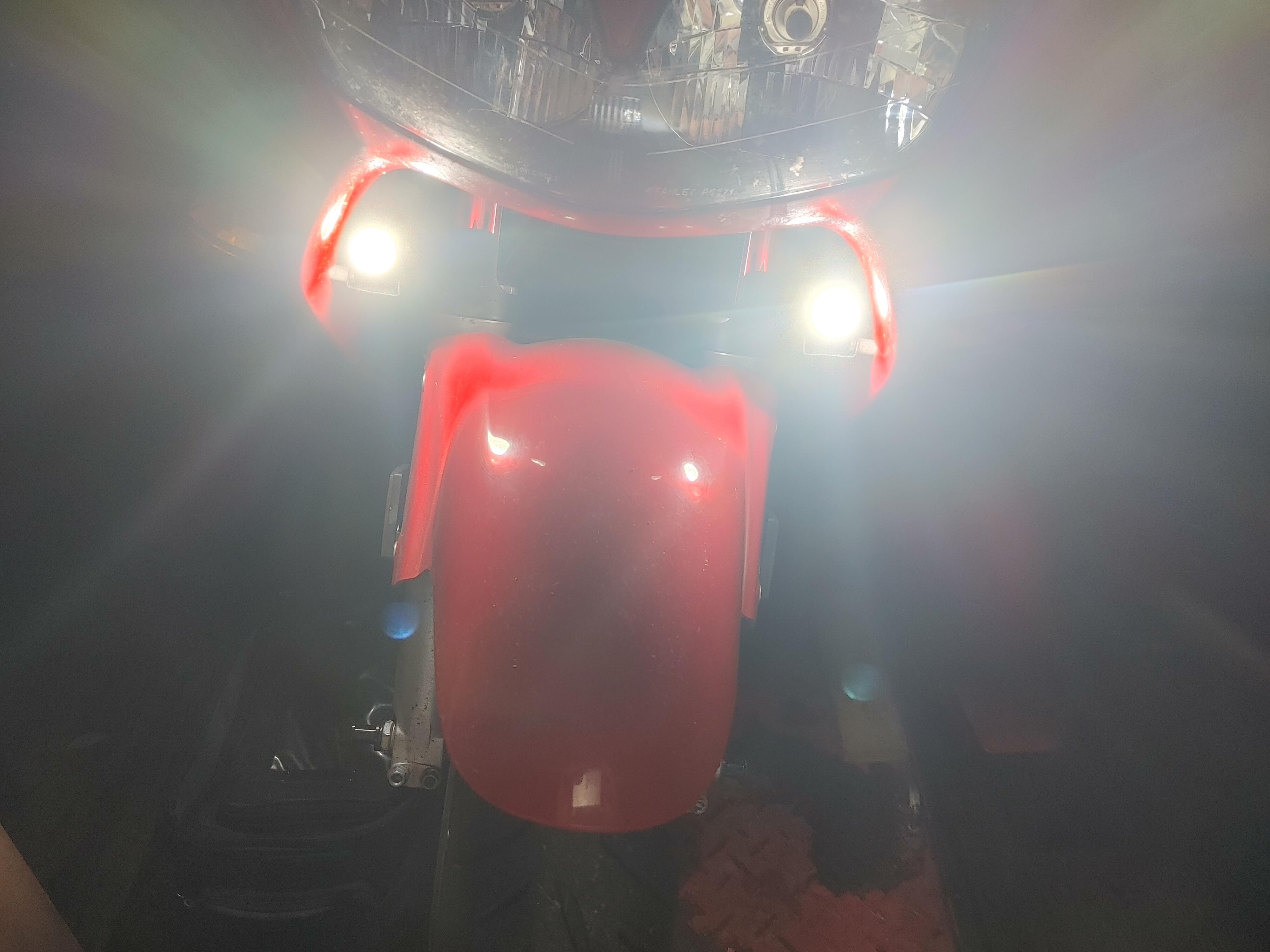

1. Lights on
2.Mounting

5.4th Gen mounting1014242207_HDR.thumb.jpg.5bf4ef7055fb8bd8eb9f5f26a93c5e5f.jpg1014242207_HDR.thumb.jpg.5bf4ef7055fb8bd8eb9f5f26a93c5e5f.jpg1014242207_HDR.thumb.jpg.5bf4ef7055fb8bd8eb9f5f26a93c5e5f.jpg1014242208a_HDR.thumb.jpg.6c1d8093105015e8a35b714da8a2d42a.jpg1014242219.thumb.jpg.36ec34f1704f1cd67b39929223a03423.jpg1014242219.thumb.jpg.36ec34f1704f1cd67b39929223a03423.jpg1014242218.thumb.jpg.b6ebc74d4165487bda051e289a3c0744.jpg1014242211.thumb.jpg.a20b380ce45342ad4e3dfaa4d38de252.jpg
