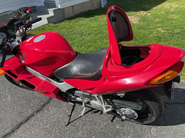

VFR4CMB Posted August 2, 2022 Posted August 2, 2022 Did a few vfrdiscussion site searches but could only find info on Givi and one had a baby in the trunk. I am looking for the one on the attached picture for my 01'. Any idea who makes or made it? Not looking for a full system just somewhere to store my hat, ear plugs and small stuff. Quote
Member Contributer VifferJ Posted August 2, 2022 Member Contributer Posted August 2, 2022 Looks like a Corbin smuggler trunk 1 Quote
VFR4CMB Posted August 2, 2022 Author Posted August 2, 2022 20 minutes ago, VifferJ said: Looks like a Corbin smuggler trunk Thanks. I saw the seat tag and went to Corbin Site but it wasn't there so figured it might be another MFG. I'll keep researching. Quote
Member Contributer Tirso Posted August 2, 2022 Member Contributer Posted August 2, 2022 it's a corbin smuggle they also sold beetle bags. neither cheap. here's a video of both Corbin Smuggler 2001 VFR800 2 Quote

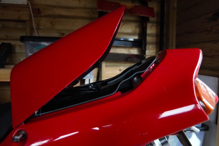

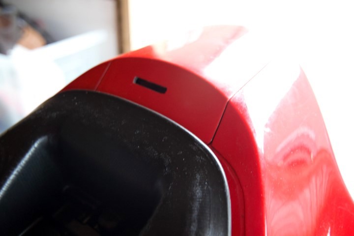

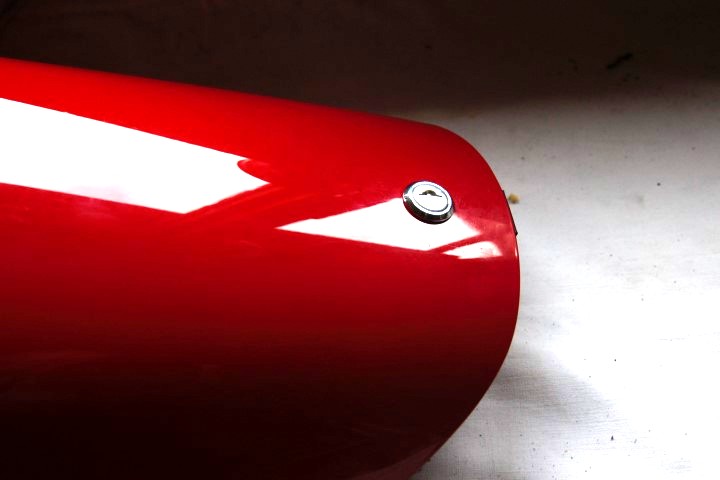

Ghostrider Posted August 2, 2022 Posted August 2, 2022 Yep, Corbin Smuggler. Hideously expensive and as rare as unicorn tears. I made my own out of an old spare seat (albeit for a Gen4 but the principle's the same)... 🙂 1 1 Quote

Member Contributer JZH Posted August 17, 2022 Member Contributer Posted August 17, 2022 On 8/2/2022 at 11:10 PM, Ghostrider said: Yep, Corbin Smuggler. Hideously expensive and as rare as unicorn tears. I made my own out of an old spare seat (albeit for a Gen4 but the principle's the same)... 🙂 That looks really nice--well done! Can you tell us more about how you did it? I had tossed around the same idea in my head for years, but never attempted it. I'm especially interested in the hinges... Many years ago I found a yellow Smuggler for my Y2k in California, but I ended up only using the seat, with the OEM cowl. But I need a 6mm Allen key to open it! Cheers, JZH Quote

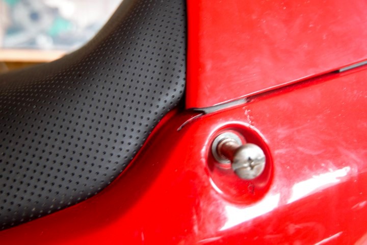

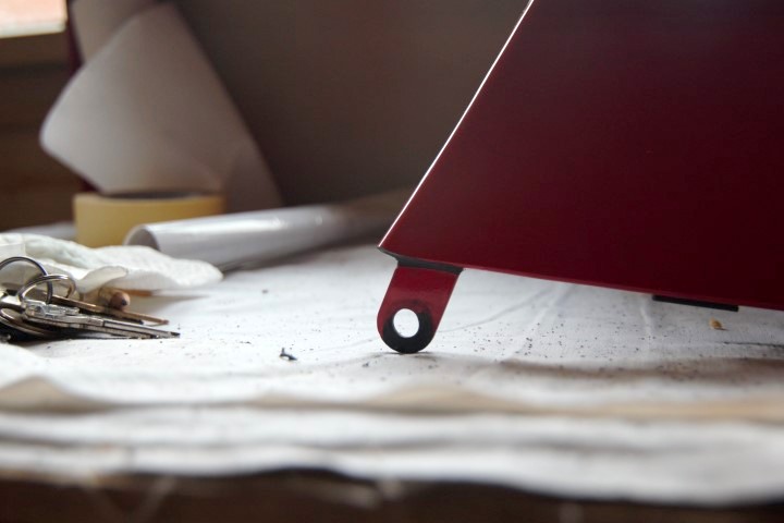

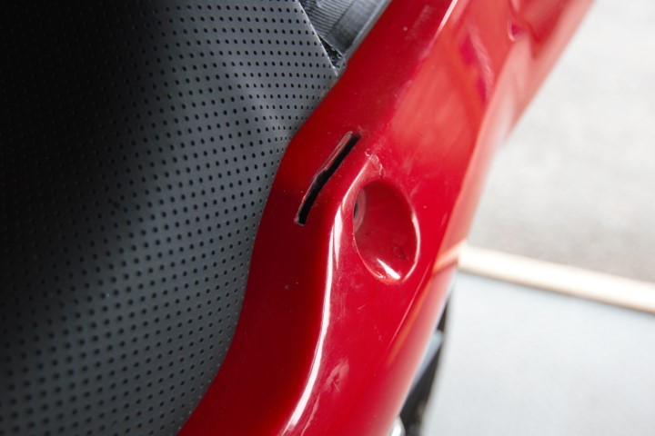

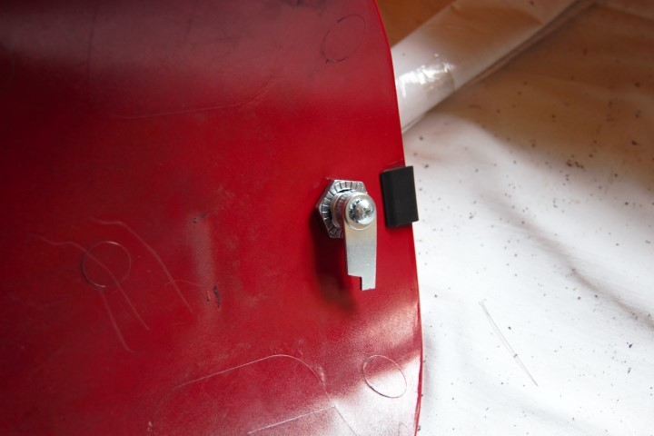

Ghostrider Posted September 19, 2022 Posted September 19, 2022 It was really quite simple. The seat hump pivots on its locating tabs into the rear fairing and is still secured by the Frankenstein bolts. To allow entry, the slot that the seat hump locating tabs normally fit into, were elongated towards the tank. Another slot was cut into the rear of the fairing to allow a simple, generic lock to fix into. 3 1 Quote
Member Contributer Terry Posted September 20, 2022 Member Contributer Posted September 20, 2022 That's awesome. I have a Sargent seat that is two piece and the area below the cowl is vacant. I'm just not sure I can bear to cut into pristine plastic... Quote
Member Contributer JZH Posted September 20, 2022 Member Contributer Posted September 20, 2022 On 9/19/2022 at 10:59 PM, Ghostrider said: It was really quite simple. The seat hump pivots on its locating tabs into the rear fairing and is still secured by the Frankenstein bolts. To allow entry, the slot that the seat hump locating tabs normally fit into, were elongated towards the tank. Another slot was cut into the rear of the fairing to allow a simple, generic lock to fix into. Awesome, thanks! Very straightforward. How far does the cowl open? Ciao, JZH Quote

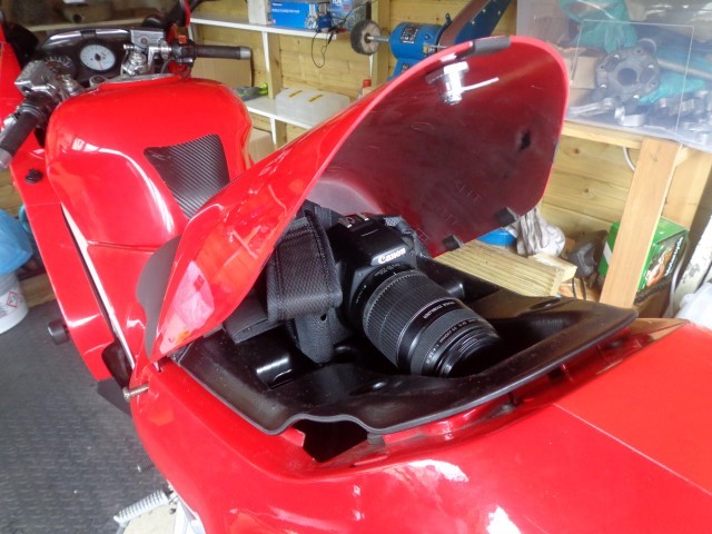

Ghostrider Posted October 7, 2022 Posted October 7, 2022 On 9/21/2022 at 12:36 AM, JZH said: Awesome, thanks! Very straightforward. How far does the cowl open? Ciao, JZH Wide enough to get stuff in, if that doesn't sound too flippant. I can easily get my DSLR in there, waterproofs, bottle of water/snacks. It really wouldn't be difficult to mod it to open wider... Quote
