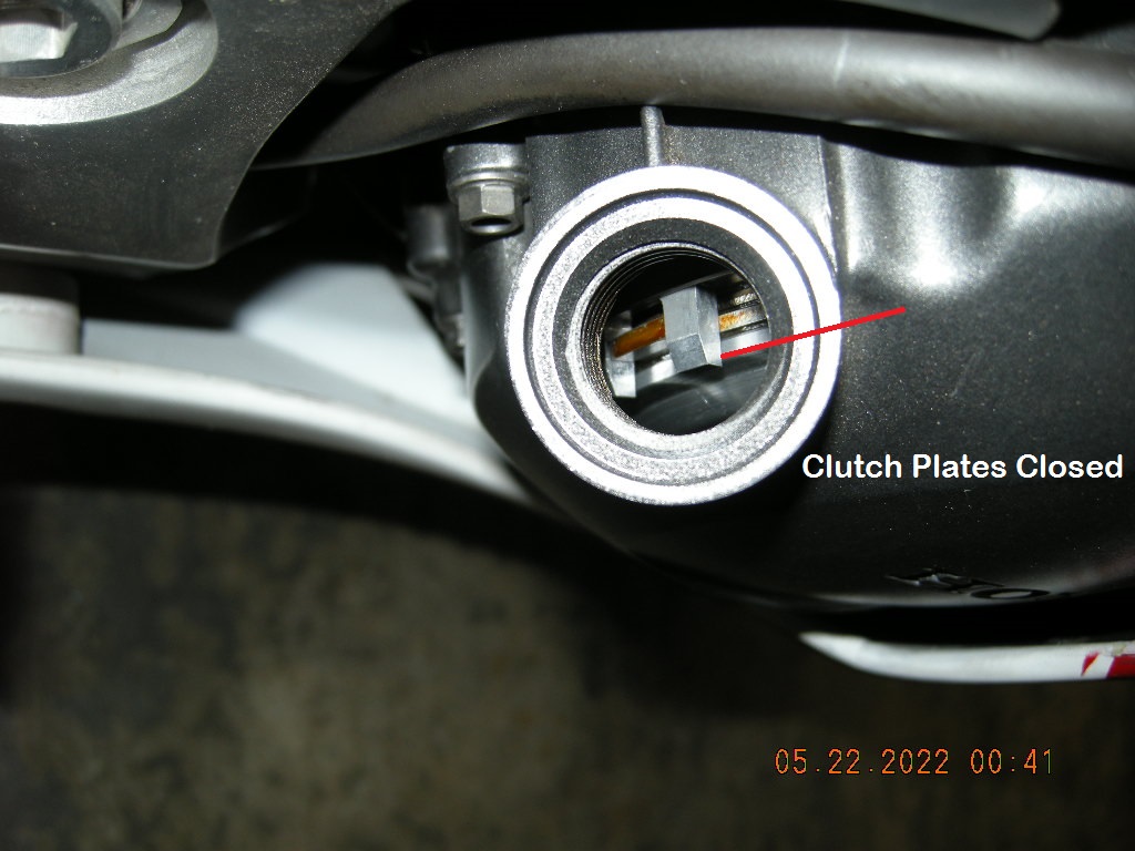

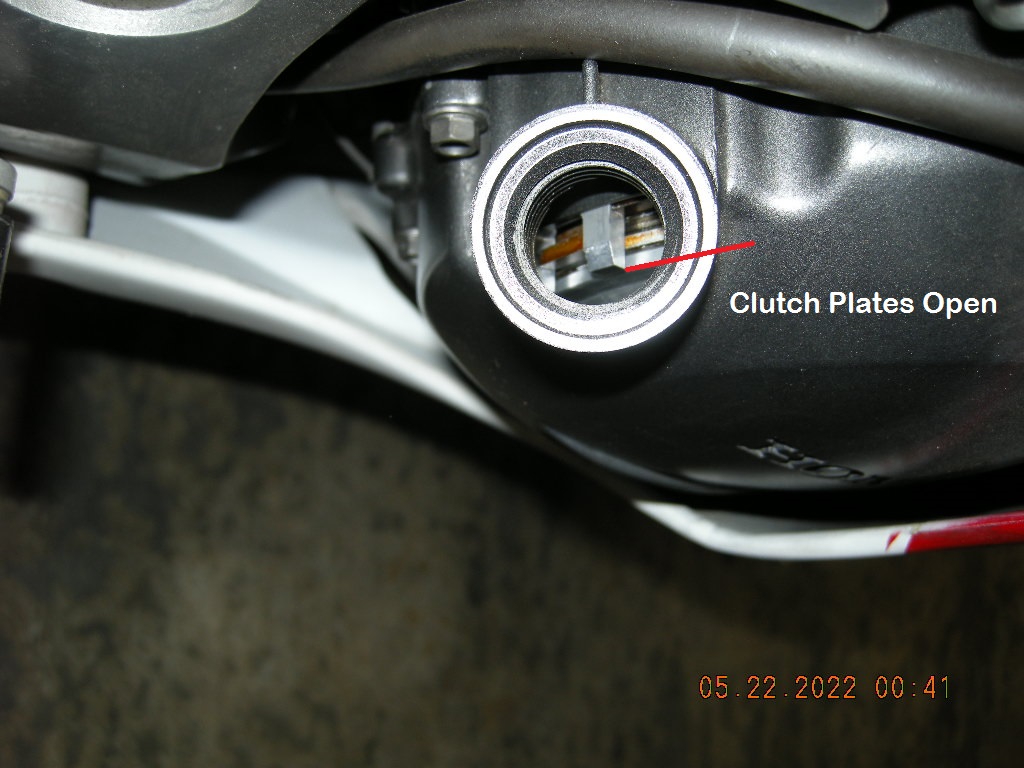

After 50 years dealing with riding and racing customers who complained
about shift quality the clutch and not oil fixed the problem... Manufactures
warn owners that our gears can't shift smoothly if our clutch is part
way engaged... check for unwanted clutch drag...
Here are the steps how to check and eliminate unwanted clutch drag...
1 Place your bike on the center stand...
2 Start engine and establish a steady idle at 212ºF (operating temp)...
3 Squeeze in the clutch lever and shift into first gear...
4 Continue holding in the clutch lever and note if the rear wheel coast to stop or not...
if it continues spinning that's unwanted drag... adjust...
To adjust a cable equipped bike turn the small knob clock wise (out)
1/4 turn and test for clutch drag... if your bike is equipped with
hydraulics bleed system for bubbles...
You may visually check for clutch plate travel by opening the oil filler and
pear inside and note what degree the plates follow the actuation of
the lever... Keeping working on it until you note a quick and abundant
spread...
Ultimately you want the rear wheel to coast to a stop when the engine
is idling and first gear selected with the clutch lever is squeezed in...

Have had a look at the clutch operation from the oil filler neck. It seems ok, in as far as the plates move when I operate the lever, and the responsiveness is fine. What I am noticing is that things don't always move in exactly the same way. Most of the time everything moves, sometimes, the right side moves but the left side sticks slightly. Or, is that the plates should move separately and are sticking @BusyLittleShop ? Here's a video.
https://photos.app.goo.gl/FMQWp3gTtpYuix5v8
This is with the bike completely cold. If that looks fine I will have to get the bike warm so that the upshifts get notchy and then check in the window again to see if anything different is happening.
