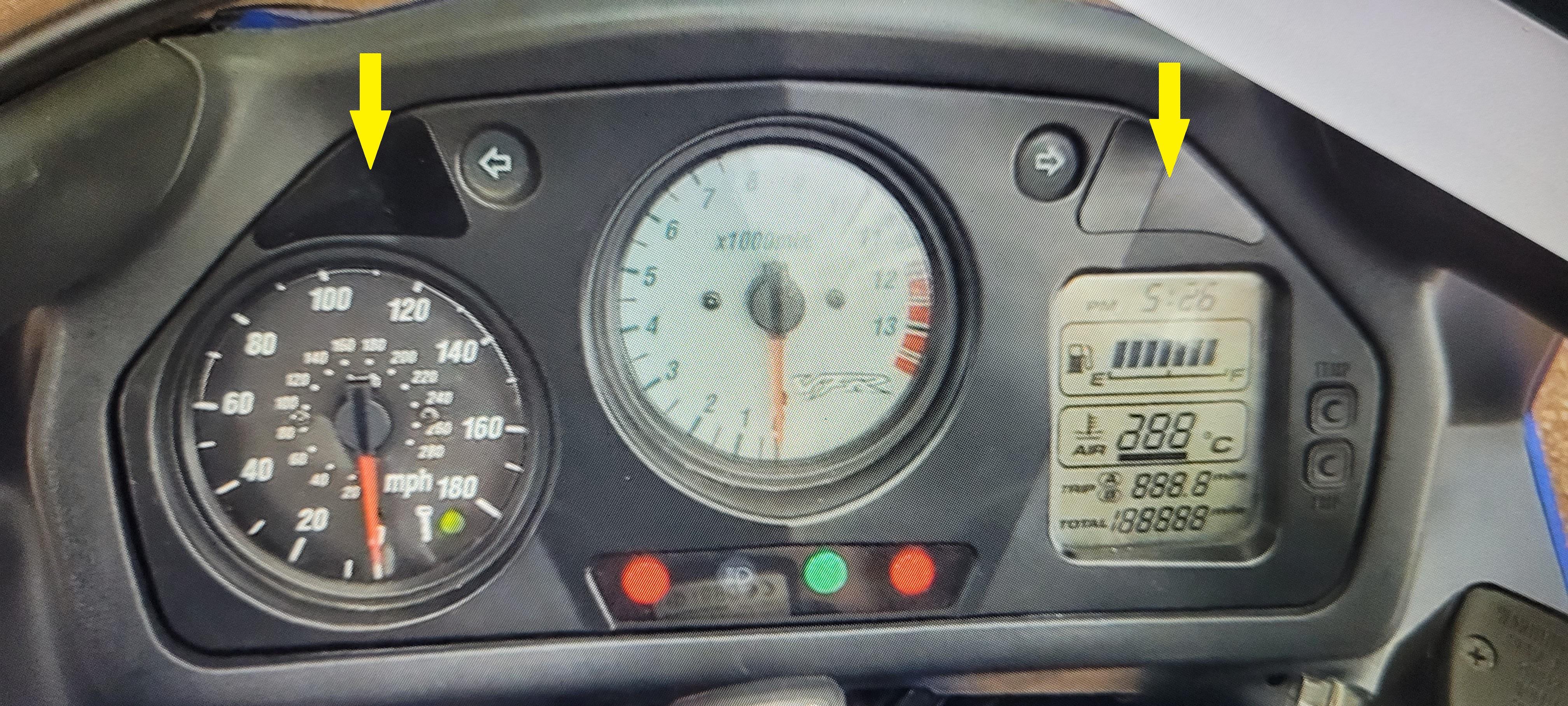

Member Contributer Skids Posted October 27, 2021 Member Contributer Posted October 27, 2021 Can someone please identify the marked small screens either side of the dash of this 2001 VFR800 please? I have a good friend who has the same year model and it doesn't have these screens so I'm wondering if it is an import. The speedo is different as well. Any help appreciated. Quote
Member Contributer ducnut Posted October 27, 2021 Member Contributer Posted October 27, 2021 Those triangles were a Honda update, because sun shining through the windscreen would melt the corners of the dash surround without them. I have a melted surround and one of these with the update pieces. 1 1 Quote
mello dude Posted October 27, 2021 Posted October 27, 2021 I have similar, a bit melted area on the dash- - It's not uncommon on bikes, thing is to remember to cover the windscreen when stopping for a break or parking all day in the sun. Quote
Member Contributer Skids Posted October 28, 2021 Author Member Contributer Posted October 28, 2021 9 hours ago, ducnut said: Those triangles were a Honda update, because sun shining through the windscreen would melt the corners of the dash surround without them. I have a melted surround and one of these with the update pieces. Do you know which country/models those were seen on? I've never seen them in the UK before and when combined with the non-UK speedo, I'm wondering where else an mph speedometer with anti-melting panels would have come from. The bike looks like an import to me, just wondering from where. Quote
Member Contributer Mohawk Posted October 28, 2021 Member Contributer Posted October 28, 2021 Skids, check the VIN they indicate country of sale. But MPH speedo, says USA, not many other places use MPH. Pretty sure Aus, NZ & Canada have been KPH since before the 5th gen. 1 Quote
Member Contributer Skids Posted October 28, 2021 Author Member Contributer Posted October 28, 2021 1 minute ago, Mohawk said: Skids, check the VIN they indicate country of sale. But MPH speedo, says USA, not many other places use MPH. Pretty sure Aus, NZ & Canada have been KPH since before the 5th gen. Unfortunately I can't read the VIN in the video. I may ask the seller but I'm in no rush. Quote
Member Contributer Skids Posted October 28, 2021 Author Member Contributer Posted October 28, 2021 Beginning to look like a French import, chassis # JH2RC46D..... Quote
Member Contributer ducnut Posted October 28, 2021 Member Contributer Posted October 28, 2021 6 hours ago, Skids said: Do you know which country/models those were seen on? I've never seen them in the UK before and when combined with the non-UK speedo, I'm wondering where else an mph speedometer with anti-melting panels would have come from. The bike looks like an import to me, just wondering from where. I don’t have any idea who all got what. But, I’d think, those update pieces would’ve been worldwide. I worked for a Honda dealer back then, but, just can’t remember the details. Quote
Member Contributer JZH Posted October 30, 2021 Member Contributer Posted October 30, 2021 From the Honda Parts Catalogues, it appears that the change was made as a mid-year update during the 2000 model run. My US Y2k doesn't have them; my UK '01 does. They may solve the problem, but I think they look horrible, so I've bought a smooth one to replace the one on my '01. (We don't have to worry about sun in the UK anyway!) Ciao, JZH Quote
Member Contributer Skids Posted October 30, 2021 Author Member Contributer Posted October 30, 2021 3 hours ago, JZH said: From the Honda Parts Catalogues, it appears that the change was made as a mid-year update during the 2000 model run. My US Y2k doesn't have them; my UK '01 does. They may solve the problem, but I think they look horrible, so I've bought a smooth one to replace the one on my '01. (We don't have to worry about sun in the UK anyway!) Ciao, JZH Thanks m8, that's interesting but my m8's Fi-1 02-plate bike doesn't have them. Quote
