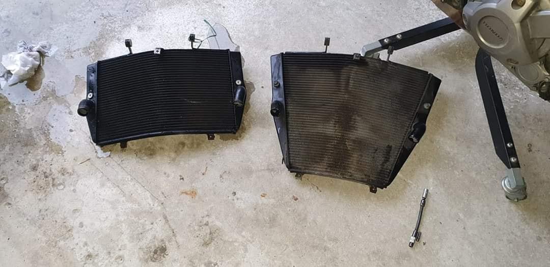

Redbike Posted October 13, 2021 Author Posted October 13, 2021 I checked the radiator is also warming up so early when the waterpump hoses are just 50C. When they get to 60C the radiator is full surface warm too. Its cap corner is warming from 30C. I read in the manual the thermostat should open from 80C, not earlier. When looking the radiator I was not happy. Is it a must to replace? Its middle and lower zones are the weakest. Quote
ggtod Posted October 14, 2021 Posted October 14, 2021 I admit it look rough but people install mesh guards that give the same effect, no? Also if the thermostat is stuck open wouldnt that cause slow warm up time and running cooler causing the bike not to reach working temp /not good as well/ but not overheating as you're worried about. I'll tell you how the temp gauge is acting on mine. If its above 20C or the speed is below 100kmh it always shows 3 bars. With speeds arround 140-150 /easy on the throttle/ it drop to 2bars but only below 20C I've read post on the fb fan page about overheating, one guy says that for 6 years and riding in 45C temps he never seen 4 bars. Pretty much means if you get 4 bars you have problem. Also do you have the automatic or manual bike? Radiators for both are different , the DCT bike seems to have bigger one , probably there is a reason behind . New radiator is expensive. Specialy OEM one. Only found aftermarket for manual bike arround 300$ and DCT on ebay for 500 Quote

Member Contributer Thumbs Posted October 14, 2021 Member Contributer Posted October 14, 2021 Rather than buy another radiator I’d get that one recored, cost should be under £250 depending on what you need done Either way I’d call this company and see what they say https://www.aaronradiator.co.uk/motorcycle/ …their work is pressure tested and warranted for 12 months 1 Quote

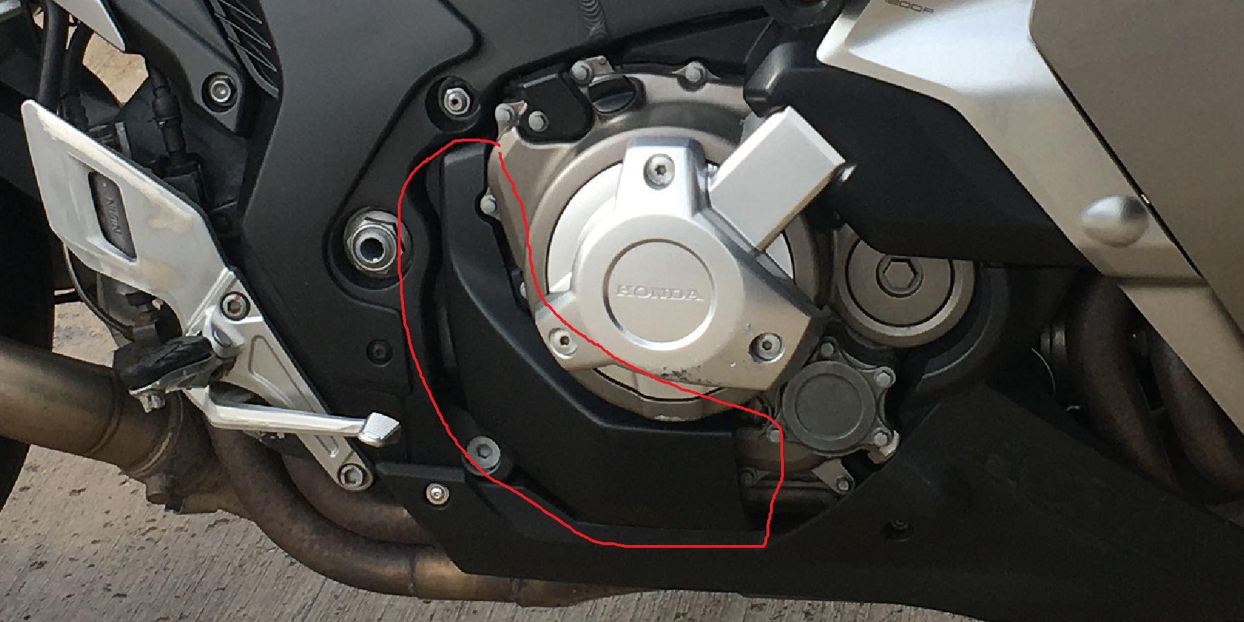

ggtod Posted October 17, 2021 Posted October 17, 2021 Like you said, if you get all the bottom DCT plastics or modify yours , why not? The rest look the same. If you get it for the same price go for DCT rad Quote
Member Contributer Viffy Posted October 17, 2021 Member Contributer Posted October 17, 2021 The standard radiator for the manual bike is fine for the engine. I think you have answered your own question. 20% of your radiator is damaged and air cannot cool it. There will be a problem next summer. I have ridden mine in 38 Degree heat, and it did not overheat. The fairing does deflect the worst of the heat away from your boots. I've ridden many Bikes far worse than this one in hot countries. Quote
Redbike Posted October 27, 2021 Author Posted October 27, 2021 Is here anybody who replaced the radiator in a manual bike for the DCT version? Would it fit if the plastic skirt is also replaced with it? Or are the other items to replace with it, too? Quote

Member Contributer RC1237V Posted November 6, 2021 Member Contributer Posted November 6, 2021 Many folks complain about dealers as they are usually in business to turn profits, and don't offer free repairs unless absolutely necessary. Either way, I would replace the radiator, either one will work, but the DCT version will require a DCT cowl, or modifying the original. There looks to be inefficient flow through your radiator, which is how they exchange heat with the air (passing through them). A screen door will have good airflow with a summer breeze, unless it's caked with mud... I would push them to at least give you a discount on a new radiator, as I have never seen one that bad. Maybe the previous owner lived on a gravel road. You could also check the water pump impeller just to make sure nothing is wrong with it. Check/replace thermostat if needed, and replace the coolant with proper type and mixture. I used a mighty-vac to empty the remote reservoir as I did not want to take off the swingarm as the manual suggests. Also verify correct fan operation. My bike runs at 3 bars on days I can wear my summer mesh suit, and at 2 bars on days when I need my winter suit - riding, not idling in traffic. I know that's not scientific, but Honda does a really good job of engineering most of the time, and heat / overheating is not at all a common issue on these bikes, if they are in good running order. I beat on mine hot-lapping priest grade in 100+ degree weather going up the 1200' climb in ~2 miles and coming down the short steep route ~1 mile, 3 times in a row with no issues, except overheated tires. The VFR1200 has the best heat management of any sporty bike I have ever ridden, so something is amiss, and the radiator seems like the most likely culprit. A radiator guard is also a good idea, as I did get a rock through mine, causing me to bail on a 3 day ride. The guards are just under $100. Hope you get it sorted, and the dealer steps up and does what is right, but I wouldn't hold my breath. 1 Quote
ggtod Posted November 6, 2021 Posted November 6, 2021 Yes my bike is a DCT and the radiator is bigger vs. manual. Pictures is from the web , example just to proove that. Hoses location seems the same, but not the attach points for the fans and plastic. If I was you, I'll spare the trouble with the plastics, I'll just replace the rad with standard for your bike and not worried about. 31 minutes ago, RC1237V said: My bike runs at 3 bars on days I can wear my summer mesh suit, and at 2 bars on days when I need my winter suit Same here! After reading how that temp gauge act, I think thats the norm. Quote
