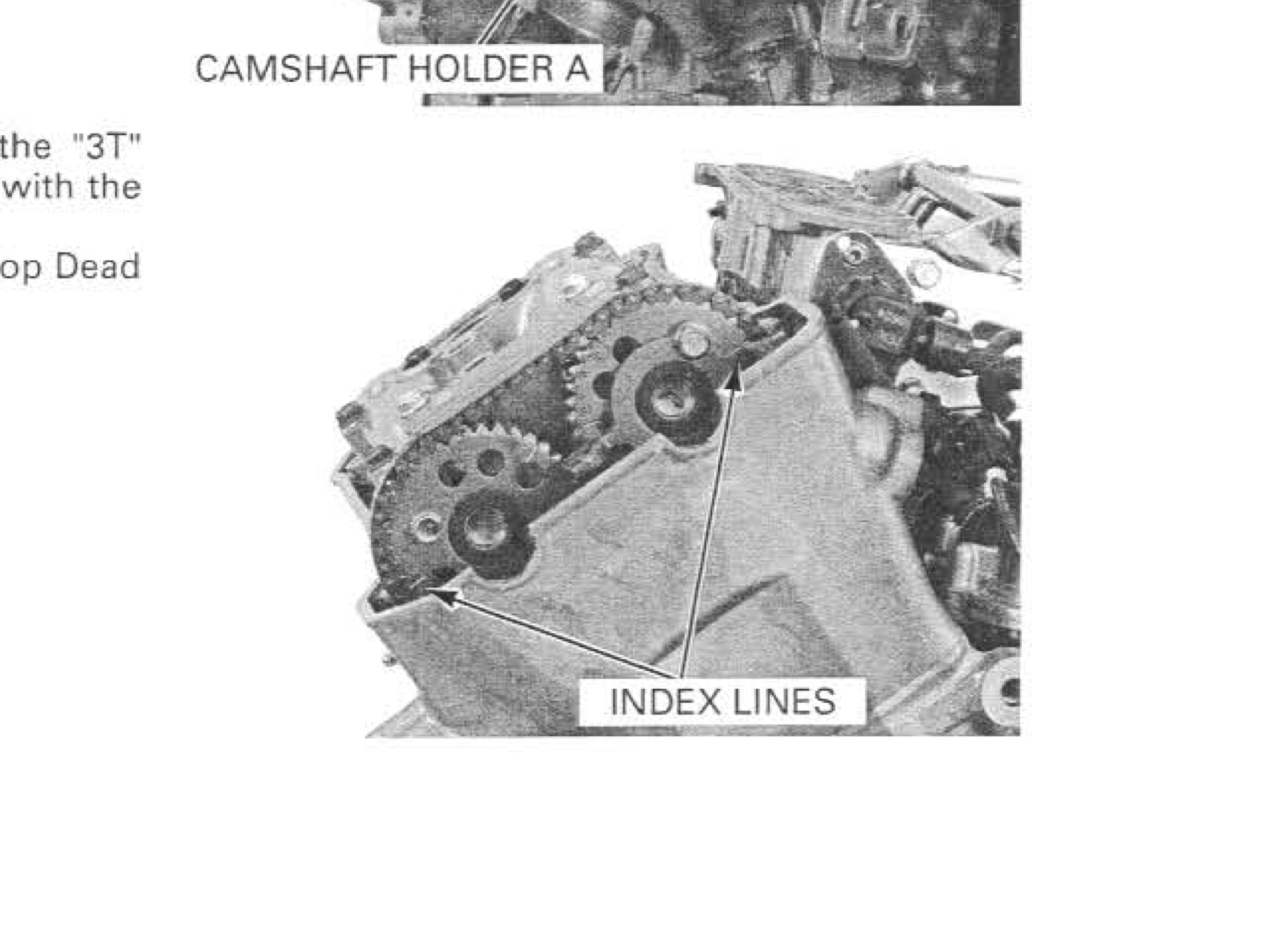

Member Contributer Grum Posted July 22, 2021 Member Contributer Posted July 22, 2021 Just wondering! If the exhaust or intake cam timing is out by one tooth, could this increase valve overlap causing excessive intake fuel to exit the exhaust? I'm no expert in this department! How does the alignment compare to the front cylinders? The rear exhaust doesn't look right compared to the service manual cam setup. Your photo is not showing the outboard/chain side for the index line! Hopefully some of the members with cam alignment experience could chime in. Quote

Member Contributer Cogswell Posted July 22, 2021 Member Contributer Posted July 22, 2021 I have a similar cam alignment issue on my VTEC. Prior to removing them, I rolled the motor over through several cycles to get a bead on what the timing marks would look like on reassembly. If the exhaust side was where it should be, the other was slightly off and vice versa. I don't recall if to the extent of yours, but it was not precise like on a 5th gen. On assembly, prior to reinstalling the caps, I initially laid one cam in properly and the other puposely one tooth off to see what that looked like. It didn't seem as though it would be noticeable, but it was very obvious. It was more than just slop in the cam drive assembly. On your rear exhaust photo I can't make out the timing - the rear exhaust mark is set by observing through the hole in the frame. I have a photo somewhere. It's a PITA, seems like Honda could have come up with something better. Regardless, although I put it back exactly as it had been, the timing was never to my satisfaction. I speculated that it could be one or a combination of factors - chain wear (30,000 miles), tensioner weakening or the slides the chains glide over wearing. I suppose the engineers considered that when designed, over time the timing drifts some, however a few owners have reported 100,000 miles without even looking at the valves and no observable performance issues. I would recommend once you're ready to remove the cams, put a small dab of paint on the cam sprockets and corresponding chain link - it will make reassembly so much easier. When finished, take some of the paint's solvent and wipe them off. When you roll the motor you'll need to do it again. And don't forget to release the tensioners before turning the crank. When I finished, I swore to myself that I would never do that procedure for anyone else or for money. It's the least favorite maintenance chore I've ever done on any of my bikes. 1 1 Quote

klrtovfr Posted July 22, 2021 Author Posted July 22, 2021 11 hours ago, Grum said: Just wondering! If the exhaust or intake cam timing is out by one tooth, could this increase valve overlap causing excessive intake fuel to exit the exhaust? I'm no expert in this department! How does the alignment compare to the front cylinders? The rear exhaust doesn't look right compared to the service manual cam setup. Your photo is not showing the outboard/chain side for the index line! Hopefully some of the members with cam alignment experience could chime in. I wish that they used higher resolution photos of the cam sprocket marks. I have a hard copy of the service manual. Also #3 was my highest compression at 160, #1 was 150. Quote
Member Contributer Cogswell Posted July 22, 2021 Member Contributer Posted July 22, 2021 The marks should be exactly parallel to the top of the head where the cam cover mates. That's why the inspection hole, it's impossible to ascertain at an angle. IIRC with it one tooth off, I could not even see the mark on the exhaust cam - so you should be able to determine if it's one tooth off. Maybe that's why the hole is so small - AFAIK thete is no Honda documentation on that. Quote
Member Contributer DannoXYZ Posted July 22, 2021 Member Contributer Posted July 22, 2021 10 hours ago, Grum said: Good Info. Danno what's your thought on his cam alignment? Photos does show oddity with rear exhaust cam gear. It shows marks for FI and FE, but where's index marks for RE? Gear flipped backwards? Quote
klrtovfr Posted July 22, 2021 Author Posted July 22, 2021 I'm at work now but I think RE is directly above the #3 timing mark almost where the timing mark should be. As far as I know I'm second owner since 6700 miles and the gears were never seperated from cam shaft. I did the first valve inspection at 20,000 (everything in spec) but it's been so many years since then I don't remember if the timing mark was off like that from the factory. Quote

klrtovfr Posted July 22, 2021 Author Posted July 22, 2021 7 hours ago, Cogswell said: The marks should be exactly parallel to the top of the head where the cam cover mates. That's why the inspection hole, it's impossible to ascertain at an angle. IIRC with it one tooth off, I could not even see the mark on the exhaust cam - so you should be able to determine if it's one tooth off. Maybe that's why the hole is so small - AFAIK thete is no Honda documentation on that. This is through the frame hole. One is slightly from bottom and one is toward the top. It's hard to photograph exactly in the middle. Also cam lobes arnt visually equally diagonal with exhaust appears to be more upward. Quote
Member Contributer Cogswell Posted July 22, 2021 Member Contributer Posted July 22, 2021 Yep - mine was like that. If it were a tooth off it would be out of sight below, and if the other way I suspect almost or out of sight on the top. Presuming the intake index mark is correctly aligned, being low like that would be consistent with elongation of the chain with wear. I found the whole thing to be very frustrating. If you want to satisfy yourself that the timing is correct, try what I did and install the ex cam 1 tooth off in both directions (no need to bolt down the retainers for this purpose) - my guess is you'll conclude that is correct as is, but is not as precise as hoped or expected. Quote
klrtovfr Posted July 22, 2021 Author Posted July 22, 2021 Here is the front cams, also timing mark pointing slightly down on intake. Quote
Member Contributer Cogswell Posted July 22, 2021 Member Contributer Posted July 22, 2021 It looks to like you're in time - wear has made it less precise. See my reply, above. Quote
