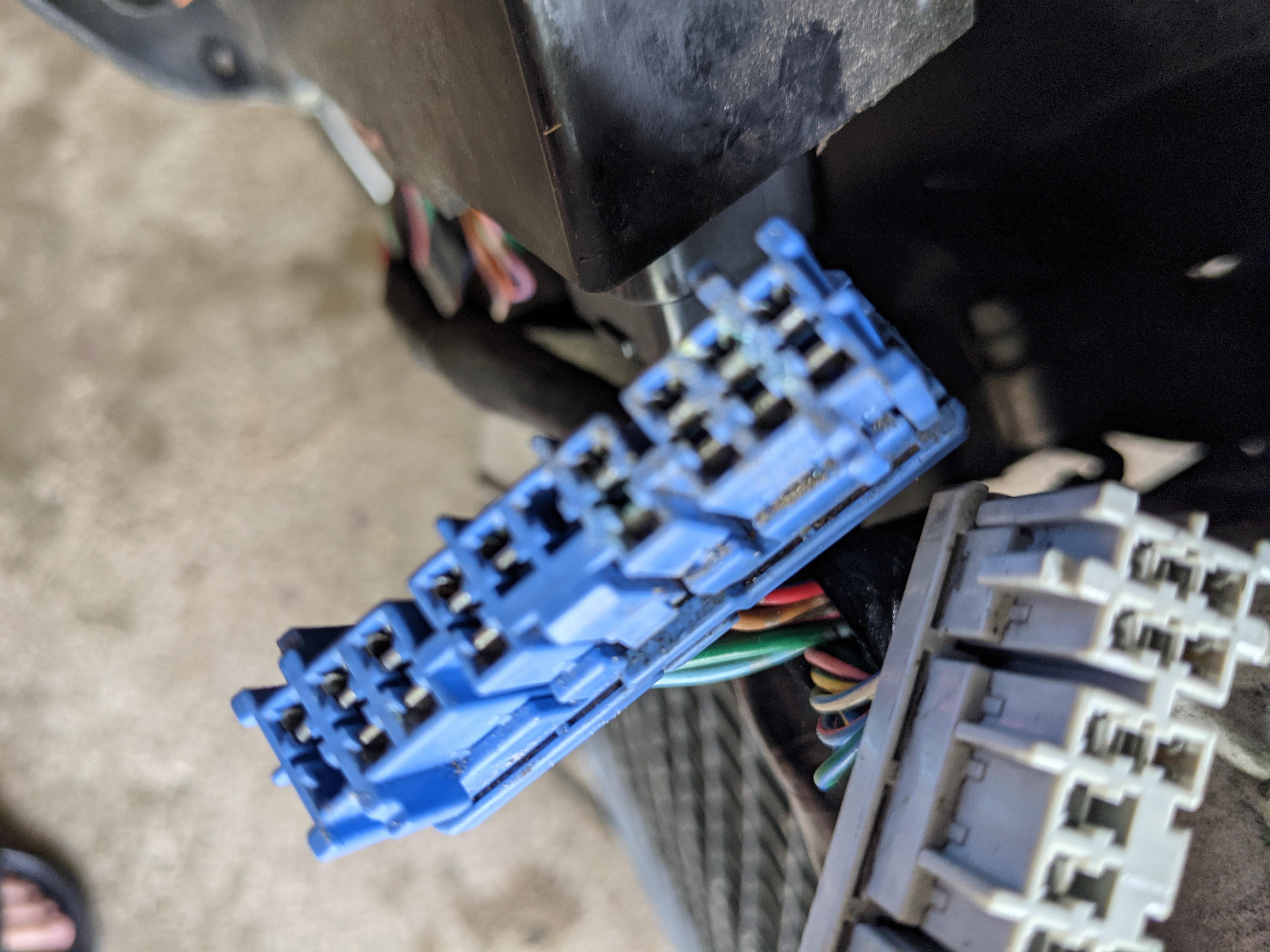

Update: As you can see the blue connector definitely has some issues on the side with the black/white stripe wire. Damn these are quite small but hopefully hitting it with some Deoxit contact cleaner and a selection of toothbrush, q-tip and a piece of copper wire is enough to get it all cleaned out. If there is a better way to clean this side of the contacts I am all ears.
For tracing the battery power on black/white stripe wire, the probes on my multi meter aren't nearly small enough. Also are you back probing it with the connector plugged together, or just measuring with it unplugged on the connector above? Might be able to carefully stick a short wire in and measure off that.

I've seen worse Blue connectors, but yes it sure could do with a clean up. Hard to see with your photo, are any of the pins or sockets burnt?

None of the pins or sockets were burnt.

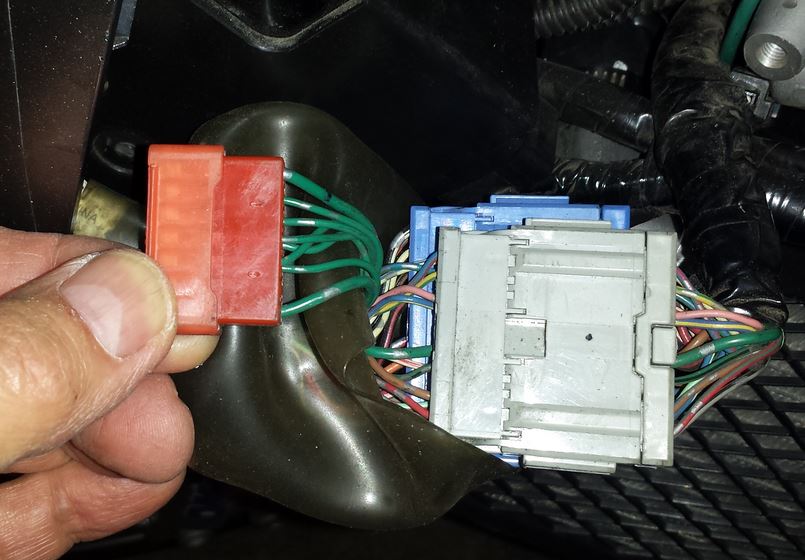

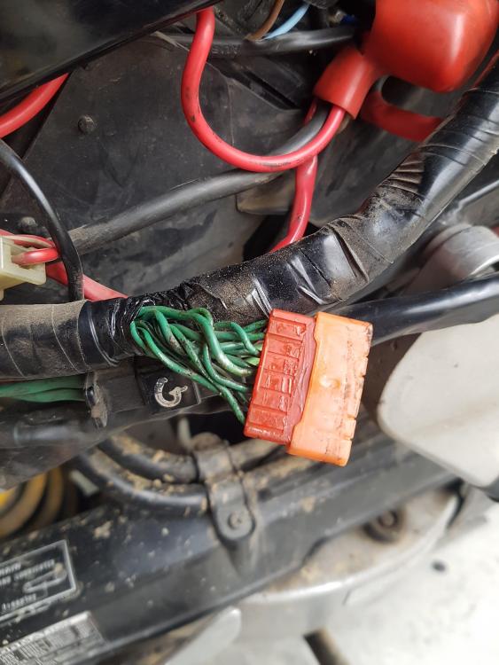

Here is the Orange Ground block for a 5th gen located in the harness above tha chain guard.
A 6gen has a light gray ground block located behind the main frame weld behind your coolant reservoir tank. So a bit more clarification on the ground block you are talking about!

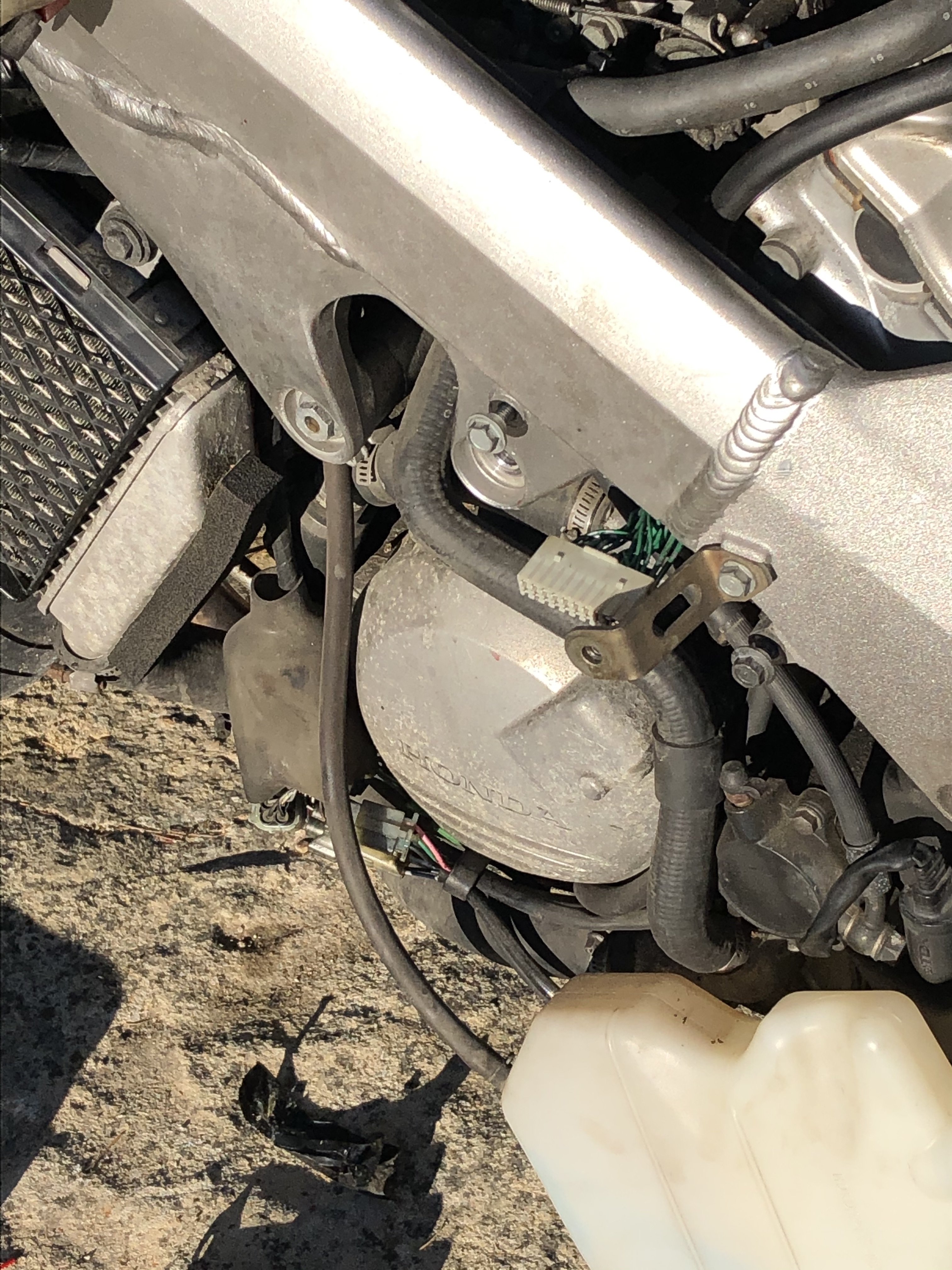

Grum,
A point of clarification - not all 6th gens have that grounding block behind the coolant reservoir.   I don't know what might be the reason - possibly the updated harness from 2006 on, or possibly the ABS variant, which is what I have and I believe the OP does as well.  At any rate, on my 2008 there is a series of 8 to 10 harness grounds connected to the frame by an M5 hex bolt that threads in horizontally.  It can be found in the general vicinity circled by lifting the tank .  The main battery ground is on the horizontal part of the frame below the tank hinge which the upper shock mount is attached to.  But for whatever reason, my 6th does not have that gray ground block.
In the other pic note the harness grounds with the capped off connector similar to the photo from the gen 5, above.

2 hours ago, Cogswell said:
Grum,
Excellent thanks for the heads up Cogs, learn something new every day. Haven't seen this on a 6gen, suspect it may well be for the ABS variant. Unfortunately in Aus, for the 6gen, we never had the ABS verion.

Yes that is exactly the orange grounding block that I opened up to inspect and clean. I did find and clean that M5 hex bolt with the grounds under the tank (looked fine) and will get to the battery ground under the hinge as well after the F1 race.
