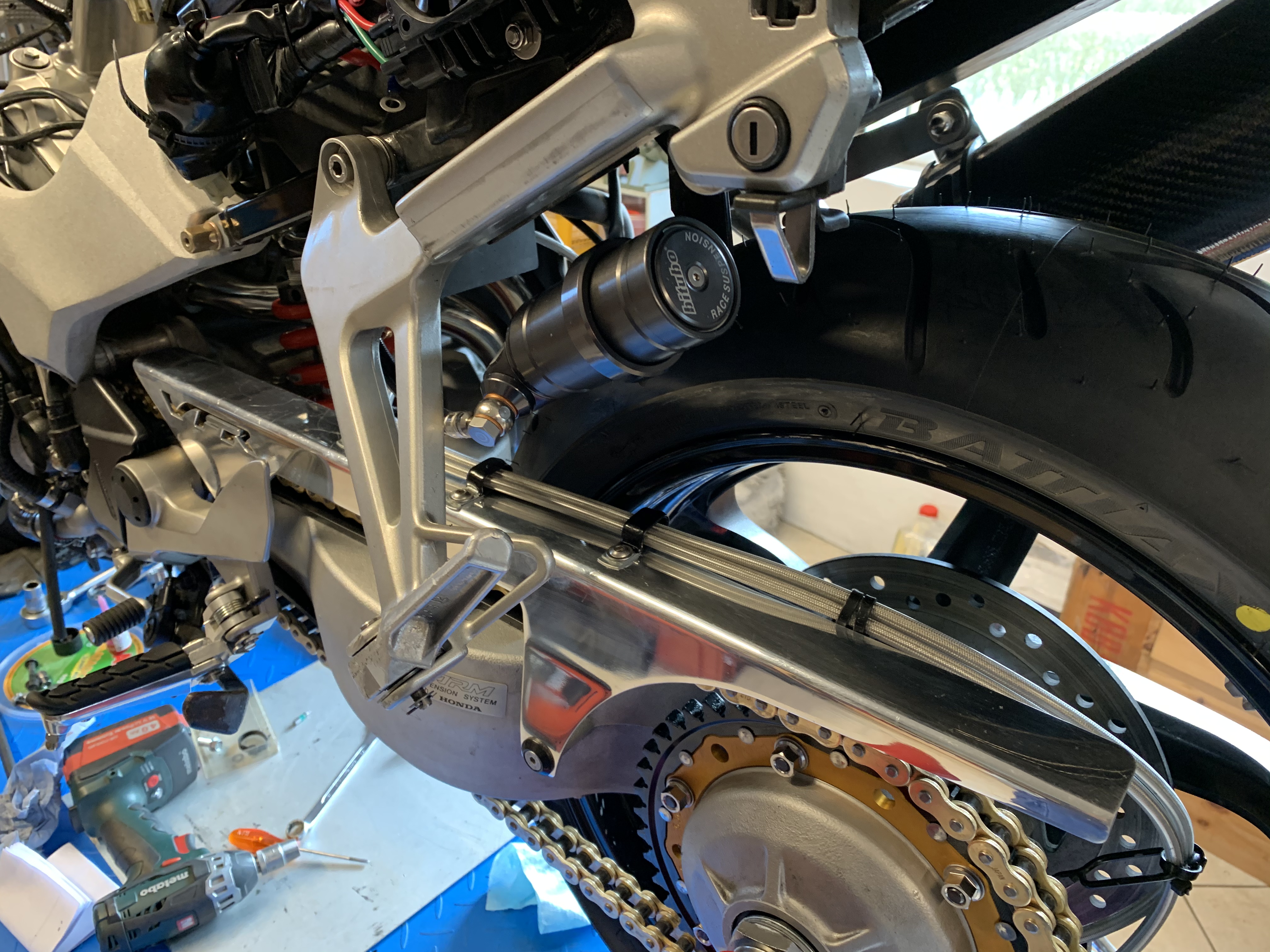

Instead I vent with: H0091CLU11 BITUBO REAR SHOCK ABSORBER HONDA VFR 800 (NO ABS) 1998-2002,found it on eBay, custom made in my spec , fully adjustable. Haven’t looked back since 🙂
