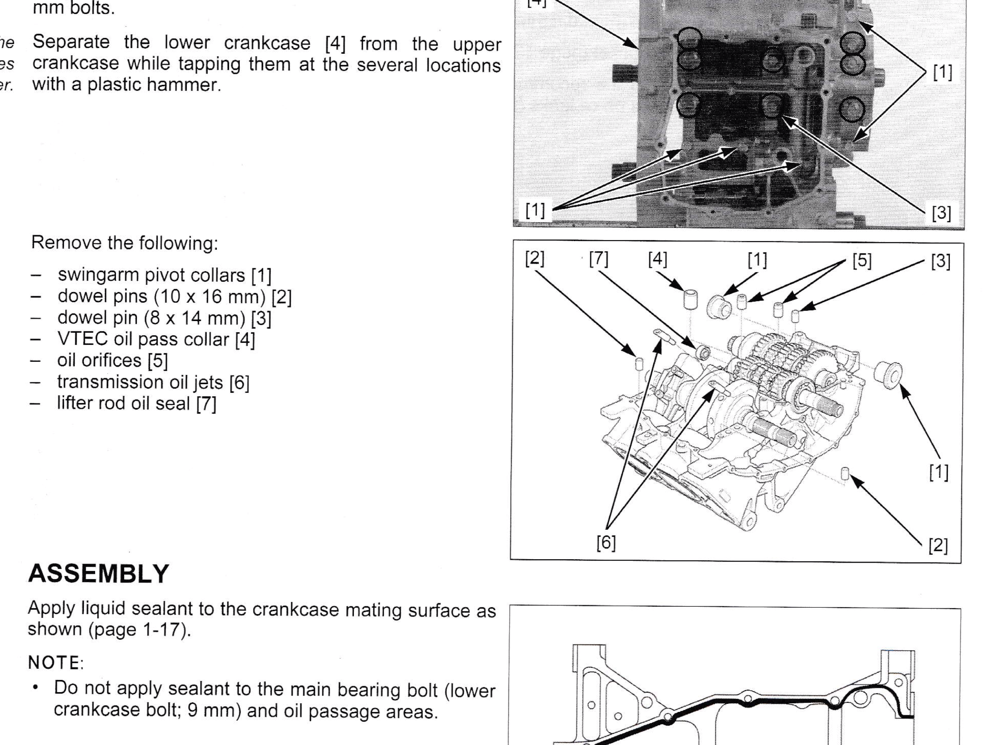

OK got it. Crankcase lifter rod oil seal Item 7 in the drawing. That's a bit of bad luck, haven't heard of one of those failing.
Same part numbered seal used in 3rd, 4th, 5th, 6th and 8gens!
Good luck, hope they sort is asap for you.
Am I the first 8th gen that seal failed on?  I searched the boards, and saw a few 85/86 vfr750's  had it, and a very few fifth gens.
After looking at the blueprint, yep it's gotta come out.

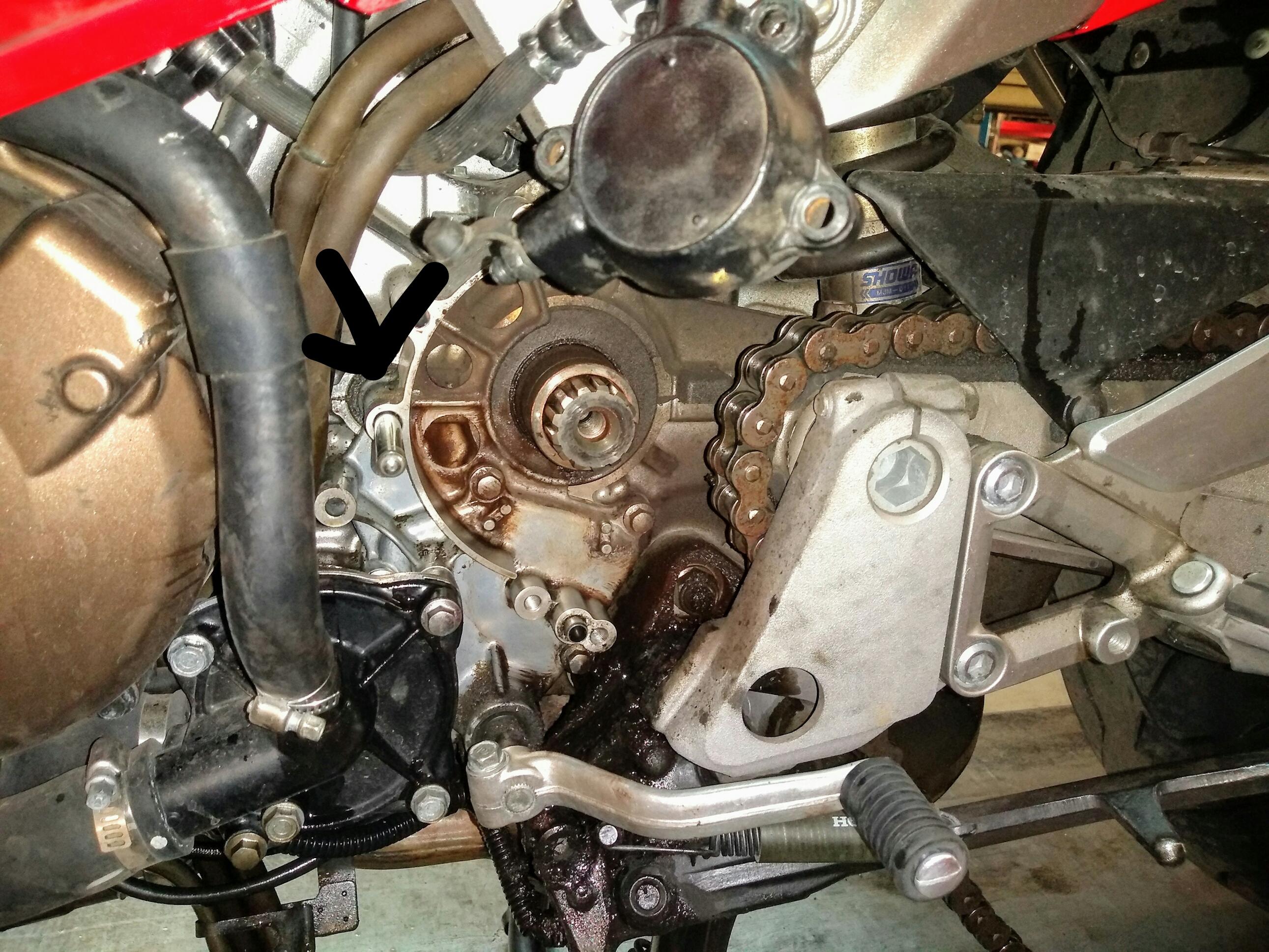

Seal failure on a VF500F2
Manual says to drop and split the engine to fit a new seal
But instead a Dremel was used to grind away that "ring" on the carter and we popped in the new one with some sealant on the outside. Years and some 30,oookm later is still is perfect.

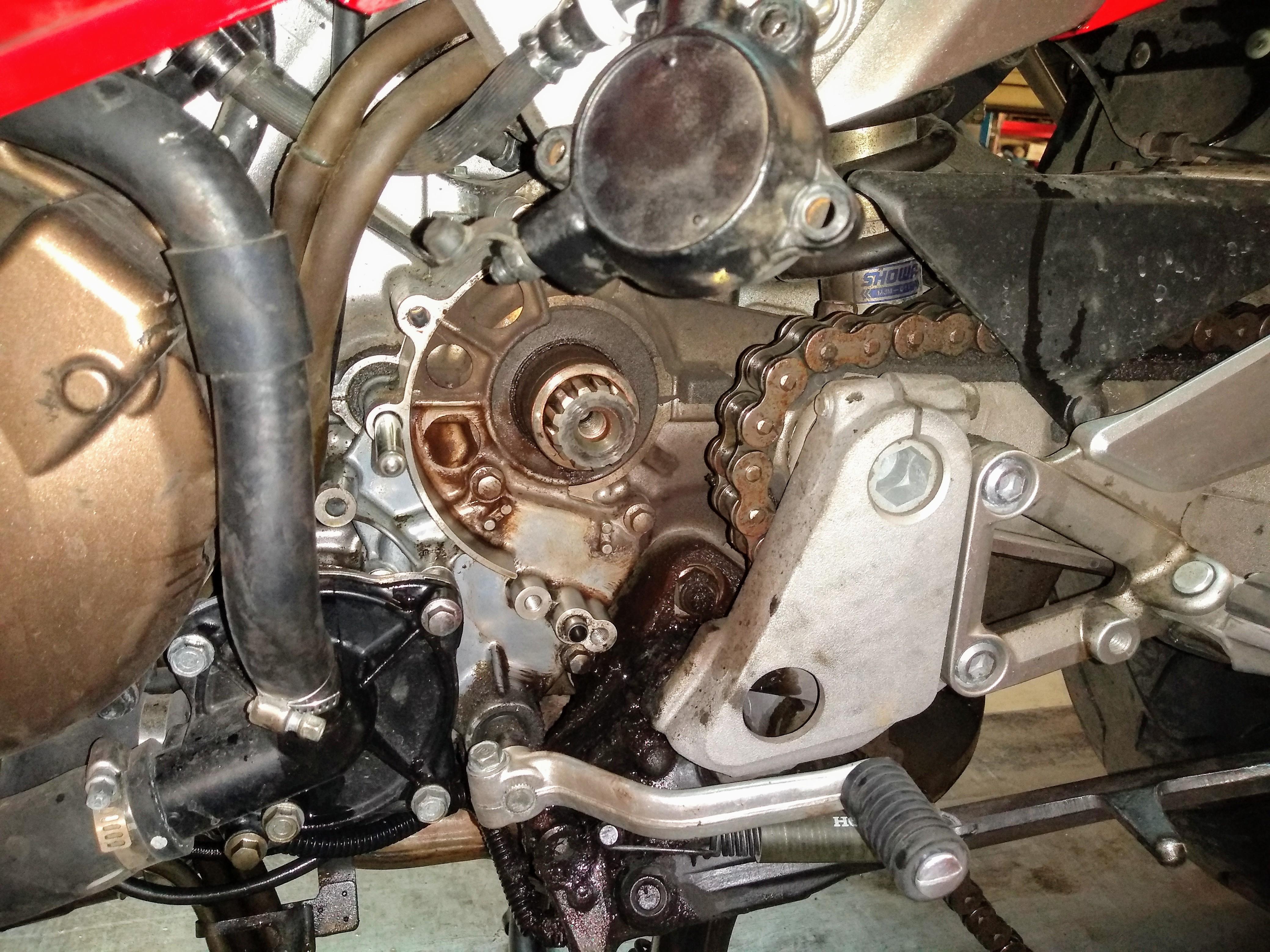

Sorry it took so long to reply, but I wanted to update the thread.
I'm back home and my VFR seems fine.  The seal turned out to be ok, but the shaft was the problem.  It had become scored where it contacts the seal, and the pressure behind it was high enough to cause the leak.  I'm going to order a new shaft, and when I change it out, I'll reflip the old one to see if I can recreate the leak.  At least it's all sorted out for now, and I'm sure glad we didn't have to perform any major surgery.  All in all, very strange, and unexpected for a vfr.
