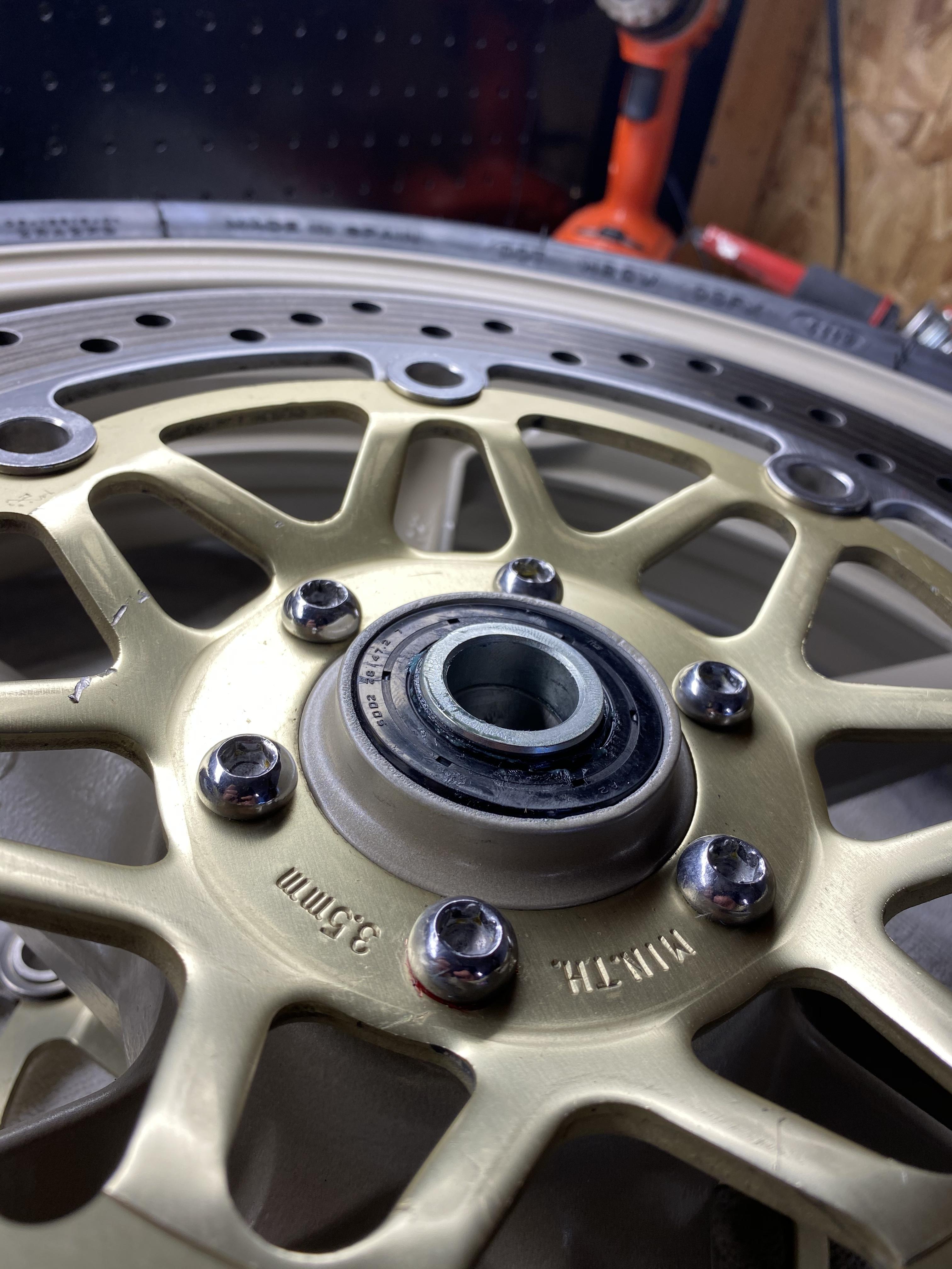

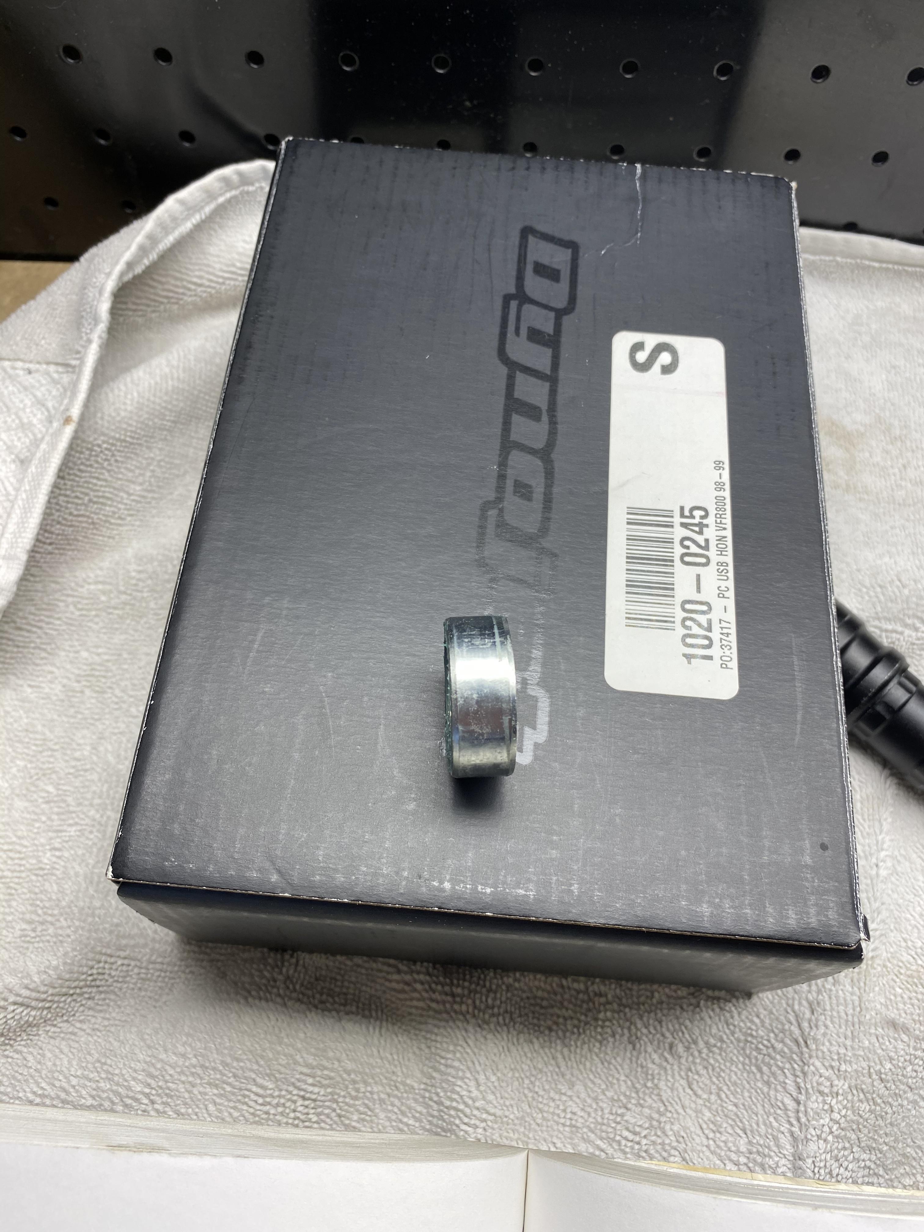

Manny78 Posted August 16, 2020 Posted August 16, 2020 Gentleman Need some help with a wheel spacer. This is the front left spacer. Seems much too skinny and fits very shallow within the dust seal. I noticed two spacers are available for the front right on the usual sites(partszilla, bike bandit). Is this the wrong one? Of course I can’t find the old one to compare. Thanks. Quote
Member Contributer Dutchy Posted August 16, 2020 Member Contributer Posted August 16, 2020 On the 4th gen at least, the spacers are a different size L/R... Quote
Manny78 Posted August 16, 2020 Author Posted August 16, 2020 Thanks. I found the issue. Didn’t have the axle pounded in far enough. Quote
comradeQuestion Posted August 16, 2020 Posted August 16, 2020 Make sure the forks are the same height in the triples. I had a really hard time getting the axle all the way in and it turned out that one fork was 0.5mm higher than the other. The axle went in fairly easily after I fixed that. Quote
Member Contributer Terry Posted August 16, 2020 Member Contributer Posted August 16, 2020 Yeah, don't pound on the axle; it should be a slip-fit by hand if the forks are reasonably aligned. Worst thing is by forcing the axle through, you might push the nearside fork inwards and that causes more binding of the bushes and also a slight wheel misalignment (bike may pull to the other side). Once the axle bolt is tightened, leave the clamps loose and give the forks a good bounce to help the loose leg find its natural (and aligned) resting place. Then tighten the clamps. 2 Quote
