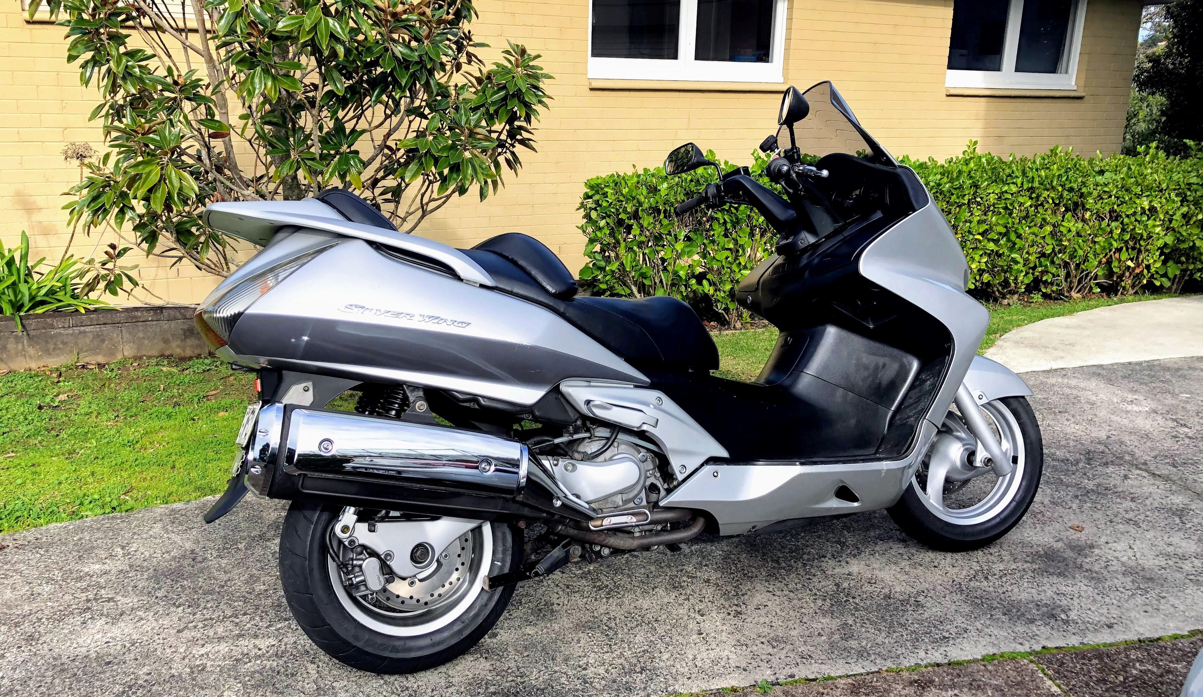

My question is, with a dodgy alternator that is not producing any power, how low can the battery voltage drop before the bike becomes unrideable? As a project, I bought myself a 2001 FJS600 Silver Wing scooter with a known electrical fault which turns out to be a failed alternator. Thanks to COVID and living in New Zealand, I've had a frustrating time ordering bits and pieces to get the bike roadworthy and so far have failed to get an alternator shipped to me. As a result I've been riding the bike on battery power only. I put some LED head and taillights in to reduce the power drain but obviously the fuel pump, injectors and ignition system still need power to keep running, so what is the lowest voltage I can go to before they stop working? I've recently fitted a voltmeter (hey, I was also a VFR owner, I know about these things!) and have observed a battery resting voltage of 13.3V (freshly charged) which drops to 12.4V on starting, and then tracks slowly down from there. Yesterday it got down to 11.6V after 45 minutes riding and was running fine, but before the LEDs and VM, I managed to ride the bike to the point of dying (wouldn't idle/stalled plus warning lights for low oil pressure and excessive coolant temp), fortunately just as I arrived back home.

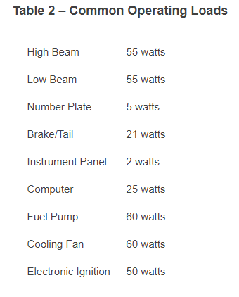

It is a combination of how much ampere your battery holds and how much watt you use...
Say the 12V battery is a brand spanking new one that holds 12Ah  (note that this drops as the battey gets older)
Say it holds 10Ah (ampere hour) from new
You switch/took off all the lights and -this varies per motorcycle- say you use 150 watts (your cooling fan on 50% of the time.
150w / 12V = 12,5Ah
so expect 10Ah (battery)  /12,5 Ah (usage) = 80% of one hour, so ~45minutes
Use 300 watts?
300w / 12v = 25Ah
Battery 10Ah / 25Ah usuage = 40% of one hour so 24 minutes
