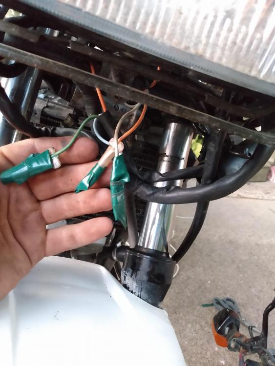

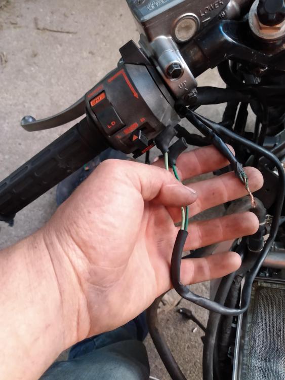

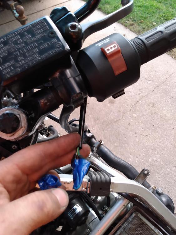

There are wiring coming out of either side of the handles, initially I thought them to be for the indicators but when I split them apart the bike would turn over.

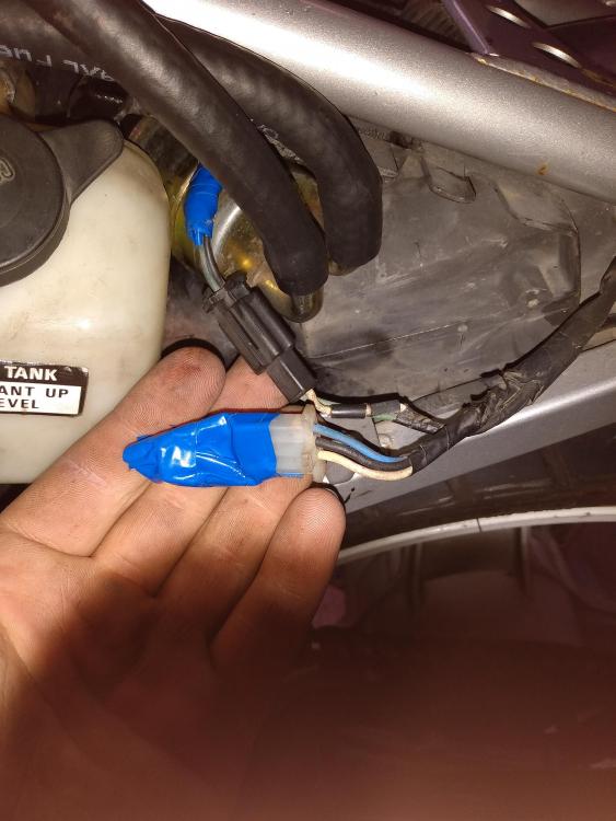

Im not even sure what this connection is for, rear turn signals?IMG_20190812_195732474.thumb.jpg.37b8de7b2227588959c64ea8ab809f15.jpg

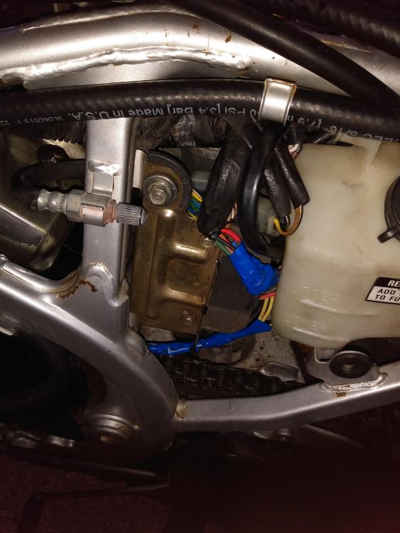

The panel has been ground down and a lot of the connectors have been splicedIMG_20190812_195752370.thumb.jpg.ab817268fb86fc5c5ce0c2042687134a.jpg

I'm sure that 3 pin White connector with the Blue, Black and White wire is for the Fuel Cuttout Relay, which is probably bypassed.
The Green and Light Green wires in your left hand are most likely the Horn Switch wires.
The pair of wires on the right hand side the Green/Yellow and White/Green is the front Brake Switch.
Your wires at the front of the bike are most likely your Blinkers and Position light. Left Blinker is Orange, Right Blinker is Light/Blue, Position Light is Brown, the Green is the ground return.

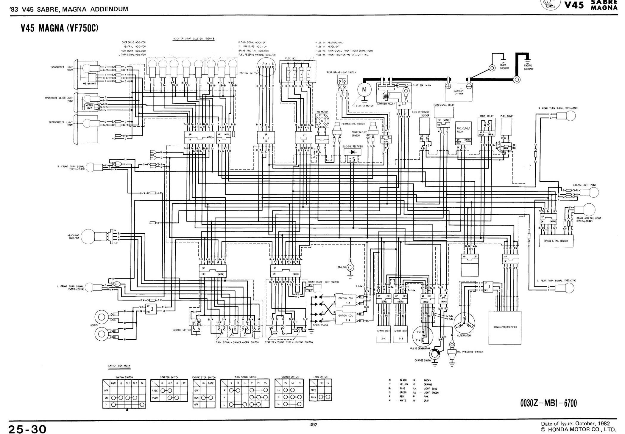

Got this info from a Magna V45 VF750C drawing (see attached) probably similar to your bike, couldn't find anything exactly for your model 1985 VF500.
Assume you mean "bike would not turn over" = probably clutch switch wiring.

The fan is "hot" when you turn on the ignition on and is switched ÖN"by the ground wire coming from the thermoswitch.
If you run a wire from the ground terminal of the fan to any ground on the bike and you turn on ignition to should spin.
I've put a on/off switch on said line you I can decide when to run the fan myself
The tempearture gauge in the cluster is trigger by a ground wire coming from the thermostat housing (besides the front right cilinder)
