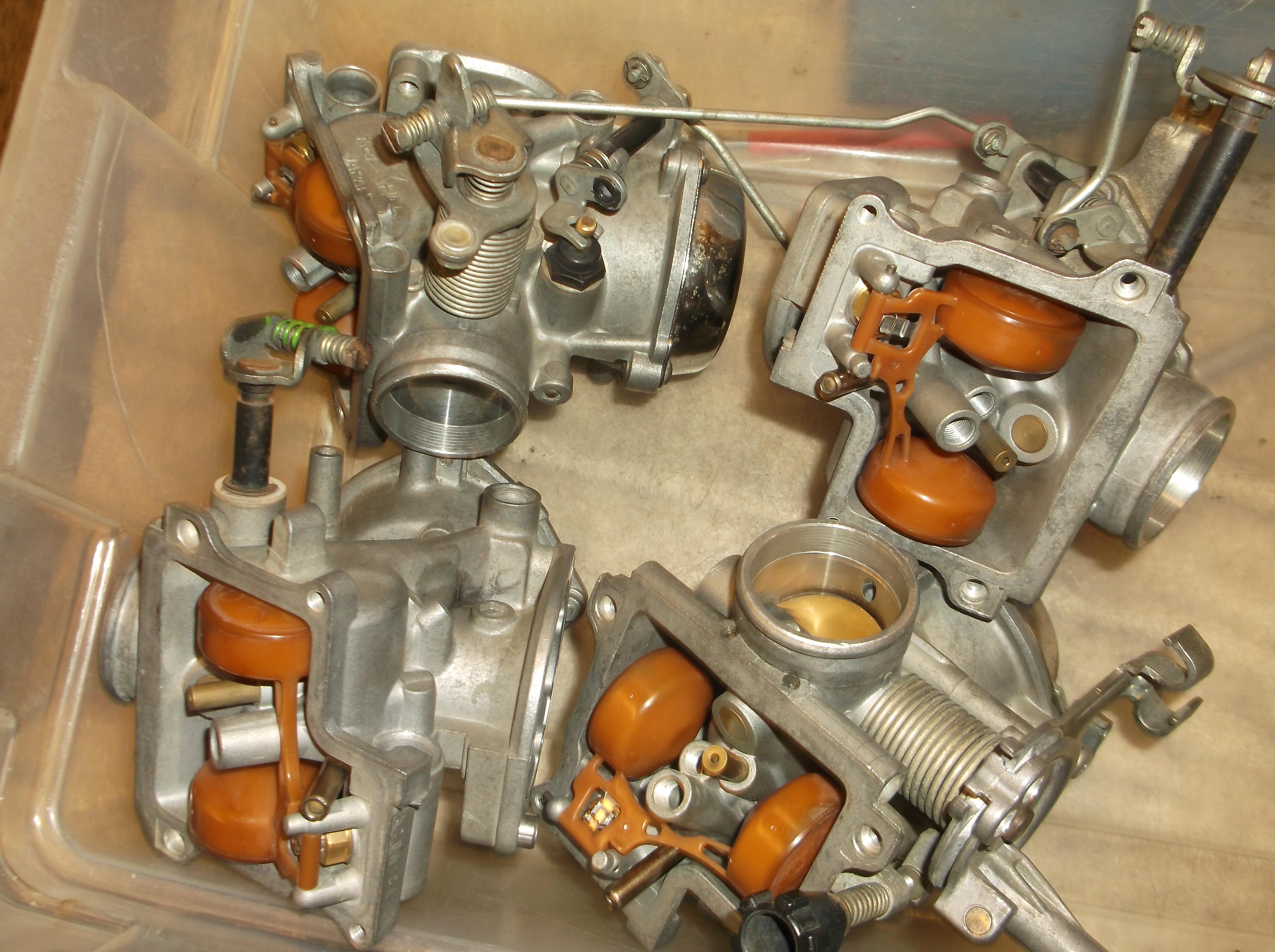

I have the carbs pulled but don't know exactly what I'm looking for next as I've never worked on carbs before. Sure have gotten to smell a lot of gas though. If anyone can point me towards a carb-newbie resource or walk me through what's next, that'd be great.
vfrw has a good carb cleaning thread. use proper tools, don't be careless as carbs can be damaged easily. if you want professionally-done work, box the carbs and send them to me, good results guaranteed. i have a set of gen3 carbs just rebuilt with new O-rings and bowl gaskets for sale and ready to go for $300 + $18 shipping.

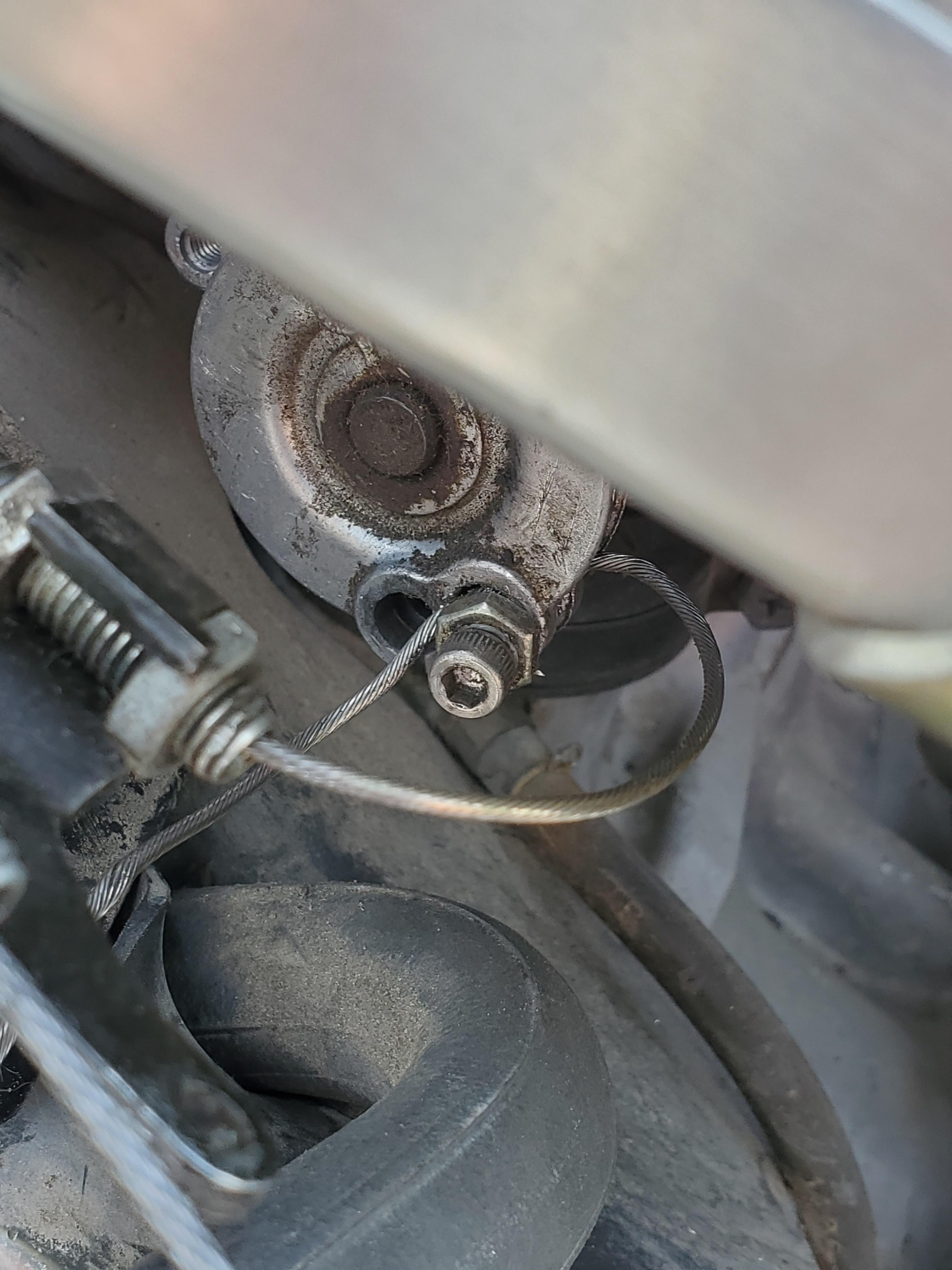

Another question because the bike is stored an hour away and I can't mess with it right this second.
The previous owner rigged up this very innovative pinch bolt setup for one of the throttle cables. Is the cable that comes over the top 'push' or 'pull'? I had to cut the cable to get that nonsense out.
16 hours ago, VFRJake said:
The previous owner rigged up this very innovative pinch bolt setup...

Hmm, the routing of your throttle cables looks completely wrong. The bracket should locate the cables ahead and in-line with the pulley on the carburettors. Can you post a photo(s) showing more of that area?

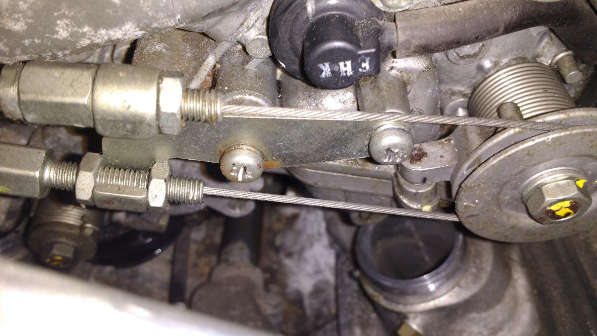

This photo from Reviving a 1994 VFR750F shows their orientation. Note this is from a '94 VFR and the service manual indicates some differences  between the '90-'93 and the '94-'97 models. It appears the throttle shaft rotates clockwise so the lower cable opens the throttle and the upper one closes it. There is no push function with the throttle, the second cable is just a braces & suspenders back-up should the throttle spring be unable to close it.
Yes, I was thinking rich as well, but not sure why. The cables are all goofed up in the photo because I removed the bracket that holds them in line and was trying to get the top one through that bolt area. I need to buy a new top cable, and they seem to be listed as either push or pull when I search. I'm guessing pull is correct and pull = open.
