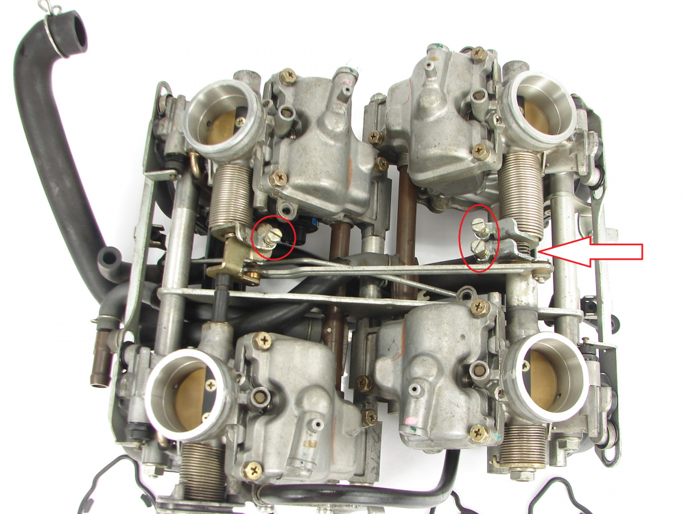

Member Contributer COS_VFR Posted April 9, 2019 Member Contributer Posted April 9, 2019 If you take a look at this picture, I think that #10 and #12 are between the throttle linkages. I drew an arrow pointing to the one on the right. The one on the left is hidden in this picture. 1 Quote
WGREGT Posted April 9, 2019 Author Posted April 9, 2019 1) WHERE did you find that foto? Amazing. 2) I'll look and report back. Quote
WGREGT Posted April 9, 2019 Author Posted April 9, 2019 If that IS where it is, it's super odd that its just held in by....tension maybe? Quote
Member Contributer COS_VFR Posted April 10, 2019 Member Contributer Posted April 10, 2019 The photo is on VFRD, but hard to find. When I am searching for pictures on VFRD I use google and the site: option, like this: site: www.vfrdiscussion.com carb Then pick images at the top of the page that google returns. The site: option will just search the website that comes after 'site:' 1 Quote
WGREGT Posted April 10, 2019 Author Posted April 10, 2019 Boom! That's it! Found out where it went, thanks to your foto, Cos. I knew it had to be held in by tension somewhere, and that's exactly how it's held. It does have a slight "bump" on the inside ends of those metal tabs in order to hold it in, but once I saw one side the spring and one did not, that was my clue. Thanks again. Now I can sleep at night! 1 Quote
