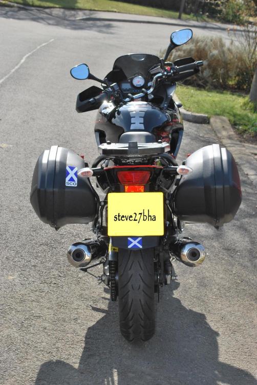

steve27bha Posted February 4, 2019 Posted February 4, 2019 On 2/2/2019 at 1:05 PM, JZH said: ..... but ISTR there is one GiVi side case system that looks like the Monokey, but has a different spacing between the two posts/slots. .... That is probably the V35 case rack - it has a curved back to use the space below the seat. The rack as well as being curved has a different spacing/size to the three box mounting points, but which look standard on first view. I don't remember the exact differences but I considered modifying my standard flat-back Monokey E21 cases with some form of false base to fit the curved rack and cases that came with the bike (a TDM900A), but found it was not possible. I got standard Monokey racks instead. Still got the curved racks and V35s - actually Kappa K35s, the cheapo versions. The standard Monokey side racks are the PL range, the curved ones for the V35s are PLX Pic shows the K35s on their rack, and a Monokey plate awaiting a top box. 2 Quote
