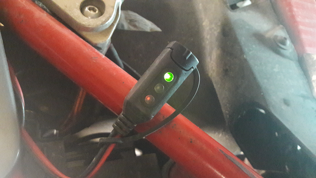

bdouvill Posted November 12, 2018 Posted November 12, 2018 Hi guys, Problem is happening on my 1992 Bandit 400, not on my VFR 750 but I cannot find out what is wrong so I am asking for help to all tech gurus spending some of their time here 😉 Bike is 26 year old, 101 000 km on the odometer. In the 8 years of ownership, I synch'ed the carbs many time (improving my technique each time), I have rebuilt the gear box (faulty output shaft bearing) and more. Work(ed) like a charm until it spent one night outside more than 2 weeks ago (so late October): bike was under an external shelter, outside temperature at night was probably around 10 deg C, some humidity in the air. I live on French Riviera so temperature had nothing to look like Alaska nor humidity like Borneo or Java. It should not have been an issue. Here are the symptom: 1/ most obvious: instead of requiring to press the starter only once, it now needs to press it 4 (long) times until it fires. Then it fires shyly to warm almost normally. So once started, everything seemed fine. 2/ since that happened (almost 3 weeks now), I noticed it does not fire 100% correctly so I can ride it gently as usual but it does not rev correctly when I rev it hard (which I never do). 3/ Now the super weird symptom: I have a C-Tek battery charger and a comfort connect indicator like this:https://smartercharger.com/accessories/#CTEK Comfort Connect Indicator Eyelet I noticed that once the bike is started, the Green LED is flashing (hopefully since the Reg is directly connected to the battery and is sending up to 15.0V to it's doing its duty) but at the same time, the RED LED is lightly lighting with intensity increasing with REVs (see the picture)... that is making me crazy. Battery is almost 2 years old and is cheap Chinese battery (less than 40€). Super funny: it is super hard to start with the starter but when I push start the bike, it fires within one second... So I am leaving with it since 2 weeks and a half now. #1 made me think about an air leak but that would rather happen when hot, not when cold. Furthermore, the bike does not die when warm. #2 made me think about fueling issue like enough to start but not the rev it properly but this is not really the case, I have probably ridden it for 200km since that. Poor fuel flow should have been more obvious (I think). #3 made me think about a current leak. That happened to me once and was more obvious: some sparks were going out of the spark wire to the engine case and I had the bike that rattled. I saw it (I mean I physically saw the sparks going to the engine case), replaced the wire and that was it. I spent 3 hours on Sunday to find such a current leak but did not find. I exchanged/swapped all 4 spark plugs, the spark caps and the wire but nothing changed. The RED light is still ligthly lightening when the bike is running. I tested with the stator disconnected but then only the RED light is fully on because I am draining the battery to run the bike. What I have not done is replacing the battery. I have no idea how I could spot some battery internal part that should have been damaged. I have an old battery that have been replaced because it did not hold the charge anymore but I believe the internals were not damaged (no shortcut or something similar). I am charging it fully today and will try tomorrow to determine whether the battery might be the cause or this should be something else. What do you think about my situation? Any clue about what could be the root cause? Other options are: - replacing the harness because I have another one in better conditions - buy brand new spark plugs caps because those are old. I also bought some NGK but they are too short, the angle is too close from the engine so they does not fit 100%. - buy new coils? I have no spare. - finish restoring my VFR (this is on-going) - buy another bike Thanks a lot in advance for your answer(s). Quote

bdouvill Posted November 14, 2018 Author Posted November 14, 2018 @zupatun I had difficulties to start the bike for 3 weeks now. But it started. I described those symptoms in the first post. And by searching for the problem, I accidentally let the petcock fully open on Sunday night (Nov 11th). I asked for help on Monday during the day (the 12th). Symptoms were only difficult start and weird behavior of my charger connector. On Monday night, I noticed the gas smell and found I let the petcock opened and closed it. I also saw gas contaminated the oil but did not think some could have stayed in the cylinders... At that point, it was not possible to start the bike (only click on the relay) nor jump start it. That would be normal if there's plenty of fuel still in the cylinders. On Tuesday afternoon (the 13th), so approximately 20 hours after I closed the petcock, I changed the oil for new oil and put a brand new battery. Same (new) symptoms: relay clicks (this is when I made the video )and no jump start possible. At this point, we might expect all fuel to have gone into the oil and no more in the cylinders but there might be still some gas inside the cylinders. Let's hope that did not contaminate the fresh oil. Today (14th), I believe I killed the relay (RIP) but I have another one that I will bring tomorrow and saw that starter is running when disconnected from the engine (when bypassing the relay). Tomorrow, I'll remove the spark plugs and see if with a new relay (or by pushing the bike) we can see gas getting out of the cylinders through the spark plug holes. Quote
