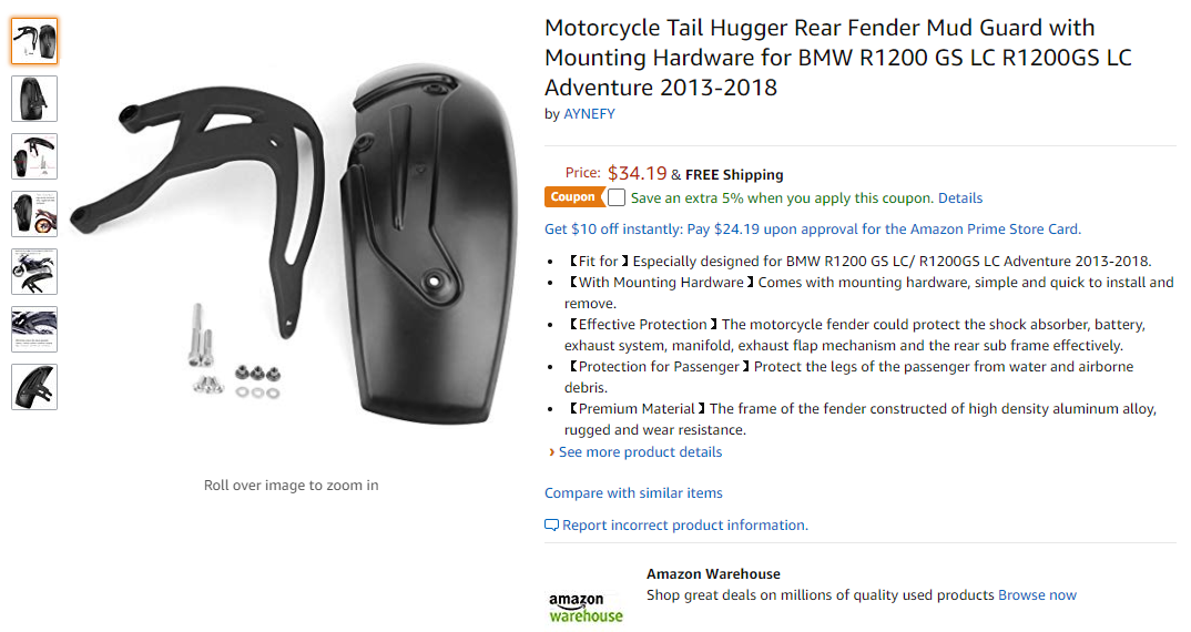

There are a few possibilities on Amazon. Not just the Puigs for $25. This one for a BMW caught my eye. $35.
It looks like the attachment frame is aluminum. I like that. Strong enough to hold the hugger in place without flexing or cracking. The mounting holes would not be in the right place for a VFR. I’d have to fashion a secondary aluminum adapter of some kind to mate with the swing arm.
The thing about any of these possibilities is I have to actually buy the hugger first, then try to adapt it. (re. comment by Dutchy, above) And I'm still smarting about that generic, and currently useless, switch pod set. 😉 I’ll keep thinking on it...

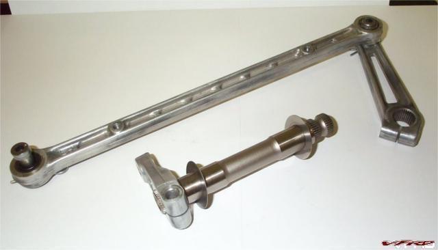

Meanwhile, how about this thing? 🙂 For the swing arm bling...it wouldn't have to actually function.
(JZH file image)
Edited by Gebruiker
bad image upload
You'd have to drill some holes in your swing arm and weld in some bosses to accept the cross-over shaft.  Other than that, no problem!
Ciao,
JZH
I'm there! You can imagine how eager I'd be to drill random holes in my swingarm...  :))  Couldn't I just use zip ties?

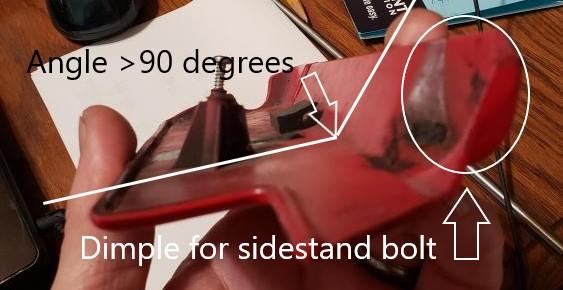

Sidestand Cover
I hadn't given a sidestand cover much thought until Auspanglish got me thinking on them last week.
My bike sure didn't come with one of these and I'm not even sure what its purpose is. Is my kickstand so ugly it needs to be hidden? I'm guessing this cover is the first thing to break off any VFR. What was Honda thinking using ABS down there on the side stand? I've yet to actually even see one in the real world.
Just the same when JZH and VFRCapn and others were good enough to upload a couple photographs, I was able to make up a crude facsimile...using my own homemade CAD(!) ... cardboard aided design. 🙂
The sidestand has two boltholes to attach the cover from the rear into ABS bosses...
But plastic bosses are hard things to make even for Honda! (...they seem to be the bits that break off...) so I just used a couple thru bolts from the front side. I'll clean them up if I make a workable piece.
I can't match the elegant lines of the originals but it is sortof okay. Is this what it's supposed to look like? The rest of the bike is so grotty down there it seems a waste to bother with it, but now it's in my head... I'd guess that 90% of the gen3 bikes I see in photographs are missing the sidestand cover.
My current idea would be to cut a 10 inch corner bit of PVC fence post, maybe. I'm thinking that would be sturdy enough stuff to hold up to a certain amount of abuse. It only comes in white, so if it works then owners of white VFRs will have an easy time of it. I'd have to paint. Always one more thing... I wonder if I can find a bit of black PVC fencing...

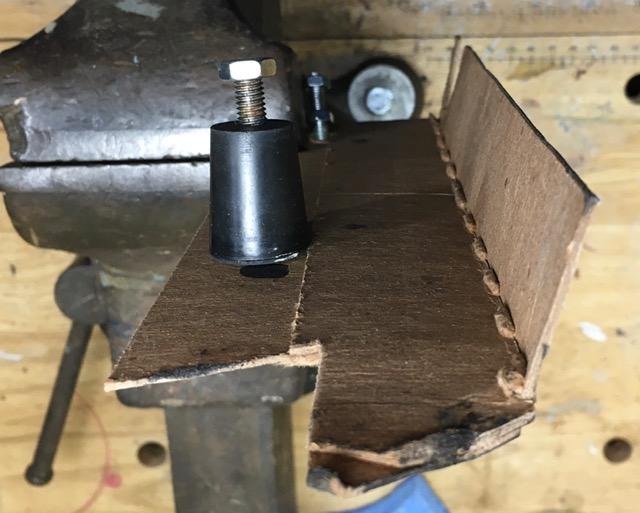

So I stopped by a fencing place not far from home and begged the guys for a scrap of fence. They were more than happy to point me to their skip with permission to root around inside and to help myself to their trash. I was hoping for a black scrap of fence post for my black-ish bike but only found white.
This is what I took.
It’s a remnant of PVC post, about a foot long (25cm). They had tons of it but I grabbed only enough for the job at hand. No point in being greedy. Just the same, they told me I could come back for more of their trash should I need it. Maybe they’ll have black next time.
The stuff is plenty strong as molded. The walls are 4mm thick. I can stand on it. Fencing PVC is treated for resistance to weather and sunlight. That’s good for a sidestand cover. The fence guys said it’s tricky to paint properly. You need to use epoxy paint and a sealant. Yeah well… I was thinking along the lines of some leftover black vinylwrap. Black duct tape? Or I could get the fancy carbon fiber kit, as recommended by Thumbs.
After the fence place, I went begging at the hardware store for carriage bolts or flask stoppers but they didn’t have any of those in their trash so I had to spring for them, cash money. About a dollar and a half. My total cash outlay for the sidestand cover project. As you might imagine, a single scrap post section provides enough material for four sidestand covers, so I’m all set for my next three bikes. Dutchy would be proud of me.
Here’s how it went.
I traced my cardboard prototype, (see entry, above) then cut the PVC with a regular jigsaw. The jigsaw blade worked fine. I didn’t even bother to sand down the PVC edge. I started out with a hack saw but that made a mess of it, and required physical labor to boot.
First fitting, still white. Adjust, tweak. I cut out the bit above the sidestand swing bolt where the original cover has a dimple, and trimmed the top a bit to clear the shift lever.
Back on the bench with rubber boss/grommet things, cut to the length given by RC1237V
Second fitting. It works! Yay.
Since the carbon fiber kit was beyond my budget of zero dollars, I had to choose from among leftover vinyl wrap, black duct tape or spray paint. I’m trying the paint first. It’s pretty certain to chip and peel. We’ll see. Remember that Krylon Fusion stuff I used on the fairings? No runs, no drips, no errors? It’s not so bad. The vinyl wrap I think would be far too shiny and fragile down on the side stand. And duct tape would look like...duct tape. If the cover actually stays in place for more than a week or two, then I’ll consider a more presentable finish.
I didn’t paint the carriage bolts. Probably a mistake. They are way too conspicuous to anyone who knows what the cover is supposed to look like. But if anybody out there has an original with broken bosses, my solution might be a cheap way to put things in order again. Sortof.
So then, where will it fail? PVC cracking? Bolts rusting out? Rubber stopper boss flange thingies? I’m hopeful that the strength of the PVC, and the built in flexibility of the rubber stoppers will give it a tolerably long half life. Longer than the originals even. But I’m not completely satisfied about my design yet. And it’s such a dumb little thing. If it falls off or breaks I’m not likely to bother making another. I don’t know whattheheck Honda was thinking in the first place.
