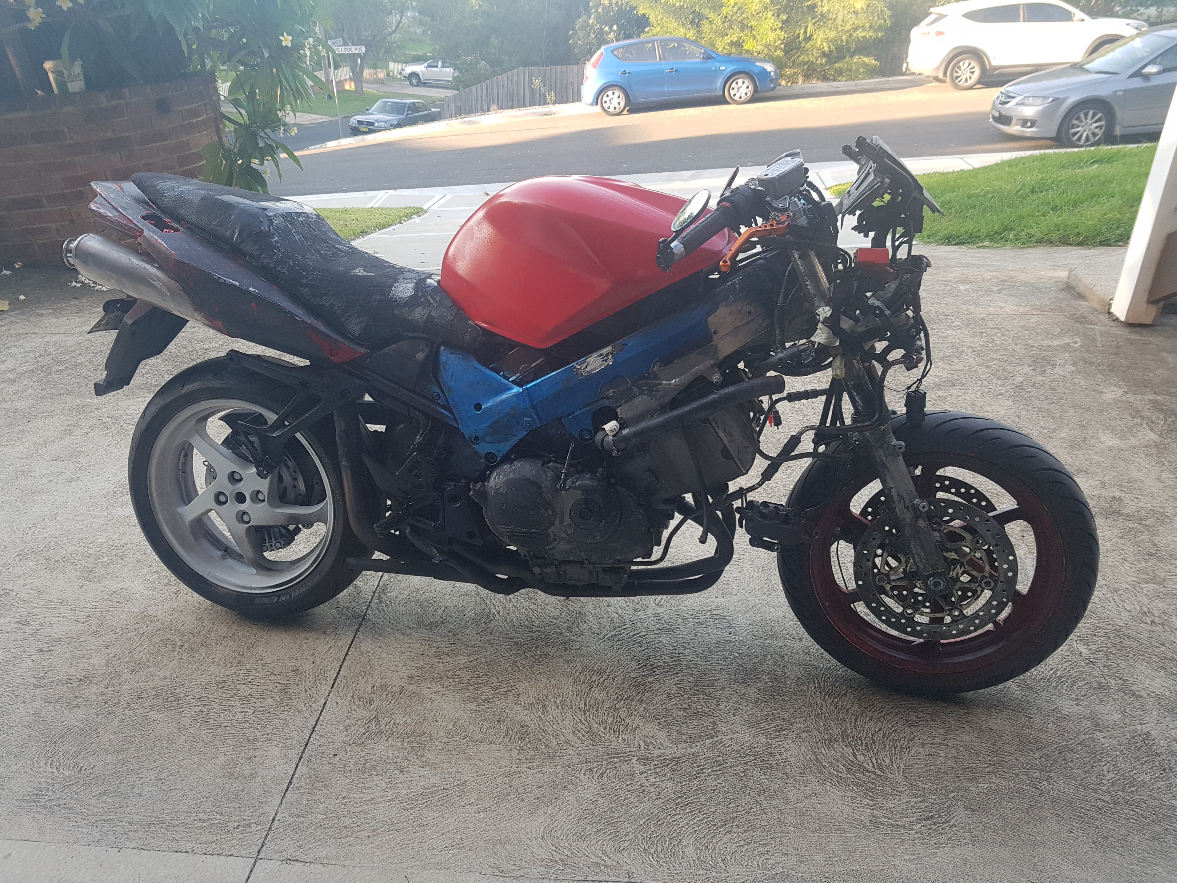

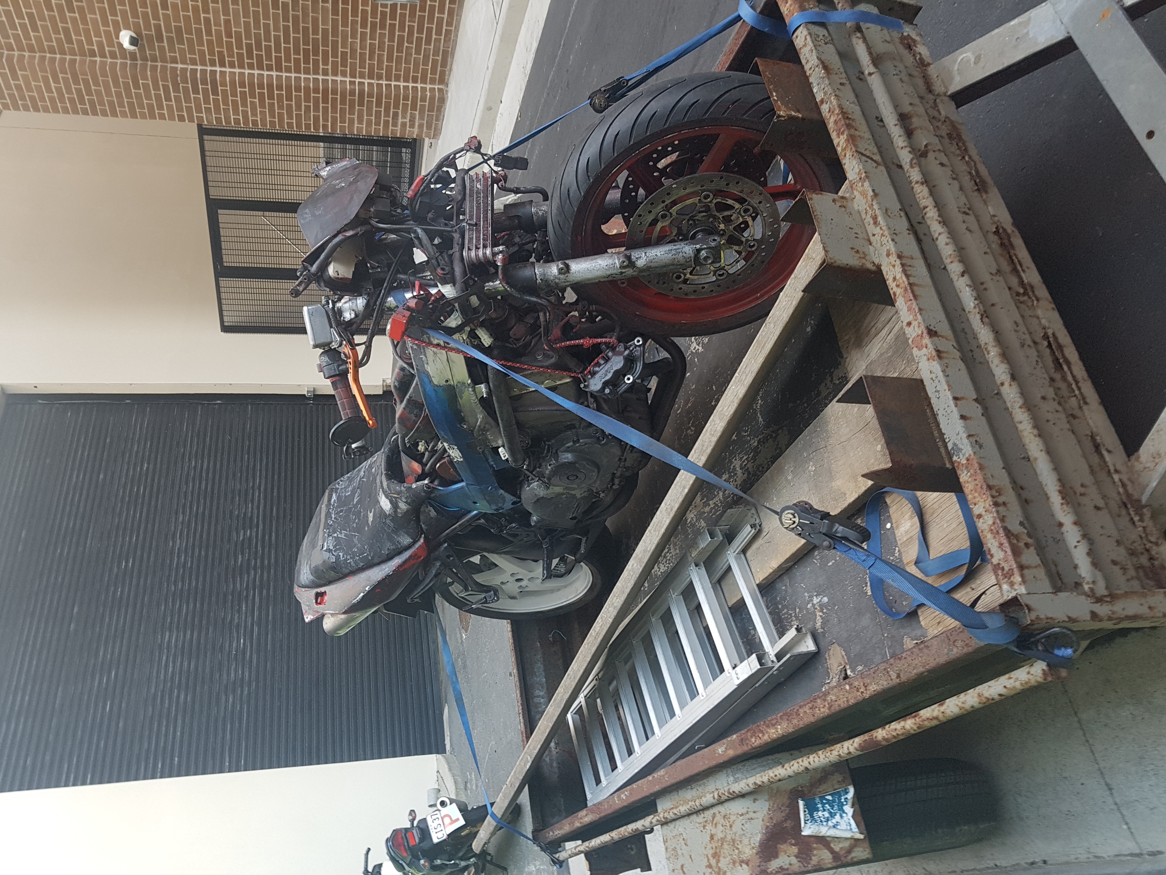

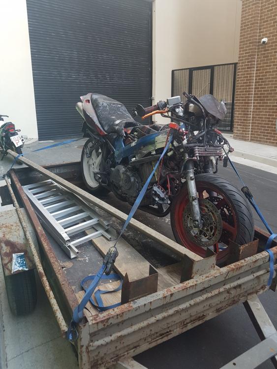

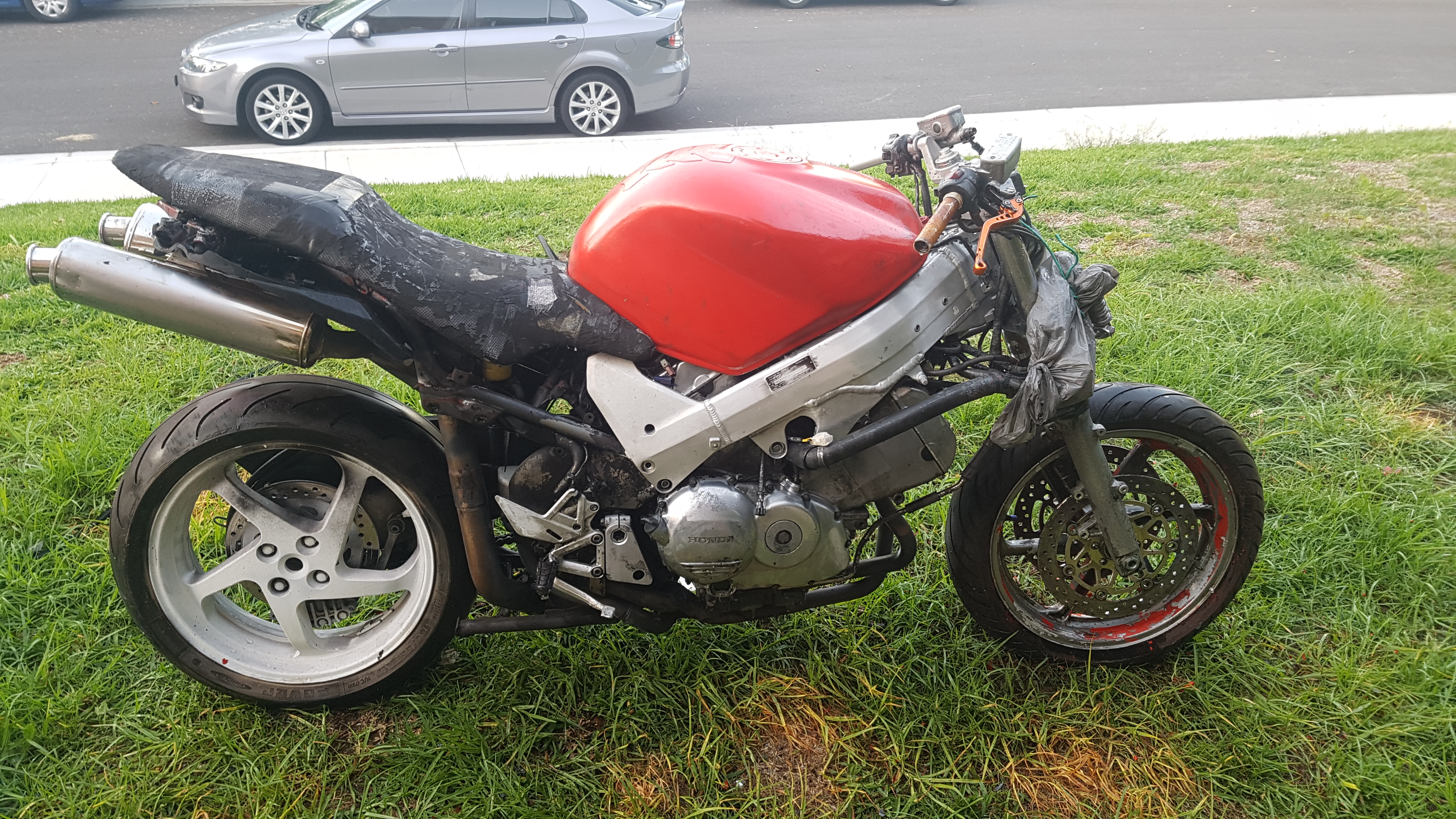

I picked up this unloved 2006 with 29k for $450AU, there is not many places on the bike which are not covered in red paint or black or white or some blue paint or a combination of all four.
Unknown condition of motor, will still be good for parts, considering I bought just a rear tyre for $300 last week
All fairings and headlight missing, fork seals leaking, brake calipers dangling of some string, tank has a dent on top that might pop out and many layers of paint, seat appears to be covered by an old wet suit.
It has staintunes and near new rear tyre, I like the white wheel, might keep that.

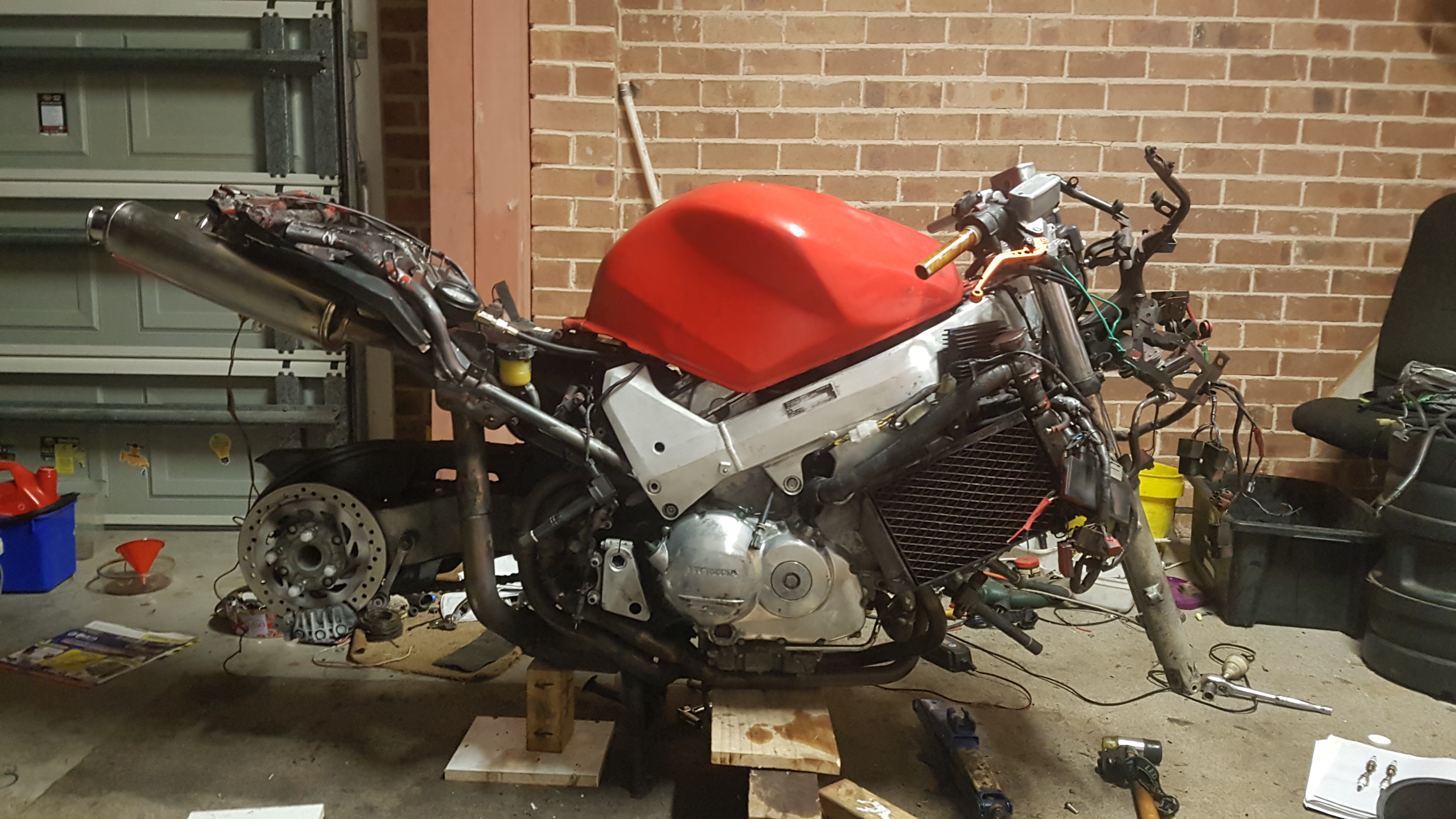

A couple of coats, a scrape then got out the pressure washer.
Charged the battery, installed the radiators, changed the oil, sorted out some electrics, turned it over, and she fired up.

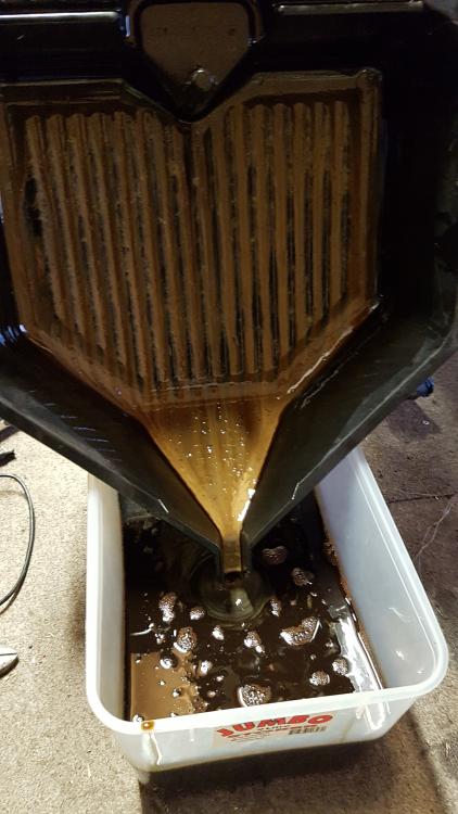

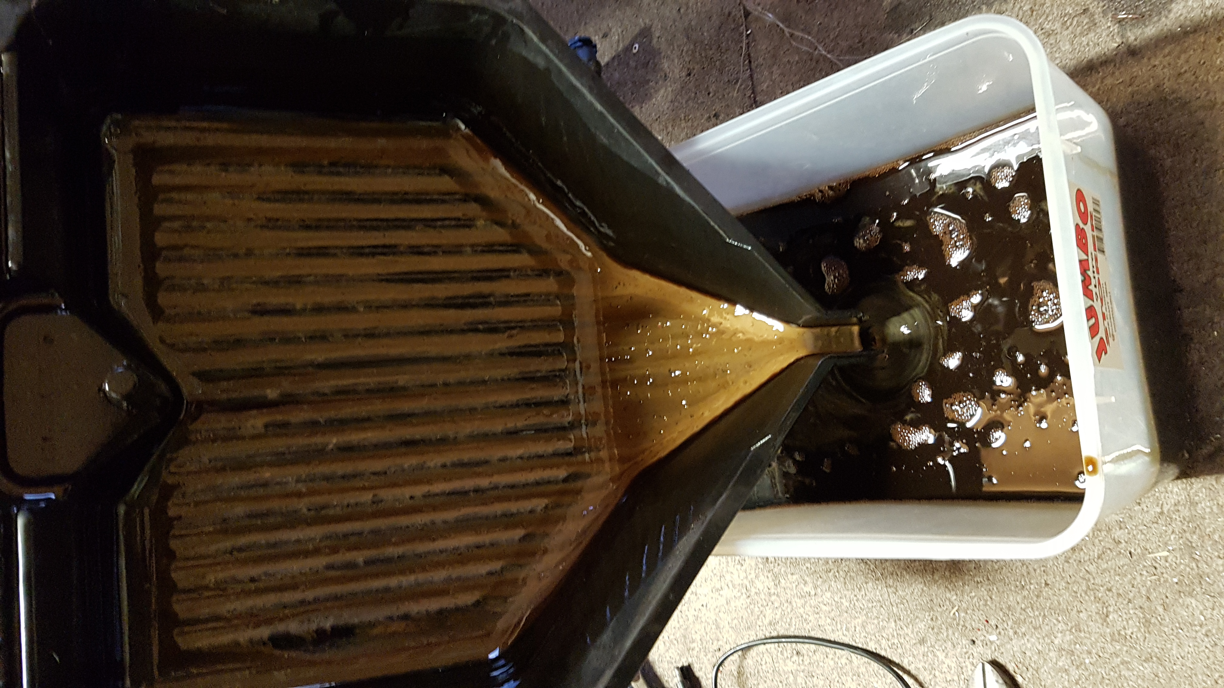

And pretty sure it has a blown head
gasket, lots of smoke, coolant level decreasing and milky coloured oil.
Did a compression test, 2 at 110psi and 2 at 125psi.
Easier to buy another motor but,
has anyone changed a Vtec head gaskets?
Rebuild is out of my league but would I be looking to do any other maintenance tasks if I change the head gaskets?
Plan to go naked with her.
Thanks in advance, all positive comments appreciated
Hold up on the head gasket job my VFR Vtec starts with plumes of white smoke, settles down after 30 secs, could the oil colour be from sitting and condensation, are you definately not loosing coolant outside engine?
Add a little oil to the low cylinders and see if value increases this will help tell if its rings or valve/head

I compression tested with a squirt of oil and it bumped up readings to @200psi on all cylinders, is that of any significance?

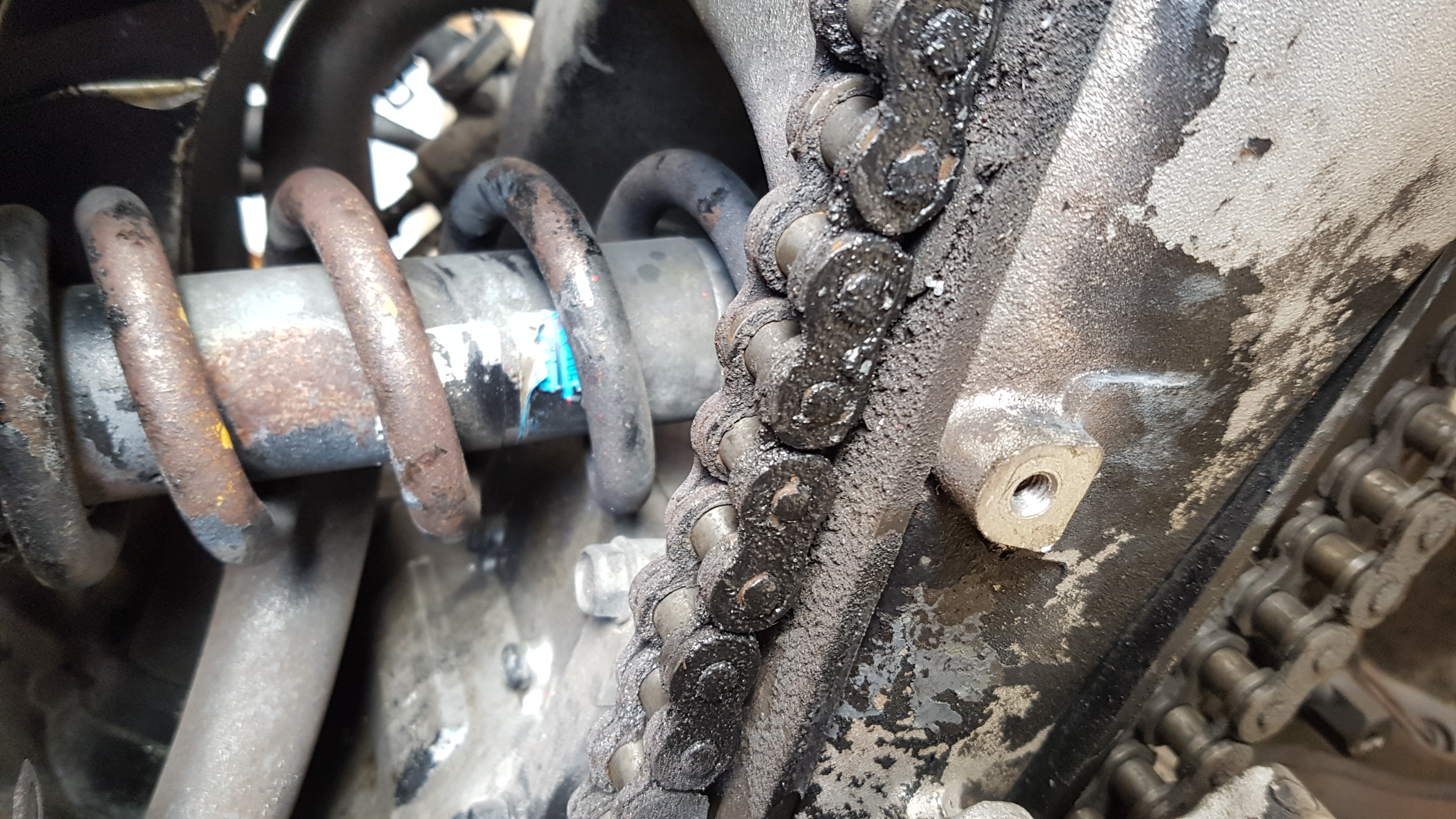

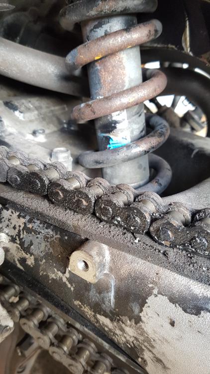

Black paint on the chain!

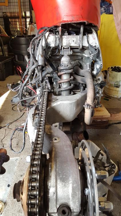

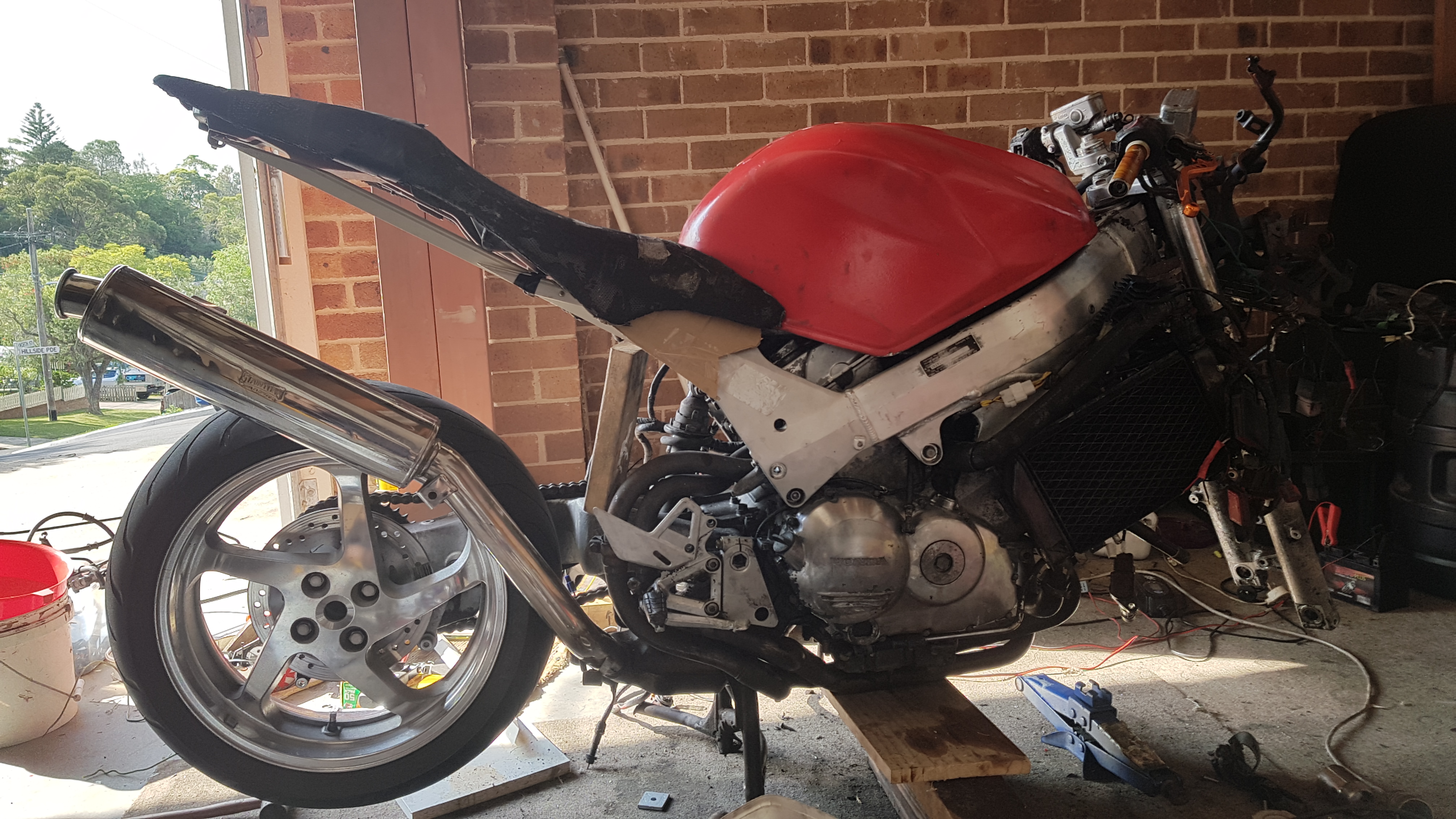

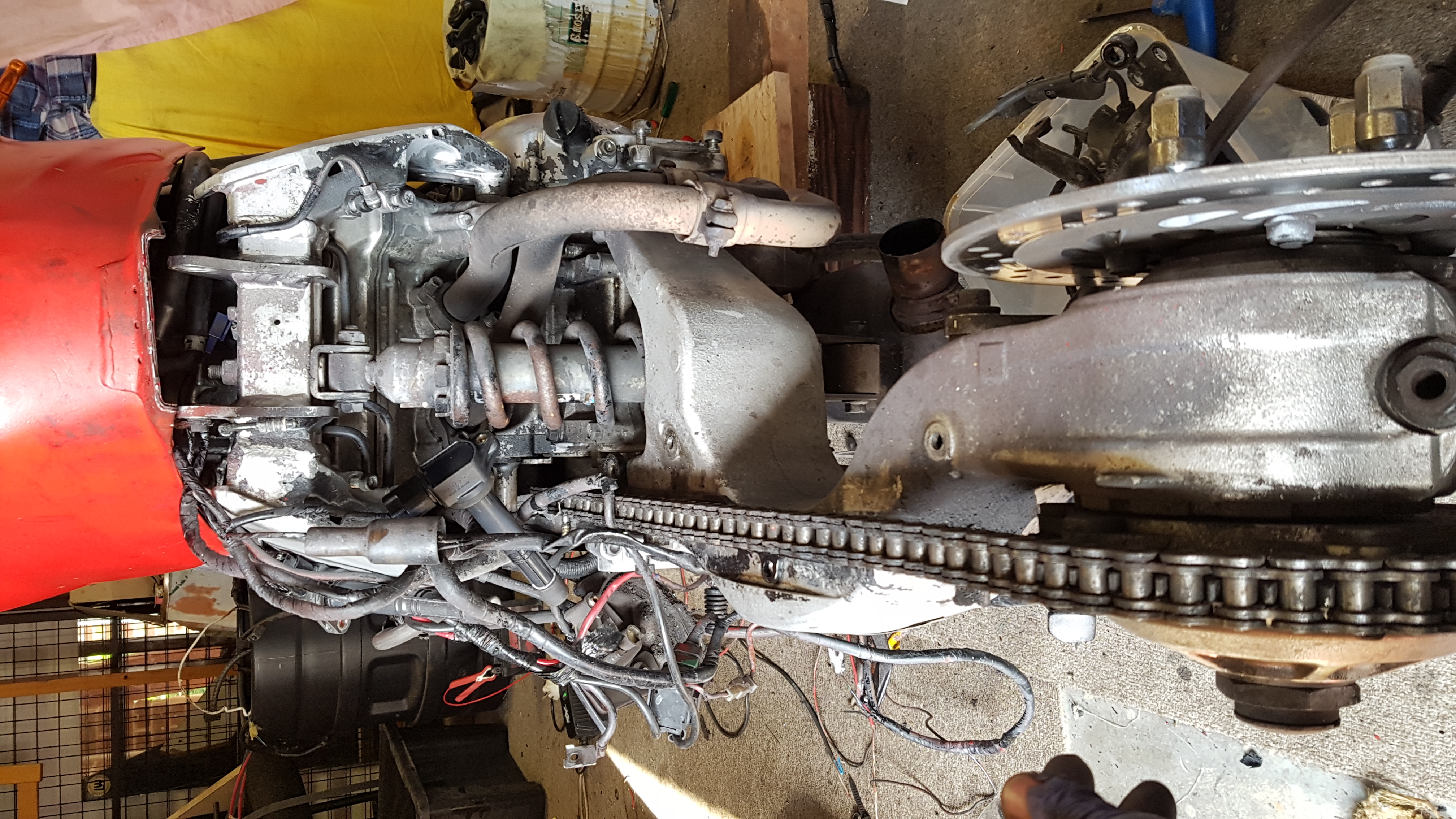

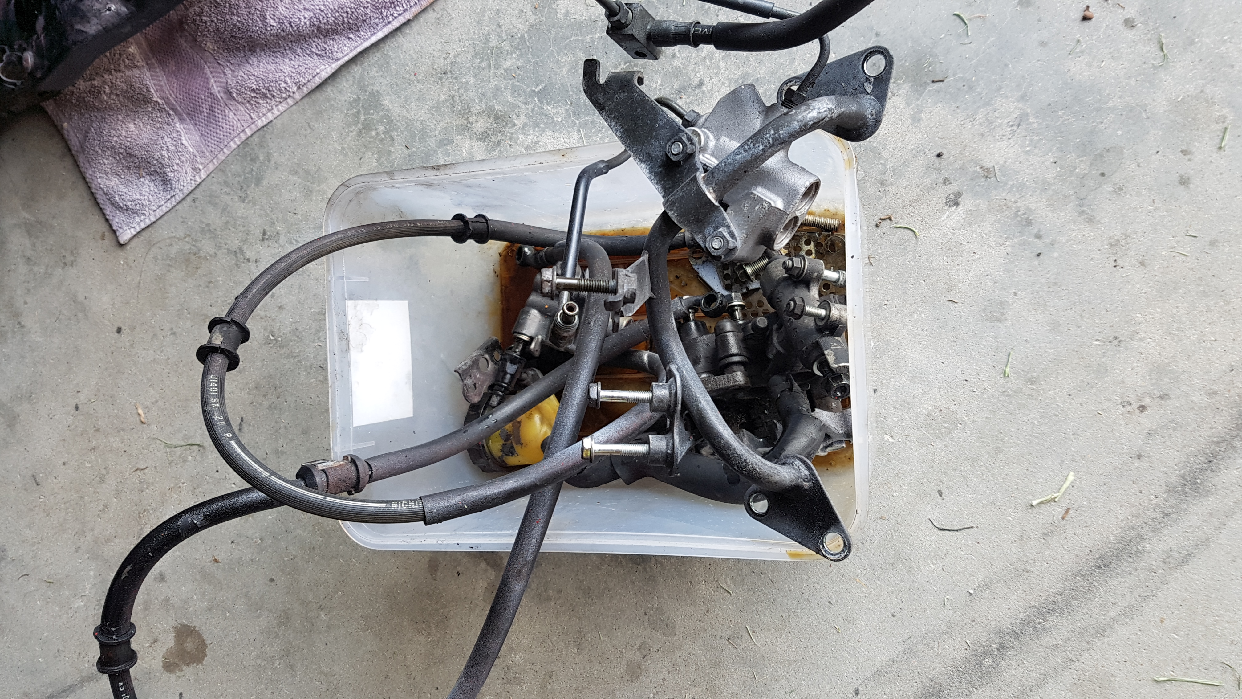

Removed the exhaust, rear fat ass subframe and linked brakes, the bracketry for the link brakes was Honda at there over engineering best.

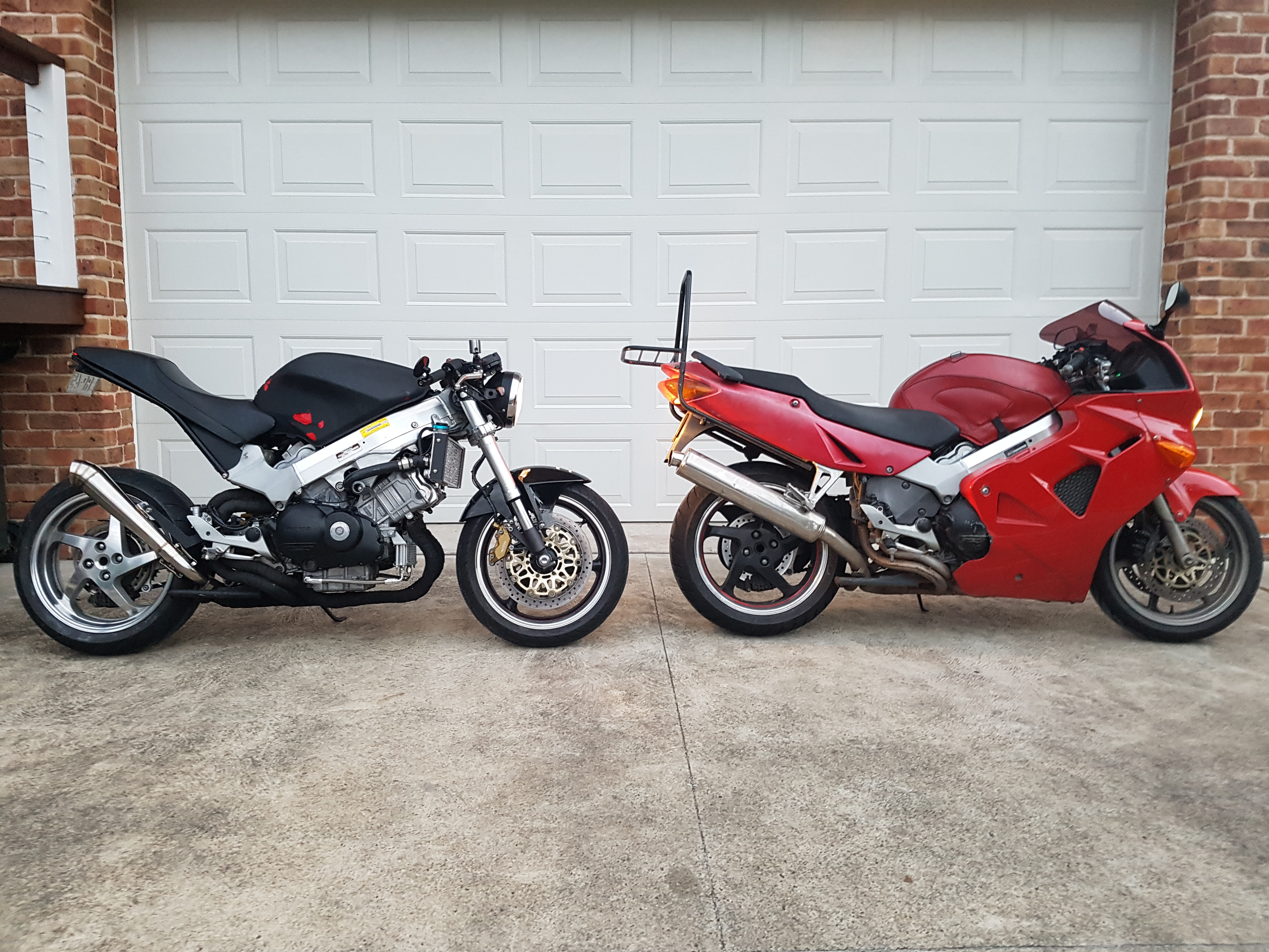

Considered putting a Triumph 675 rear with undertail exhaust but then came up with this.
Original seat, raised, diy subframe  , fibreglass undertailand and 5gen staintune.
I have a thing for 5 gens, clothed and naked.20171206_200059.thumb.jpg.6b3242013ce270d83a2c27c2b63ee419.jpg
Very interesting project, Halfrider. I don't think I've ever seen a bare metal clutch cover before - looks good.
Your 5th gens are cool. Which front end did you use for the naked bike?

The paint came off the clutch cover when I was paint strippping, now that you mentioned it, it mighr stay thst way. That a CBR 929 complete front end.
