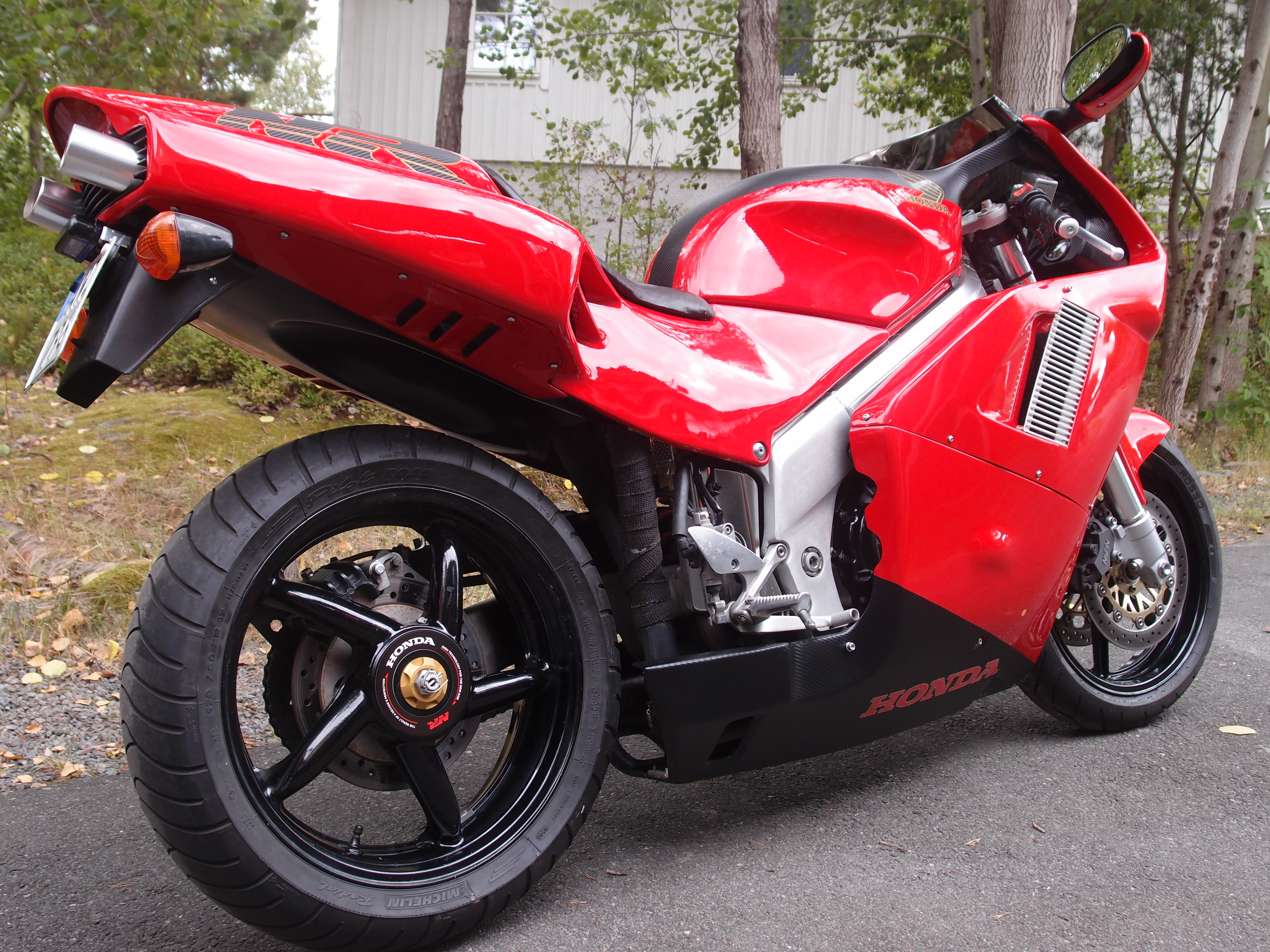

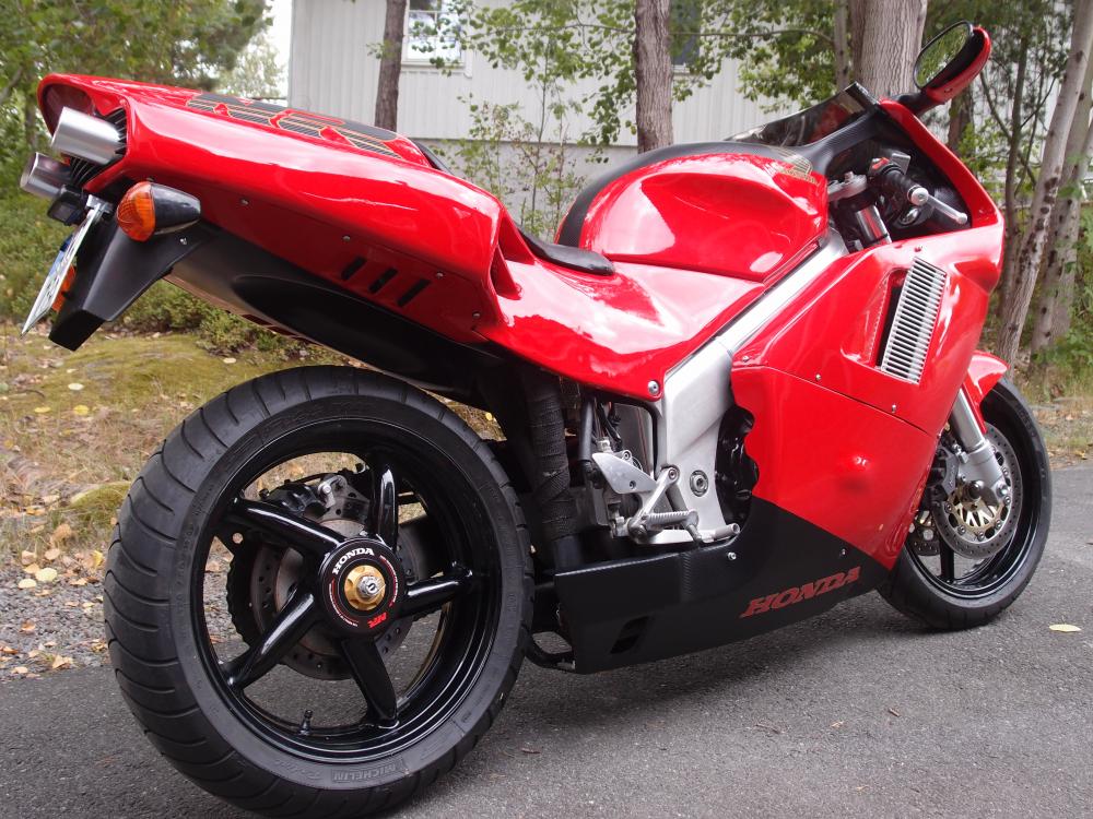

0 Member Contributer JZH Posted November 4, 2017 Member Contributer Posted November 4, 2017 15 hours ago, Lorne said: John, I like the decal on that rear wheel hub. Could you elaborate on it? I'd like to find something similar for my '09's white wheel. As Ken noted, that's my gen-u-ine NR rear wheel (courtesy of Yahoo! Japan Auctions many years ago). The decal is/was available as a separate part number from, CMSNL, but it needs a flat surface to stick onto. The replica NR in Dutchy's pic uses a 4th gen rear wheel (very close in appearance to the NR wheel) and some sort of lug nut cover, so maybe it would also work on a 3rd gen wheel? (I actually have a spare of this decal, as my original one is slightly damaged, which I could scan for you, if you like.) Ciao, Quote
0 BiKenG Posted November 4, 2017 Author Posted November 4, 2017 1 hour ago, JZH said: ... The replica NR in Dutchy's pic ... Ciao, Wow, I never even noticed that was not a real NR. Now I look closely I can see some differences, but what a great job. Based on a Gen 4 I guess. Is it Dutchy's bike? Where did those plastics come from? I want to make one like that Quote
0 BiKenG Posted November 4, 2017 Author Posted November 4, 2017 1 hour ago, JZH said: Sounds like a cool project. I can measure the engine mounting points on my frame (or you can simply borrow it), or spare engine. All you need is to find a 5th gen engine to play with! Ciao, We need to involve Mohawk. Hey Chris, care to measure up your spare 800 motor? Quote
0 Member Contributer Dutchy Posted November 4, 2017 Member Contributer Posted November 4, 2017 3 hours ago, BiKenG said: Wow, I never even noticed that was not a real NR. Now I look closely I can see some differences, but what a great job. Based on a Gen 4 I guess. Is it Dutchy's bike? Where did those plastics come from? I want to make one like that That bike was build by our member AndreasH from Sweden. Helweg from Denmark also build his NR; maybe he has finished the air scoops by now.. In choosing where to tour following my redundancy, the 2 NR's were key (as was Keny) in deciding on "the Ace of Spades Balic tour 2016"... Having a real one 3km from my house, I took some close-ups and measurement to help these guys... Quote
0 Member Contributer Lorne Posted November 4, 2017 Member Contributer Posted November 4, 2017 6 hours ago, JZH said: As Ken noted, that's my gen-u-ine NR rear wheel (courtesy of Yahoo! Japan Auctions many years ago). The decal is/was available as a separate part number from, CMSNL, but it needs a flat surface to stick onto. The replica NR in Dutchy's pic uses a 4th gen rear wheel (very close in appearance to the NR wheel) and some sort of lug nut cover, so maybe it would also work on a 3rd gen wheel? (I actually have a spare of this decal, as my original one is slightly damaged, which I could scan for you, if you like.) Ciao, Thanks, John, a scan would be great. There isn't a lot of flat space on either the 3rd or 5th gen wheel hubs, but I might be able to rejigger it to fit between the lug bolts. If not, the scan will be a nice addition to my files. Thanks, Quote
0 BiKenG Posted November 5, 2017 Author Posted November 5, 2017 13 hours ago, Dutchy said: That bike was build by our member AndreasH from Sweden. Helweg from Denmark also build his NR; maybe he has finished the air scoops by now.. I guess the mirrors are just BlackBird items, but what about headlights? What did they use for those? Exhaust? Do you know if either of them would consider making another set of plastics? Or do they sell kits already? Quote
0 Member Contributer Dutchy Posted November 5, 2017 Member Contributer Posted November 5, 2017 I recall they sourced the panels from France. The kit designed to fit a Fireblade, so modifications were needed, filling the headlight holes. Handcrafting the exhausts, rasters etc...... @AndreasH @Helweg Quote
0 Member Contributer JZH Posted November 5, 2017 Member Contributer Posted November 5, 2017 9 hours ago, BiKenG said: I guess the mirrors are just BlackBird items, but what about headlights? What did they use for those? Exhaust? Do you know if either of them would consider making another set of plastics? Or do they sell kits already? I think the french company is Poly26. See this thread: Btw, it would be more accurate to say that the Blackbird used NR mirrors! Ciao, Quote
0 BiKenG Posted November 5, 2017 Author Posted November 5, 2017 2 hours ago, JZH said: Btw, it would be more accurate to say that the Blackbird used NR mirrors! Ciao, Yes of course, the NR came first. My bad. Quote
