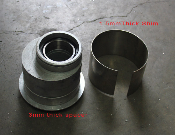

keef Posted February 22, 2017 Posted February 22, 2017 8 hours ago, Alaskan said: keef, what does putting on an 848 front wheel/rotors entail? Easy? my 848 front wheel is in a set of 04/05 gsxr 600 forks/yokes, with 02 gsxr 1000 rotors and 03 gsxr 1000 calipers, Essentially, spacers of various sizes, possibly a bearing change, i can't remember. Quote
keef Posted February 22, 2017 Posted February 22, 2017 11 hours ago, EMC2 said: Funny, I just picked up a complete 1098S swingarm/hub for $100 to look at this option. I figured I could sell it and not lose any money if it didn't work. Do you happen to have the specs for the shim and spacer needed to make this work? It would save me a bunch of time and beer! Thanks $100 is a absolute bargain. I bought a driven quick change rear sprocket centre/hub, and had extreme creations custom make a 45T 530 rear sprocket for me. I had a fairly new chain and front sprocket at the time. I'll drop down to a 520 when it come time to replace them. I dropped the wheel to ex creations to make an adapter set up like carro used to make, but as he had a spare vfr arm lying around, he figured out that the 1098 guts would be easier to transplant. Quote

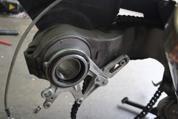

EMC2 Posted February 22, 2017 Author Posted February 22, 2017 Thanks Keef!! This is much less work than I thought it was going to be. After looking at what needed to be done I went ahead and bought wheels. One last question..that torque arm bracket...is that custom or is that a part you bought. I looks like it has a logo on it. Again thanks for you time and info. Quote
artpongs Posted February 22, 2017 Posted February 22, 2017 Extreme Creations I take it is located in Australia? Are those custom bits or do they make them for sale as well? Can you show us your bike please? Art Quote
keef Posted February 22, 2017 Posted February 22, 2017 Yeah, in Aus. Maybe an hours drive from me. Everything's for sale, just depends if you want to pay for it. But they don't keep a stockpile on the shelf- the market for 1098 rear wheel conversions on 17 year old vfrs is quite small. Some things he may still has the program saved for his cnc machine, some things would have been done on the fly, like the spacer. And the bracket for my CBR side stand, recently. I have a vfr8 streetfighter thread. Quote
