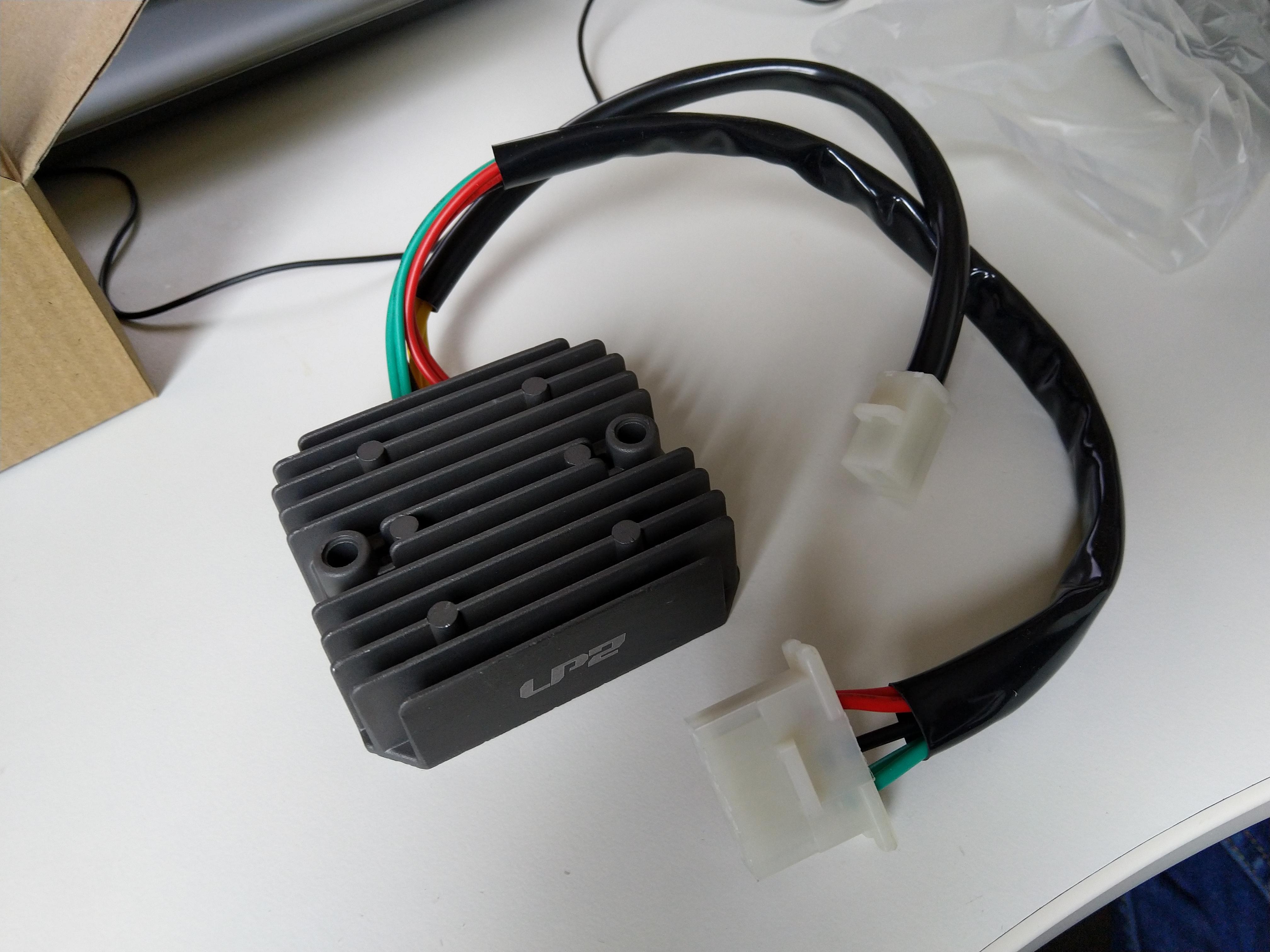

Measuring 15.1V at the battery, the 33yr/75,000km OEM RR maybe on its way out.
But before investj g in a MOSFET one, let's see what reading I get from thus cheapy from China :tongue:

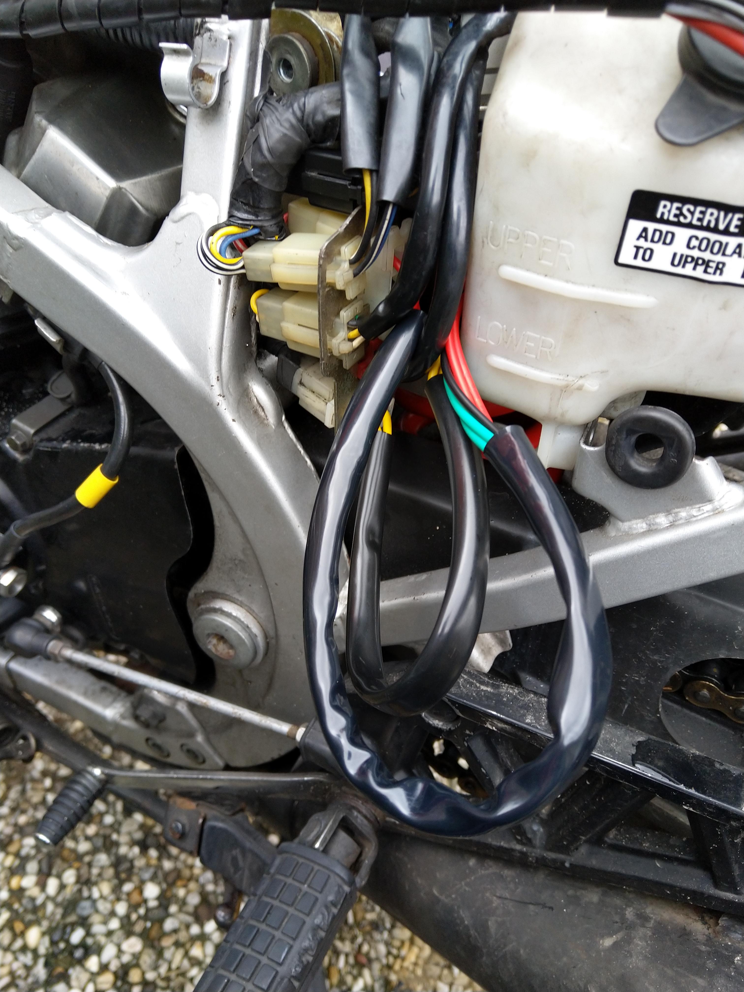

OK, it was cheap, but the "bolt holes" are not the same/not "sunk". Need longer bolts to start with, but with the bolt head rinding on top, it reduces the clearance to the rear shock's spring. Still ok though..
Wires are "a wee bit" longer....
So while they advertise it as a replamenent for the VF500F, it comes with a few buts....
Output though is now a steady 14.5Vdc
