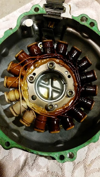

Member Contributer Switchblade Posted February 21, 2015 Member Contributer Posted February 21, 2015 Pull the stator cover and inspect the stator. Quote

Member Contributer Cogswell Posted February 21, 2015 Member Contributer Posted February 21, 2015 Pull the stator cover and inspect the stator. It could look like this (after 18,000 miles). The connectors (especially to the R/R) can be helped out by using some Oxgard (available at most home centers) to reduce corrosion and promote conductivity. Quote
Member Contributer Switchblade Posted February 21, 2015 Member Contributer Posted February 21, 2015 Or one of these .. Quote
mv577 Posted February 21, 2015 Author Posted February 21, 2015 Thank you for the replies... I'll definitely run the tests and go from there... I'll order a gasket as well to open the stator up if needed... Quote
mv577 Posted March 19, 2015 Author Posted March 19, 2015 So... it looks like one of those lol... I have the upgrade kit ready to go in... although I saw no issues... glad I opened it up and will have the piece of mind knowing it's brand new while crossing the country :) Thanks again for the replies... Quote
