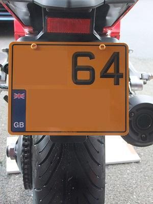

fatshoutybloke Posted February 12, 2015 Posted February 12, 2015 (edited) Not much point in a tail tidy when a standard UK plate is this big and the traffic police are very hot on smaller ones that can't be picked up by the automatic number recognition cameras, but at least the only reflector that's required here is the rear red one. Edited February 12, 2015 by fatshoutybloke 1 Quote
dogman Posted February 12, 2015 Posted February 12, 2015 Not much point in a tail tidy when a standard UK plate is this big and the traffic police are very hot on smaller ones that can't be picked up by the automatic number recognition cameras, but at least the only reflector that's required here is the rear red one. Wow that's effin HUGE! Quote
NZCam Posted February 21, 2015 Posted February 21, 2015 That's not a number-plate, that's an air-brake. Quote
fatshoutybloke Posted February 22, 2015 Posted February 22, 2015 That's not a number-plate, that's an air-brake. Quote
duccmann Posted February 22, 2015 Posted February 22, 2015 Holy cow, probably slows ya down a bit..that thing is huge (license plate) Get the drill out and go to town Quote
