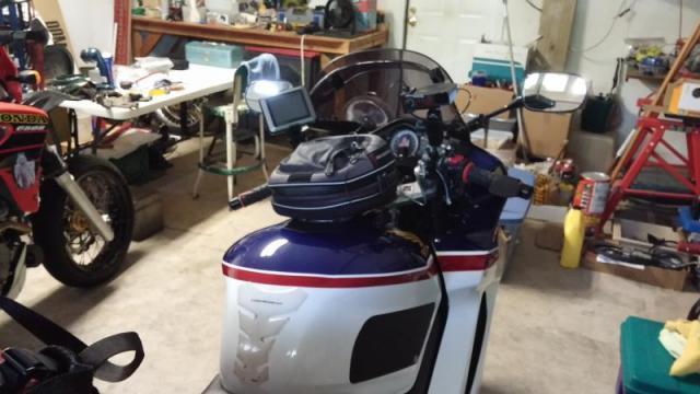

Member Contributer The mailman Posted August 28, 2014 Member Contributer Posted August 28, 2014 After purchasing my '07 VFR two years ago, I have slowly been adding bits to make it more touring friendly. Why do we buy a bike, spend months and thousands of dollars to make it just the way we want it, only to sell it and start over? There has to be a name for this medical condition! As posted in other threads, I'm about to set out on a 4500 mile round trip to follow the Mississippi River from beginning to end so I thought I would share some of my mods to make my 6th gen more tour-friendly. I started out with some nice thick foam grips. I don't need risers but something a little easier to hang on to helps. The stock grips are rock hard and so narrow that my hands get tired holding something so small. Next came a nice Givi Tanklock tank bag. I prefer this over magnetic because there is NO contact with paint and it comes off with the pull of a lever. Next was the Leo Vince exhaust system. This is much lighter than the stock anvil system and has a nice adjustable note to it. I then chose the ST shield from Zero Gravity for better protection from the elements. The bigger the better for long hauls! I also found a Givi trunk and rack system on my local craigslist for less than the cost of just the rack new. To top it off, the seller delivered the items to me! Over the past week, I added some new Michelin Road 2s since they are bargain basement priced now and I'll likely flat spot them on my upcoming ride. No need to buy the latest most expensive tires to roast on a cross country trip. We ARE planning to stick to two lane county roads most of the time. And today, I received my Nelson Rigg saddle bags that I found dirt cheap on Amazon.com. I also purchased a digital voltage meter to keep an eye on things. I velcro-mounted it to the front side of my ignition box just low enough that it clears the bottom edge of the instrument panel. Being mounted down low also helps with visibility rather than having it up high in the sunlight. The last thing I did tonight was to re-mount the Monster fender that comes stock after I removed my Competition Werks fender eliminator. Without it, the rear tire is constantly slinging water/mud/debris onto the rear tail light and trunk. I could do w/o that for my cross country run. Aside from packing, The bike is much more road worthy for the long haul runs and can be easily reverted to sport mode. Quote

signal Posted August 28, 2014 Posted August 28, 2014 Sounds like some good touring improvements. I would just say, your bike would look SOOOOO good with the Givi panniers and side bags vs. the Nelson Rigg.......just saying :) Also, if you don't have one already I highly recommend a Throttlemeister, Kaoko or similar throttle lock. If there is one thing I am so glad I have on long trips, its my throttlemeister! Other things to bring, compressor, plug kit, battery charger. A few powerlets would be good. One constant that you can charge from, and one switched that you can plug things into like your GPS. Do you have a GPS? In many cases a smart phone will do. By far some of the best mounts are RAM Mounts. You can buy a mount that uses the front tank screws, its perfect! Another option is using the steering stem, however I like to put a Powerlet there so I use the tank bolts for the RAM Mount. Brake reservoir is also a spot you can use a RAM mount. Keep an eye on the electrics. I realize you have a meter, but having a spare RR is not a bad idea, especially if your running the stocker. Buy a Ricks Motorsport one, its better than stock and you'll have it when you need it. 1 Quote

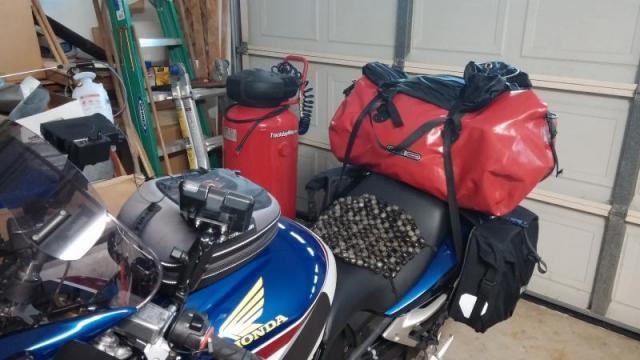

Member Contributer carlgustav Posted August 28, 2014 Member Contributer Posted August 28, 2014 As many of us luv pix, here's a couple of my setup from a recent short trip (AL - NC & back): and: She's set up for trips in a similar fashion to yours, just different equipment. Ortlieb waterproof roll-top bags, tank bag that clips on to ring mounted to tank, RAM mounts to carry Garmin & V1, LED volt. mon., Spider grips w/ cramp buster, beaded seat (works very well to keep butt cool, gotta be careful when going to hang off ), 'safe-pak' that allows me to put helmet & small removable items in it & lock to bike, MRA screen with deflector, upgraded mosfet R/R, heli-bars, and sundry ... Enjoy your ride ... ACE Quote
Member Contributer Conedodger Posted August 28, 2014 Member Contributer Posted August 28, 2014 Personally, I'd trade the Leo Vince for an aftermarket seat on a trip like that. Looks like your set for an adventure though...I'm a little jealous. Quote
