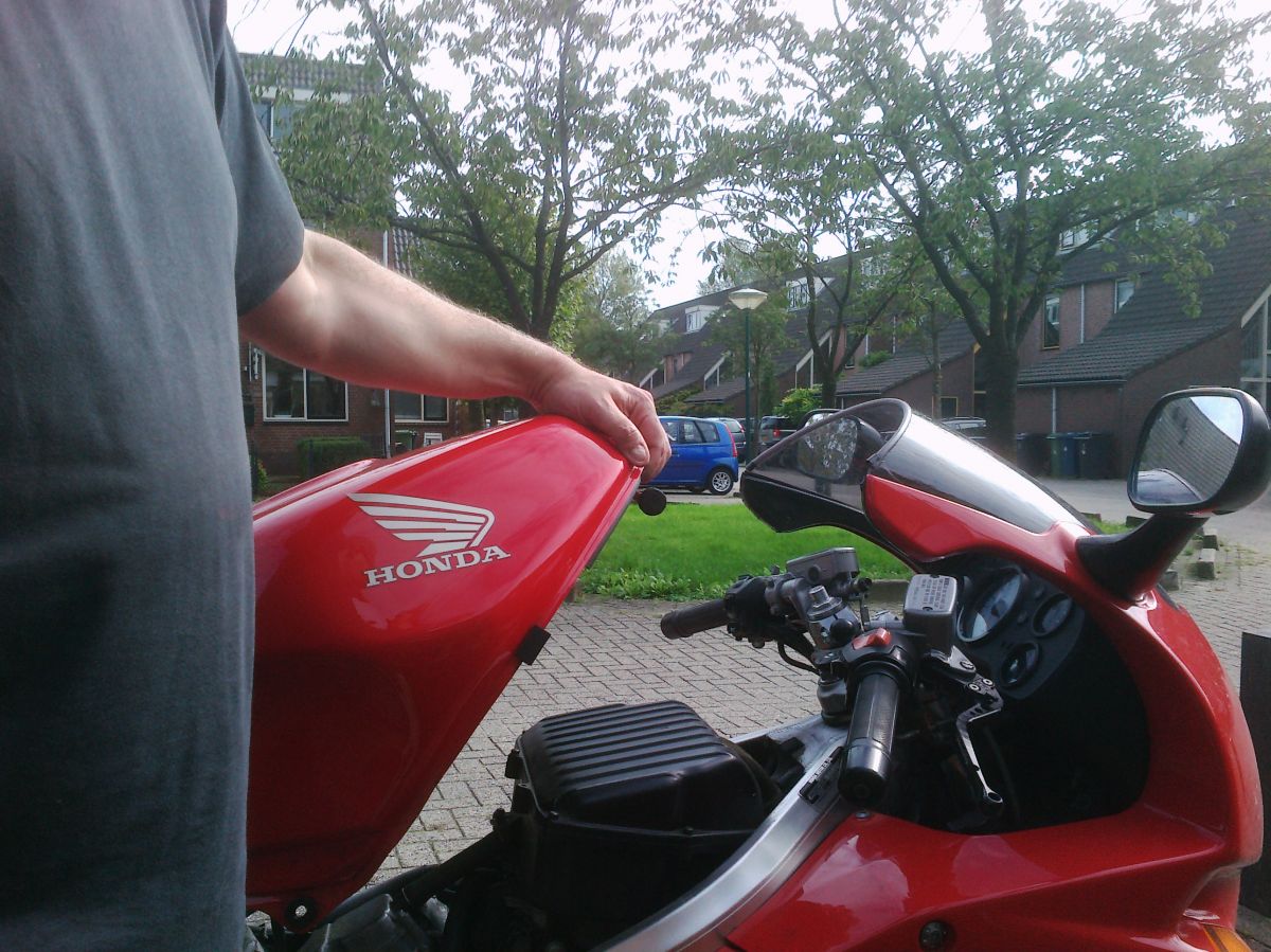

Member Contributer Switchblade Posted April 23, 2014 Member Contributer Posted April 23, 2014 Dutchy bike has them !!! The other side .. Ignore the big beer belly .. Quote
Member Contributer V-FORE Posted April 23, 2014 Member Contributer Posted April 23, 2014 My guess would be the rubber grommets on the front where it slides into the frame. I have lost those little clips on the side before I replaced them last year and I never noticed a wobble...I just had to go on a hunt in a hardware store to find one just last week before I put my tank back on when I changed my shock. I was able to find something similar in a cabinet with various rubber grommets and washers. Good Luck with the refurbishing!! Quote
Member Contributer zoomzoom Posted April 23, 2014 Member Contributer Posted April 23, 2014 I'm with vfore on this one. Most likely the cause of the wobble is one of the front grommets missing, or both. My wife's 96 VFR is missing both of the rubber cushions for the side of the tank the sit on the frame and it doesn't wobble much if at all. I have ordered some replacement rubber tank to frame cushions from my local dealer (expensive little suckers at $10 each) as the shipping costs from the US suppliers like bikebandit and ronayers is just ridiculous. Think they wanted something like $65 in shipping to get them to Canada. The pieces are a LOT more but at least I don't have to pay the outrageous shipping charges. Quote
GadiantonRob Posted April 23, 2014 Posted April 23, 2014 Yes, mine has 2 as well. The tank needs them to stay still. A parts fiche would probably have them. Check the rollers too on the front side of the tank, they don't always like to stay in place during install and could exacerbate the rocking. Also, when installing those rubber stabilizers, find a spot where they actually support the tank and will stay put--they don't like to just stay in any one spot. Quote
Member Contributer CornerCarver Posted April 23, 2014 Member Contributer Posted April 23, 2014 As V-Fore said it is the two rubber bushings on the front that your tank does not have in the picture that you can see in Dutchy's pic. While you are waiting on the parts to be sent to you, you can use a couple of small rubber caps from the auto parts store, test fit them to ensure they are snug. Quote
Guest Posted April 23, 2014 Posted April 23, 2014 Excellent advice guys , cheers. Switchblades picture perfectly demonstrates that I havent got them. Bit annoying i'm finding things completely missing. If there is a whole lot of bolts and washers on the ground after you've done a job on your bike how do you just kick them aside and not try and work out where you left them out !? Anyways .. Only found one mechanical problem so far. Right front brake calliper pistons has seized. I instantly knew something was up when the bike was pulling to the left on the ride home from buying it. took it down to a place I used to go for help when i had the harley called Doc Hogz here in Melbourne. Had to laugh because they were struggling to find a metric bolt in the whole of the workshop to block up the hole and then use compressed air through a rag on the other hole to push the piston out. They have the experience to get them unstuck without damaging them that I don't have. Did it for me for free because the shop owner is a Massive fan of v4 Hondas and wants to have a ride when its up and running. looking for metric bolts I'll order some rubber things if there not too pricey and cut up some car suspension bump stop rubbers to use temporarily. thanks lads Quote
