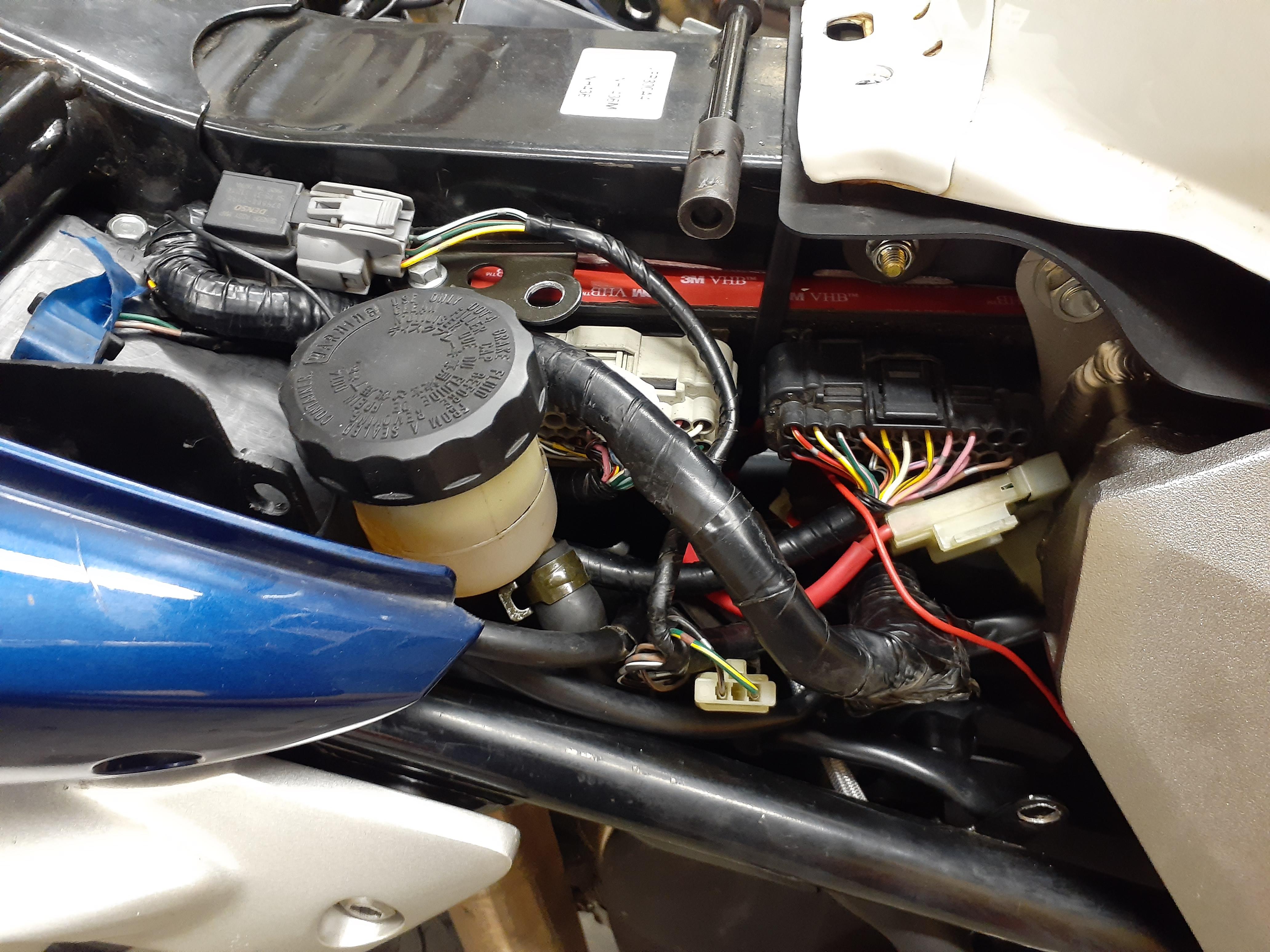

Update- Several thousand miles later, Bike runs great! Had to relocate one of the rear coils to the rear of the airbox after it rubbed one of the connectors and developed a short. Had to replace the clutch-miles were unknown on the 01 motor, and the plates were in pretty bad shape (started slipping after some practice drag race starts). Starting my next project- 02 also getting an 01 motor, this one will have a 929 swingarm and forks. If anyone is in need of a 50k mile 02 motor, ecm, coil packs etc., 02 forks and brakes, 04 ABS stuff, I got 'em!

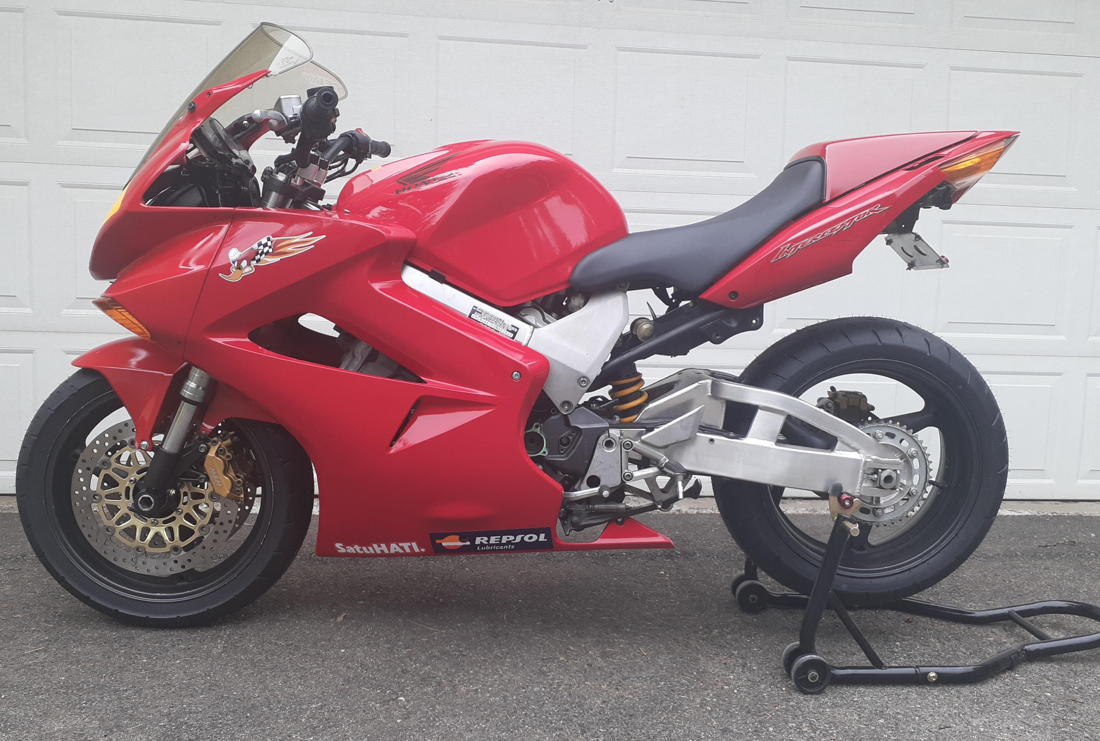

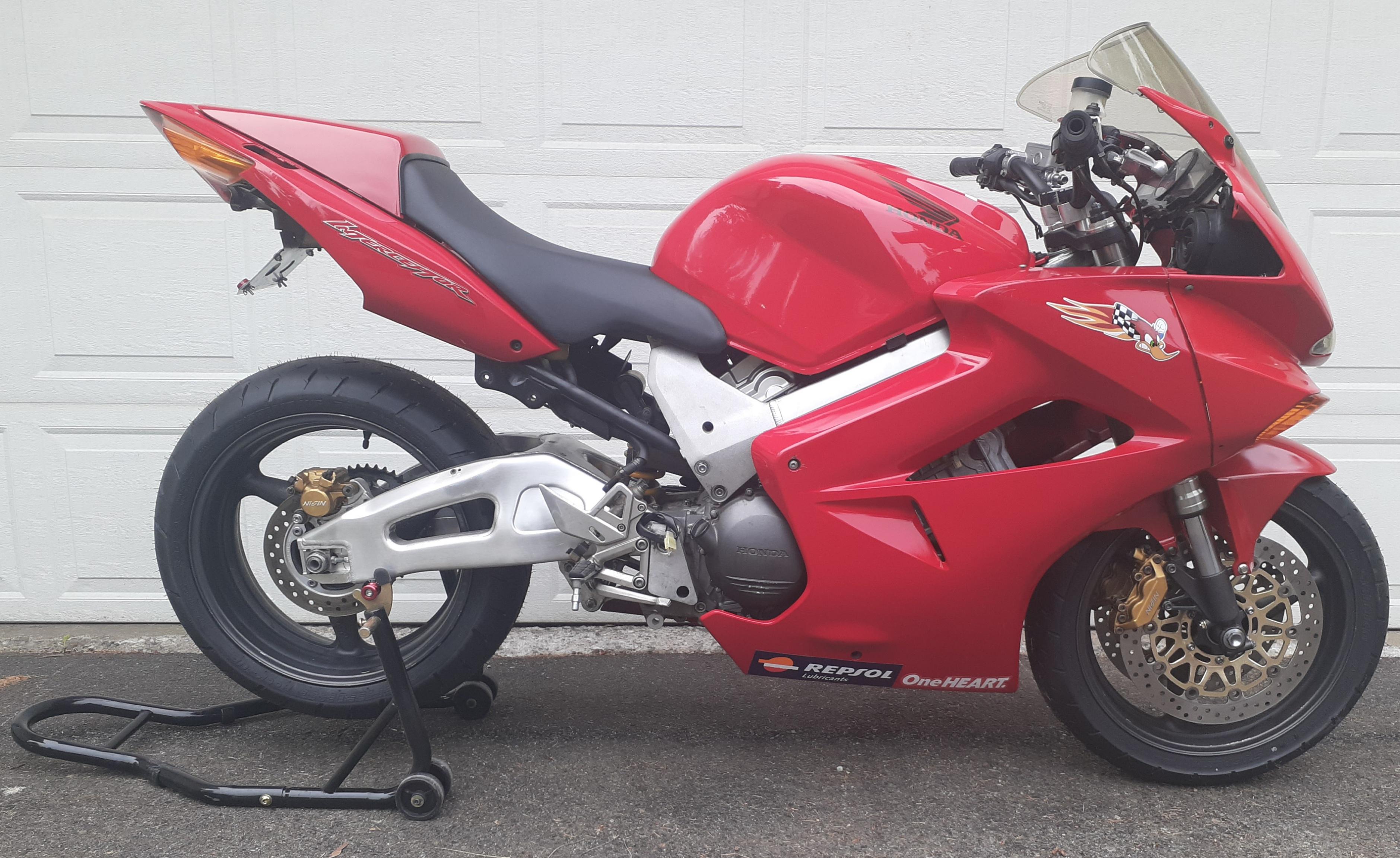

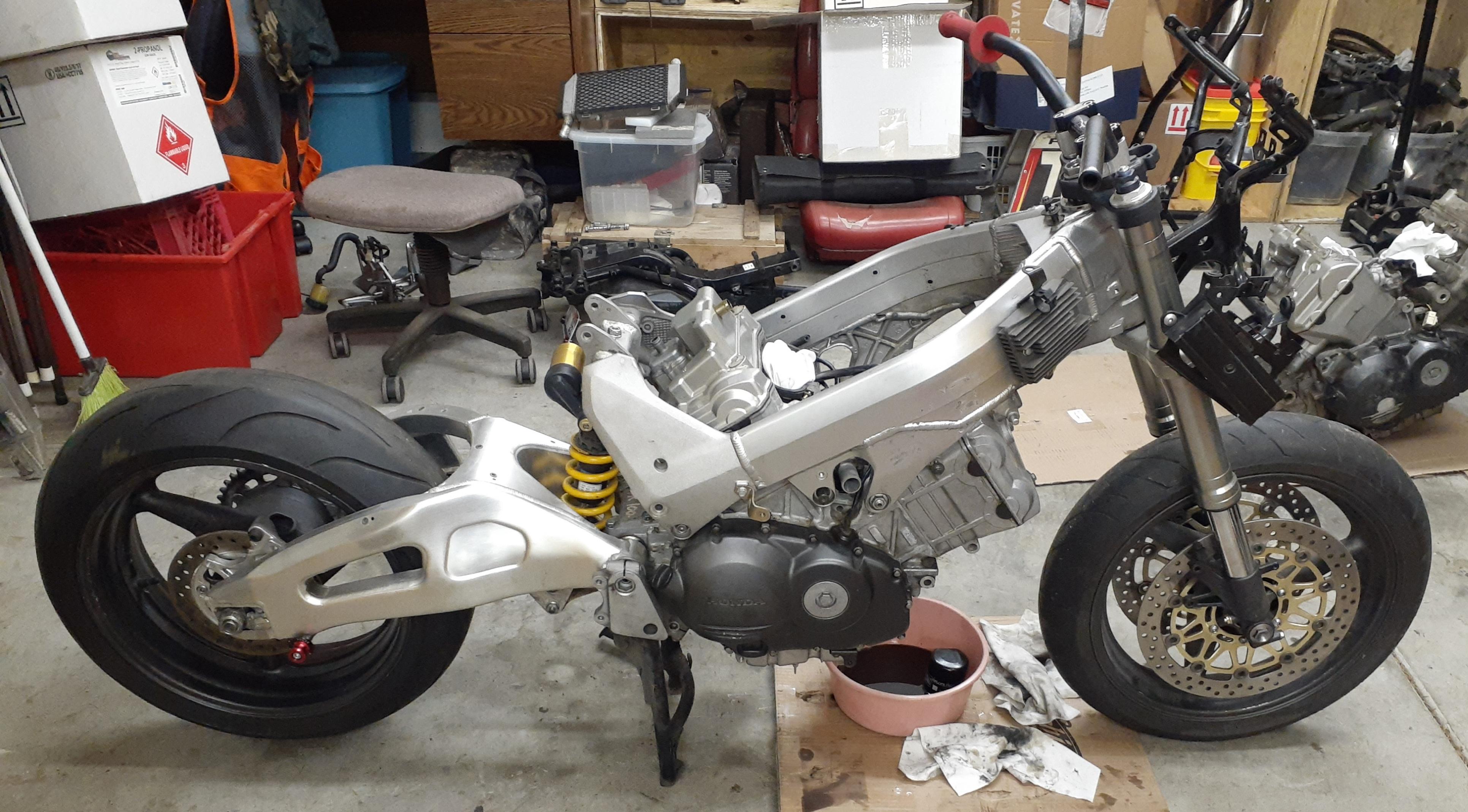

I haven't posted anything in awhile, so here's an update on my next project: 02 chassis, 00 motor, 954 swingarm, 929 forks and wheels.
