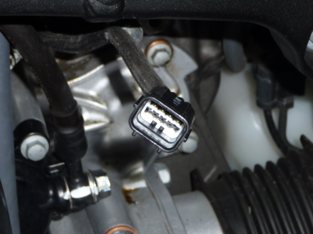

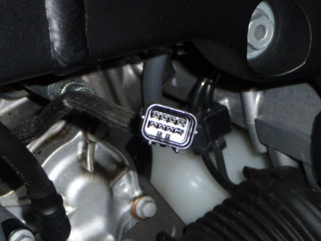

Member Contributer Georges Posted September 16, 2011 Member Contributer Posted September 16, 2011 Who can provide me 2 pair of Gear Position Sensor plugs. 2 male and 2 female plugs. I Will send you a wiring harness back with switch-able 1st and 2nd gear de restriction abillity . It is a 8 pole connector with 7 poles used. This looks like a connector I have on my acura. Will get back to you Quote

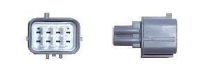

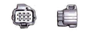

Dutchgixxer Posted October 18, 2011 Author Posted October 18, 2011 Any news about the availability of the connectors for the plug able derestrictor ? Quote
Guest ignoreance Posted October 28, 2011 Posted October 28, 2011 The Female Connector The male Side Are these correct? Quote
Lee 2002 Posted October 29, 2011 Posted October 29, 2011 Have you guys checked with Eastern Beaver? He seems to have access to all kinds of OEM electrical connections that the outside world can never source. He's helped me several times in the past. It would be worth a try. http://easternbeaver.com/ Quote

Member Contributer eastbowl2 Posted December 10, 2011 Member Contributer Posted December 10, 2011 I saw this posted on another forum (guy called tin-tin). It sounds like a great idea given that no one can get their hands on the 8 pin Honda connector. What do you think? "I know that the 8 pin gps connector is hard to find but the pins in the harness cant be too special I would think. has anyone ever just done the conversion at the pin level with a couple of extra 3 pin connectors that take the same pin size as the OEM 8 pin and just make a separate 3 pin jumper harness. I didnt do it this way because I dont have an extended warranty but I would think this would work. I guess if I have to take it back for warranty in the couple months i have left, I would probably just cut all the wires for the gps harness and repin the connector. I doubt anyone would notice that the harness was half an inch shorter. I dont know. just kind of brainstorming." Quote
