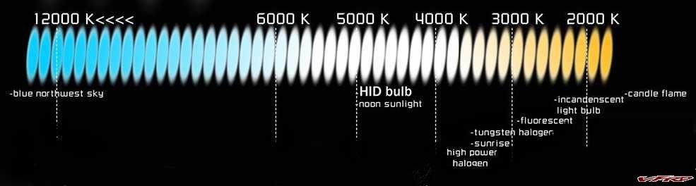

Member Contributer Terminex Posted November 2, 2009 Member Contributer Posted November 2, 2009 (edited) So....which bulb, 5k or 6k. I know 5k has more light but the slight blue in the 6k might get someones attention before they hit me,....... or maybe not. 6K same temperature as the sunlight. I have used them, they are great and work better in fog. Unfortunately in Europe are not legal. It is better to buy the bulbs separately. The bulbs of a kit are usually of low quality. Can you recommend a good place to get bulbs? I just bought them from a local store. The original (Chineze) bulbs had bad geometry and after 350 hours of use lost 40% of the initial luminosity. About the cost; there are three categories cheap 15, good 35, best 55 euro each bulb, but these are prices in a local store more than a year ago. Which type am I after for my 6th Gen? 6th gen uses H7. Take into account that you will have to built or buy also two bases (adapters) for the HIDs to fit in the headlight. I did not have to get any adapters for my HID swap. I have an '07 and it used normal H7's. The HID's were completely plug and play without any adapters necessary. I "believe" they changed the need for adapters with the '06 bikes, but someone else would have to confirm. Edited November 2, 2009 by Terminex Quote

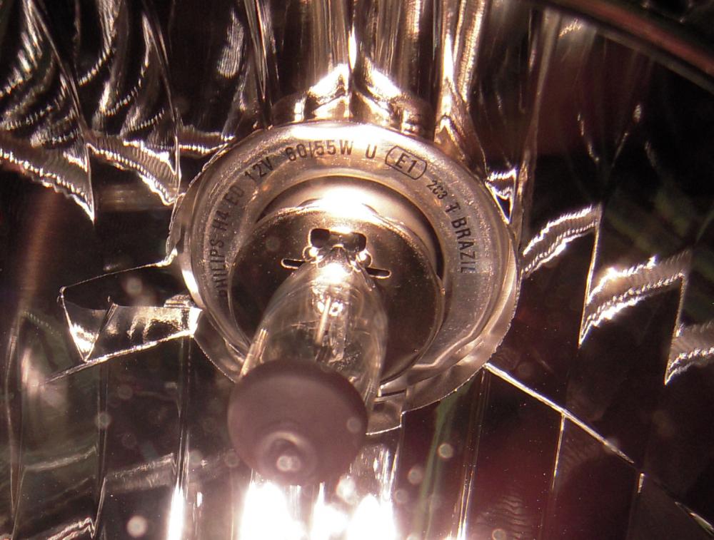

Member Contributer coderighter Posted November 2, 2009 Author Member Contributer Posted November 2, 2009 OK, now I'm really confused. I went and triple checked, I have a H4 for my low beam. My low beam is on all the time. If I hit the high beams the 2 top lights come on, which appear to be H7 bulbs. Since HID have to warm up, my intent is to replace the low beams with HID and leave the high beams stock. When I need high beams, I don't what to be waiting for a warm up. I may actually up the high beams to 70 watt later, since the HID only draw 35 watt warm, I'll have a few watts to spare. Quote
Member Contributer Q-Dawg Posted November 2, 2009 Member Contributer Posted November 2, 2009 OK, now I'm really confused. I went and triple checked, I have a H4 for my low beam. My low beam is on all the time. If I hit the high beams the 2 top lights come on, which appear to be H7 bulbs. Since HID have to warm up, my intent is to replace the low beams with HID and leave the high beams stock. When I need high beams, I don't what to be waiting for a warm up. I may actually up the high beams to 70 watt later, since the HID only draw 35 watt warm, I'll have a few watts to spare. - Why would you be waiting for the high beams to warm up if you stay halogen? They will light up the same speed as always unless you switch them to HID (bad idea). As for other aspects to the discussion on HID lights: - get a good kit with bulbs that are nicely centered and decent ballasts. - don't run cooler color temp than 6000K if you want decent lighting. 6000-6500K is noticeably blue, with 5000K being slightly blue. 4300-4500K is pretty much the brightest, purest white light you can get. 2500-4000K will give you a yellow look (yellow color increasing with drop in K-value) and will be good for contrast and poor weather. If you just want HID blue lights for the "look" then save yourself the money and headache of install and just get yourself a set of blue tinted halogen bulbs. Both are useless, but look "cool" if you are into that sort of thing. - Blue lights don't get you noticed any better, as every other idiot on the road seems to think 6500K to 10000K blue lights are the shit. Intense yellow color stand out more, if you ask me, and aren't as annoying to other drivers. - I could go on and on with this subject, but I will spare you all. If you want to educate yourself, look up HIDplanet or The retrofit source and do some reading. Quote
Member Contributer coderighter Posted November 2, 2009 Author Member Contributer Posted November 2, 2009 OK, now I'm really confused. I went and triple checked, I have a H4 for my low beam. My low beam is on all the time. If I hit the high beams the 2 top lights come on, which appear to be H7 bulbs. Since HID have to warm up, my intent is to replace the low beams with HID and leave the high beams stock. When I need high beams, I don't what to be waiting for a warm up. I may actually up the high beams to 70 watt later, since the HID only draw 35 watt warm, I'll have a few watts to spare. - Why would you be waiting for the high beams to warm up if you stay halogen? They will light up the same speed as always unless you switch them to HID (bad idea). As for other aspects to the discussion on HID lights: - get a good kit with bulbs that are nicely centered and decent ballasts. - don't run cooler color temp than 6000K if you want decent lighting. 6000-6500K is noticeably blue, with 5000K being slightly blue. 4300-4500K is pretty much the brightest, purest white light you can get. 2500-4000K will give you a yellow look (yellow color increasing with drop in K-value) and will be good for contrast and poor weather. If you just want HID blue lights for the "look" then save yourself the money and headache of install and just get yourself a set of blue tinted halogen bulbs. Both are useless, but look "cool" if you are into that sort of thing. - Blue lights don't get you noticed any better, as every other idiot on the road seems to think 6500K to 10000K blue lights are the shit. Intense yellow color stand out more, if you ask me, and aren't as annoying to other drivers. - I could go on and on with this subject, but I will spare you all. If you want to educate yourself, look up HIDplanet or The retrofit source and do some reading. Re-read it. I was stating my reason for not using HID in the high beam. I'll check with those sources, Thanks Quote

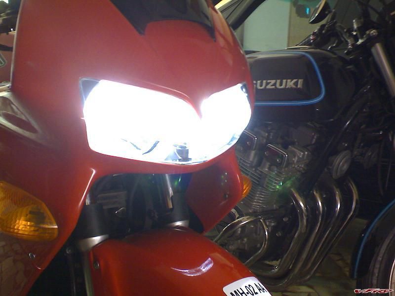

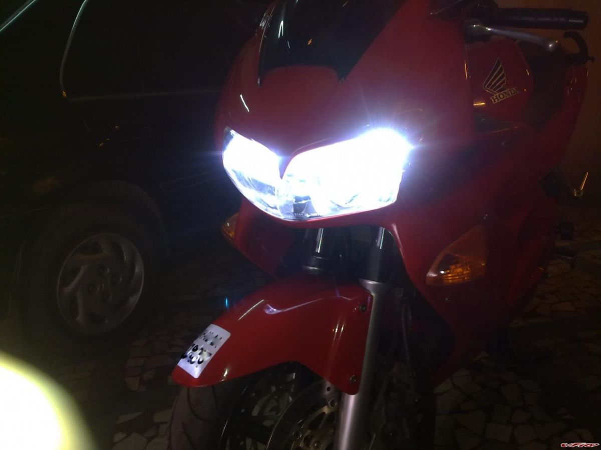

Member Contributer JZH Posted November 14, 2009 Member Contributer Posted November 14, 2009 I can't tell much from your pics, but why would your installation be different from everybody else's? Even if your HID conversion put the doubled output of light in exactly the same place as OEM (which is physically impossible, due to the fact that an H4 emits light primarily from the center of a glowing filament and an HID capsule emits light primarily at either end of a much larger arc), you would have exceeded the design parameters of the headlight reflectors and would, therefore, have too much foreground light (as well as wherever else the lighting engineers at Stanley intended a small amount of light). What you actually have is that, PLUS the dispersion that inevitably follows from replacing a tiny pinpoint source of light with a relatively big blob source of light in the middle of the same, carefully designed reflector. If you think that's "perfect"... :blush: Ciao, Quote

Member Contributer alwaysaware Posted November 25, 2009 Member Contributer Posted November 25, 2009 Wow, that looks great. Where did you get the kit you have on your bike? Quote
Member Contributer JZH Posted November 29, 2009 Member Contributer Posted November 29, 2009 Wow, that looks great. Where did you get the kit you have on your bike? What looks great? Are you just looking at the color? Oh, dear... I've been in California for the last two weeks, so haven't had a chance to even clean out the new garage or move my stuff in. It'll happen this winter! Ciao, Quote
