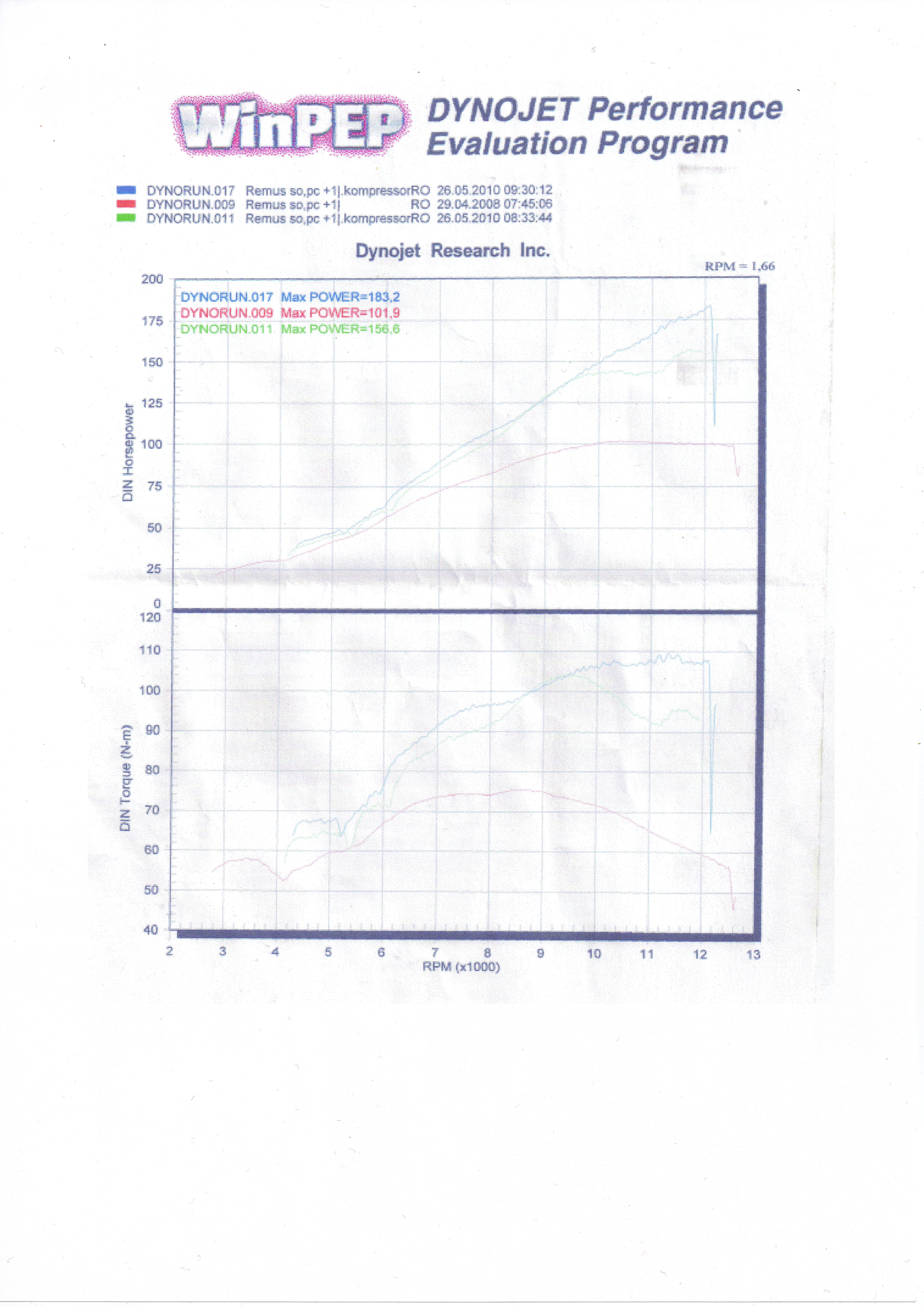

WackenSS Posted May 26, 2010 Posted May 26, 2010 After trying different maps, and having Dan custom make 2 maps via e-mail, i finally found the time to run a dyno for some realy spot on adjustments... The numbers went from 156.6 -> 183.2... pretty ok one should say :) I dont have to say that the gained ponies does kick... Let the summer begin :) Quote
Member Contributer magicman Posted May 26, 2010 Member Contributer Posted May 26, 2010 The numbers went from 156.6 -> 183.2... Yowzah! Quote
WackenSS Posted May 28, 2010 Posted May 28, 2010 (edited) Now, here is the evidence... Red line = pre charger install. Green line = A&A Perf. european charger map. Blue line = Custom map. I had the dyno recorded, here are my compilation of the goodies Edited September 3, 2010 by WackenSS Quote
