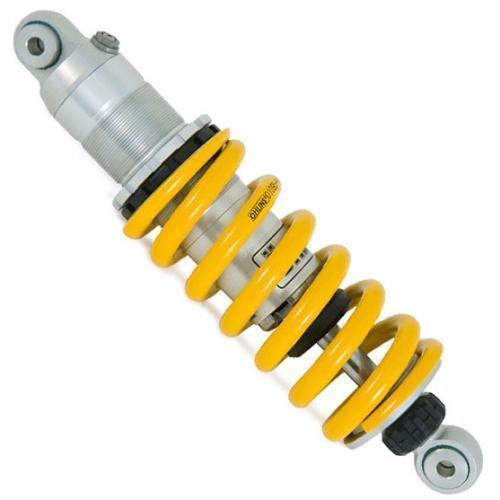

Member Contributer ronimalvfr Posted March 21, 2013 Member Contributer Posted March 21, 2013 Has anybody heard of or done business with this place? Looks like a pretty good deal for an Ohlins. http://www.pureperformancecycles.com/Brand/Honda/Honda-VFR800/Suspension---Brakes/Ohlins-HO043-Shock-Absorber--02--12-VFR800-FI Quote
Hotbrakes Posted March 21, 2013 Posted March 21, 2013 Has anybody heard of or done business with this place? Looks like a pretty good deal for an Ohlins. http://www.pureperformancecycles.com/Brand/Honda/Honda-VFR800/Suspension---Brakes/Ohlins-HO043-Shock-Absorber--02--12-VFR800-FI Not a bad price but does it only have one damping adjuster? Meaning both compression and rebound are all in one similar to the stock shock? Quote
NakedViffer Posted March 21, 2013 Posted March 21, 2013 Has anybody heard of or done business with this place? Looks like a pretty good deal for an Ohlins. http://www.pureperformancecycles.com/Brand/Honda/Honda-VFR800/Suspension---Brakes/Ohlins-HO043-Shock-Absorber--02--12-VFR800-FI Not a bad price but does it only have one damping adjuster? Meaning both compression and rebound are all in one similar to the stock shock? Its fully adjustable, I don't think the nut you're seeing at the bottom is the adjuster, the adjustment is the two black rings stacked on top of eachother at the stop of the shock. Quote
Member Contributer HighSideNZ Posted March 21, 2013 Member Contributer Posted March 21, 2013 I think that shock only has rebound external adjustment. Best to check on the Ohlins web site against the actual part number. EG: HO406 For compression adjustment with Ohlins you normally need the external resevoir. Phil Quote
Member Contributer 2thdr Posted March 22, 2013 Member Contributer Posted March 22, 2013 Has anybody heard of or done business with this place? Looks like a pretty good deal for an Ohlins. http://www.pureperformancecycles.com/Brand/Honda/Honda-VFR800/Suspension---Brakes/Ohlins-HO043-Shock-Absorber--02--12-VFR800-FI Not a bad price but does it only have one damping adjuster? Meaning both compression and rebound are all in one similar to the stock shock? Its fully adjustable, I don't think the nut you're seeing at the bottom is the adjuster, the adjustment is the two black rings stacked on top of eachother at the stop of the shock. Don't think so...looking at the Ohlins site I don't think the photo is completely accurate...it doesn't show the piggy back reservoir, the rings at the top are the usual preload adjustment. The little black rings at the bottom you can barely see are the rebound damping adjuster. Compression damping adjustment in on the piggyback reservoir. The Ohlins site says that model has one...it's also supposed to have a length adjustment. http://www.ohlins.com/Our-products-new/Motorcycle/Products/Hypersport/HO-406/ Click on the text just to the right of "Type" to get the info Wonder how much trouble it is to mount on a 6th gen with the piggyback reservoir? Quote
NakedViffer Posted March 22, 2013 Posted March 22, 2013 Do you see that split black ring with the notches at the TOP of the shock? I guess, from what I can remember, that may be the rebound on the bottom, and the compression is the black knob, I don't think its actually split. Quote
Member Contributer 2thdr Posted March 22, 2013 Member Contributer Posted March 22, 2013 Interesting... Looks to be lots of adustability for $650 bucks... Quote
Baileyrock Posted March 22, 2013 Author Posted March 22, 2013 pretty sure that shock has rebound adjustment only. that's the black ring/knob at the bottom of the picture. this is ollins most basic shock. that's a little plug at the top were the remote hose would go. BR Sent from my SCH-I405 using Tapatalk 2 Quote
