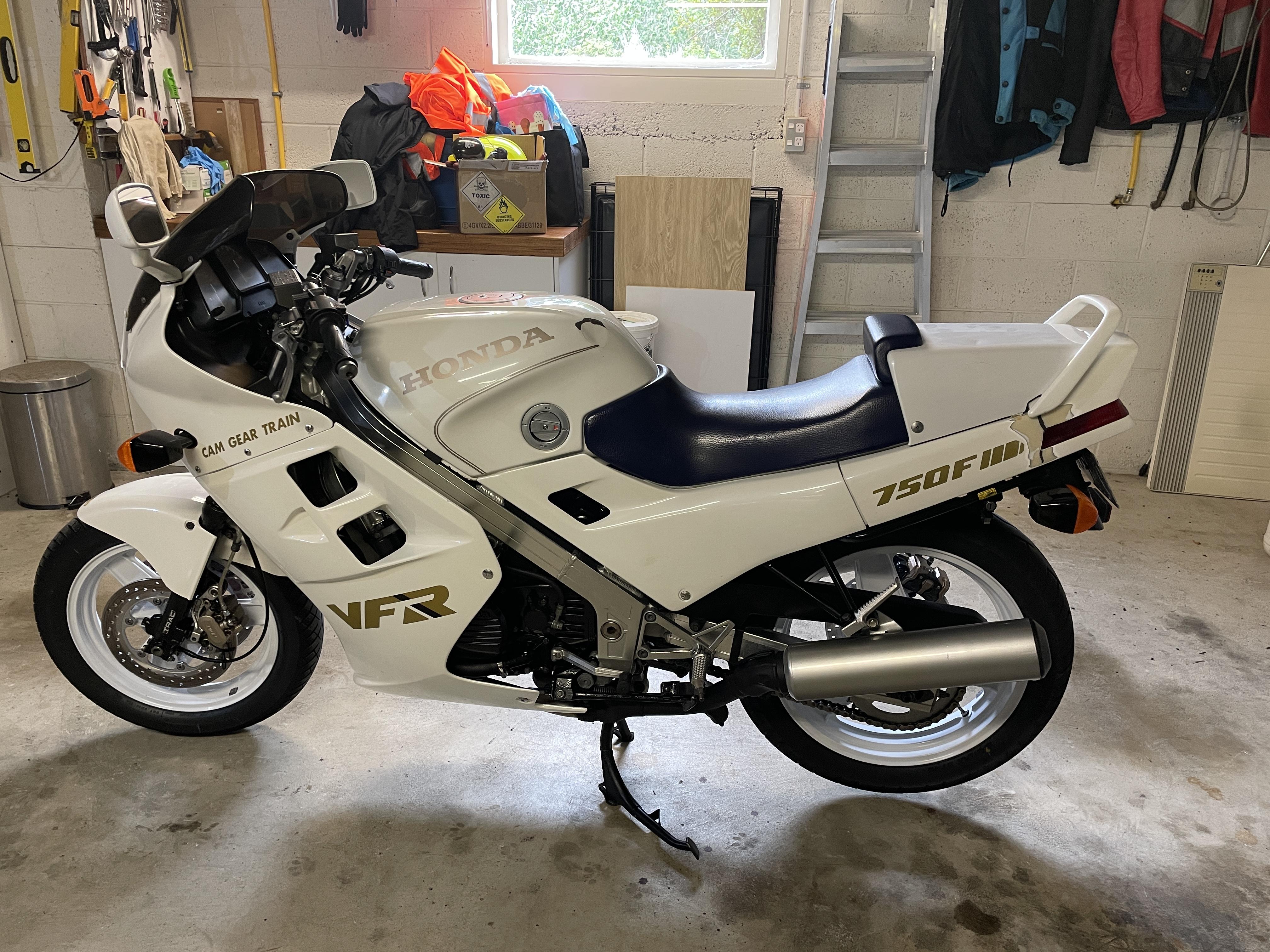

bob38 Posted September 8, 2024 Posted September 8, 2024 I have found one of the iconic bikes, low mileage (20,000), good condition with upgraded brakes. I want to use it to commute year round - this may be sacreligeous but if I ‘m buying something I like it to be good to ride. I have had more recent 800 vtec and 1200 VFRs and they are excellent at everything, the latter of course high and heavy- I m attracted to this first model as the specs indicate it is both lighter and more powerful than later models - is this true in fact? Also the 750 has the gear driven cams which would be a first for me. I am not practical so won’t be working on it myself so will use a local old school bike shop (he has some 70’s and 80’s Honda s and British bikes in his showroom seemingly not for sale). Is there any reason why you think this is a bad choice? 1

bob38 Posted September 8, 2024 Author Posted September 8, 2024 Thank you, it looks like it’s a good idea then 😀 2

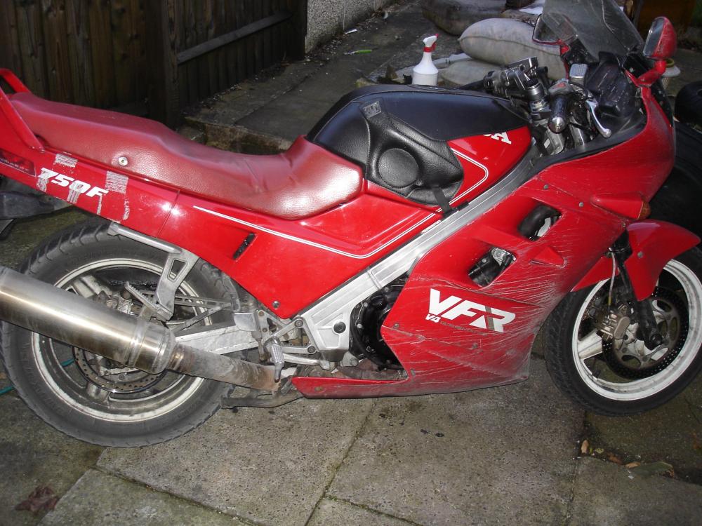

Member Contributer Terry Posted September 9, 2024 Member Contributer Posted September 9, 2024 The 86 will make a great daily ride. Compared to a later 800, the 86 has a bit more pep at low revs and makes more mechanical noise, but that would be where the performance comparison ends, otherwise they will be pretty similar. With some decent maintenance, the brakes are more than up to the task and there are some decent tyres available in stock sizes e.g. Bridgestone BT46. IIRC the headers are stainless (I know the front ones are anyway) but the collector/mufflers are mild-steel. Here's one I prepared earlier. The bodywork is very weak where the rear light sits and they are known to crack there, so preventative fibreglass would not be a bad move. 1
