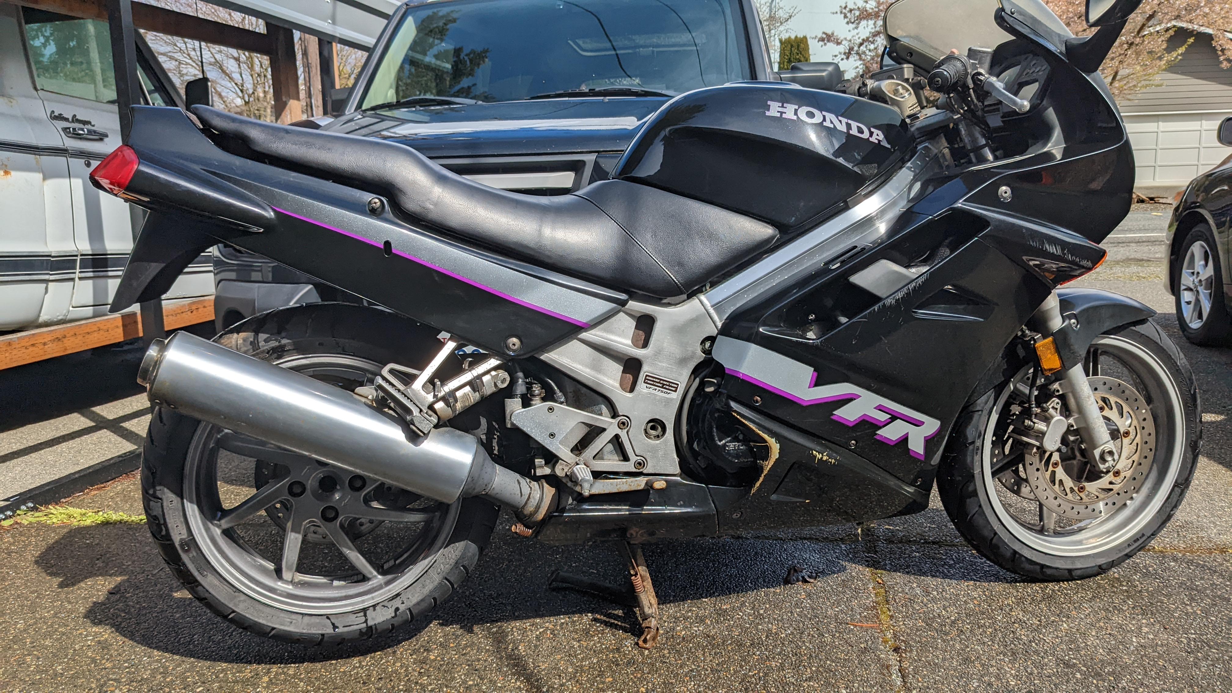

Sounds like the US 1992 VFR *PB184MU* GRANITE BLUE METALLIC.  Its a Pearl "Black" with blue metallic flakes sprayed over a Purple base coat.
You can check under your seat and see if the original Paint Code sticker is there.
Careful, the tank will have more clearcoat than the rest of the bike and is more resilient to polishing.  Also, the graphics on the tank are clearcoated over (if original), but not on the rest of the bike, so graphics can be removed.
Before:
After:
