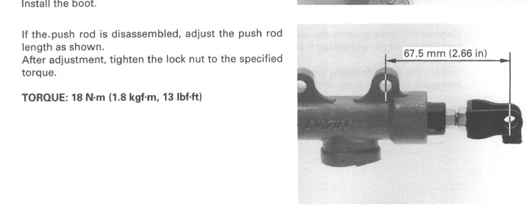

According to the Service Manual the Brake Pedal Height is supposed to be 67.5mm (2.66").
What is that height in relation to?

It refers to Push Rod Length.
See this from the Rear Brake section of the Service Manual!
Thanks, I missed that.
