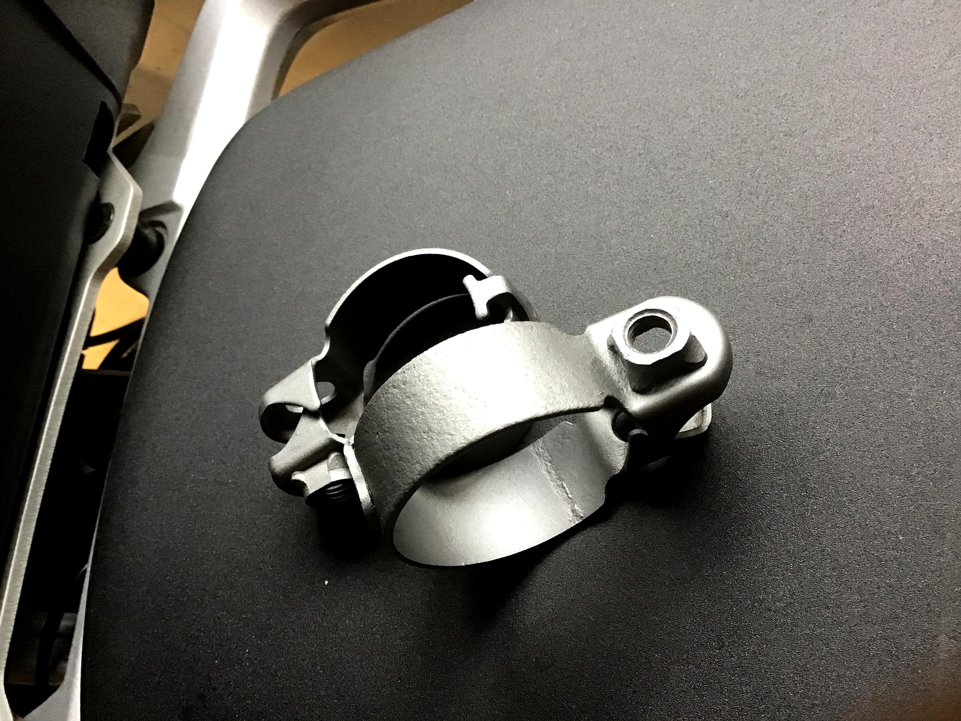

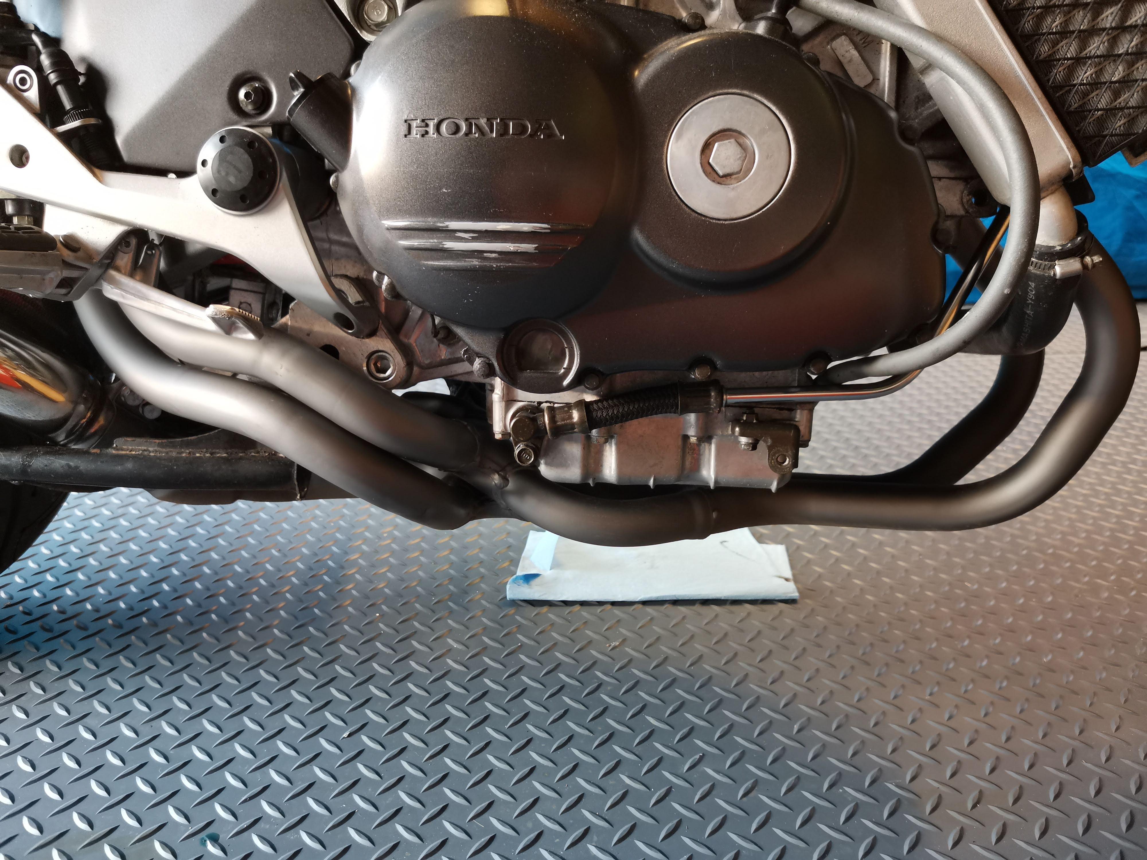

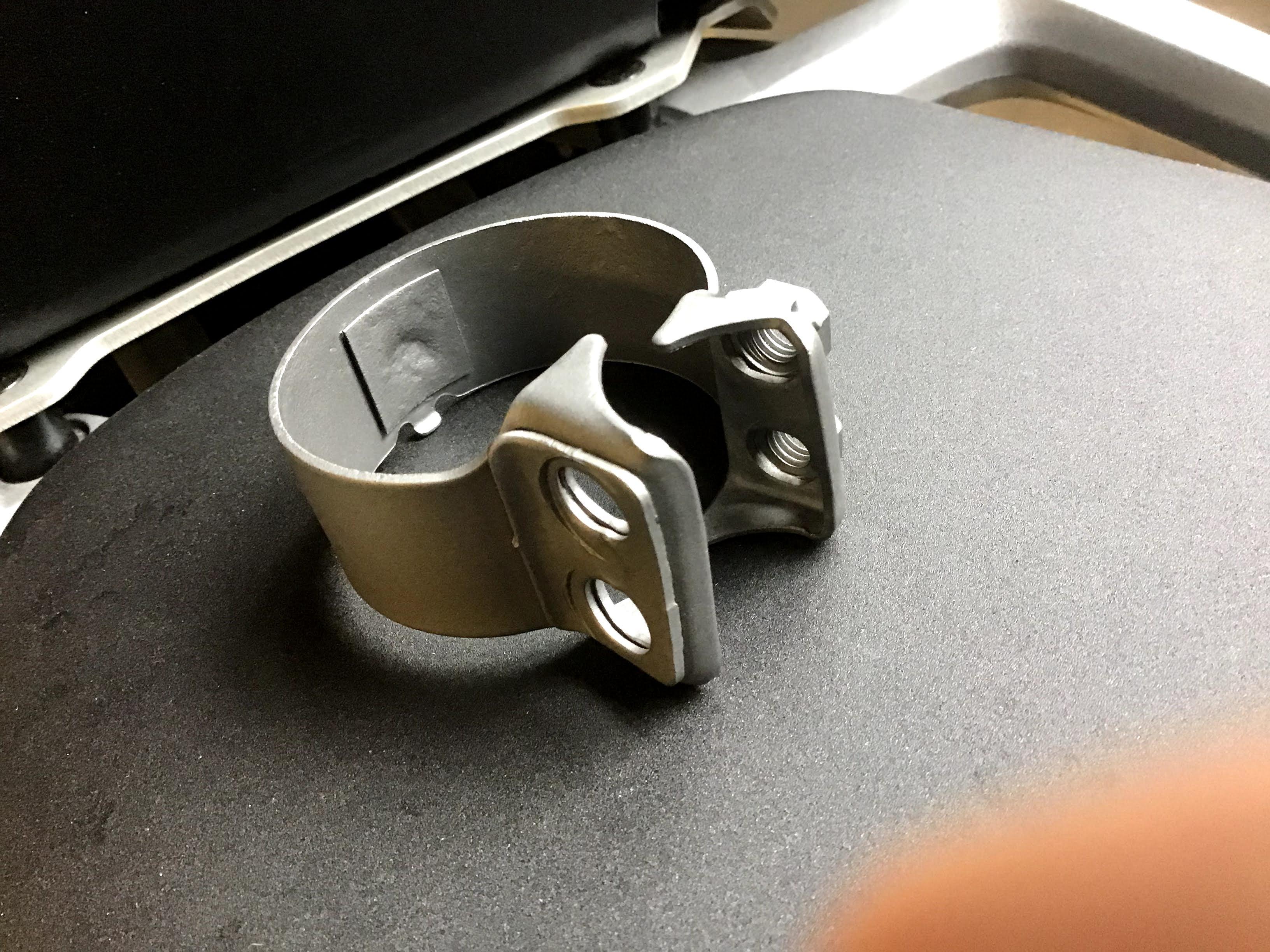

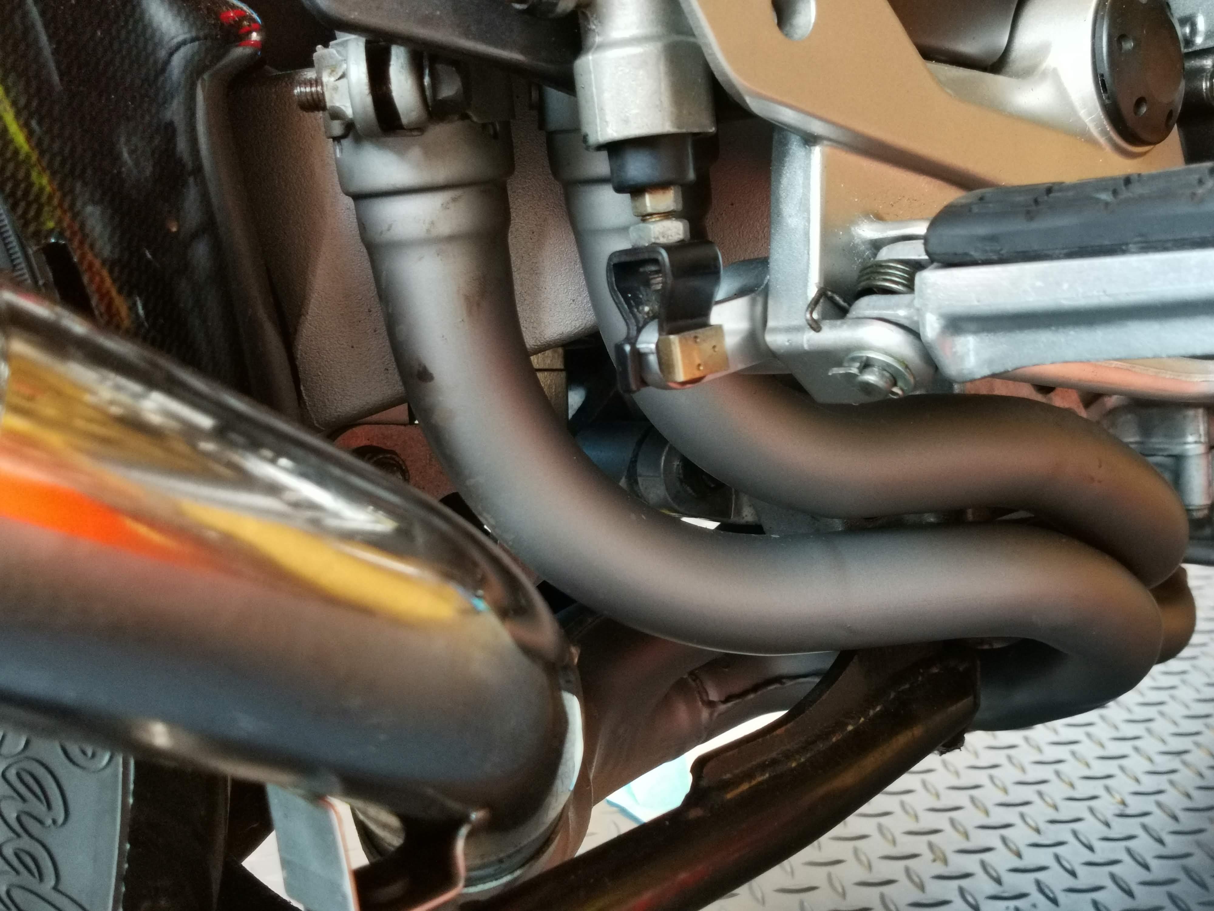

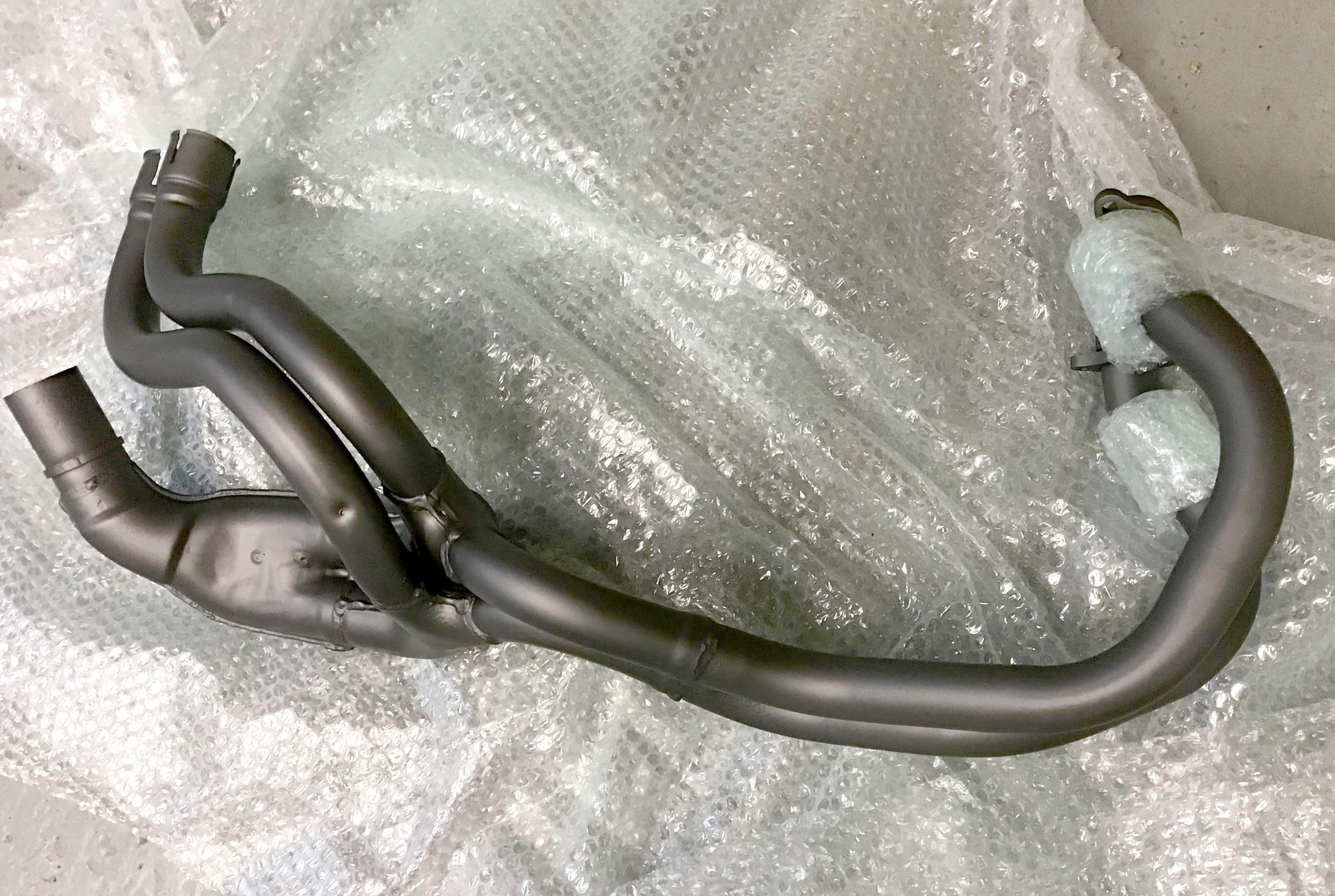

Don't know if this is of any interest, but I always like looking at what everyone else puts up so maybe someone will find this of some use.  I decided to get my stock exhaust (headers) ceramic coated rather than getting an aftermarket set.
My logic was based on keeping originality and potential worries about fit of some aftermarket options.  I've no idea whether this will turn out to be a sound choice yet as I haven't put any miles on since they were done due to well... (long boring story omitted).
I must have had a bit more spare cash in 2019 (when I had them done) than I do now, as I'm slightly embarassed to say it cost ~£300 not including shipping costs (I dropped off and collected).

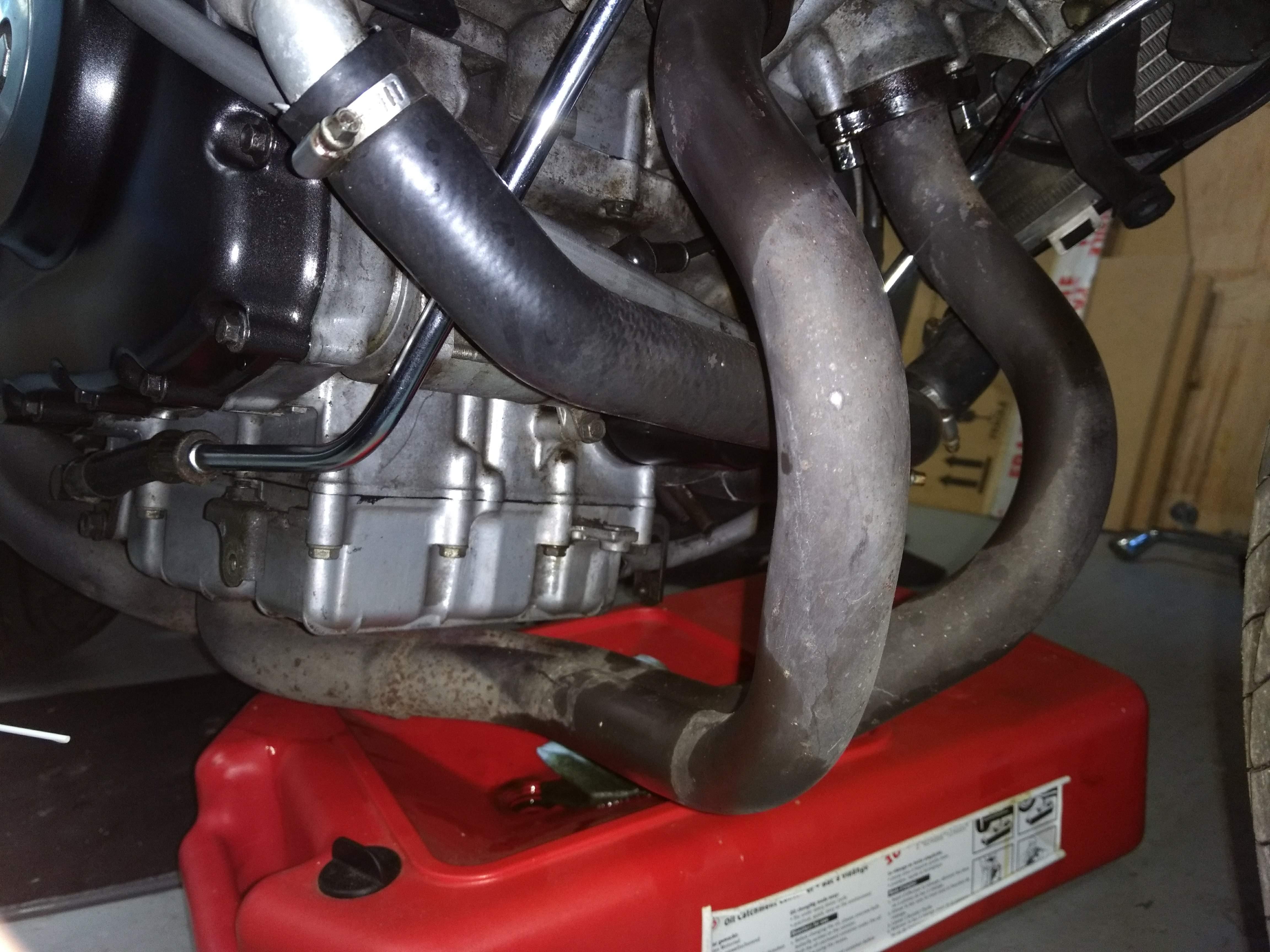

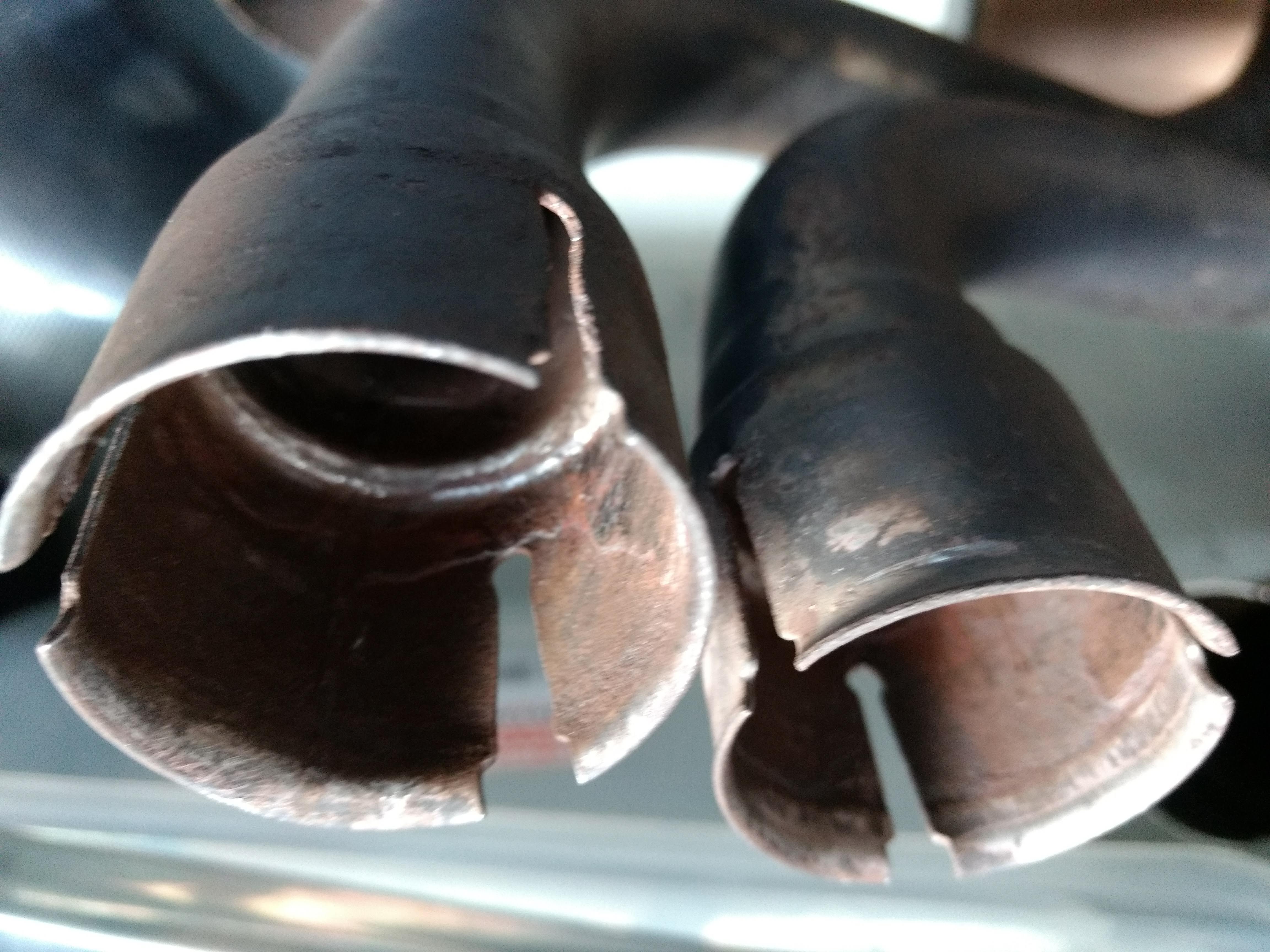

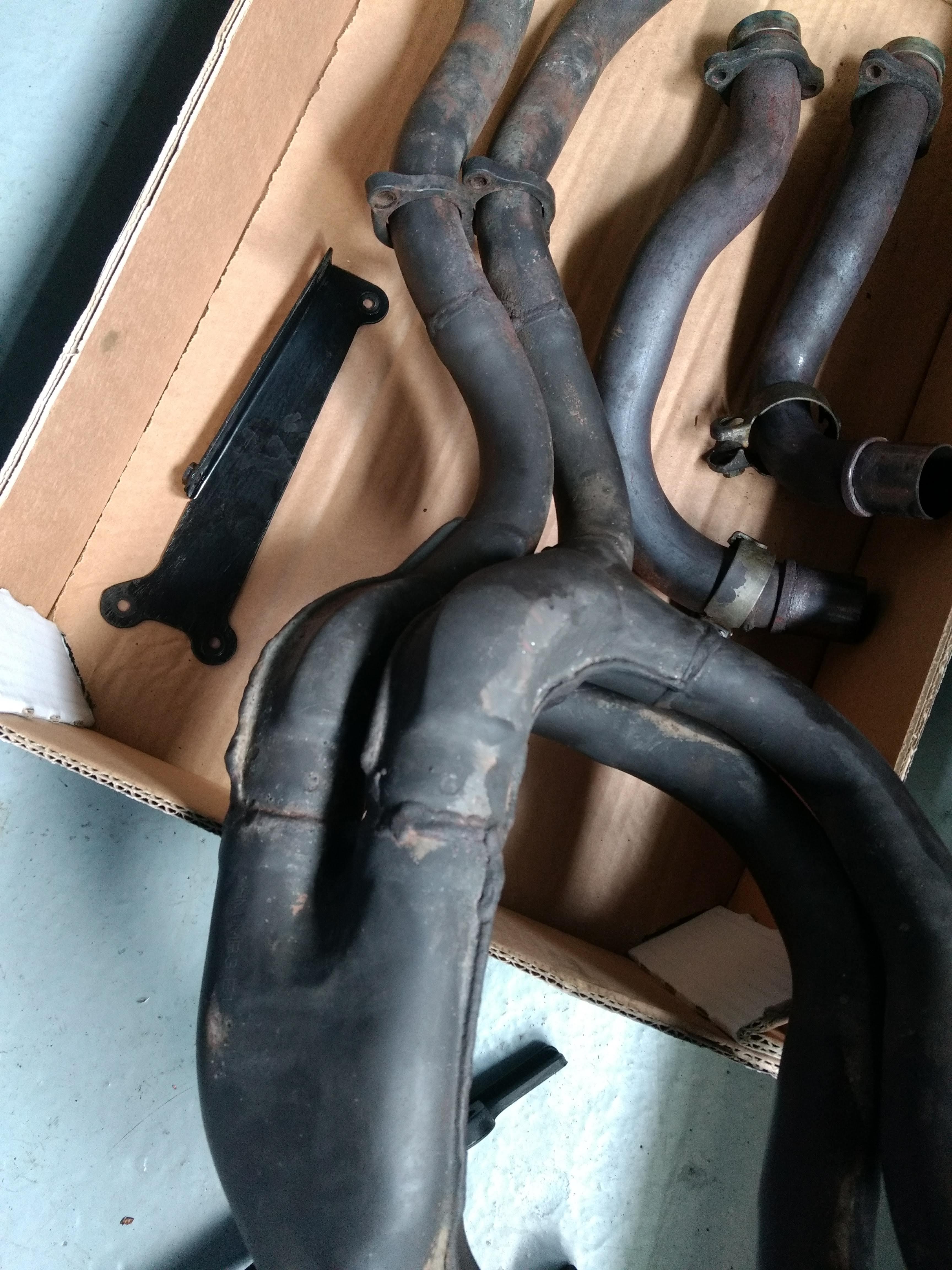

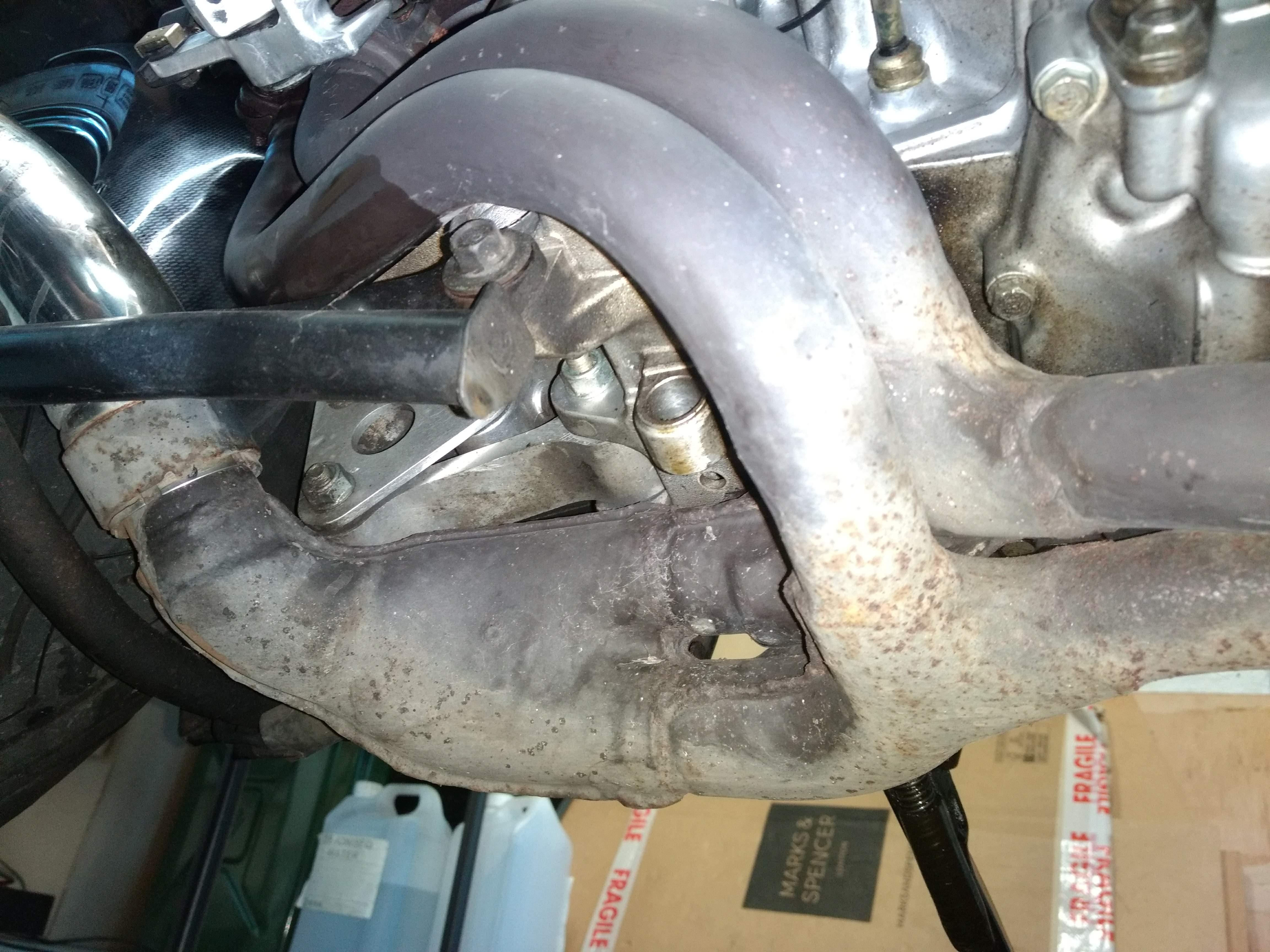

Anyway, here are some before and after pics.  I had previously partially painted the stock headers once myself with VHT paint while they were still on the bike (I know).

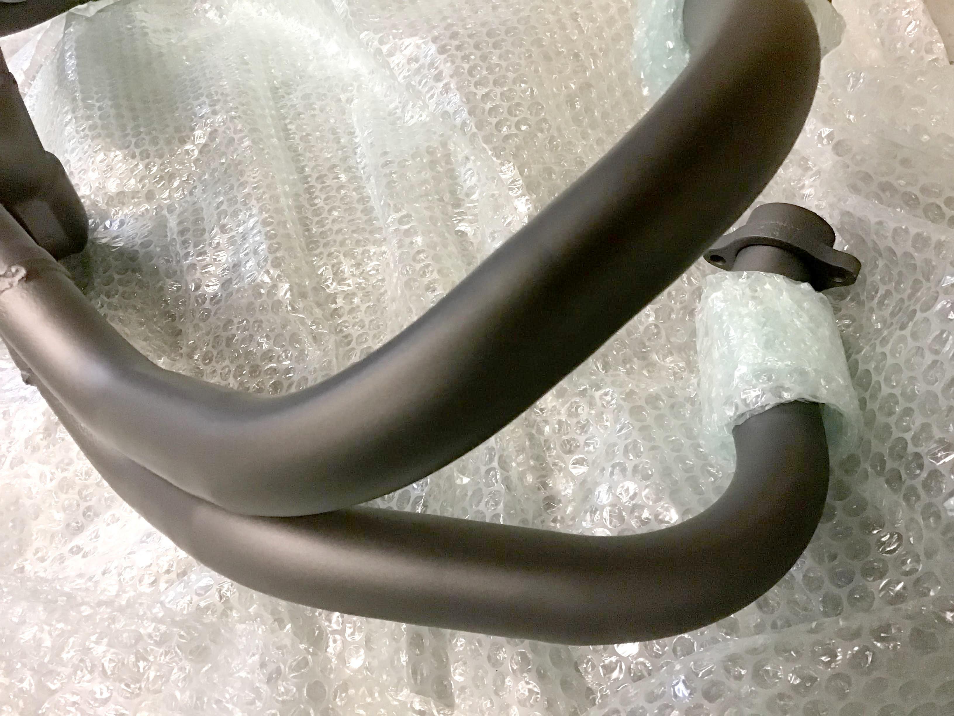

The coating was done by Performance 1 in Abingdon (UK) using their Volcanic range.  I can't recall why they recommended this range as it's overkill in terms of the temperature handling (1050 deg C).  I think it was because the standard bike finishes are a little rougher and they had the colour I was after in that range.
Although you can of course seem some pitting where they were already corroded, the finish is lovely and even the manky old clamps look good now fitted.
