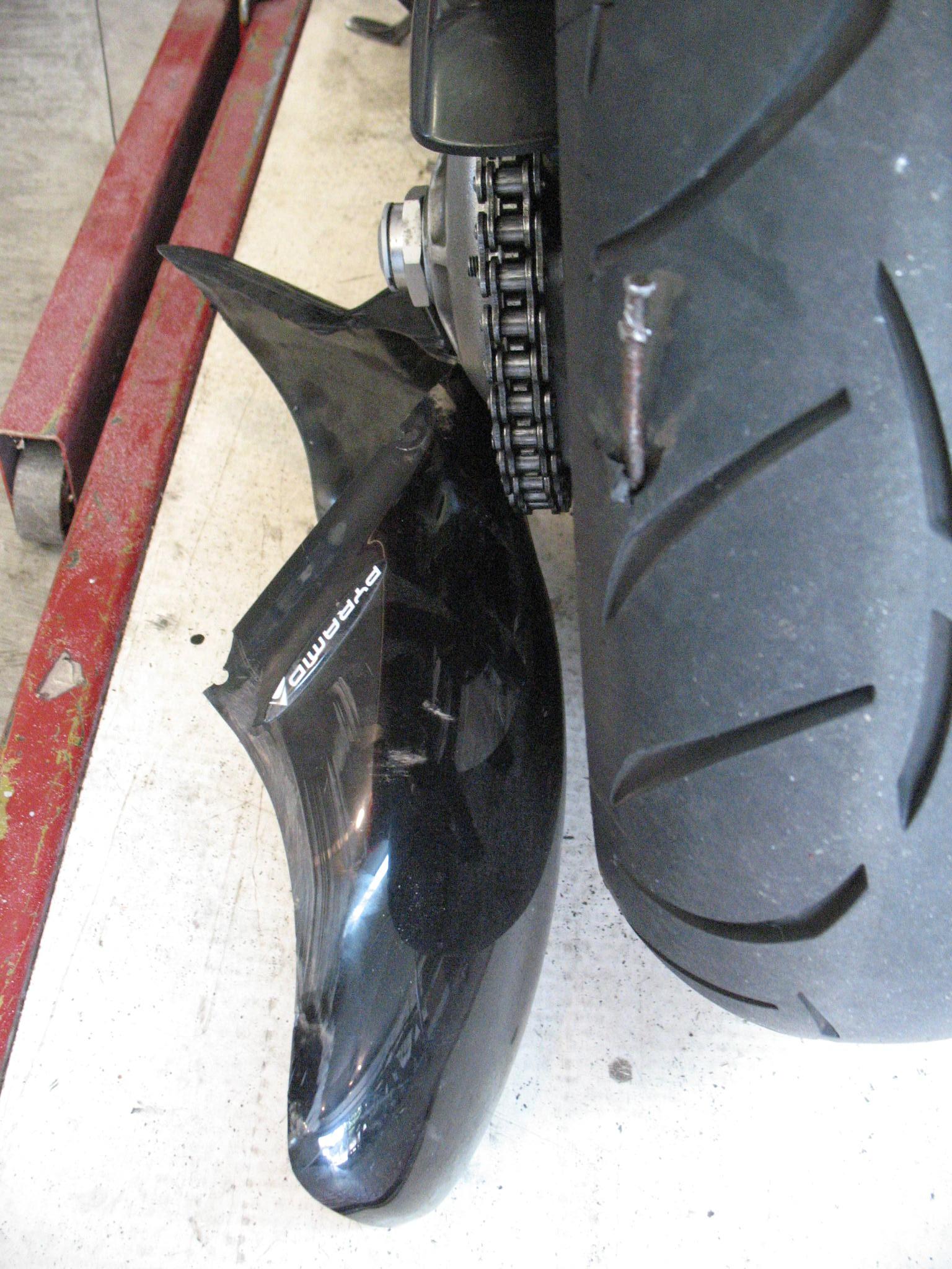

About a month ago I was riding along and heard a loud commotion at my rear wheel area.  A little jitter and as fast as it came on, it went away.  I pull over right away and see that my pyramid hugger fender has been ripped off its mount, but no clue what caused it.  I take a bungee and set it up to hold the fender from running into the tire while I ride home, some 8 miles away.
After putting the bike on the lift, I see that culprit.  A 4" duplex nail at a shallow forward facing angle imbedded itself into the tread portion of the tire but never punctured the case.   It stayed in even after it ripped my fender.
So, other than my lost fender, it was a easy pull the nail and ride.  No plug required.
While I'm at it, does anybody have a hugger fender they no longer want?  If so, let me know.IMG_6395.thumb.JPG.c0dac58e657b270a28edbb4577acca80.JPG

Sorry for your woes. I would suggest that although the nail didn’t go all the way through, noting how the structure of the tyre wall is critical for cornering, I would replace the tyre for peace of mind. Last thing you want is it to let go as you are rounding a high speed corner. A shame, as from the photo, it looks a fairly new tyre.
Be safe
Good advice for the tire change.  I'll probably take that route.

The choice is yours but I'd start plugging because there is mounting
evidence that plugged tires work and are safe... I have yet to note
anyone armed with first hand knowledge to the contrary...

I have been using plugs on flat tires for the last 6 or 7 years.  What a great technique to repair tires.  It is a rare event that requires taking my tire in for flat repair, and if I have to take it in, they don't usually want to repair for liability reasons.
Not to mention the ease of repair while on the road.  Don't forget to bring the compressor with you!
For the last 12 years or so I have carried a Slime mini compressor on my bikes along with the tools and plugs. The compressor fits nicely into the left upper part of the fairing on my 3rd and 4th gens, The plugs and tools are in my Tail bag. On my V65 Sabre I hard mounted a compressor to the bike with a switch.
Large swaths of Maine, and northern New England have no motorcycle services along with no cell service as does parts of the west in Utah, Montana, North Dakota etc.. Better to be self sufficient than stuck in a lonely place.. Used it once myself, then on some Harley in Colorado, then a Camry in I think, Quebec.
Any repairs to a V rated tyre is only permitted on a “get somewhere to replace the tyre basis” in the UK
Its illegal for a tyre company to repair the tyre and your insurance is invalid if you do otherwise
