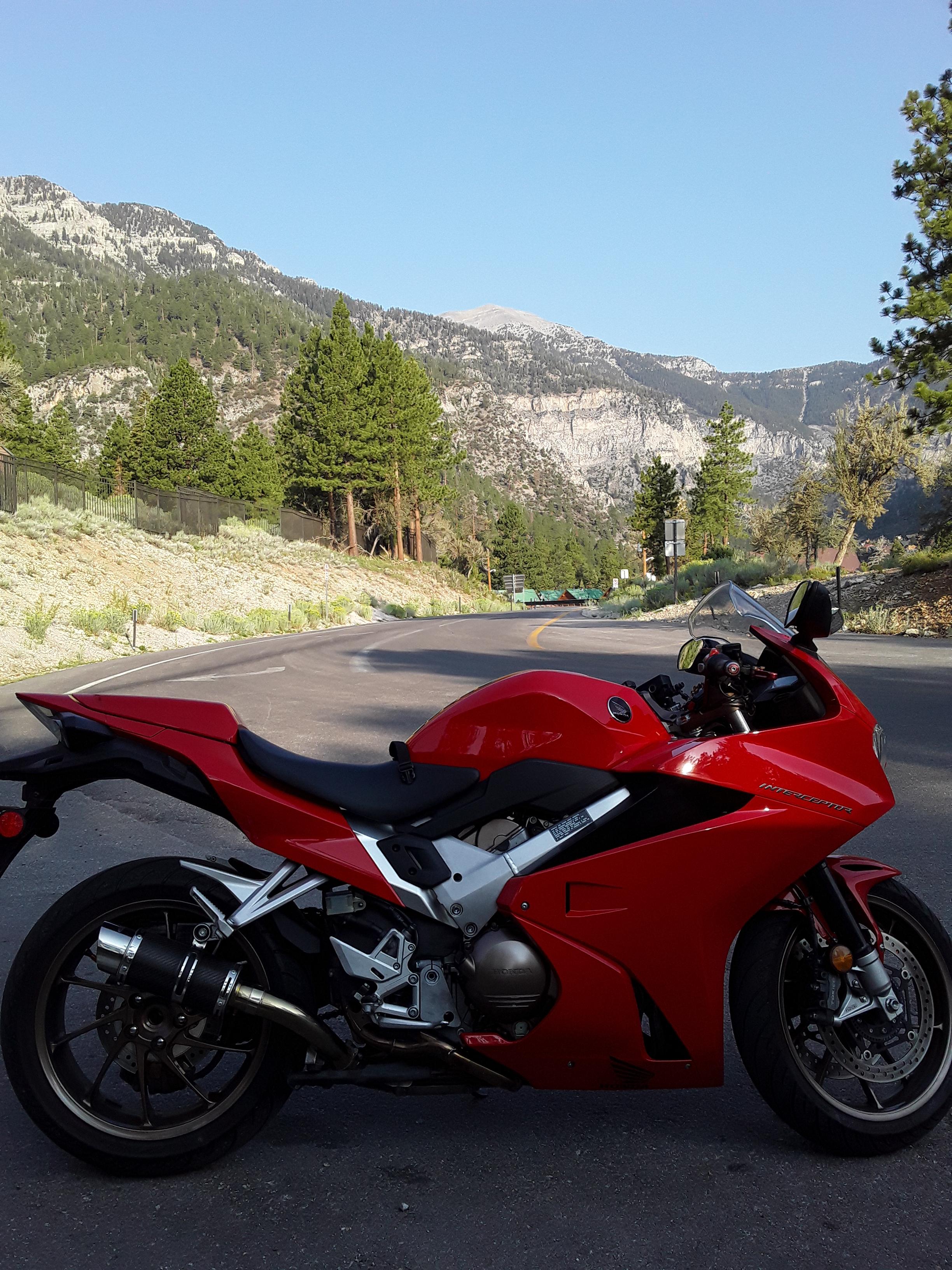

SchlepRock Posted August 12, 2021 Author Posted August 12, 2021 This is 10 minutes from my brother's house, where I'm staying for a bit. Quote
