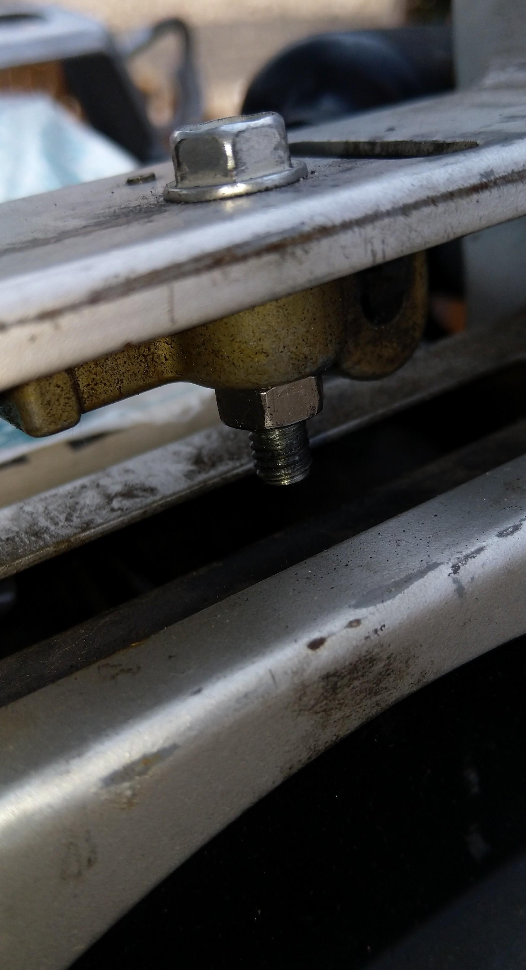

This is how the 4th gen latch looks like
That bolt will come loose over the years, so put a longer one in and put a nut on
